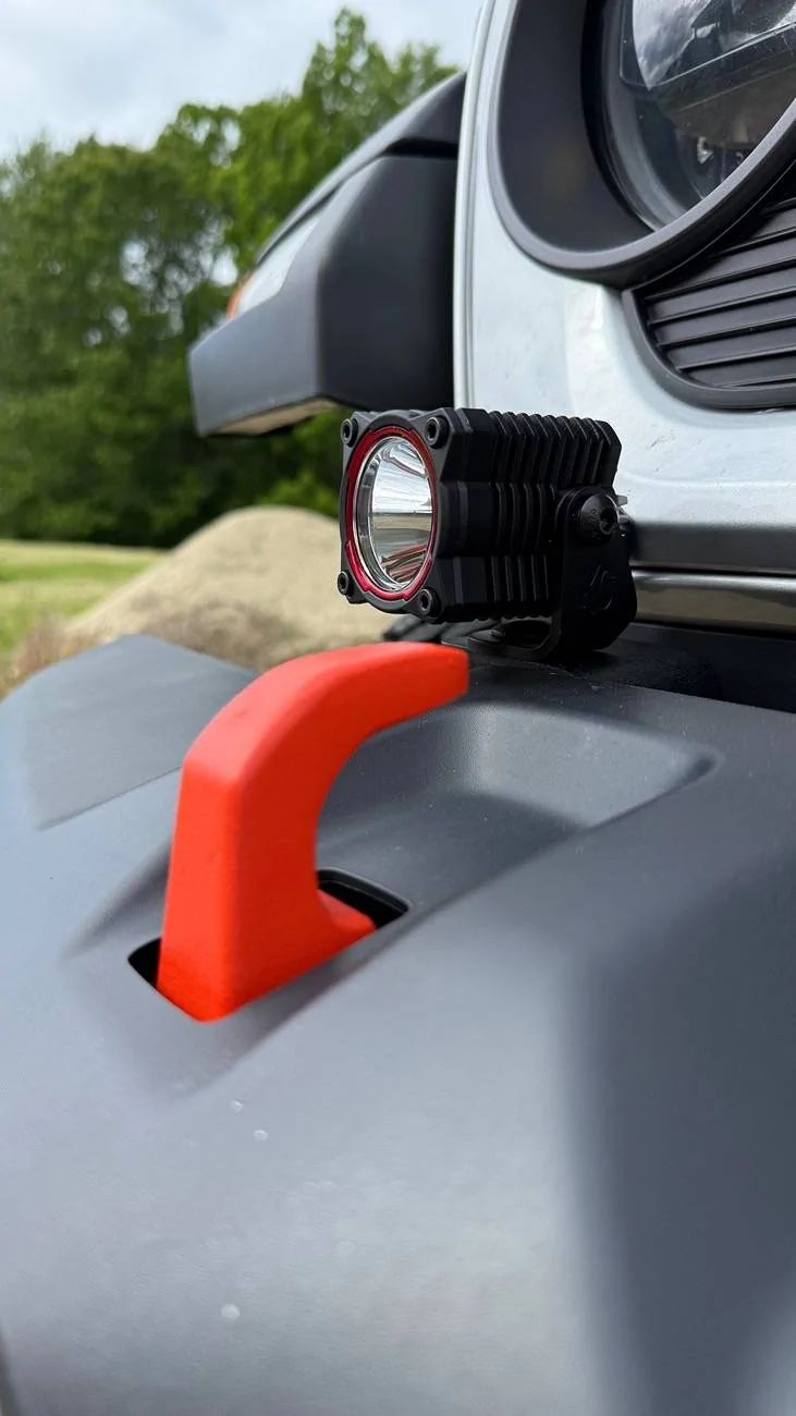

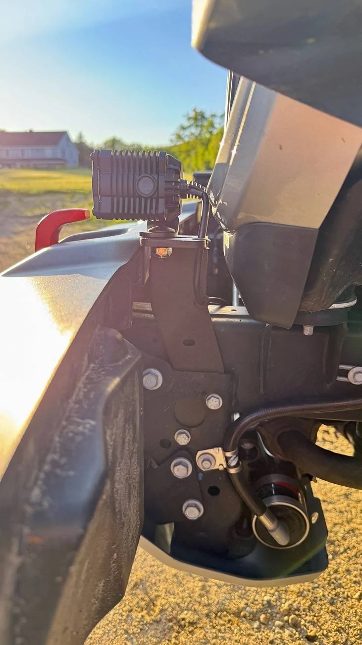

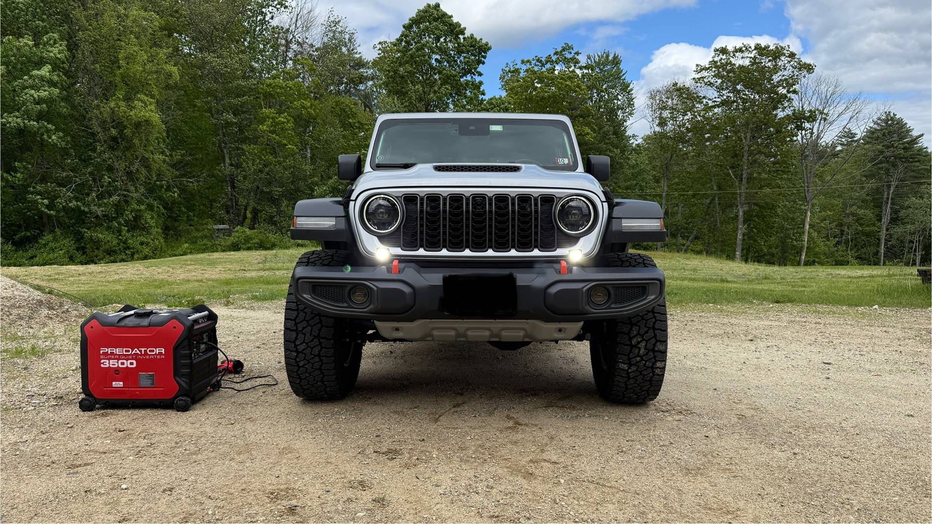

I’ve had the lights and brackets (bought from someone called HazardSky on Etsy) for a bit but haven’t had time to work on installing them. The brackets tucked into existing spots on the frame. I pulled my grill to do them but you can also probably loosen the bumper and get them in too. I need to aim them still when it gets dark but they’re good little lights though the cable does hit the grill and may wear the paint over time but being plastic I don’t care about it too much. They come with gold trim rings but I also bought red to try and get close to Mojave orange accents. I can get additional photos if anyone likes. Generator is in the pic because I forgot I loaned out my long extension cord and I had to run the heat gun. Haha.

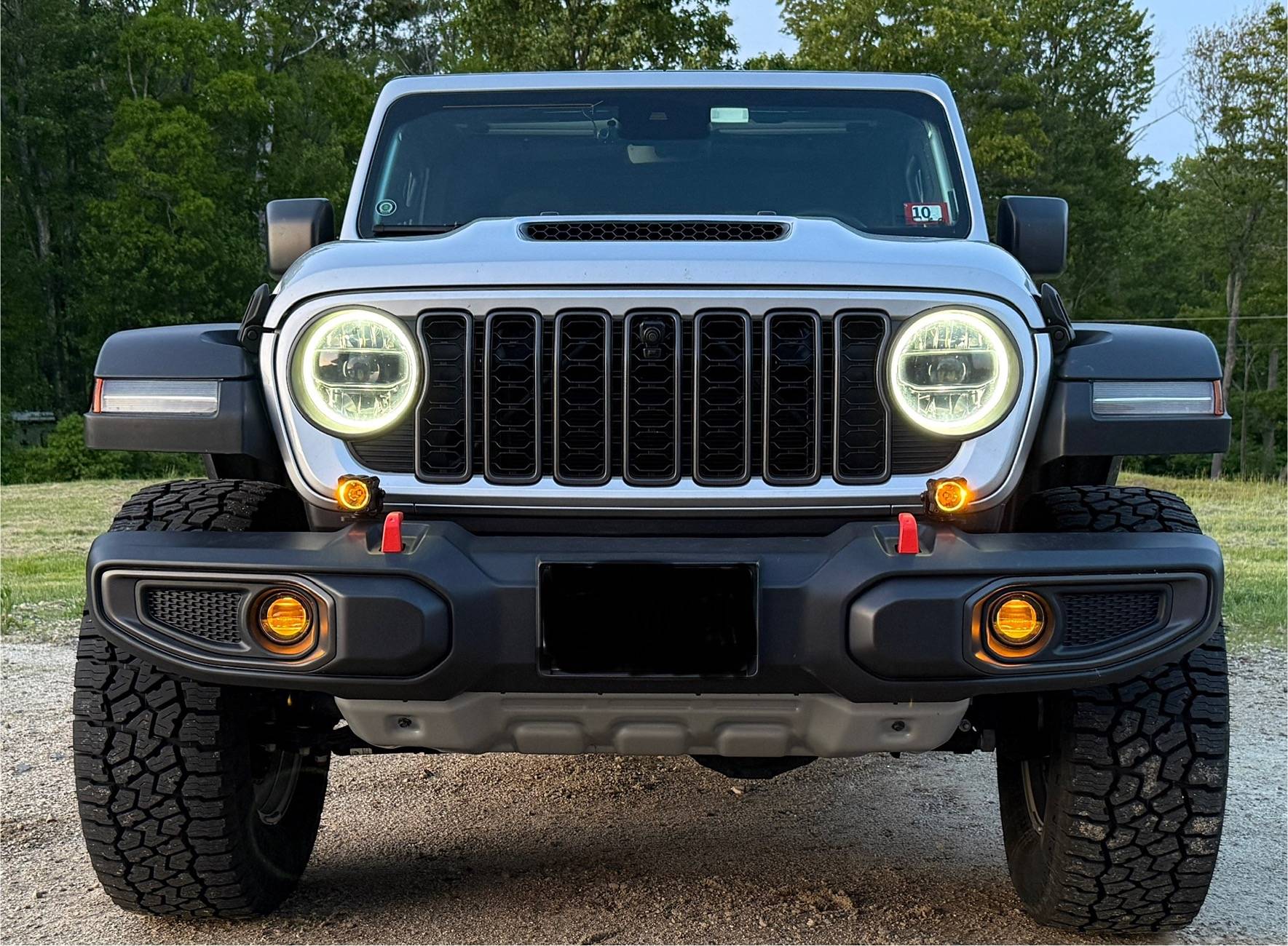

Very nice. How did you make lights amber?

Both the new lights and my fog lamps (Diode Dynamics) have an amber backlight wired to one of the auxiliary switches. The KCs light up white and the fog lamps are actually amber which has been great in fog/rain/snow.
