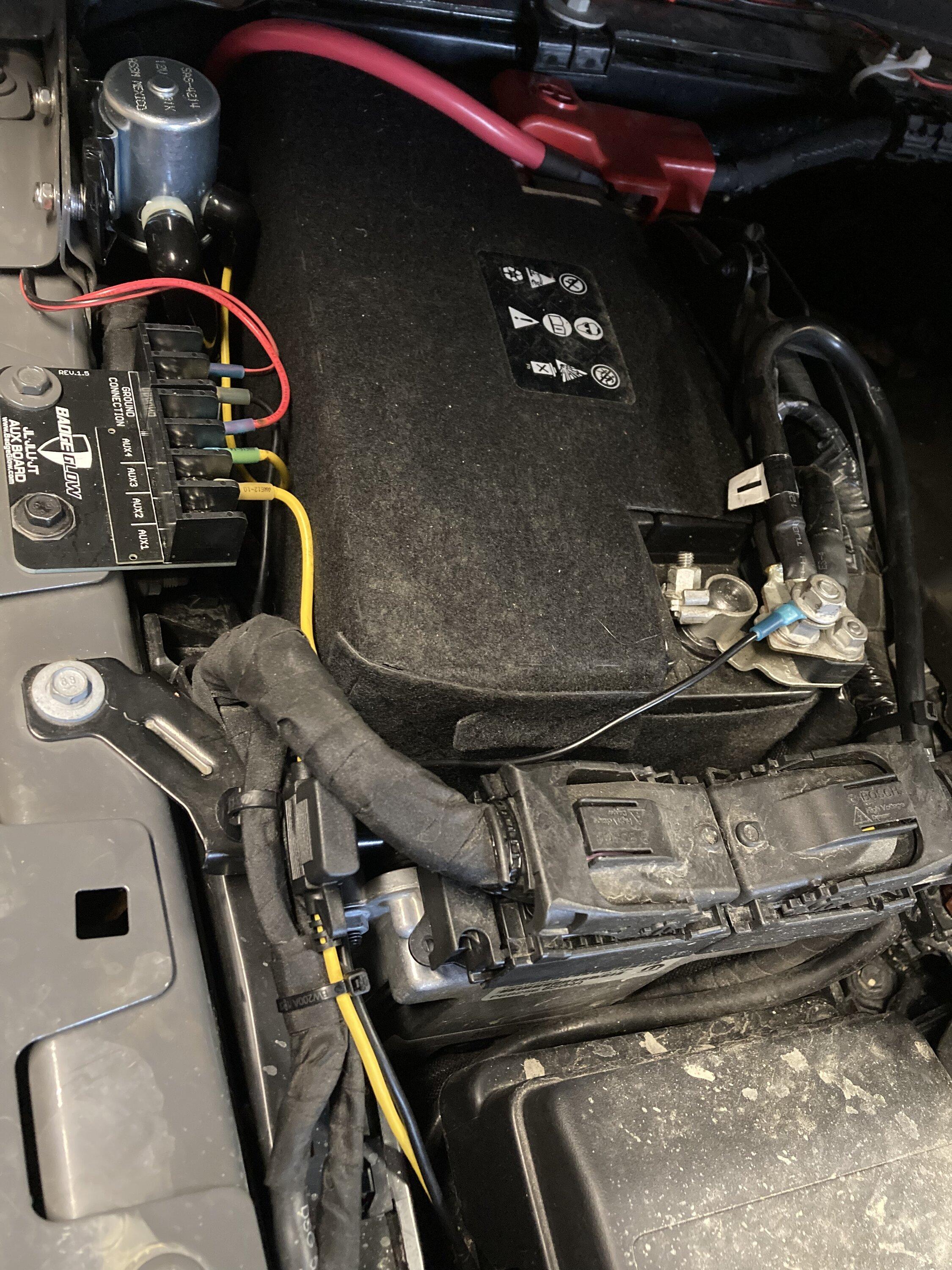

Used Aux 2, trimmed out the KC switch, and added the BadgeGlow board to make it even easier.
And I totally forgot about the running lights. I guess I have a weekend project ahead.
