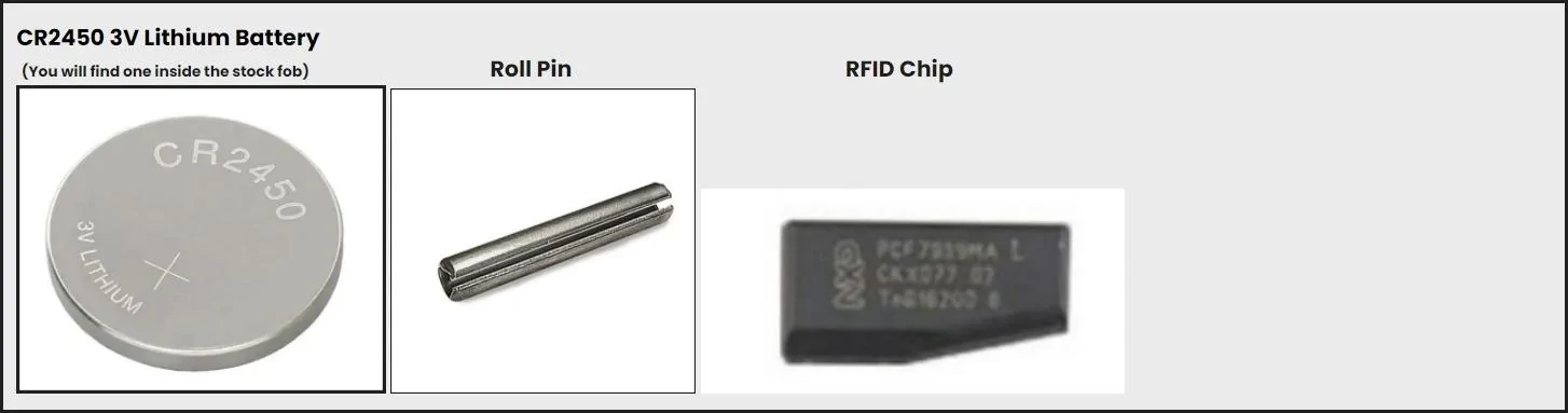

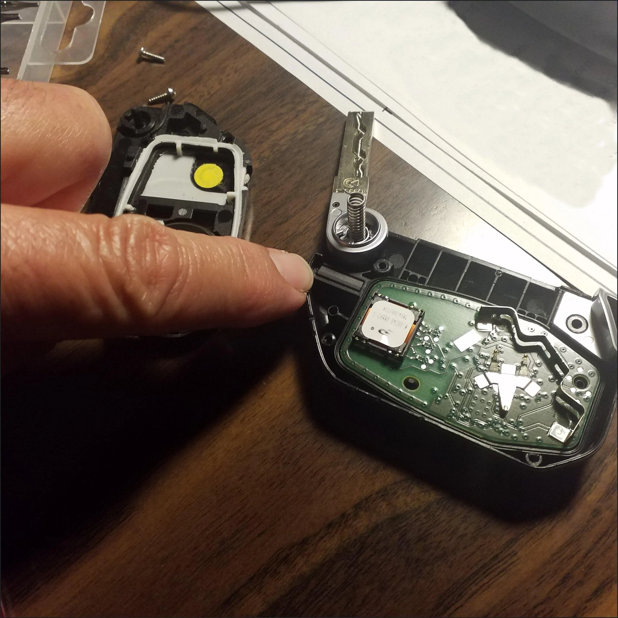

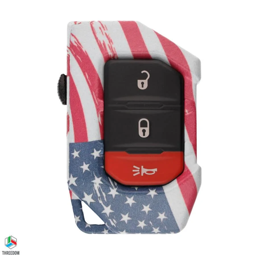

For those that want a Threedom fob but ...."lack the patience" to deal with the RFID chip removal..
There is another way so to speak...
You can disassemble the factory fob and leave the RFID chip alone/leave it in it's holder in the fob casing/shell.

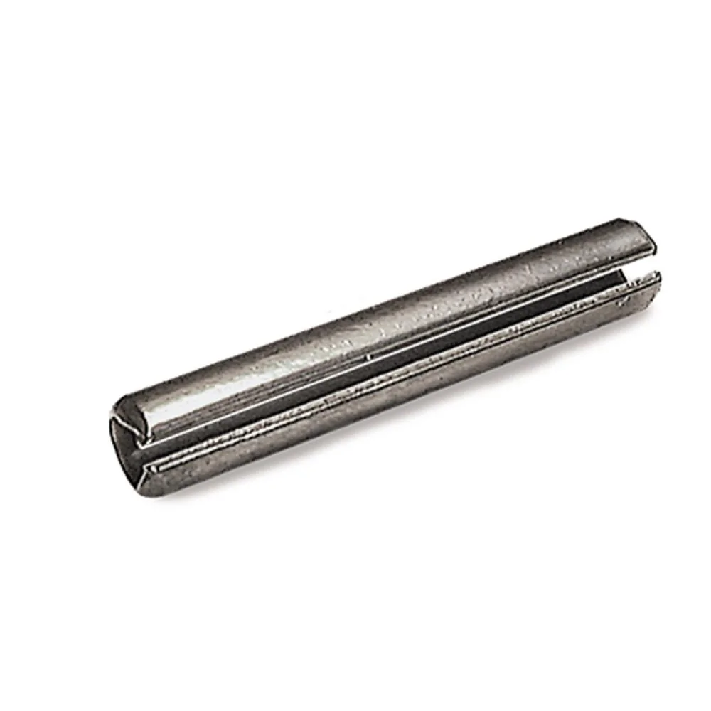

Just take the circuit board, battery, key with the roll pin, and with those, easily easily assemble your Threedom fob.
That assembled Threedom fob will be all you need to have/use for your day to day use of your JT/JL. You do not need the RFID chip in the JL/JT fob. All you need is a programmed for your vehicle circuit board and a healthy CR2045 battery inside the Threedom fob and your key.
You do want to have that RFID chip handy though, as if your fob battery dies, the fob gets wet and no longer works, etc. you will need the RFID chip so you can start your JT/JL and get home.. See my post earlier in this thread showing / explaining how to start with the RFID alone... Read this post over carefully.
So... with that said, you can without issue, use the Threedom fob without having the RFID chip in it.... but you would want to take that disassembled factory JT/JL fob with the RFID chip in it and stash it well / hide it well, in the vehicle so that if/when that day comes, that you need to use the RFID chip to start the vehicle, that you will have the RFID chip with you/with the vehicle.
Threedom encourages guy/gals to move the RFID chip to their new Threedom fob when they assemble it but again, this work around lets call it, can be used. You decide whether this work around is a way to go for you.
For sure, there are many that do not feel comfortable trying to / dealing with, the removal of the RFID chip from the factory fob.. This work around is A WAY, for them to not deal with the RFID chip and still enjoy having/using a terrific Threedom fob...

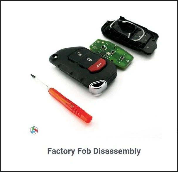

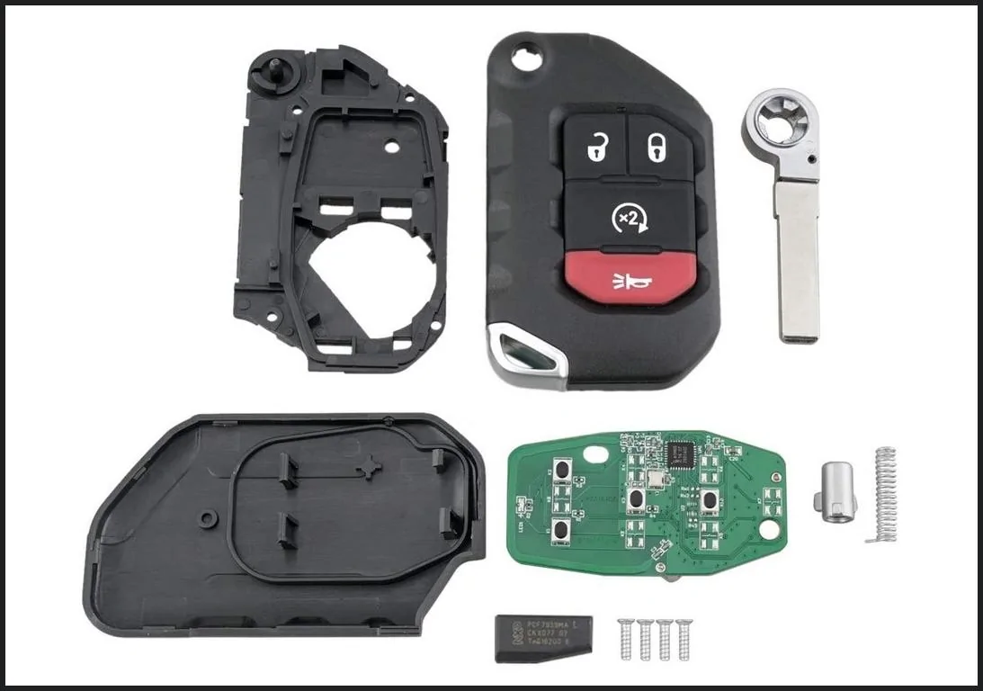

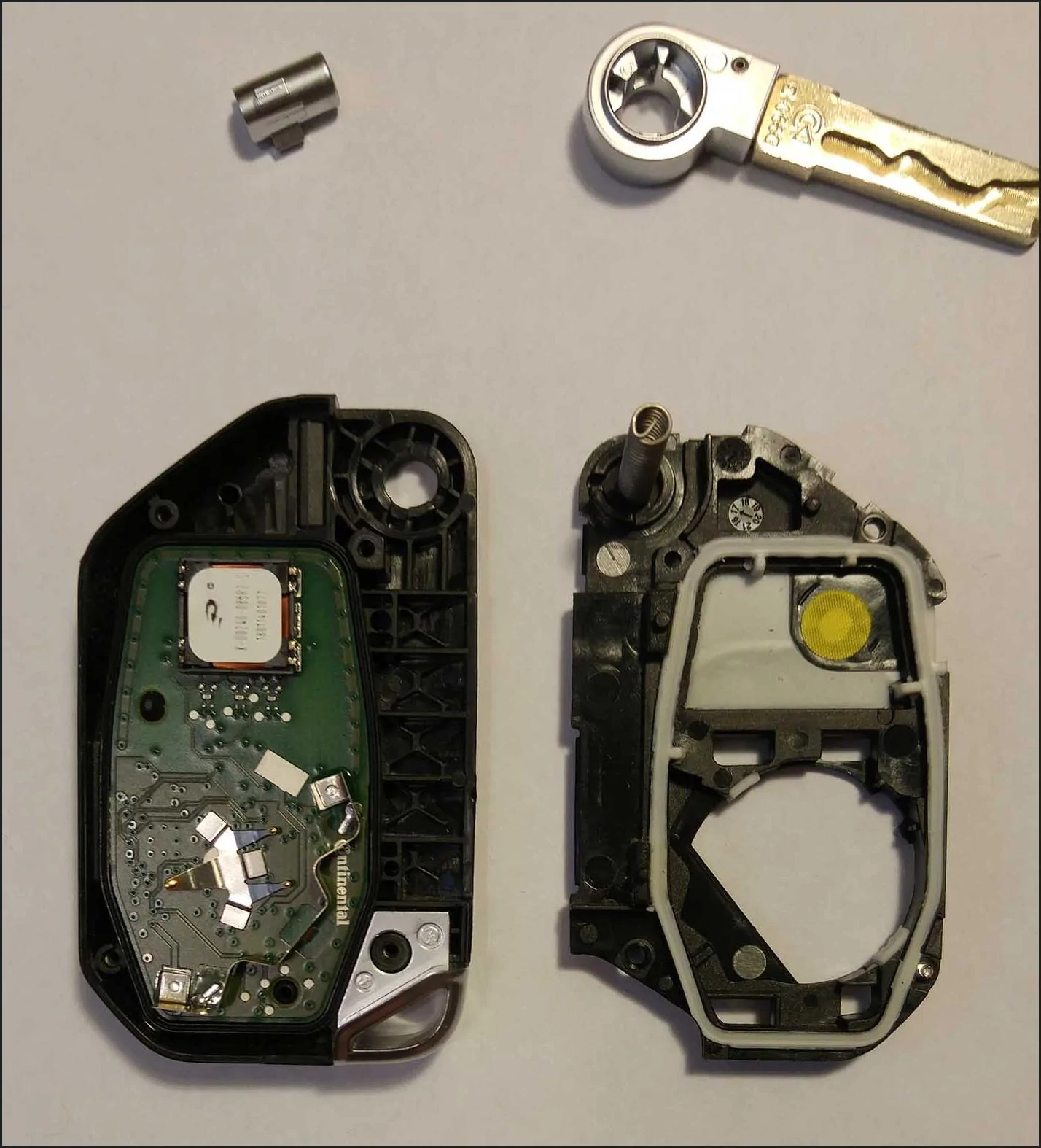

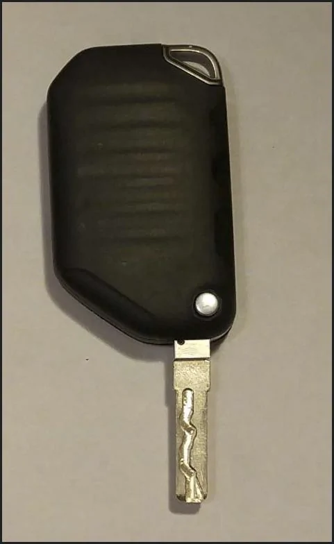

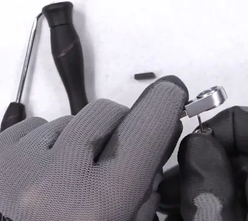

Not every JT/JL owner is familiar with what is inside of a factory JT / JL key fob...
IF you have any questions, ask away... IF you have something to say regarding the disassembly, etc., let's hear it.. Help thy fellow JT /JL owner..
JT/ JL Factory Key Fob Disassembled
Jeep Gladiator ?  Key Fob 101 - Know thy JT key fob ? stock-fob-guts
Jeep Gladiator ?  Key Fob 101 - Know thy JT key fob ? 2323

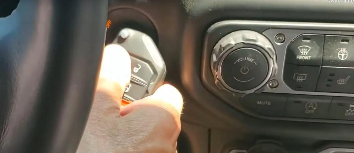

Factory JT /JL key fob disassembly video click here.

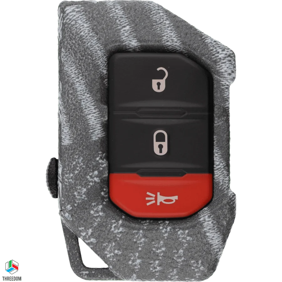

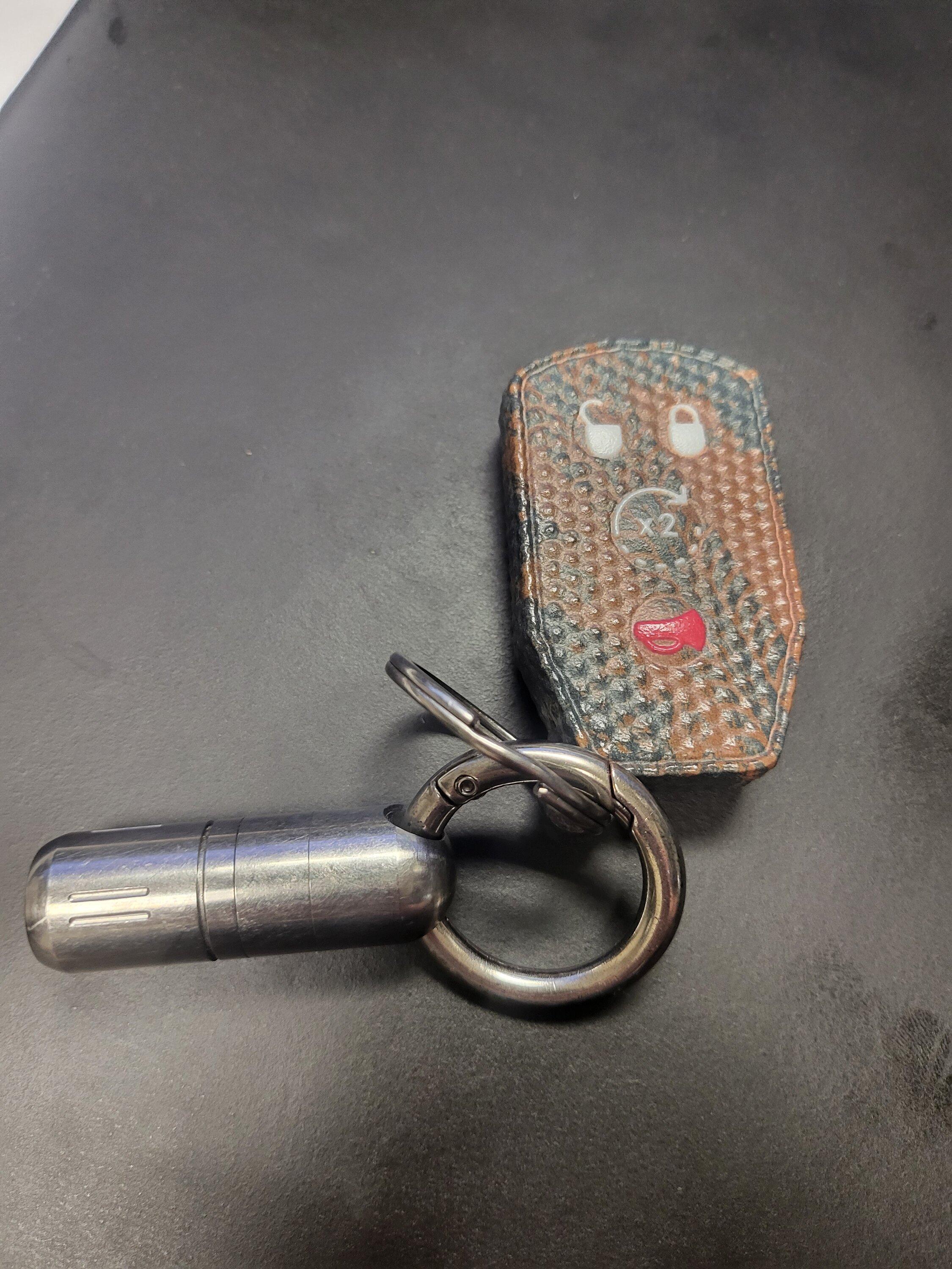

I got my M+ this week. I gotta say, I am impressed. After carrying the brick for the last 3 years, this is almost disturbingly light.
Thanks for a quality product!

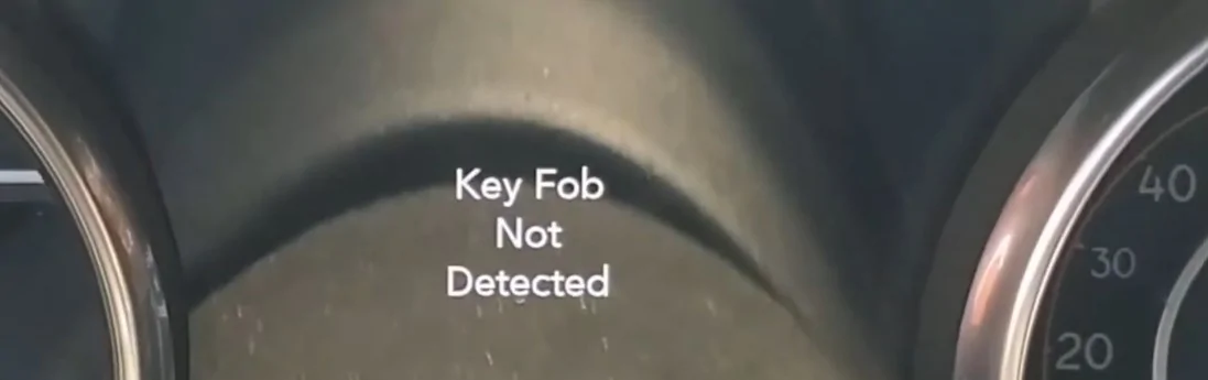

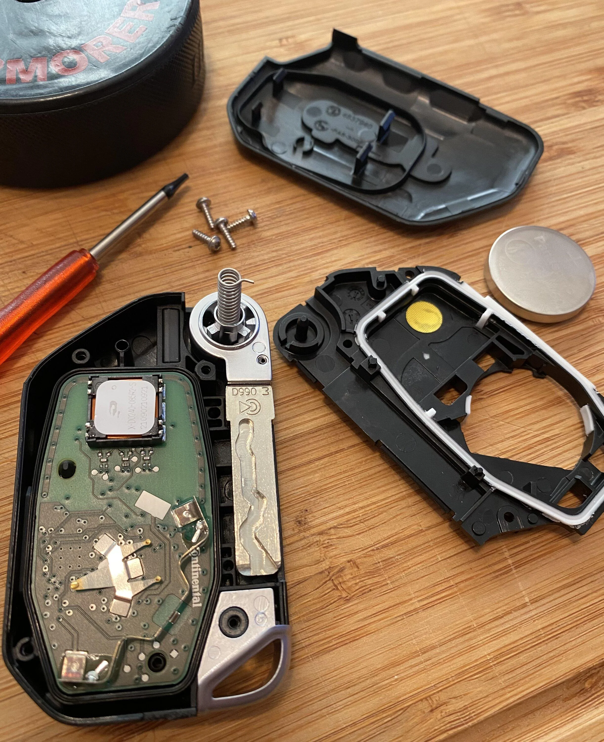

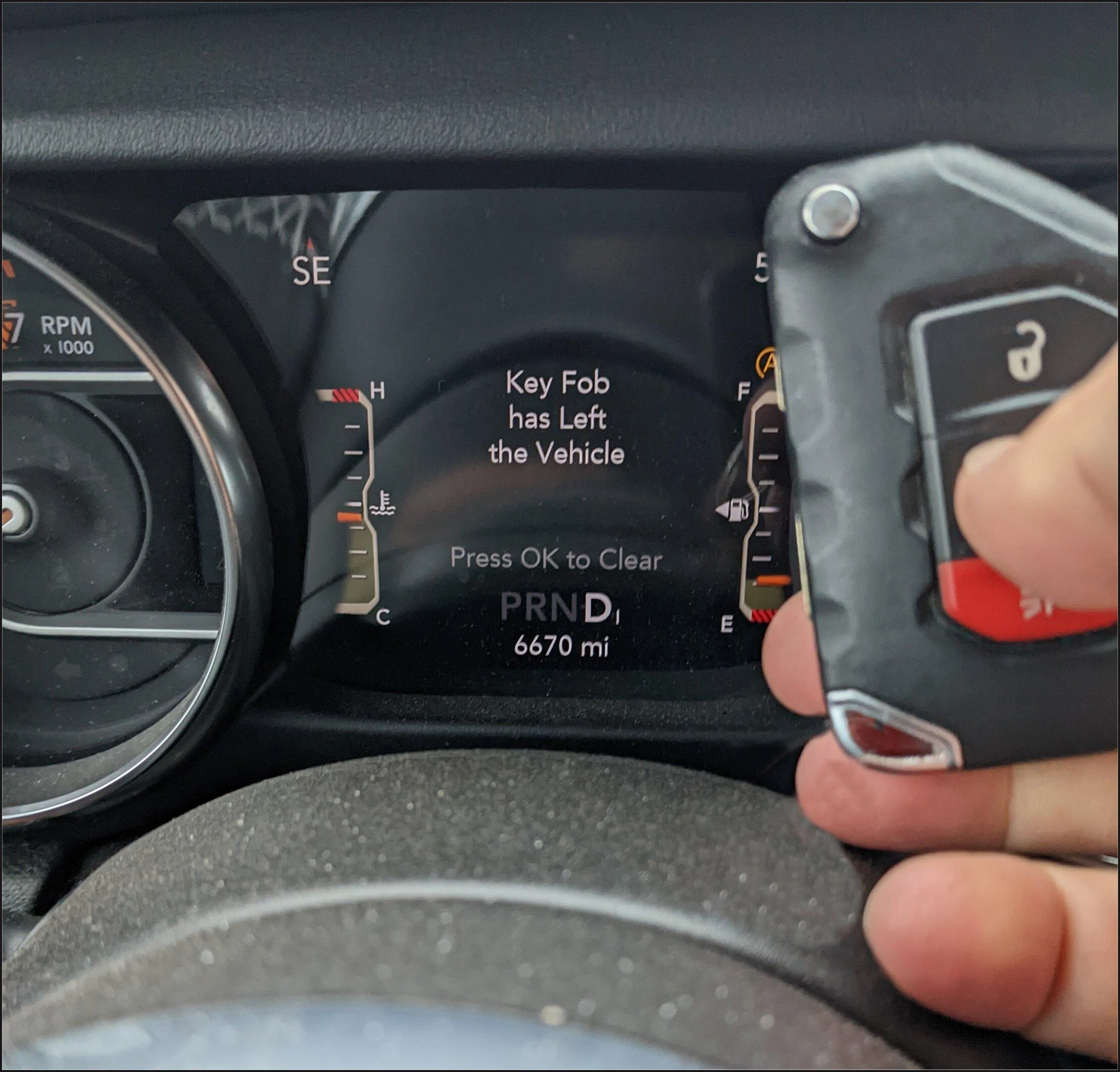

Key Fob has Left the Vehicle ... when your fob is in the vehicle, replace your fob's battery!
Jeep Gladiator ?  Key Fob 101 - Know thy JT key fob ? 567gvhbn
CR2450 Fob battery... Whether you have a clunky factory fob or a custom design, smaller Threedom fob, you will need to routinely replace your fob battery.
