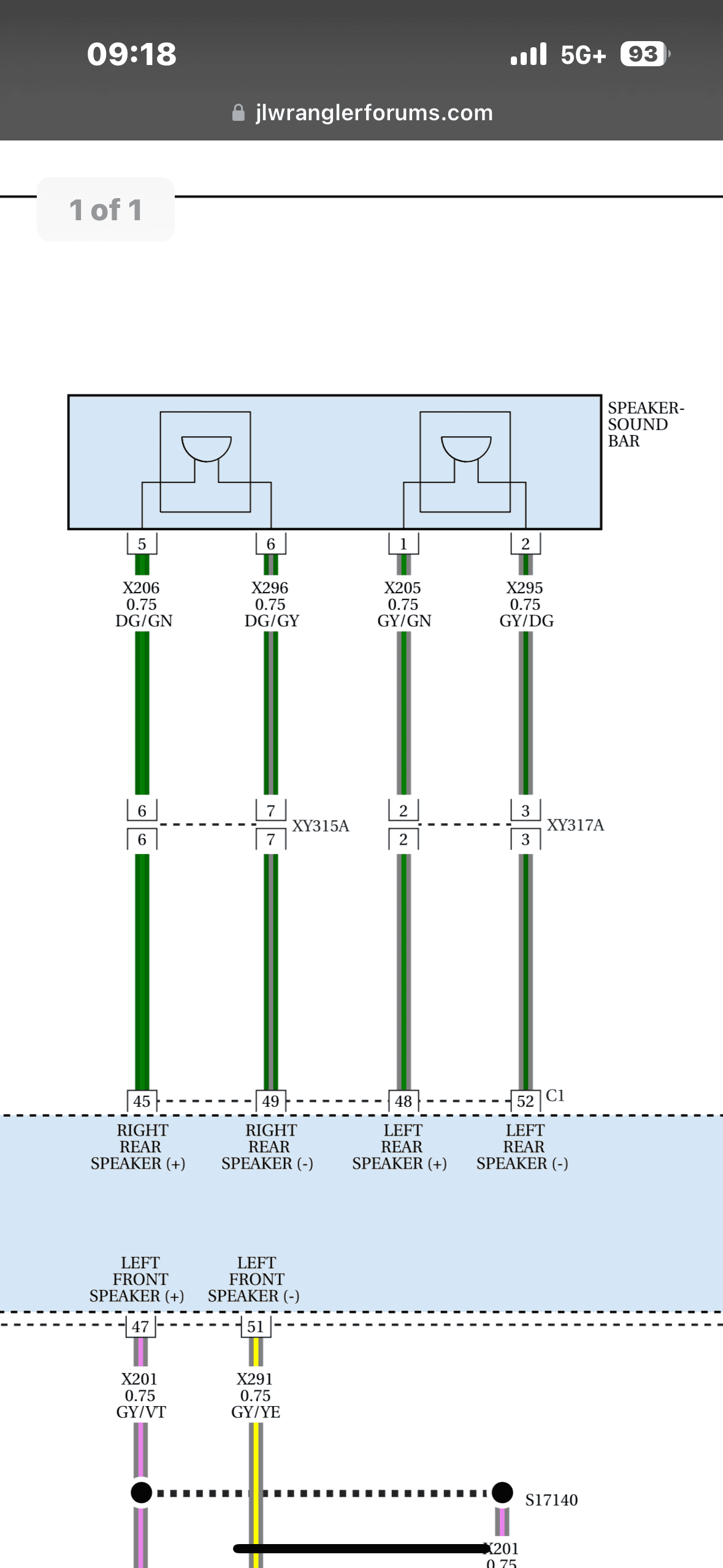

Good morning, I have a 2021 Willys with the base radio. I’m going to add a kicker Hs10. Just trying to figure out which wires and where everyone is tapping in to the speaker wires. I know B Pillar passenger side. Just want to confirm wire colors. Does anyone have a diagram?

Found this….looks correct? Lol
Jeep Gladiator Kicker Hs10 install 541EA402-A2EC-43CD-B1A2-9690A3C030D9

Did this work?

Yes, works great
