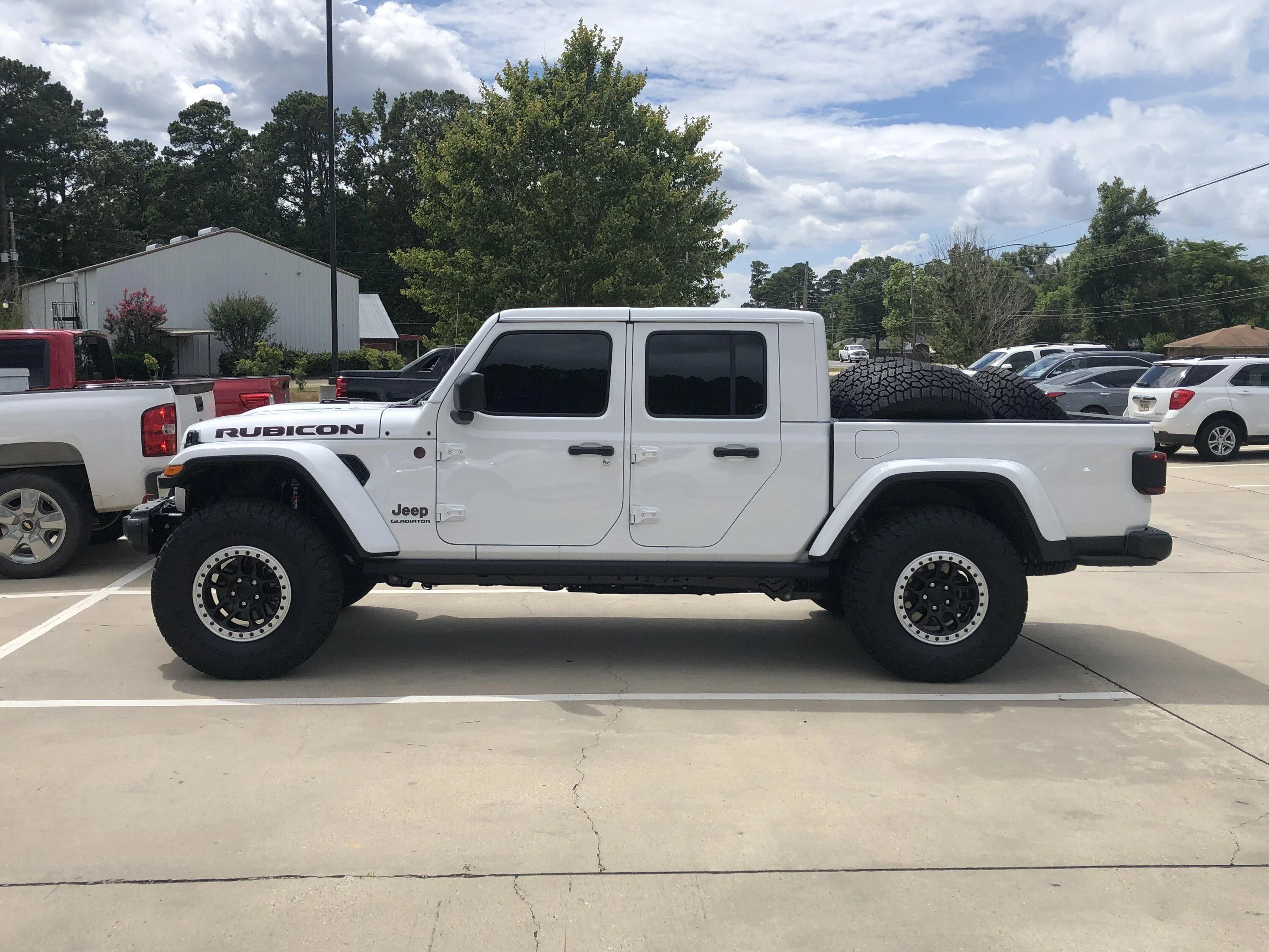

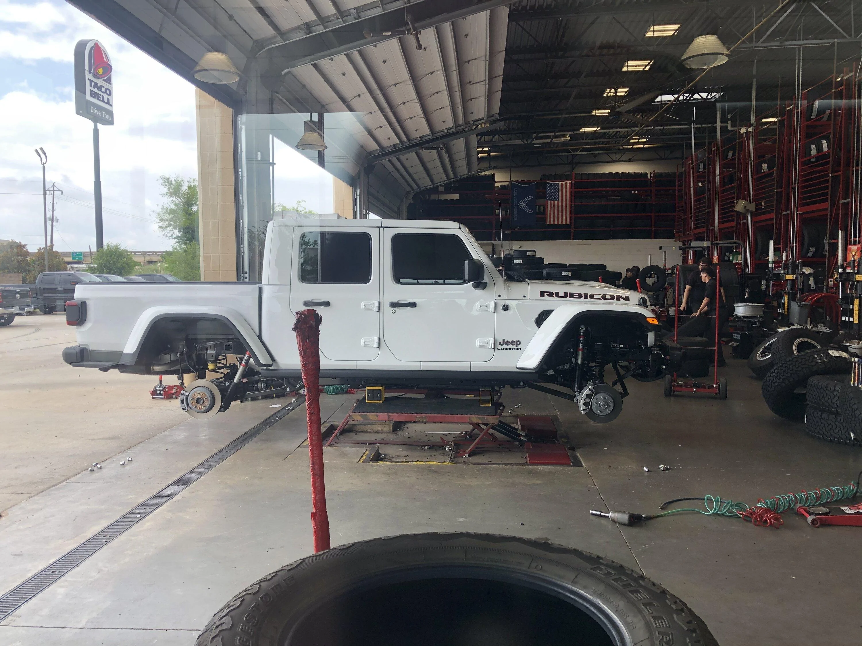

Got my 37’s on today. My appointment was at 1 pm and by 1:03 they had the tires off. I even got an additional $110 off with a 4th of July promo. Big fan of Discount Tire.Waiting patiently for the Metalcloak sale now.
Jeep Gladiator KO2 fitment - is Discount Tire messing with me? EFC72E0B-B5D5-426F-9BBF-4332467C451C
Jeep Gladiator KO2 fitment - is Discount Tire messing with me? 1B3DDBA7-BA5B-497D-8035-538B323E8BF2

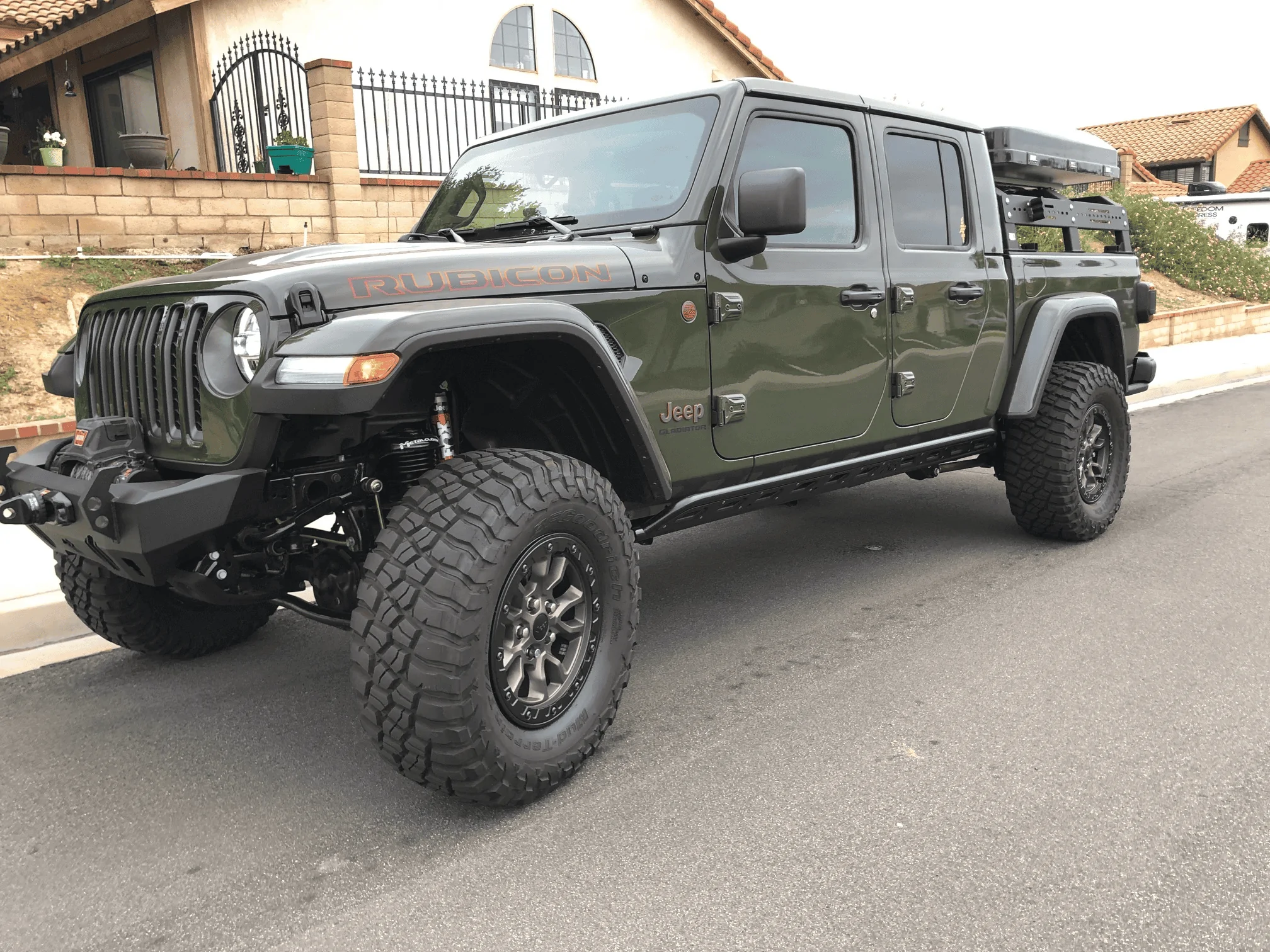

Those are the wider 8" Mopar 392 beadlock-capables. Did they mention if 37's can be installed on the other 392 7.5" width wheels? I'm on 35s, MetalCloak 3.5" lift, stubby bumper for more clearance and no questions asked when mounted on the narrower 392. @Discount Tire
Jeep Gladiator KO2 fitment - is Discount Tire messing with me? 1657039169934

That is a beautiful truck. I too ordered a 3.5” Metalcloak lift. Seems like the best looking setup for the Gladiator IMO.

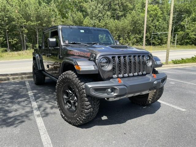

ive got 37x12.5x17 Mickey Thompson Baja Boss M/Ts. You’ll be fine at 37”, but the trick is the 12.5. They won’t fit on the stock wheels. I got AEV Saverge II. They’re built specifically for the JL and JT and I think the offset is 5.5” or something. That’s what keeps the extra inch of width from rubbing at full lock.
Jeep Gladiator KO2 fitment - is Discount Tire messing with me? 20B084D5-5238-4777-8A44-7EAA59ADA7DF
