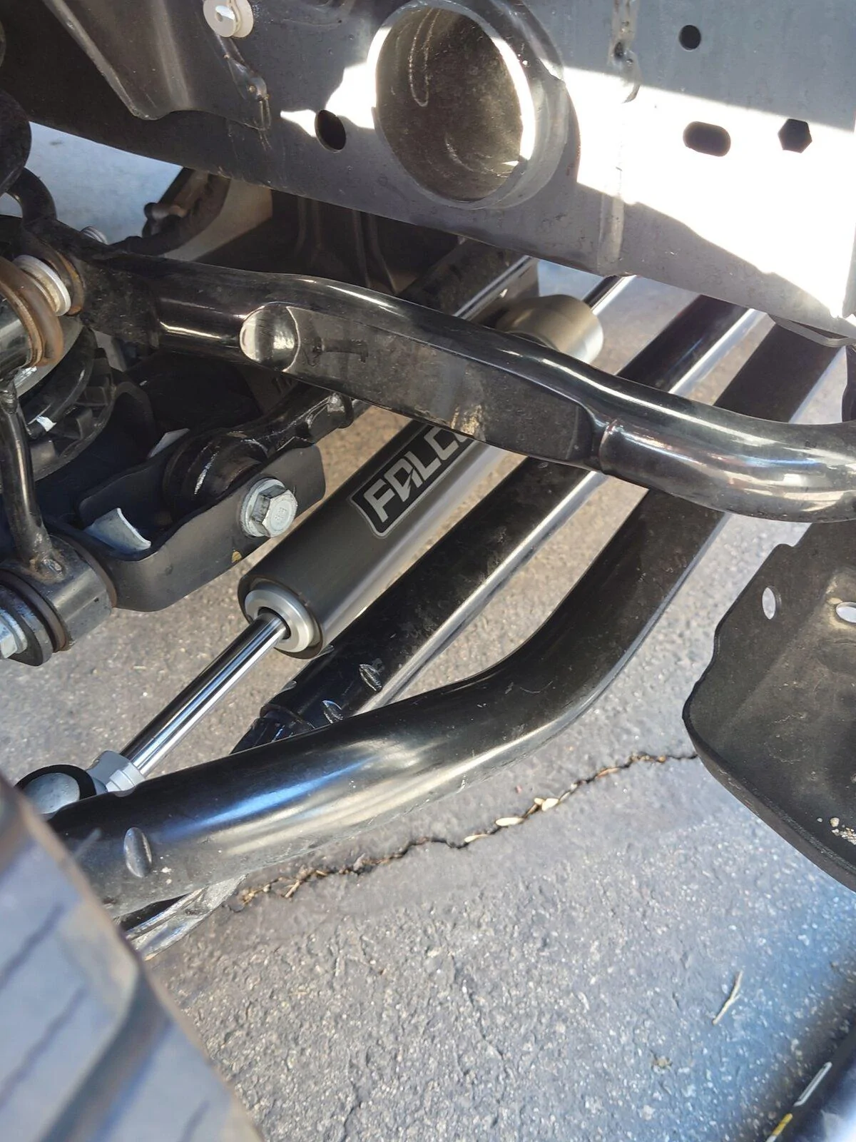

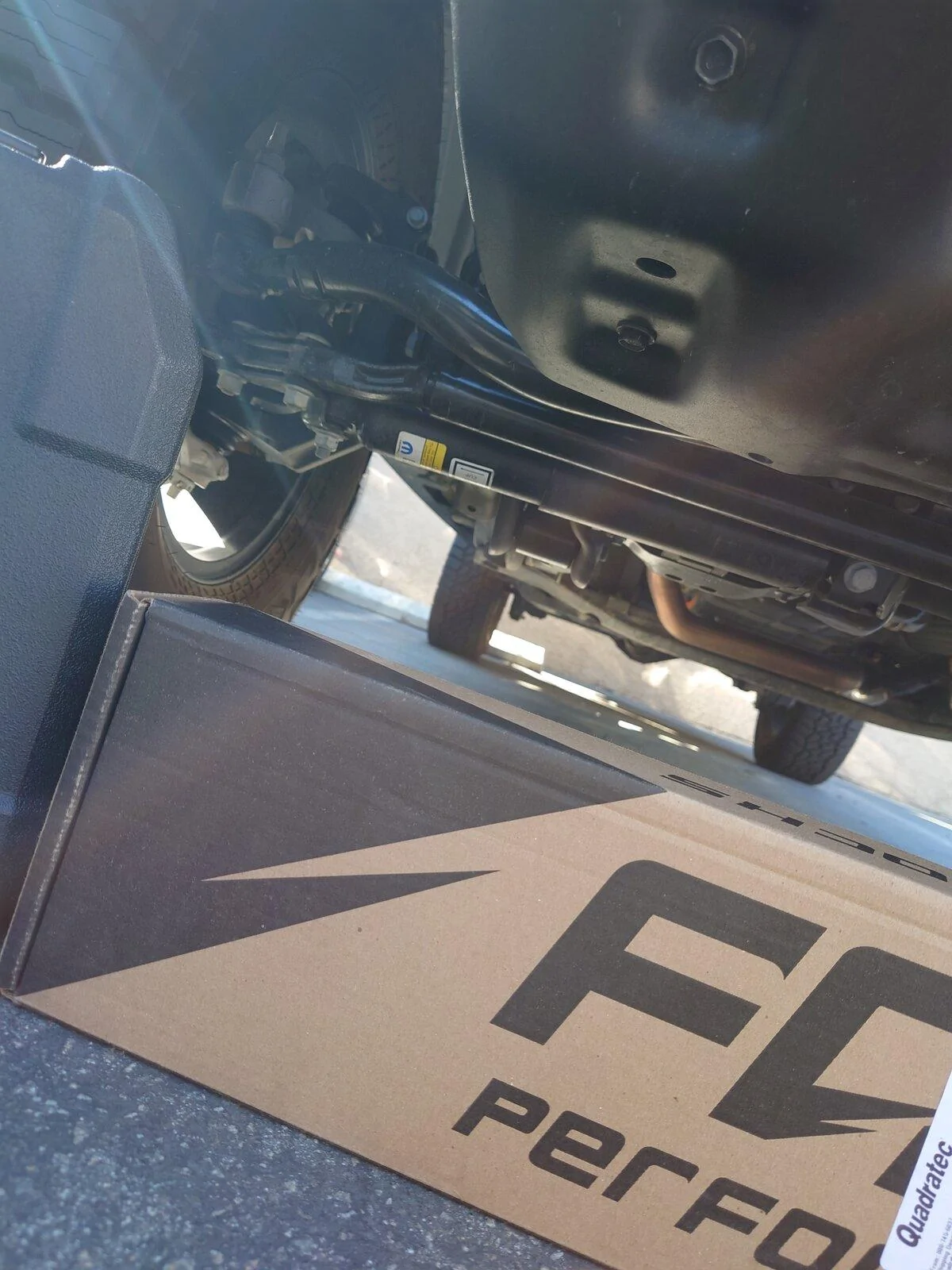

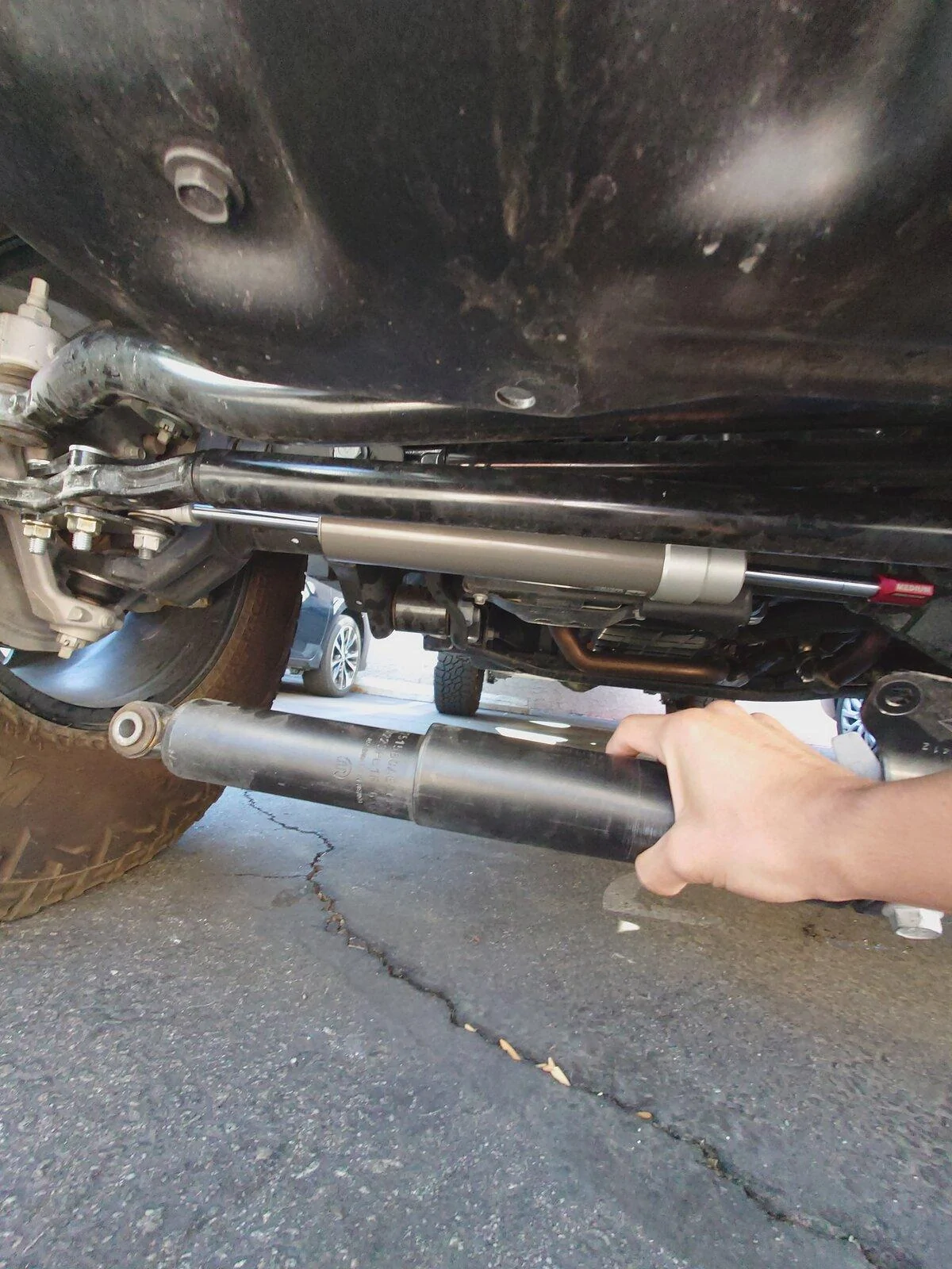

Steering Stabilizer
Falcon Nexus 2.2 S. S.
Decided to replace the stock SS because it sucks, it feels good at the dirt and city driving (not that much) but on the freeway this SS is not a good experience. Since my wife use to drive the truck when she needs i decided to upgrade that part (just to start and getting into the suspension later).
Jeep Gladiator La Calentura Build (JT Rubicon 2021) DSC_0262
Fox never restocked @Quadratec, so i decided to pick Falcon (by Terraflex)
Jeep Gladiator La Calentura Build (JT Rubicon 2021) DSC_0001_BURST20201115133550242_COVER
The installation is "Easy" but with the correct tool (like a big jack). but i think everybody with a small knowledge on mechanical tools and watching some Youtube Videos.
Jeep Gladiator La Calentura Build (JT Rubicon 2021) DSC_0265
The results were magnific, my wife and i loved it.
It is amazing to have 3 setups for the SS.

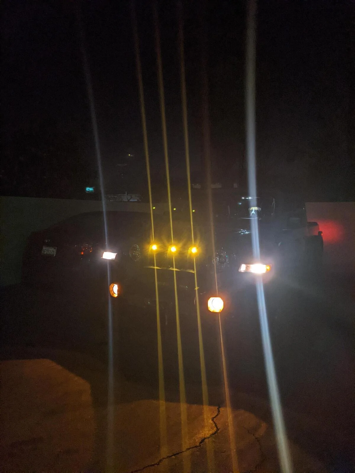

Lamin-X
this fil is just temporary, im trying to go Led (KC, BajaD etc) witht the amber look or yellow.
the install is simple but it not fit perfectly
Jeep Gladiator La Calentura Build (JT Rubicon 2021) {filename}
Jeep Gladiator La Calentura Build (JT Rubicon 2021) eRtP6wh
i though that it was going to be a match with the Oracle PreRunner ligths "Amber" but was not the case/

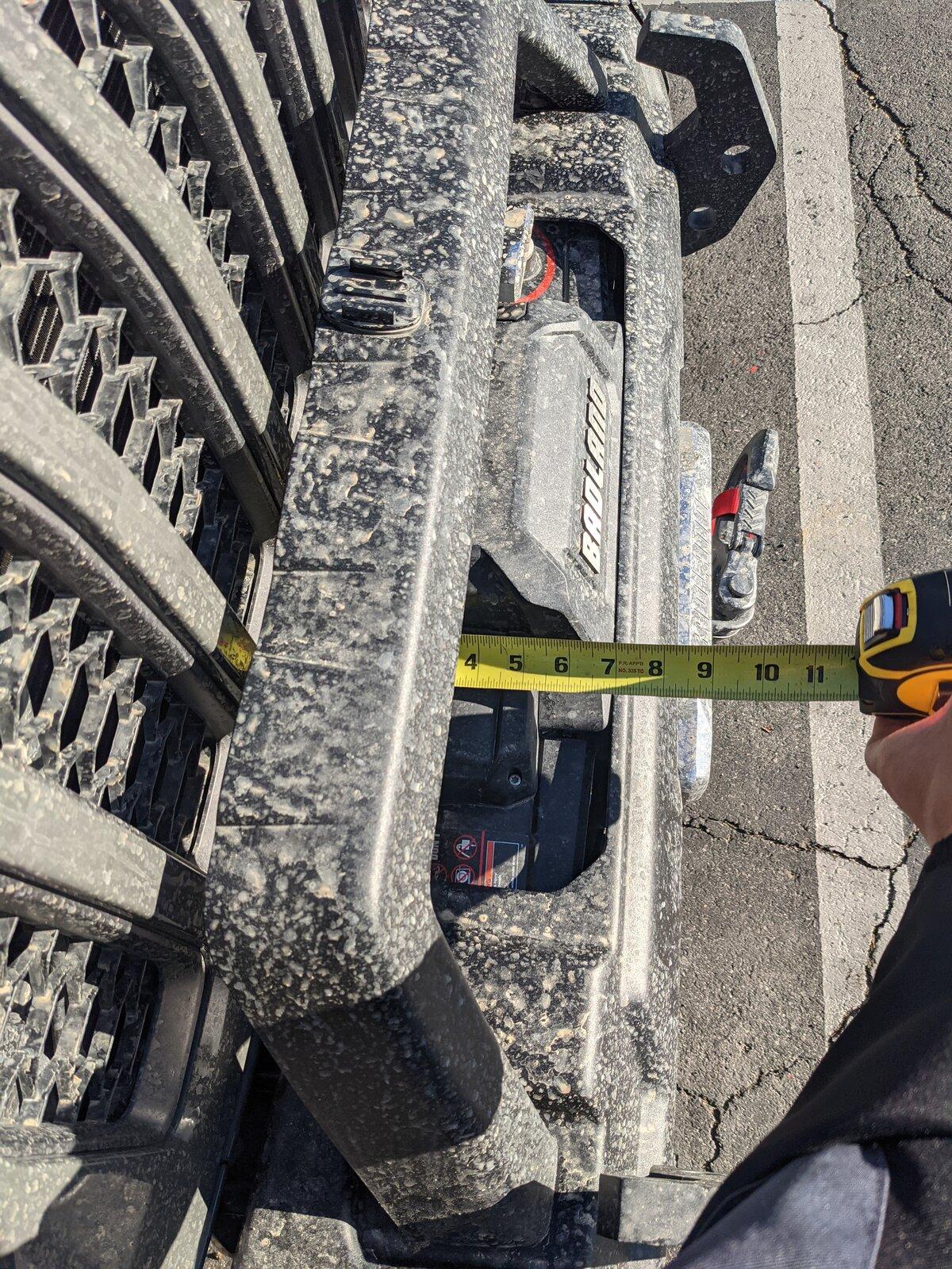

The Venator stubby looks great! Can you do me a favor and measure the distance from the grill to the front edge of the fairlead?
narcoteca
narcoteca
Carlos
Jan 15, 2020
165
91
Riverside, CA
JTJS98 2021
Narquitecto
Almost 9-1/2in

Perfect, thank you! The stock bumper is around 11" from the grill to the furthest point out. I am trying to choose a bumper that will allow me to shave some length off my Gladiator so it will fit in my garage and still keep my cabinets and bench.

oh i got you, yeah the Venator is a little bit tight for this Winch but thank God the superior cover it has a little bit of movement on the brackets so i can move it forward or backward.
