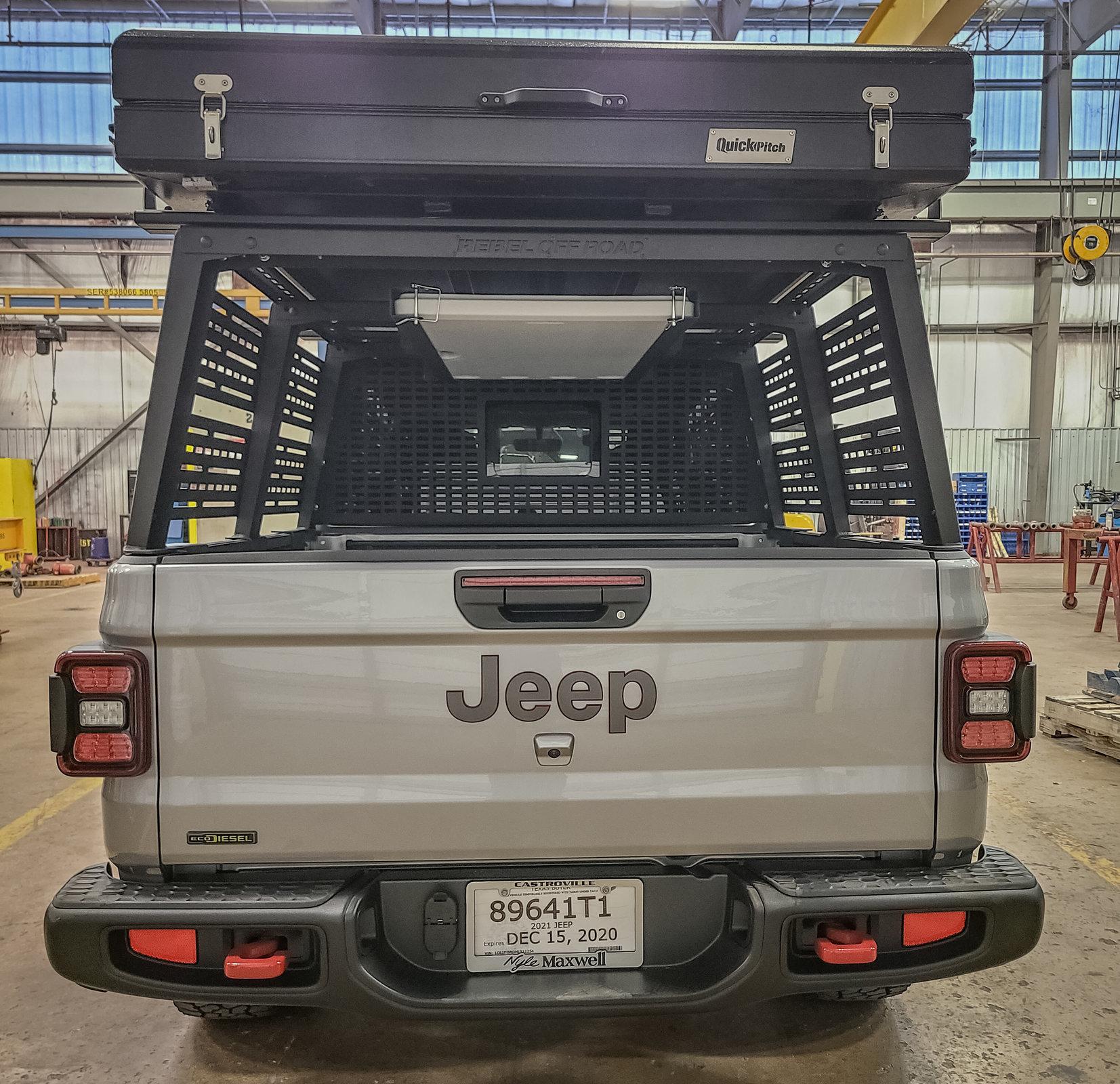

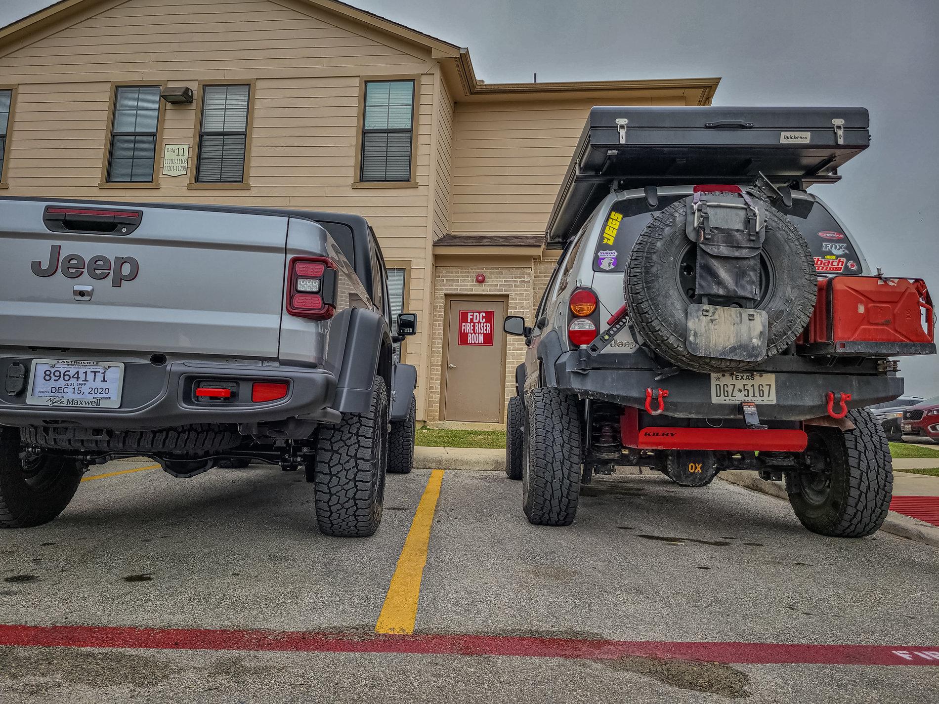

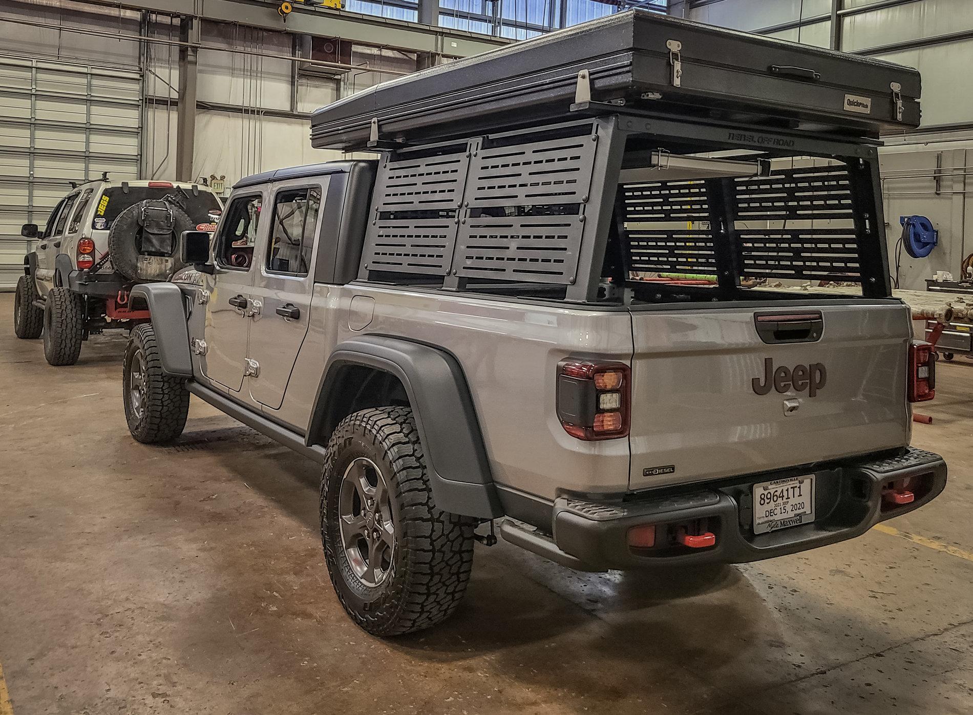

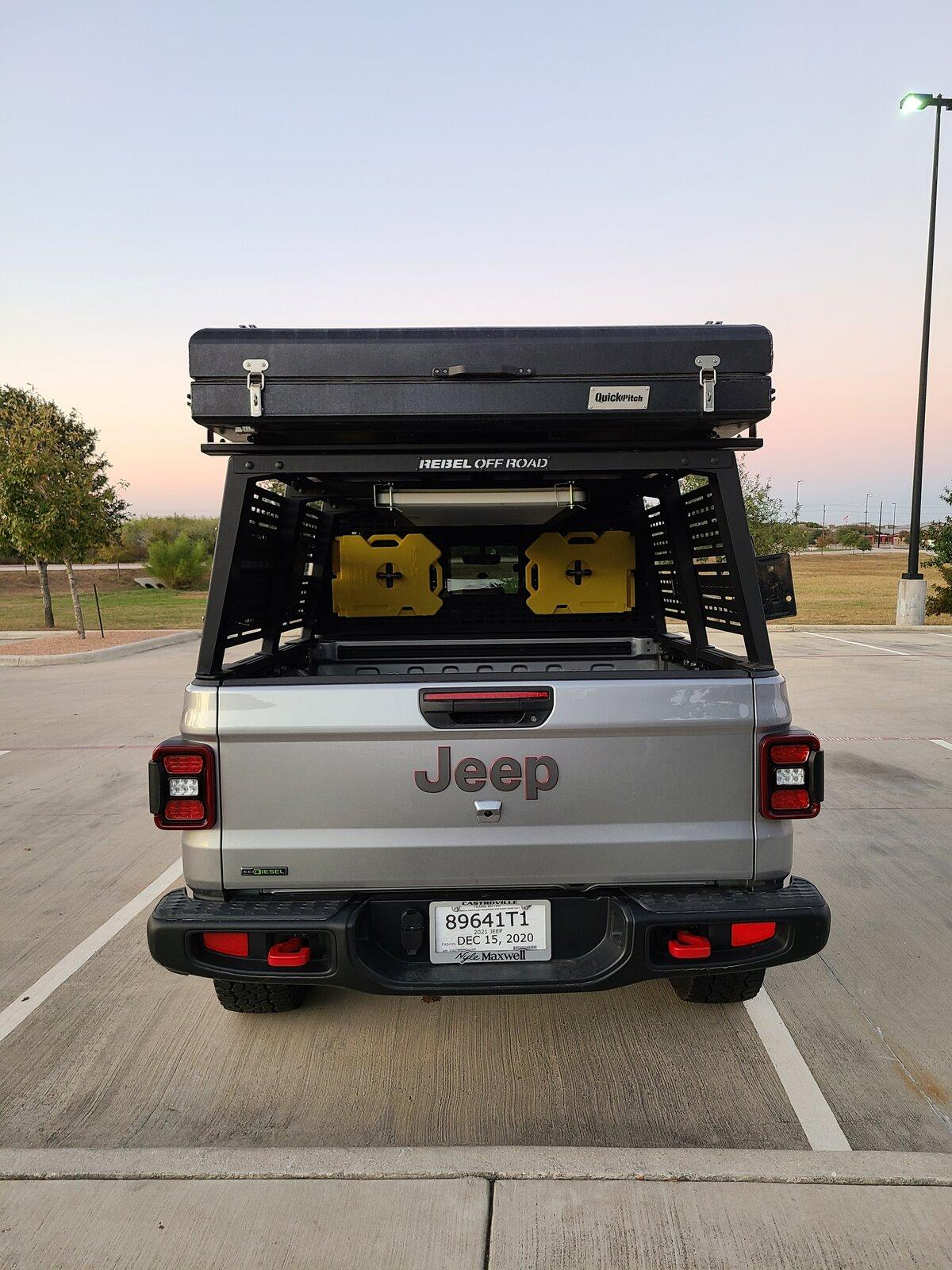

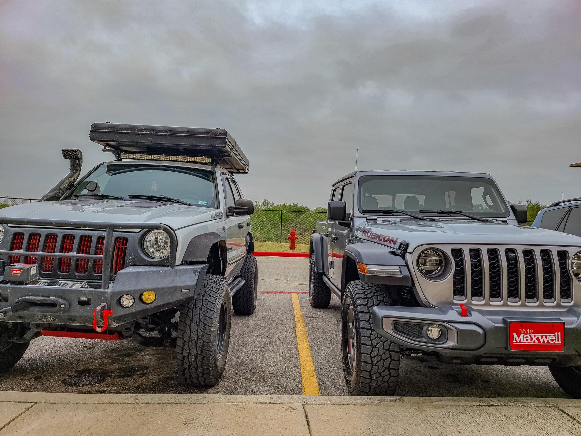

Took her out for a quick photoshoot and the brought her home yesterday and parked her next to the KJ.
Going to put the bed rack on today

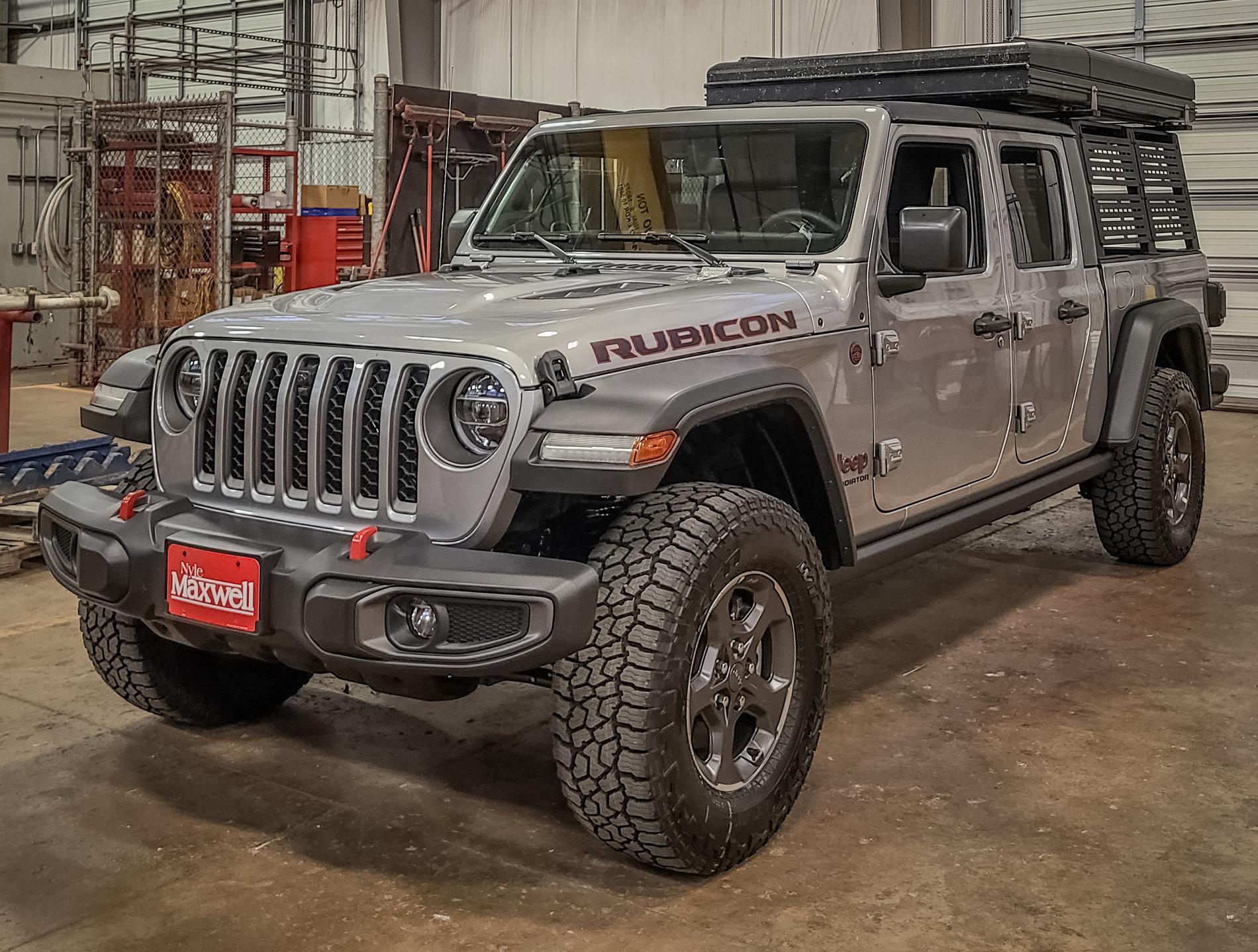

  • #5
Now that is a garage!
how did the rack and tent affect ride height and handling?
I wish it was my garage! Haha. Its my workplace.
Well, I don't really know what to base it off of, because I only drove it one day before installing. Lol. Buuuut, it feels pretty normal with it on there. I dont notice any swaying for anything...I didn't notice any with the tent on my Liberty either, though.
They each dropped me 1/2". So im about an inch under stock height in the rear. The front was unaffected.
Bed rack weighs 165lbs.
Tent weighs 187.

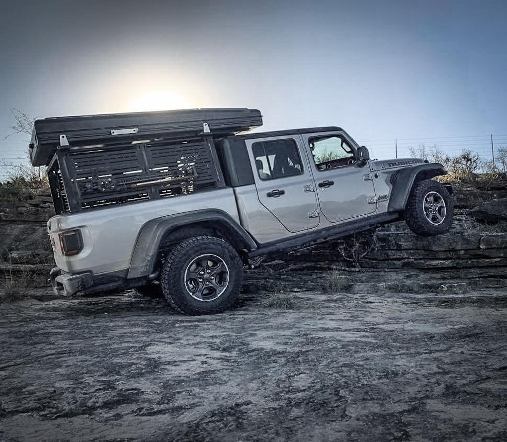

Went for a little day trip to test out 4lo. This thing is stuuuuupid torquey. I didn't even need to apply any throttle for a lot of the rocks

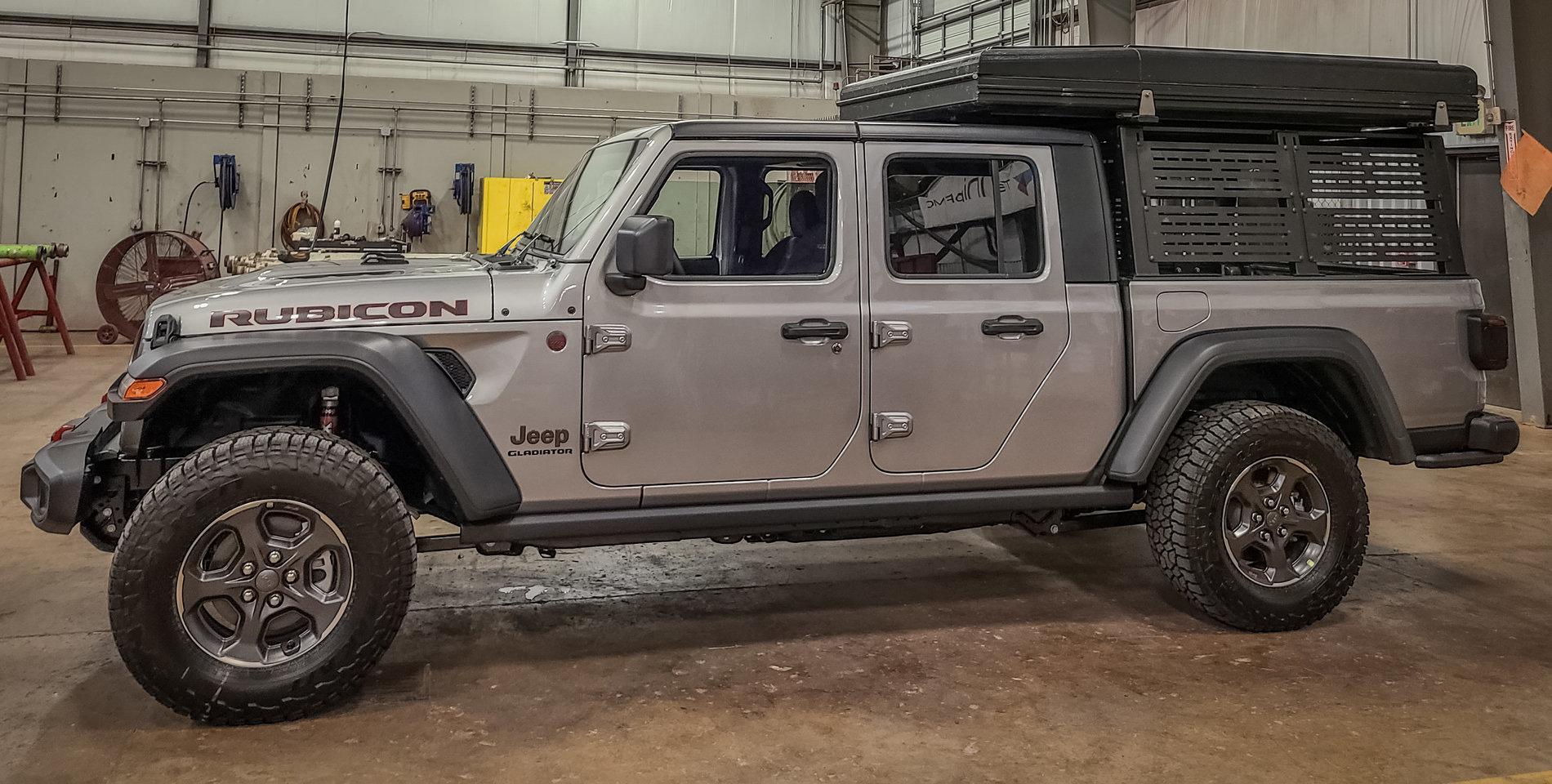

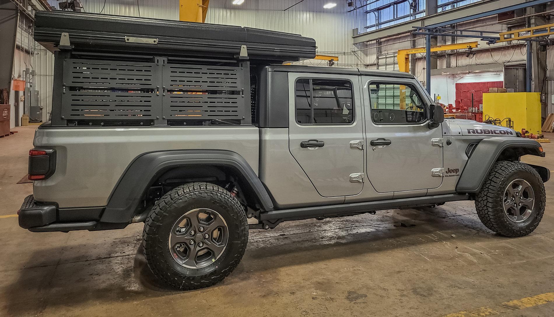

2" Mopar is on and rides smooth so far. I had the dealer do it so I'd get the warranty. Price was $1,989.34
Gonna start looking for some deals on wheels/tires.
Stock specs before lift (rear is already 1" lower due to add-ons):
Ground to mirror driver-- 49.75
Ground to mirror pass-- 49.5
Ground to front bumper-- 19.5
Ground to rear bumper-- 19.25
Ground to rock rail driver-- 17
Ground to rock rail pass-- 16.75
Hub to flare front driver-- 24
Hub to flare front pass-- 23.5
Hub to flare rear driver-- 23.5
Hub to flare rear pass-- 23.25
Jeepasaurus_Rex
Jeepasaurus_Rex
Aug 21, 2020
145
219
San Antonio Texas
2004 Jeep Liberty KJ --- 2021 Gladiator Rubicon - EcoDiesel
  • Thread starter
  • Thread Starter
  • #12
Here are the after measurements:
Ground to mirror driver-- 52
Ground to mirror pass-- 51.75
Ground to front bumper-- 21.75
Ground to rear bumper-- 21.5
Ground to rock rail driver-- 19
Ground to rock rail pass-- 19
Hub to flare front driver-- 26.75
Hub to flare front pass-- 26
Hub to flare rear driver-- 25.75
Hub to flare rear pass-- 25.75

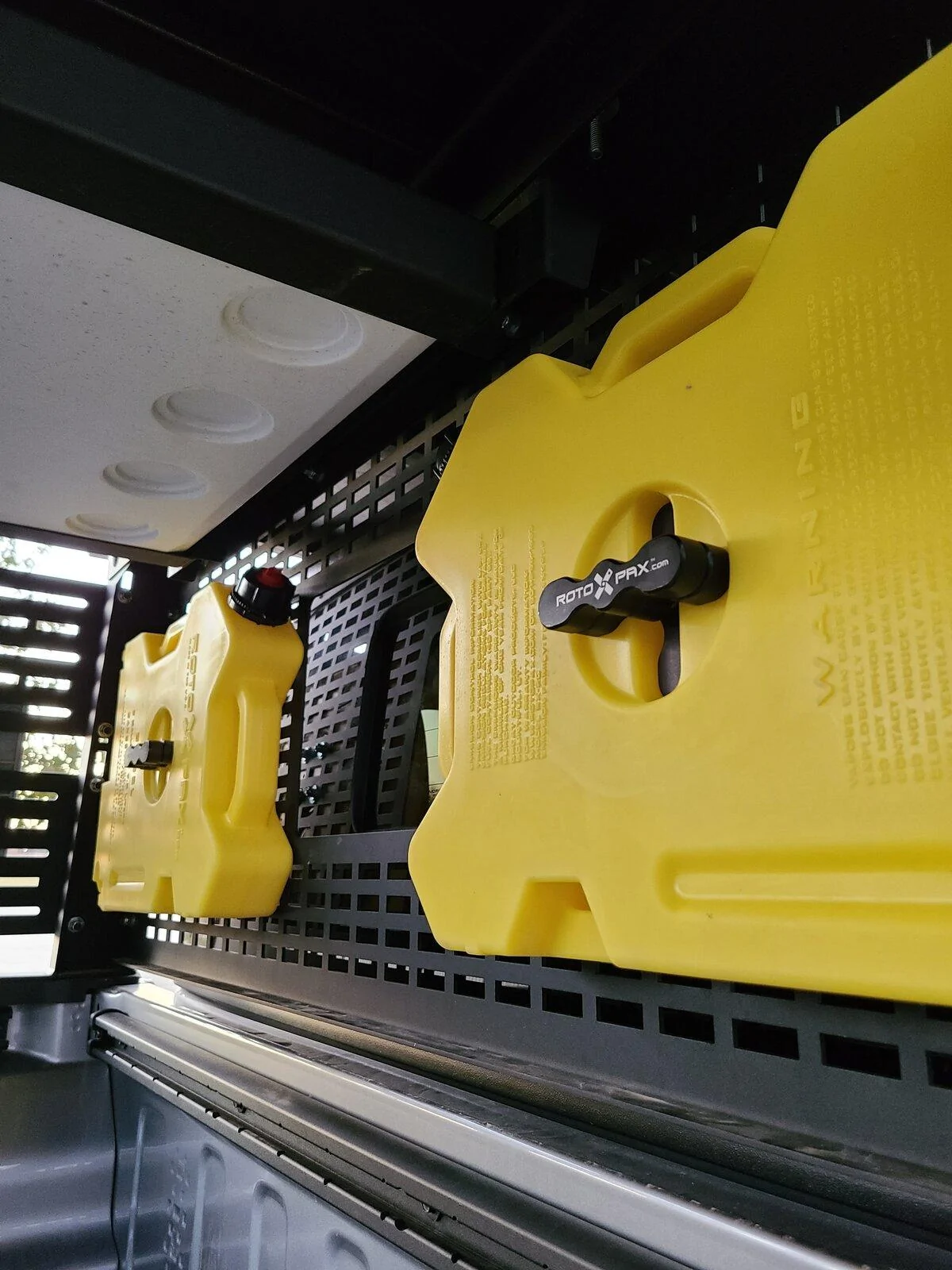

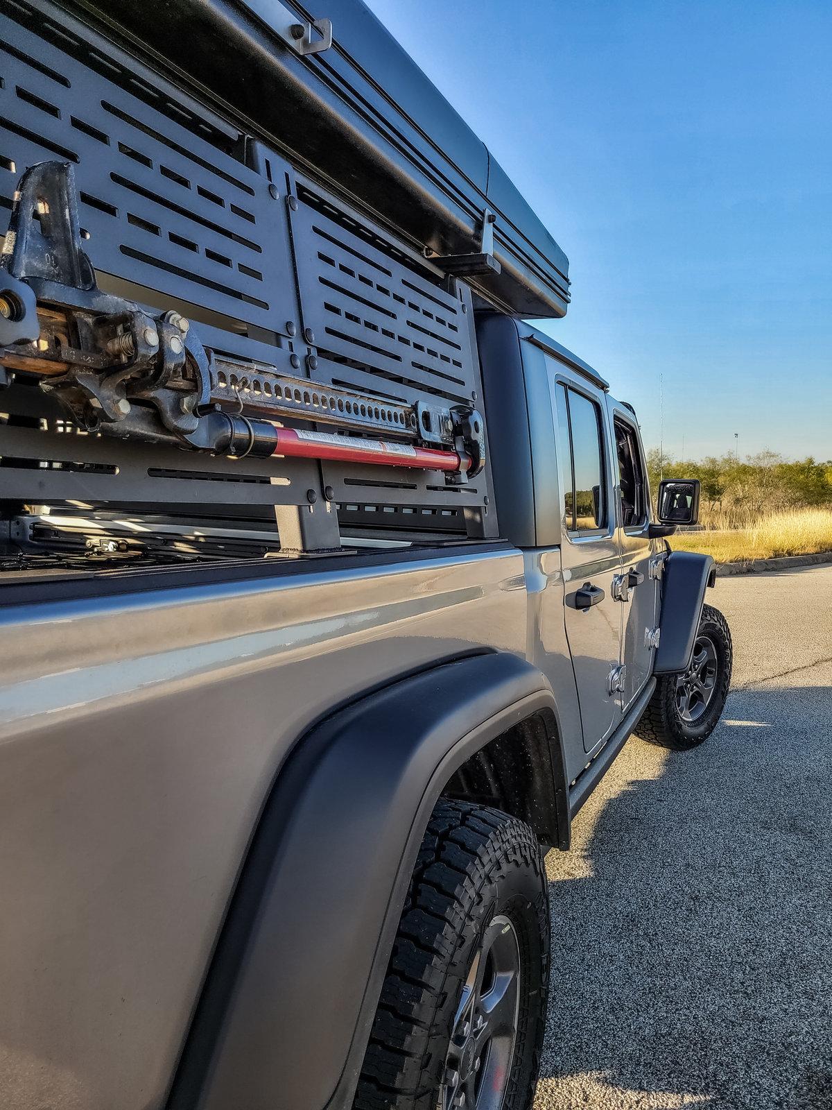

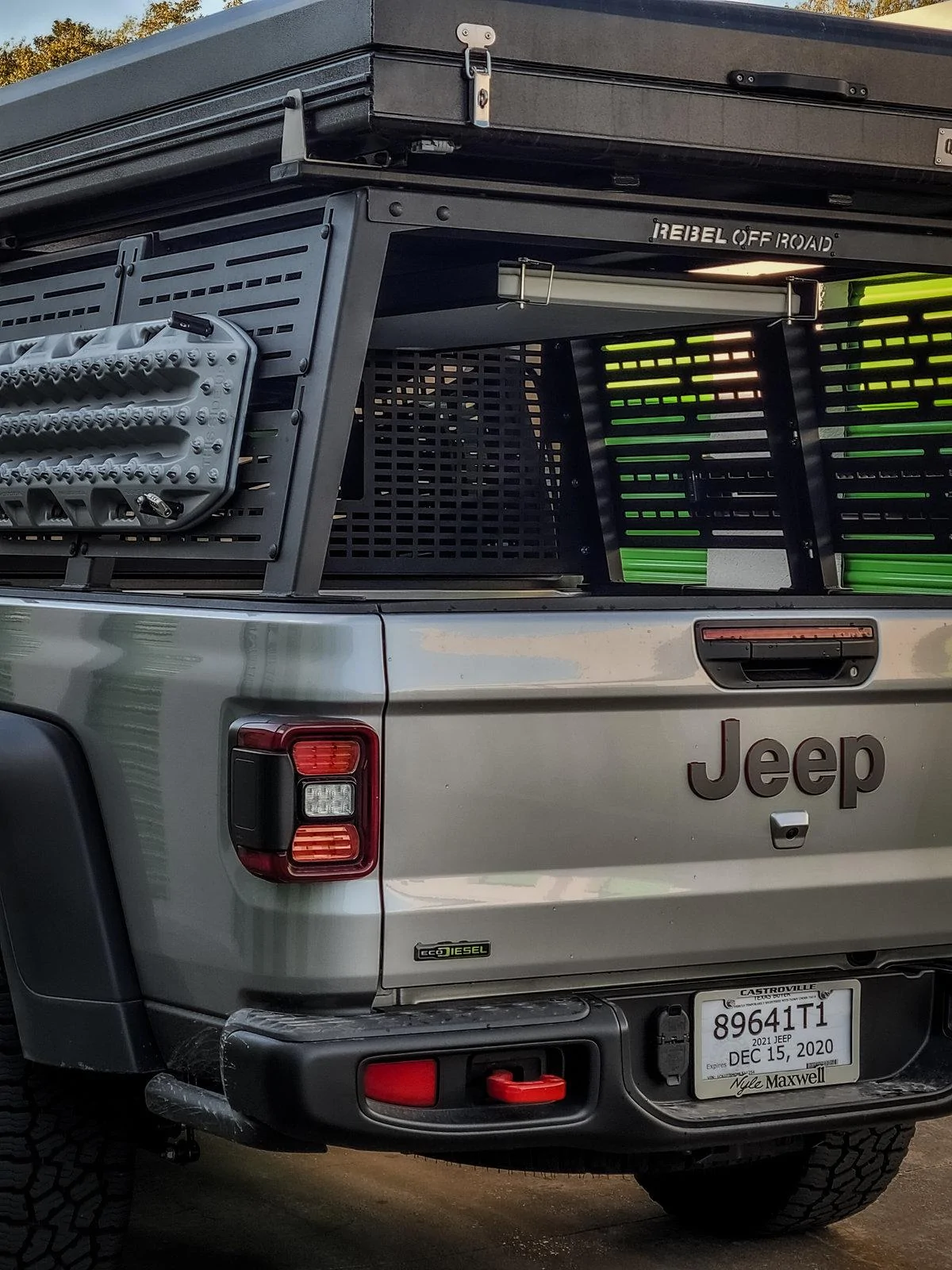

Also got my rotopax mounted up

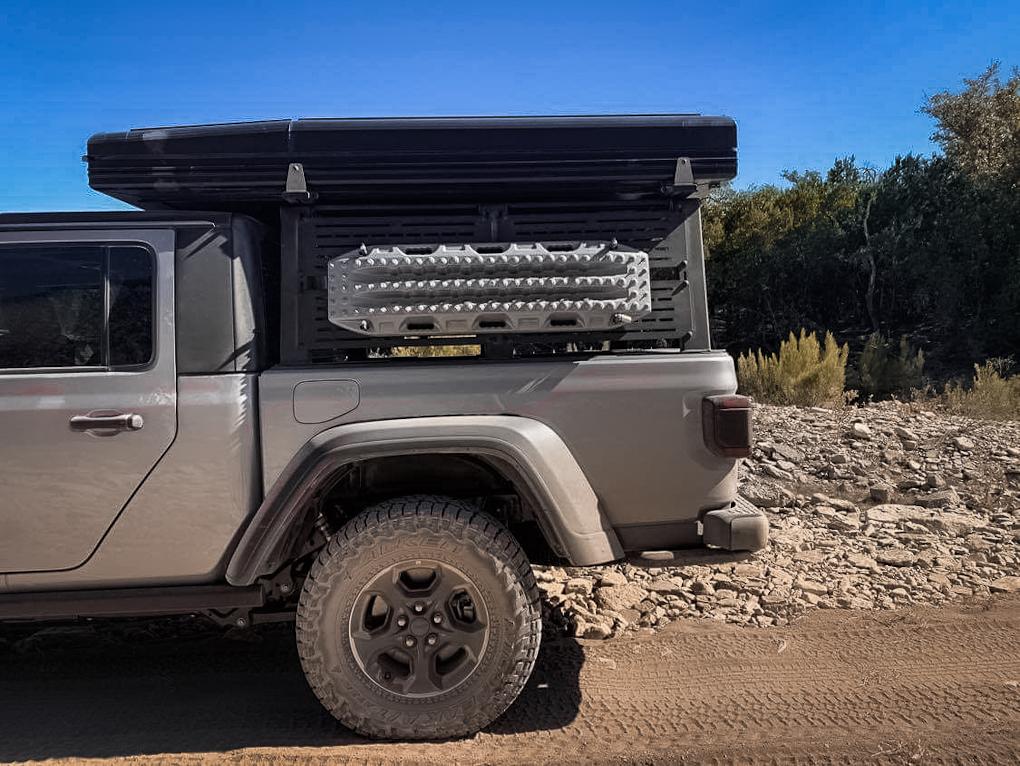

We hit up the East Texas 450 trail this weekend. It was a blast! Found out real quick that the Falken AT's don't do very well in the sticky mud...but that will be corrected soon!
