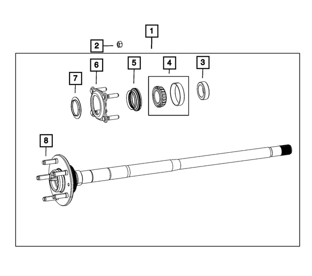

Guys just want to confirm:
had my re gear done and seal started to leak if I replace with PN 68474264AA I should be ok?

Without looking, that sounds like the axle shaft assembly that dealers are using. It's the assembly, not just a seal, etc.
Does MOPAR even list the seals and bearings alone yet?
Interesting that the parts books show only the whole shaft assembly.
I know the shops do it that way because of the pain in the butt for them to spend time removing a bearing, and pressing a new bearing and retainer on, etc. but end users like me would go buy the seal and bearing set and re-use the same axle shaft (as long as I found the shaft to be undamaged)

Just picked her back up. Replaced the axle shaft part number 68471168AA fingers crossed!
I see from the diagram that the axle includes the seal and bearings.

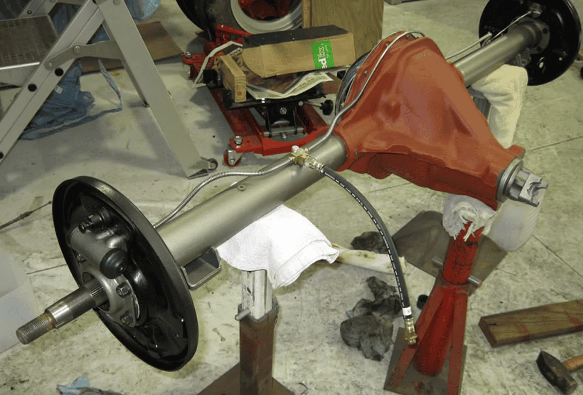

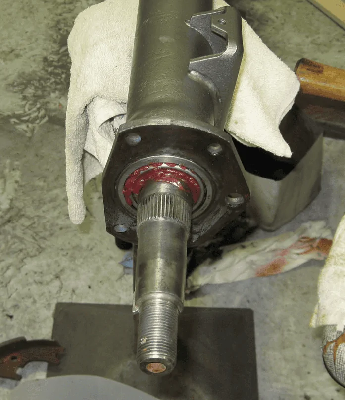

Likely not - and I'd sure not want any of them working on anything like this - with inner and outer seal -
Jeep Gladiator Leaking axle seal? 1661125910068
Jeep Gladiator Leaking axle seal? 1661126069825

Boy howdy!
I suspect there's a few things we've both worked on and have in common.
I can't even remember how many of these I did - the one in the pics was one I restored.
You recall the 2 piece axles, the hub nuts that took 250 lb/ft of torque..........

Yep. I was an Ordnance Vehicle Maintenance Officer (WO1) in the Marines after spending time as a tracked vehicle mechanic (Sergeant). There were some huge torque values on Amtracs. I learned that PM can save your life. I saw that in action in Vietnam. You don't want a tractor to die when you're taking fire. I became known as "PM Shackman" although they didn't say that to my face. I had that CJ-5 for 15 years and never had a breakdown. It got me through grad school traveling all over the Southwest and northwest Mexico. Stuck a few times, but never broke down. Using the GI Bill I left maintenance and went into geology, but I still adhere to the PM mantra: "Do it now, or pay later".
