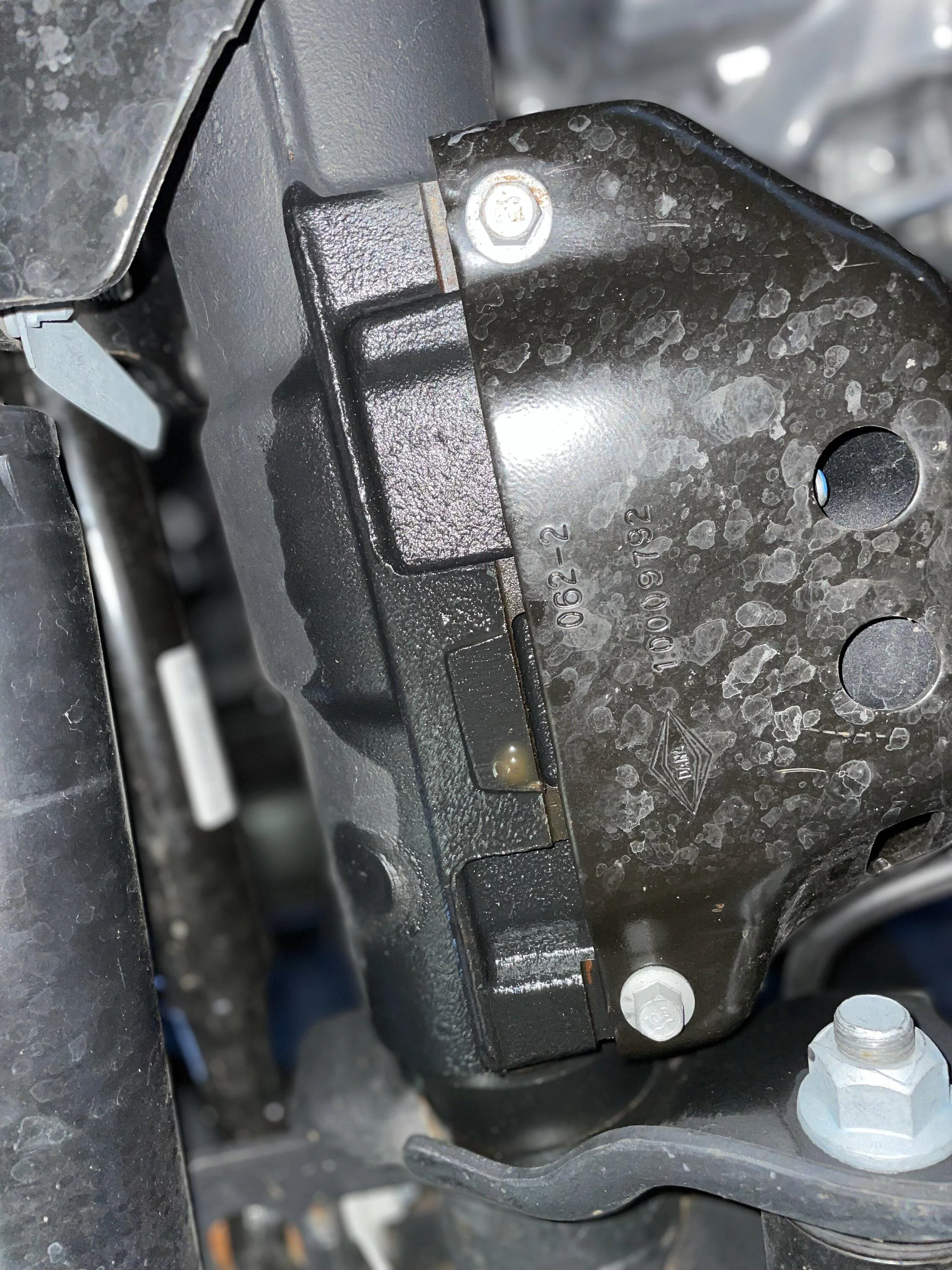

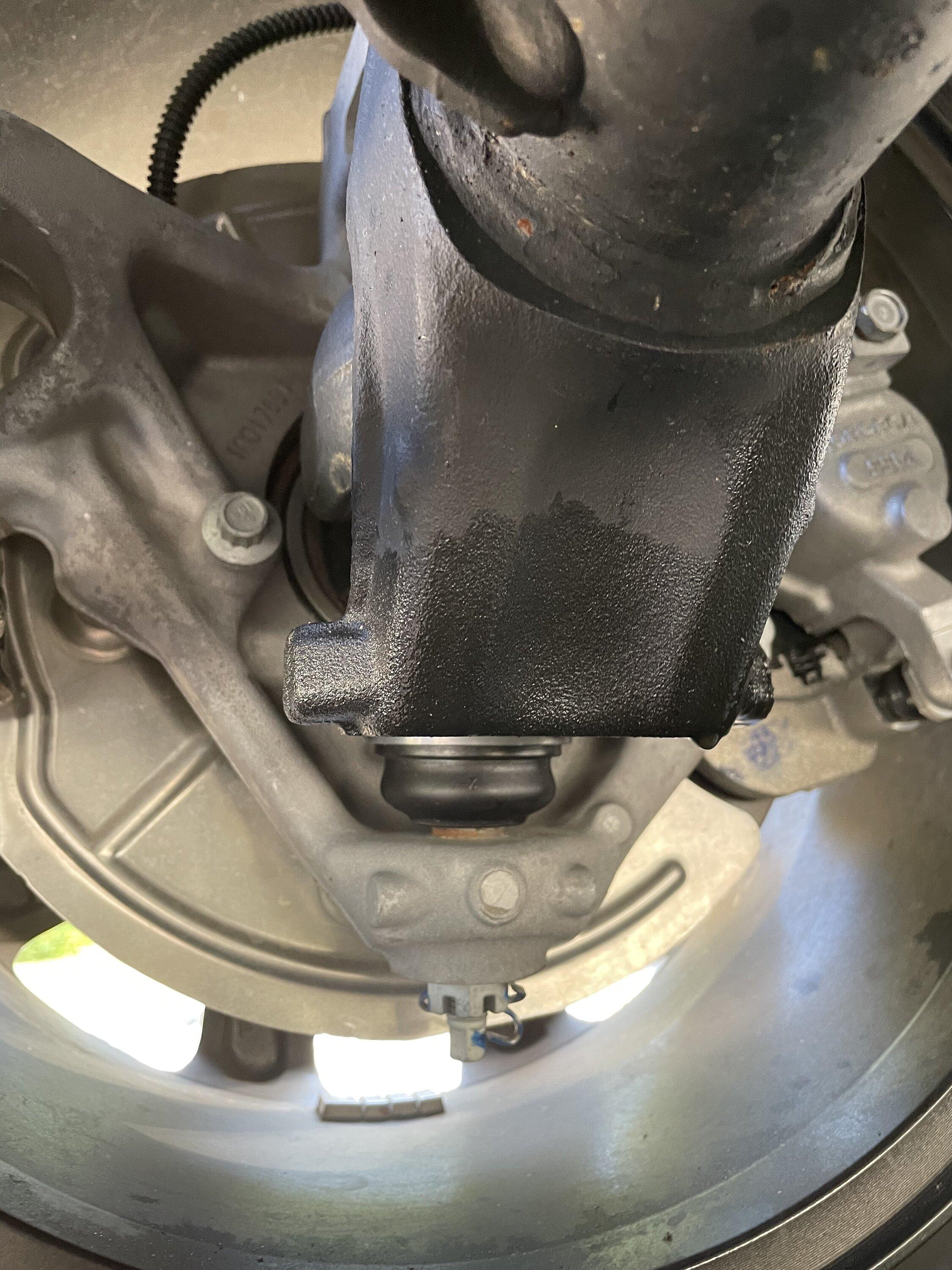

I’m guessing this is a blown seal? It’s the front passenger side
2022 altitude 3.6 1600 miles built 3-22
Jeep Gladiator Leaking axle seal? 5692C19B-4FDC-409F-B502-95692BF0DFA3
Jeep Gladiator Leaking axle seal? 7BB49926-C1C2-433E-8F23-0D5F6BE1950A

Looks like it's leaking from the FAD.
His top pic is definitely an axle seal - that's the steering knuckle and the lower ball joint in the pic. Lube on the ball joint coming from the axle above.
Agreed. That's rare to have both leaks like that.

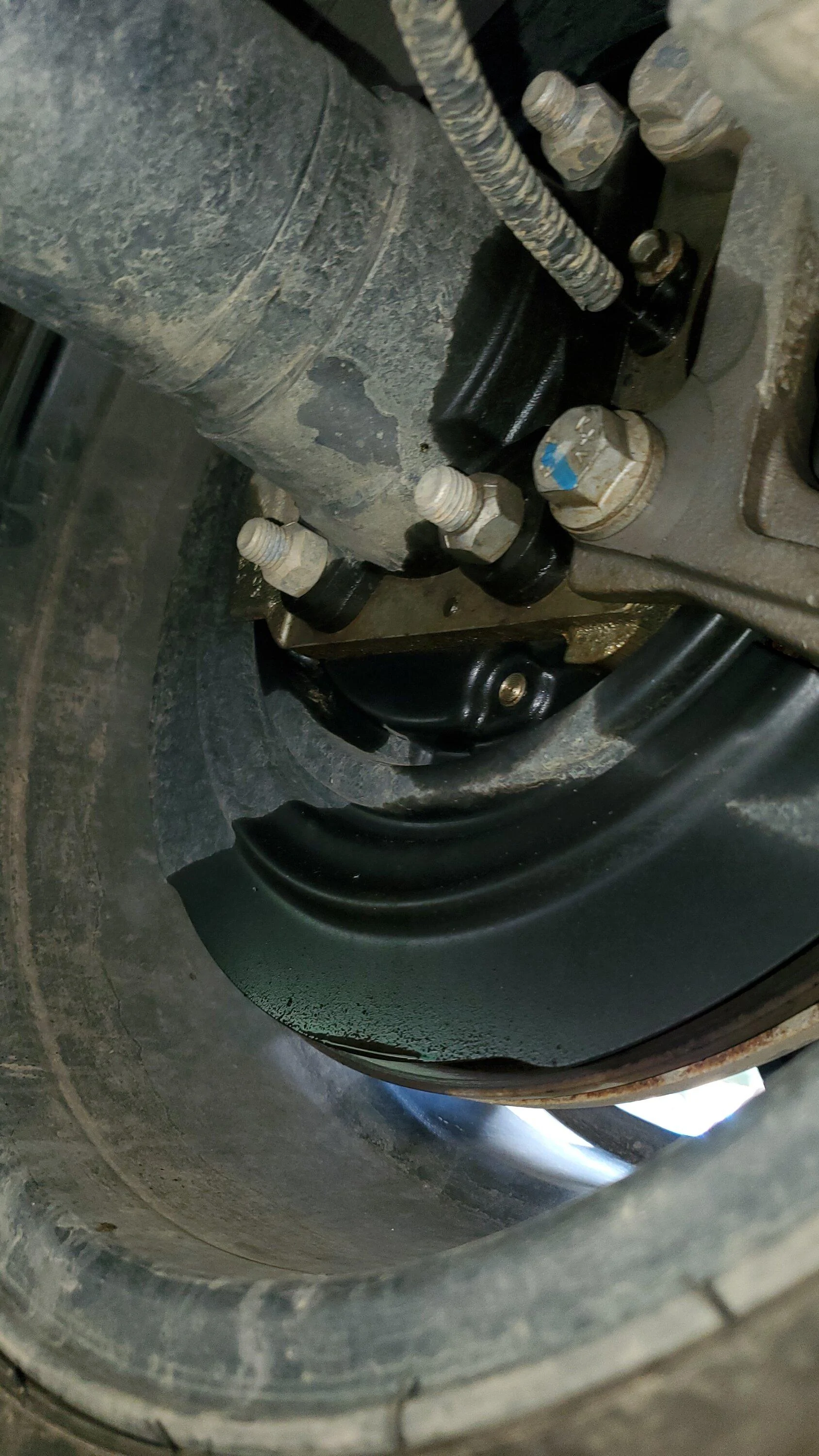

Rotated tires today on '21 Mojave built 6/21 and found oil on wheels. Going in Tuesday for inspection. 26,303 miles. It happened in the last 3000 miles. Picture is after I rotated wheels.
Update 9/27 - Brought in for assessment. Indeed it needs an axle replacement. Dealer will have one in-house tomorrow. Part #: 68474264AA
Jeep Gladiator Leaking axle seal? 20220920_151815
