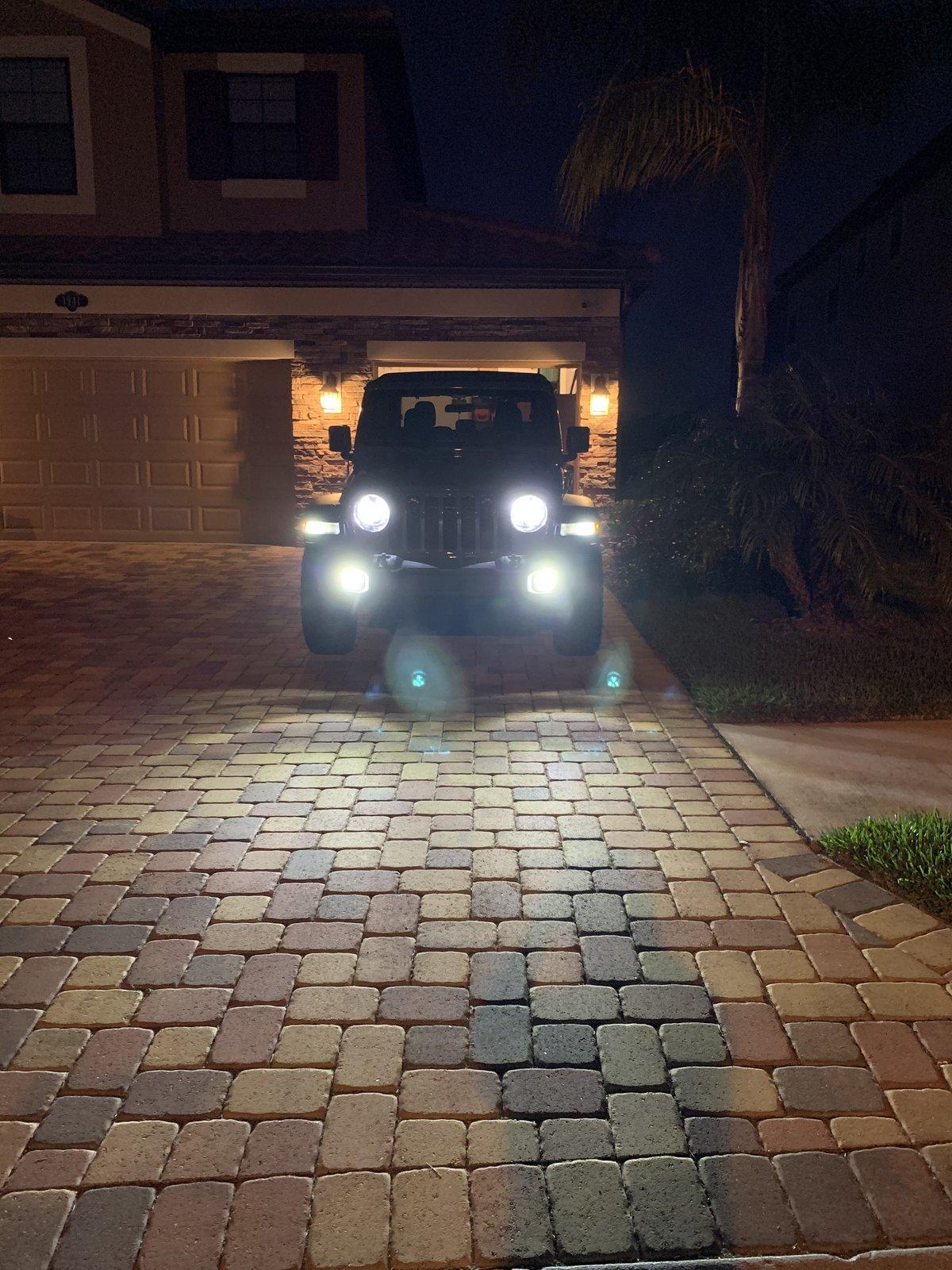

Amazon LED lights. Awesome look and light for $100!!!

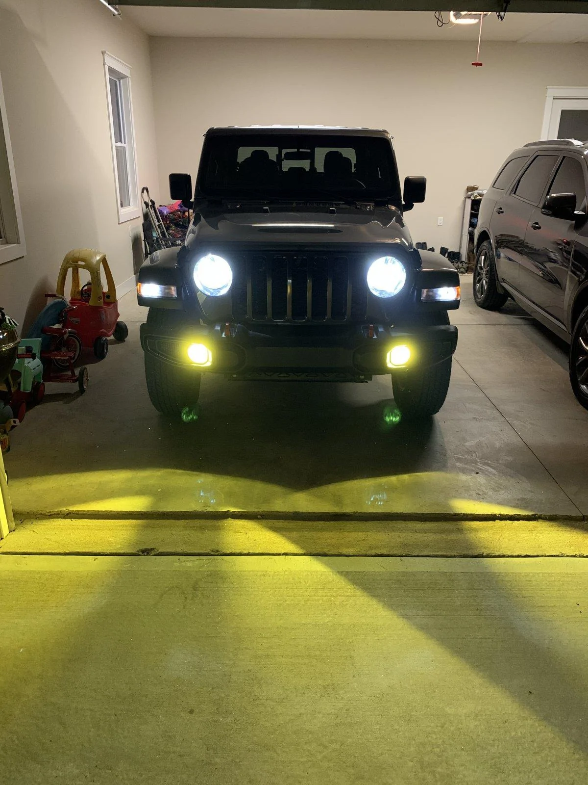

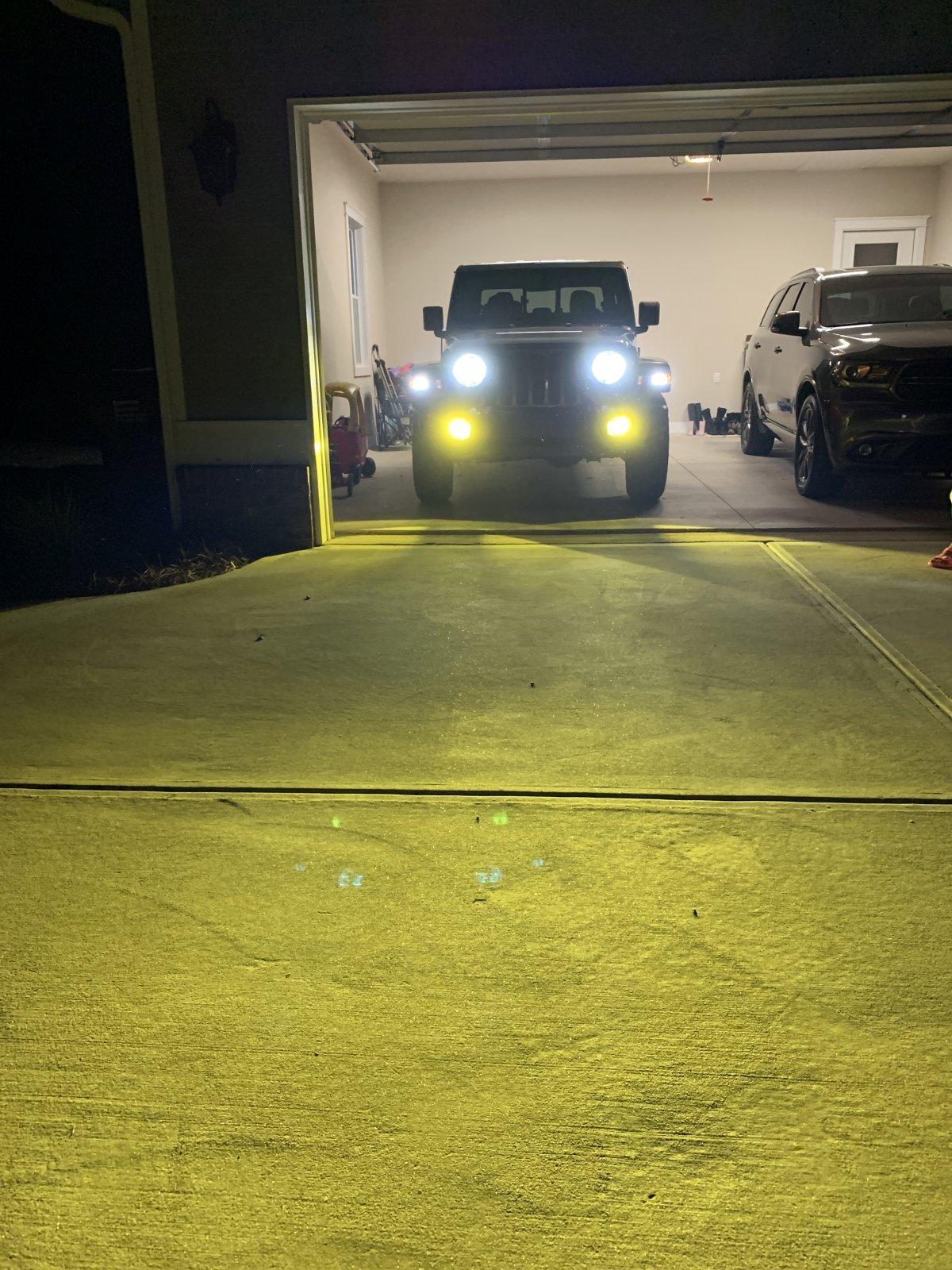

Well, almost two months later and I finally got all of my bulbs from HR. The Supernova headlights are AMAZING. The fog lights have been in for about a month, but I rarely drive at night anymore to use them. So far so good for the handful of times I’ve used them. Now that everything is in I am very happy. Hopefully they don’t let me down!
