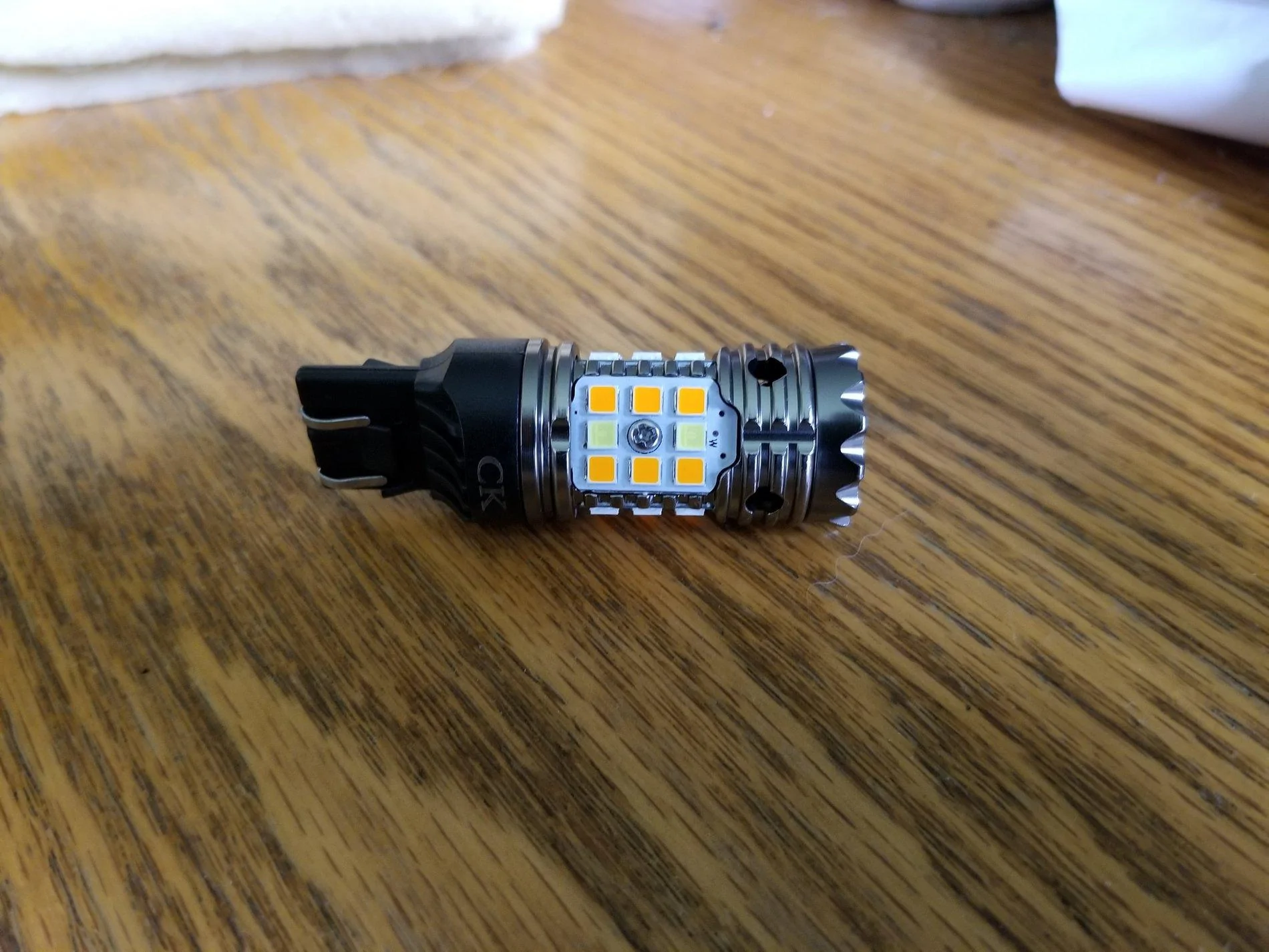

anyone that has a gladiator without led's and wants to upgrade the front turn signals and running lights check out headlight revolution website and order them now.I just installed these in my sport s and they are awesome.the lights light up a nice bright white color and switchback to amber for the turn signal and they are plug and play with no issues.
I just got my order, same ones you ordered, the Running Lights light up as the Amber color, Turn indicators are the Amber color which is correct. Wondering why I can't get the running lights to light up in the White!? Did you do something to solve this problem or did your automatically light up white? Tried all of them and none light up white, grrrrrrr...
i bought the switchback ones that light up white for the running lights and then they turn amber when you use your turn signals.they worked correct right out of the box.did you buy the switch back ones?
The package does say Switchback on the back. The package says: Carbide 2 LED Replacement Bulbs for turn signals and marker lights, and the label on back lists them as Carbide2 CAN BUS Series 7443 LED Bulbs-Switchback. Here's a pic, when they came I looked at them and wondered where the White would come from since only seeing yellow and orange diodes, do you recall if yours had white diodes or look exactly as the pic I attached? Thanks for your input! I have already emailed LR about all this.
You might try turning them around or something. Seems to be some weird polarity issues with all these LED bulbs in Jeeps. Like the PWM issues we’ve discussed in here.
Yeah, I turned them around once since they didn't come on the first time. Thanks! We shall see what Headlight Revolution says on Monday. This is my second go at LED's, the first set from Jeep Federation wouldn't even go in the stock sockets, they said I should shave them down to make them fit, I told them to go pound sand in their ass and returned them. There's a couple things I like shaved and doing it to LED Connectors is not one of them!
