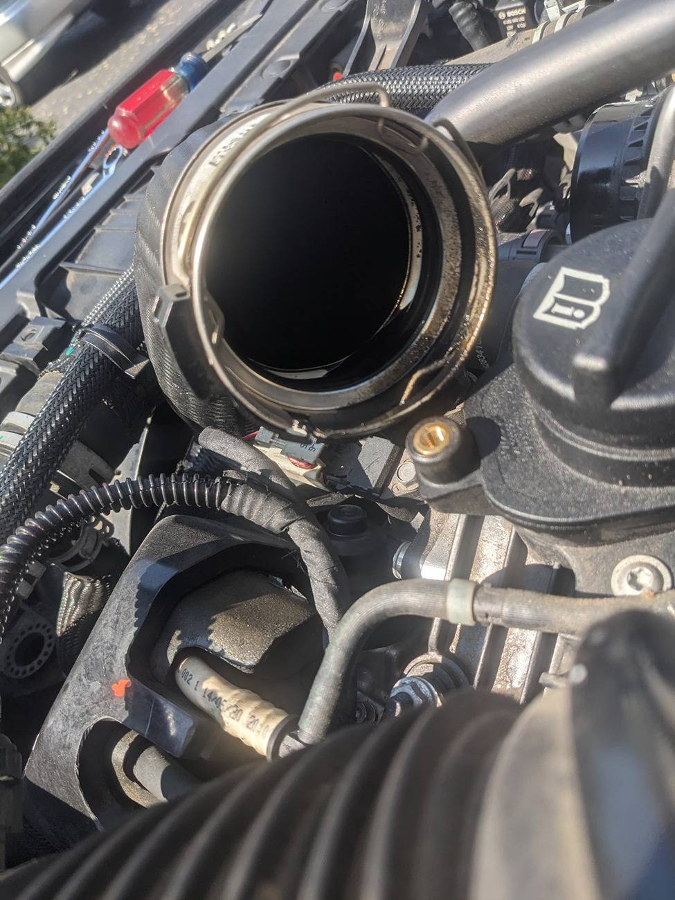

So curiosity got the best of me. At 16psi in 25 mins I lose a lot of the pressure. Coolant tank cap is 21psi.
That was this past weekend.

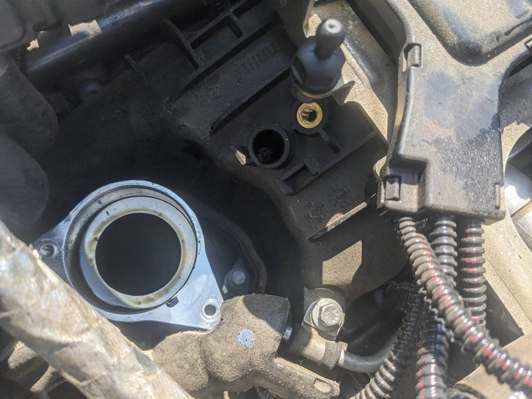

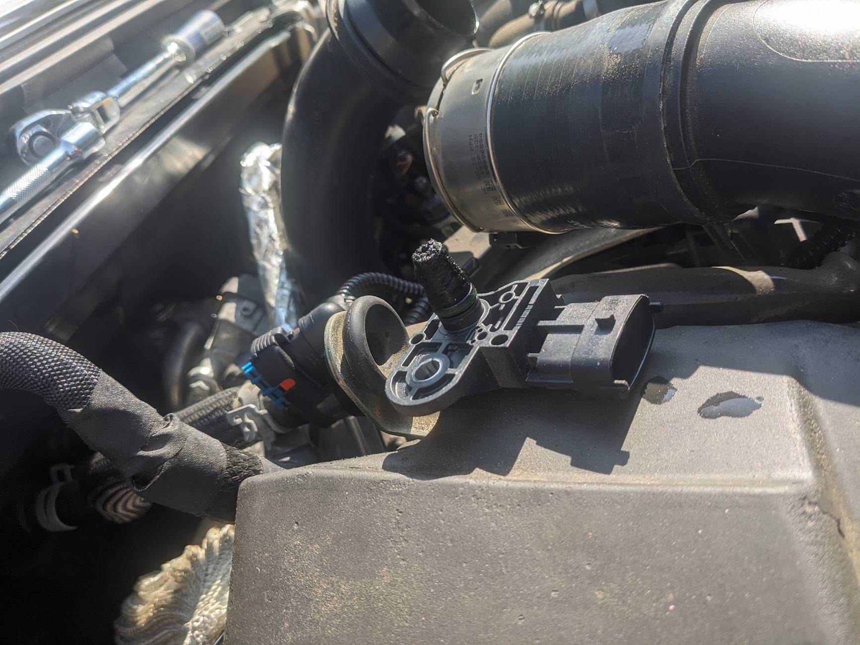

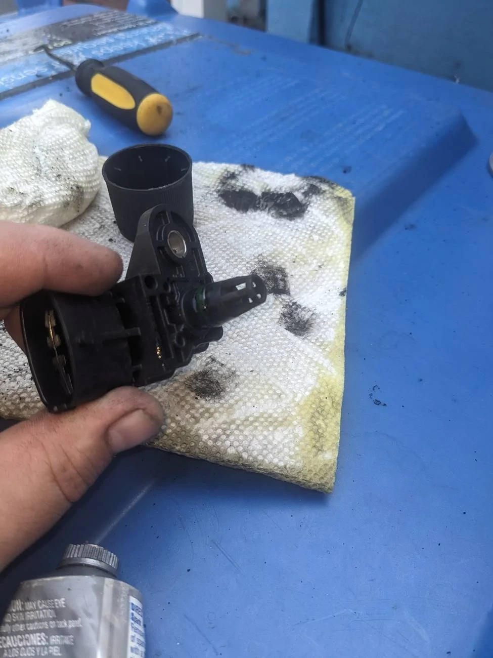

Today because my fuel economy didn't make sense I decided I would clean my maf and map. Um not good things were found.
Now I am going to go back to the original dealer before I go anywhere else and have a long conversation.

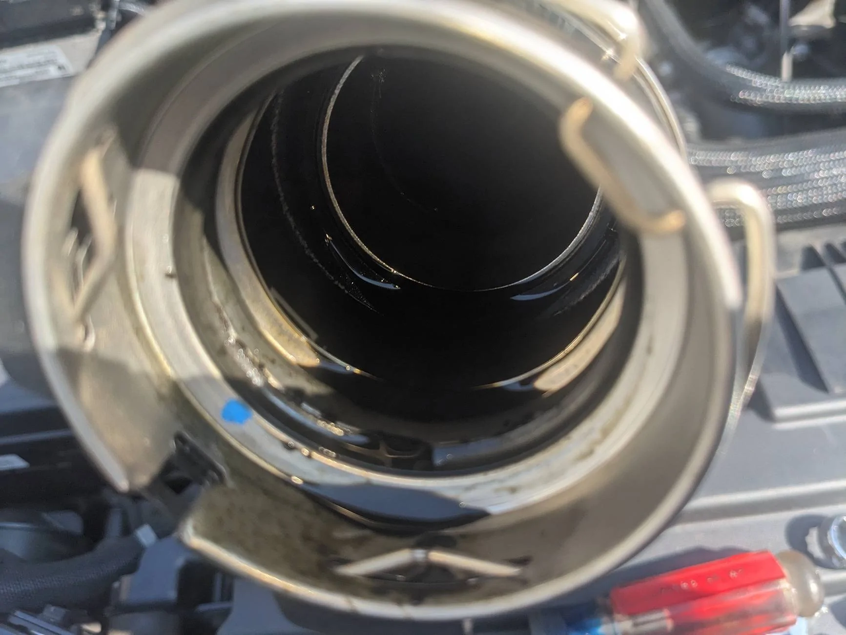

Basically Manifold Absolute Pressure Sensor was completely plugged. This should have set a cel the fact it doesn't is concerning and indicative of poor engineering. Because this doesn't set a code (likely because Jeep knew there was a sooting issue) it slowly causes the engine to run in ways that make the turbo produce more boost. This causes a high load pressure differential on the seal for oil for the turbo. This causes the turbo oil seal to fail. When this fails oil is sent through the kntake towards the engine. It normally fails slowly. This slowly fills the charge air cooler aka cac with oil. It also causes the engine to burn that oil. That acts as added un metered fuel. That causes excess soot. Excess soot causes EGR plugging, injector tip fowling, worn piston rings, worn cylinder walls, dpf soot loading with frequent regen requirements. More frequent regens also means more soot loading and earlier dpf replacement. It also creates a more biased map sensor making it worse and worse. Now you have soot and oil combining. This causes something the equivalent of an abrasive tar. It sticks to the inside of the intake plenum, intake throttle valve, and valves. If it hardens it becomes like asphalt. Now add trans is slipping some in first and not shifting correctly because the engine at a certain rpm is expected to have a particular torque and it does not because of the increased boost pressures. This causes clutch sheering removing more friction material over time.
Basically I am rather sure I got a lemon and they knew it was one when they sold it to me. They also did an oil change without doing the fuel filter. Now add the fuel pump tick and valve train tick on overnight start ups I am hearing and vibration in the front and rear at speed.
After cleaning the MAP sensor. It looks a lot better. Engine runs a little better too.

Oh I forgot to mention a CAC (charge air cooler) full of oil can cause your engine to run away and blow up cause it runs off the oil from inside the CAC and they likely didn't program the intake throttle valve to slam shut on key off. (Yes this is assumed, but assumed that way for a reason) That is if people even think to shut it off. Happens on hills ir hard turns normally. Also turbo seal isn't going to heal itself and can cause the same issue.

So an update. I had this at 2 different dealerships and an independent shop.
None could find the coolant issue.
I replaced the coolant cap and it was fixed.
Yes, not a single person in all 3 shops checked the coolant cap.
Which is also baffling because I was loosing pressure when pressure testing before even have video of it and I soapy water tested my pressure tester.
My independent shop was thorough though even running it under 21psi pressure and running a regen on it.
Excess oil getting into the CAC was strictly from the clogged MAP sensor. It wasn't seeing pressure so it was overboosting causing the seal in the turbo to leak. After cleaning it is now within turbo oil bypass spec.
Aka a tiny bit which is normalish still shouldn't be that way imho but, even big rigs pass a tiny amount of oil any more even though old ones before EGR/DPF/SCR never did. It's due to the excessive back pressure from all of that in the exhaust systems. It should be a film what I had before was way more than that tho.
