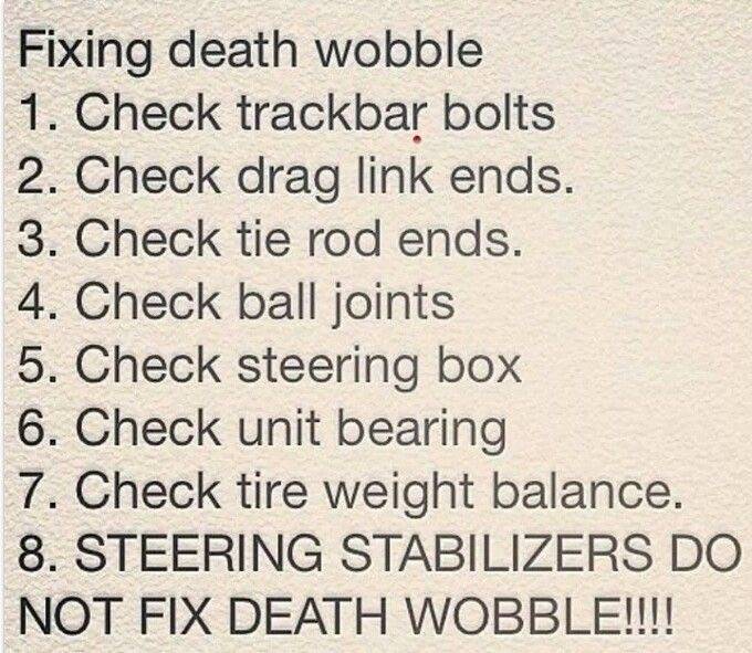

Jeep Gladiator looking for help - re wobble IMG_6023
Only other thing I have found is loose control arms or bad control arm bushings.
Good luck!
