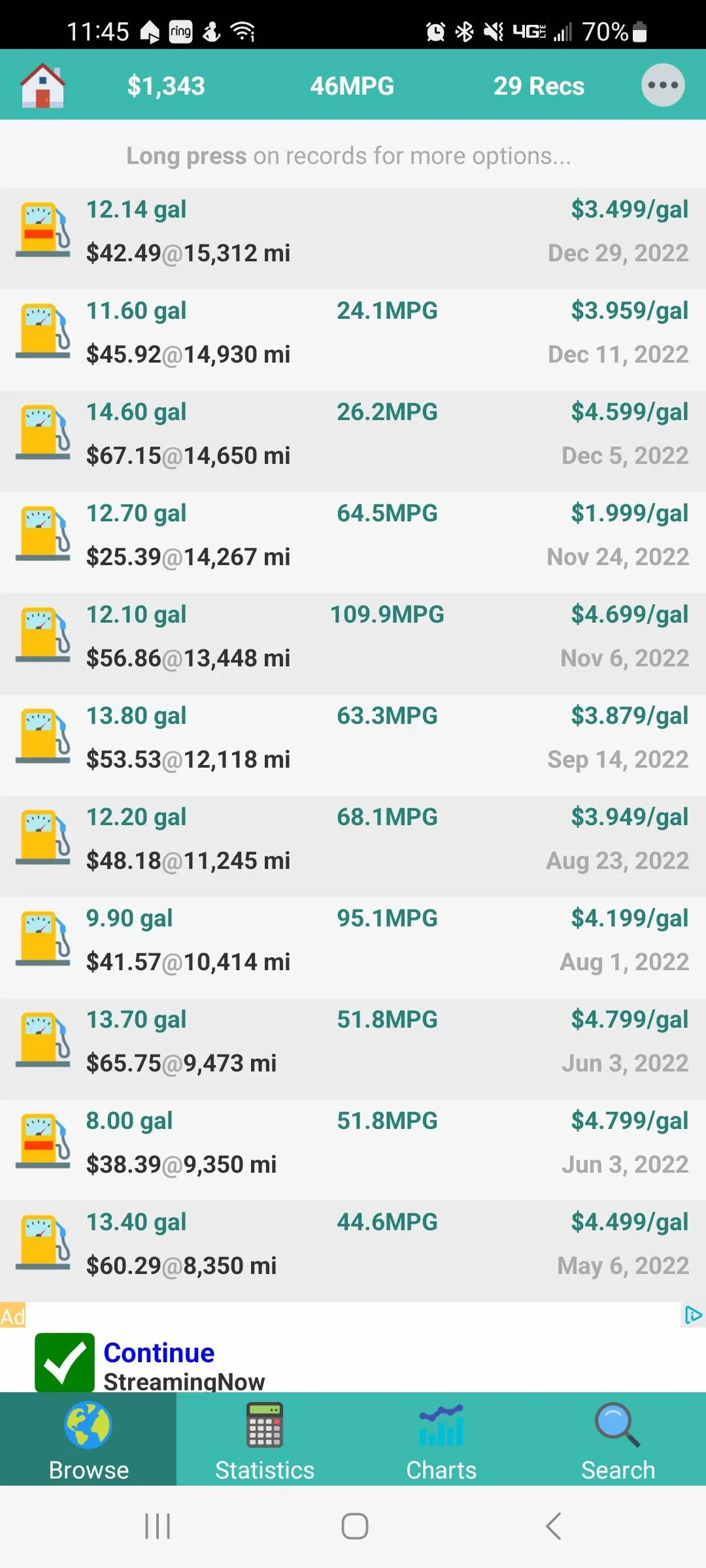

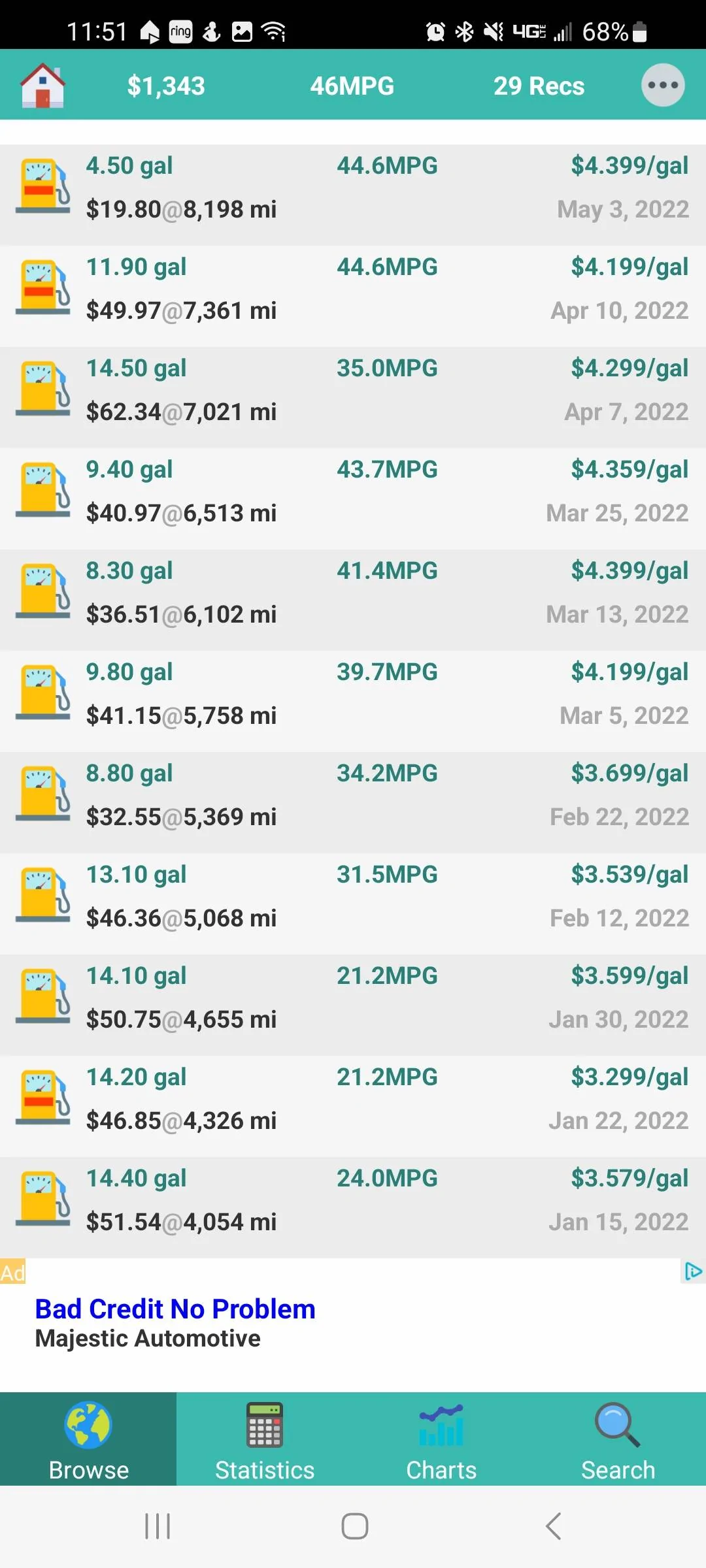

I've got both a 2021 Gladiator Sport and 2021 4xe sahara. The 4xe is the wife's daily driver, but when we're together we always take her 4xe for short trips.
Looking for real world experiences, first hand, not "I heard" or "it looks like. It's fast as hell, we have the sahara so leave it in full time 4x4 auto, which unlocks additional power and makes it just stupid fast for a jeep. I love switching modes and sometimes recharging on long highway drives to have electric when we get into town. Mileage is much worse in winter (-30%).
Reliability? Have only done the recalls, but never actually experienced any of the recall problems. Do get the fuel refresh message which locks out use of electric mode, but that's actually a feature and I traced that to the use of e88 fuel. Now we just use midgrade in the winter, no problems since.
Real-world fuel economy?
100% dependent on the length of your trip and how you manage your modes. Long story short,
-leave it in hybrid and take less than 30 mile trips. 40mpg,
-leave it in electric and take less than 20 mile trips. 100mpg
-any mode and drive until you empty the tank. 21mpg
My actual mileages are attached. You can see those 100+ were probably times in the summer where we went a month all on electric, those 20+ times were probably a long trip to the shore with only one electric charge or less. So, if you never charge, expect to be in the 21-23 range, if you
Battery life? Summer 20miles. winter 15 miles.
How far can travel on tank of fuel? depends, each of those calculated mileages I attached was one tank or gas, probably filled up when the light came on. With no charge probably 250-300 miles depending on driving type.
