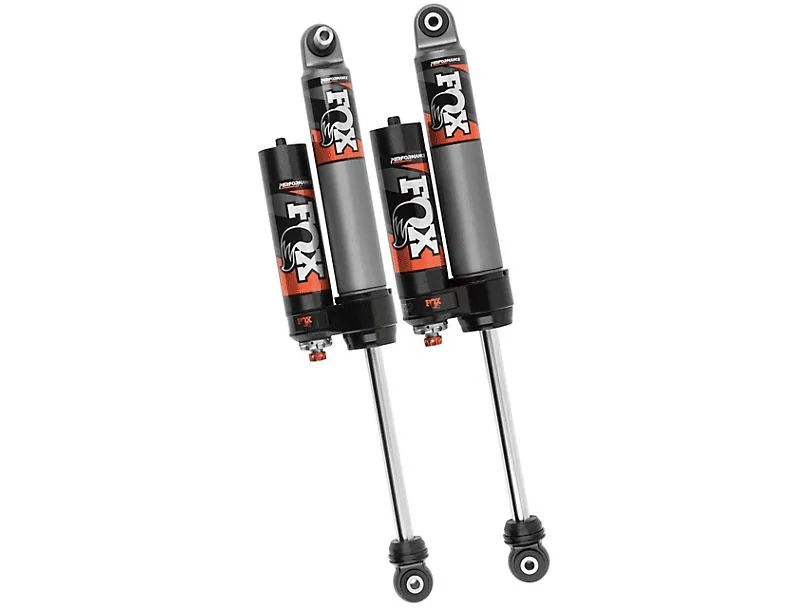

Looking for some new shocks, the basic 2.0 performance series Fox are not holding up well, ride has become garbage. So looking to upgrade to something bigger and better and adjustable.
What can people tell me about these 3 offerings on the JT?
Fox 2.5 Performance Elite Piggy Back. Something like $2,900 for 4. I like the fast and slow damper separate knobs.

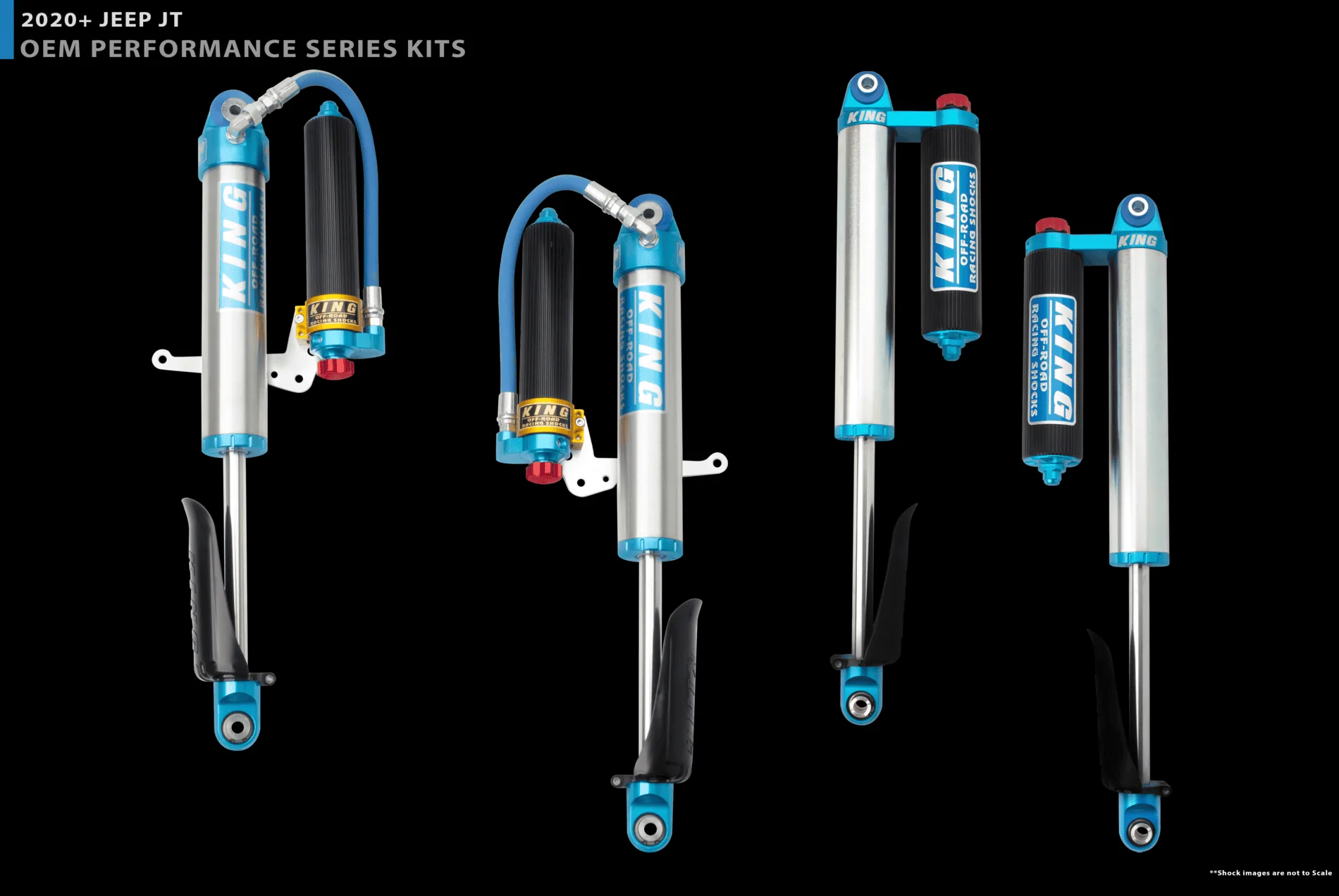

King JT Specific remote/piggy back combo. Also 2.5" shock body like Fox above but single adjuster. Should be a little less at around $2200.

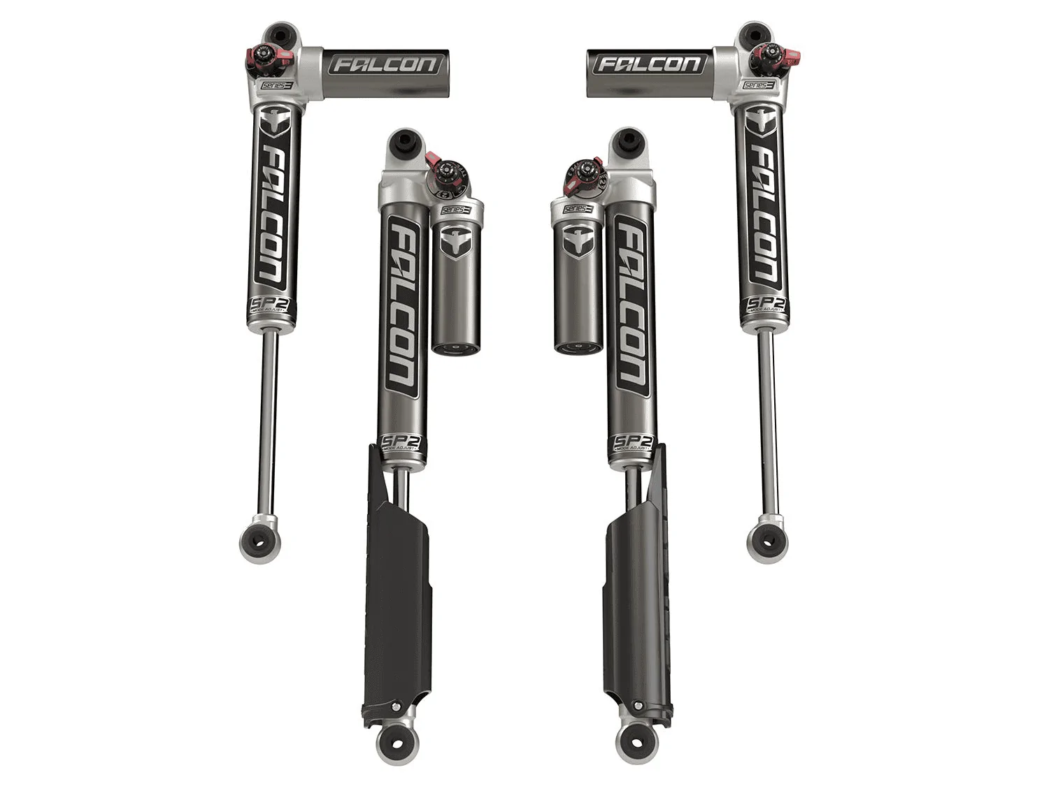

Falcon 3.3 also has a 3 position knob that has 8 fine tuning options available. Right around $2,000

I’ve run a variation of all three in the past on my JK and JL. Kings offered the best build quality and the Fox‘s being the easiest to fine tune.
Falcons were a distant third for me, mostly because I don’t like digressive shock valving and the shock fluid did not react well to cold weather. The ride was beyond stiff. Supposedly their new SP2 line addresses these issues.
