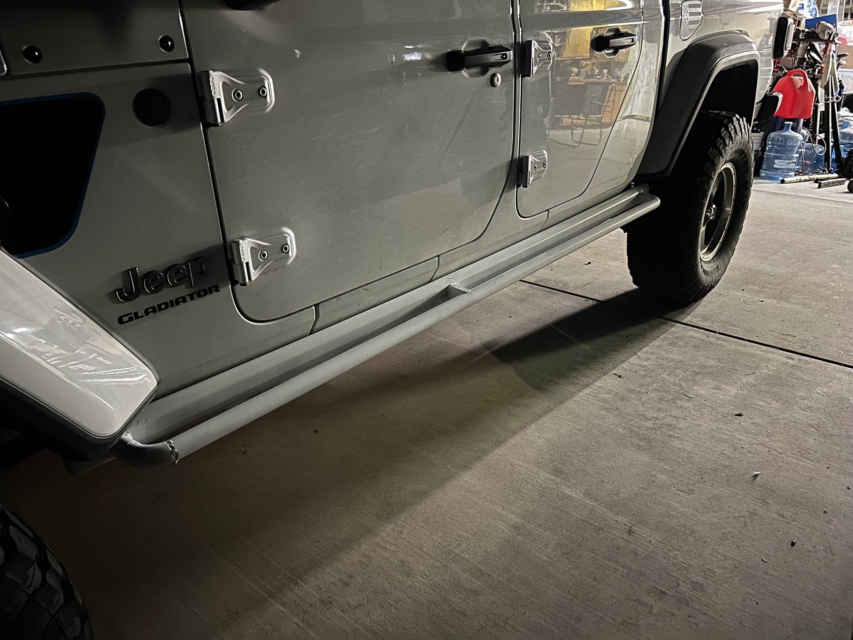

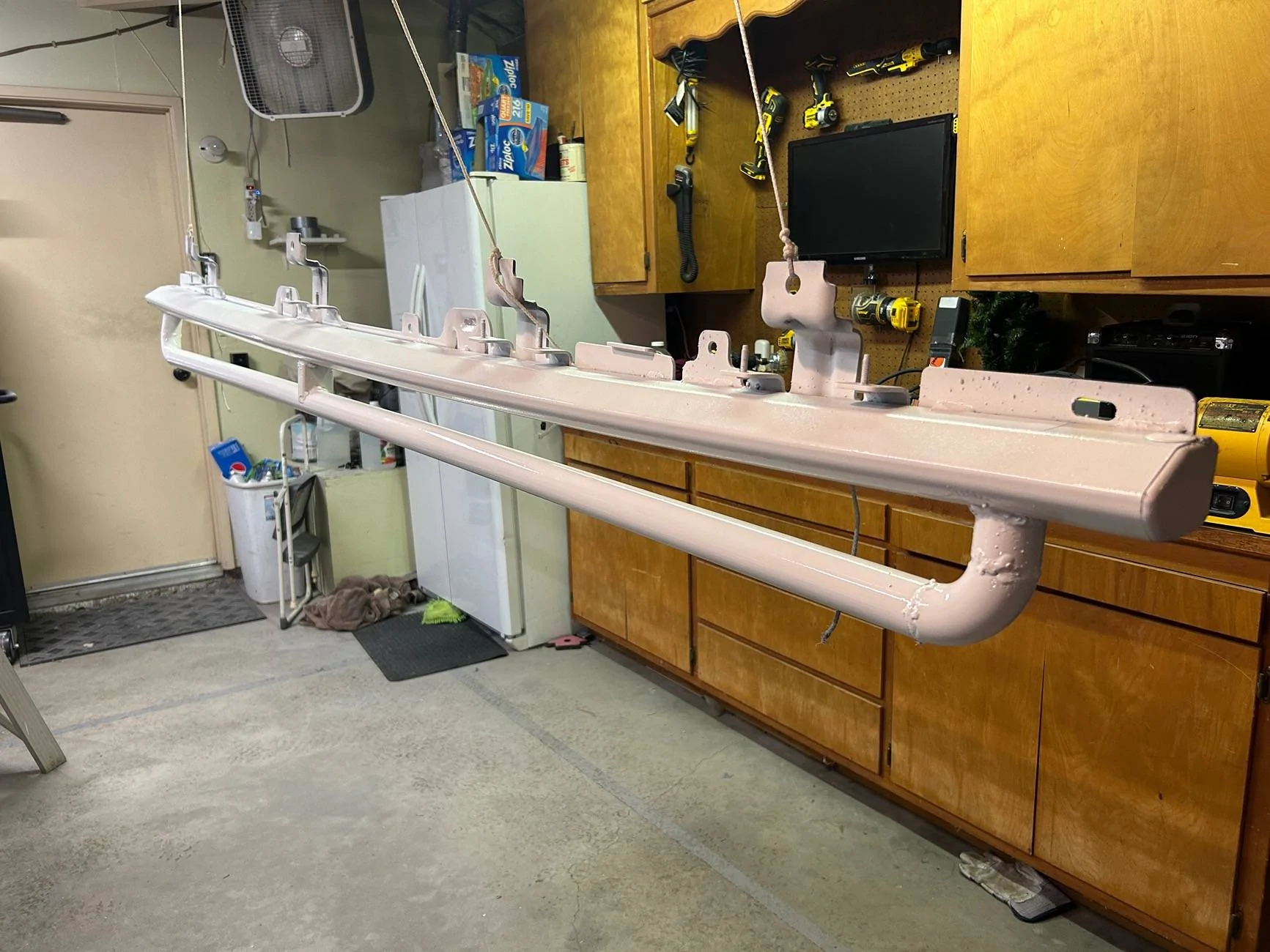

I used the factory sliders and welded schedule 40 tubing to them. It held up fine but ultimately the Mrs said I could buy sliders from a company that can weld a little better than I can 😂

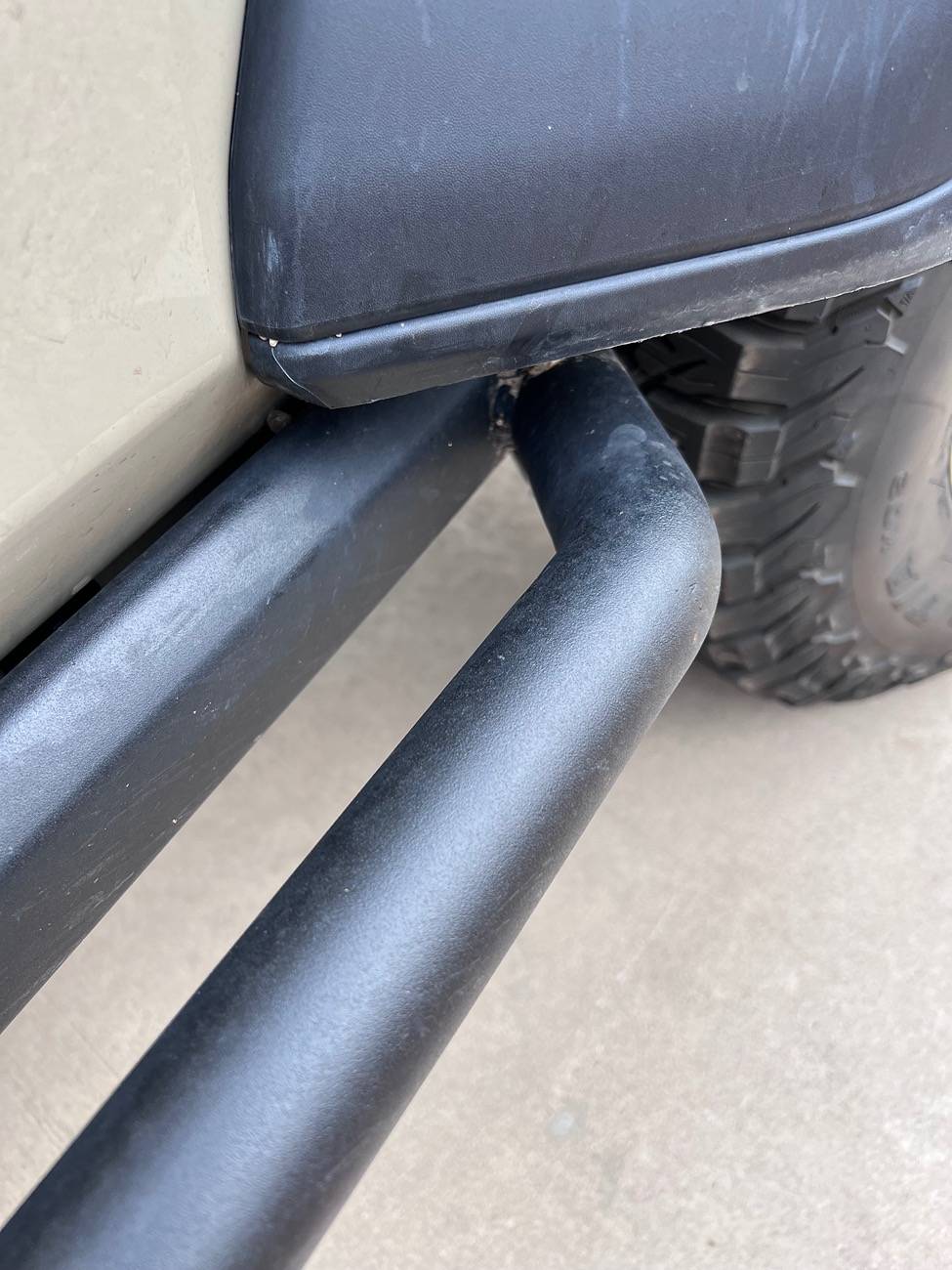

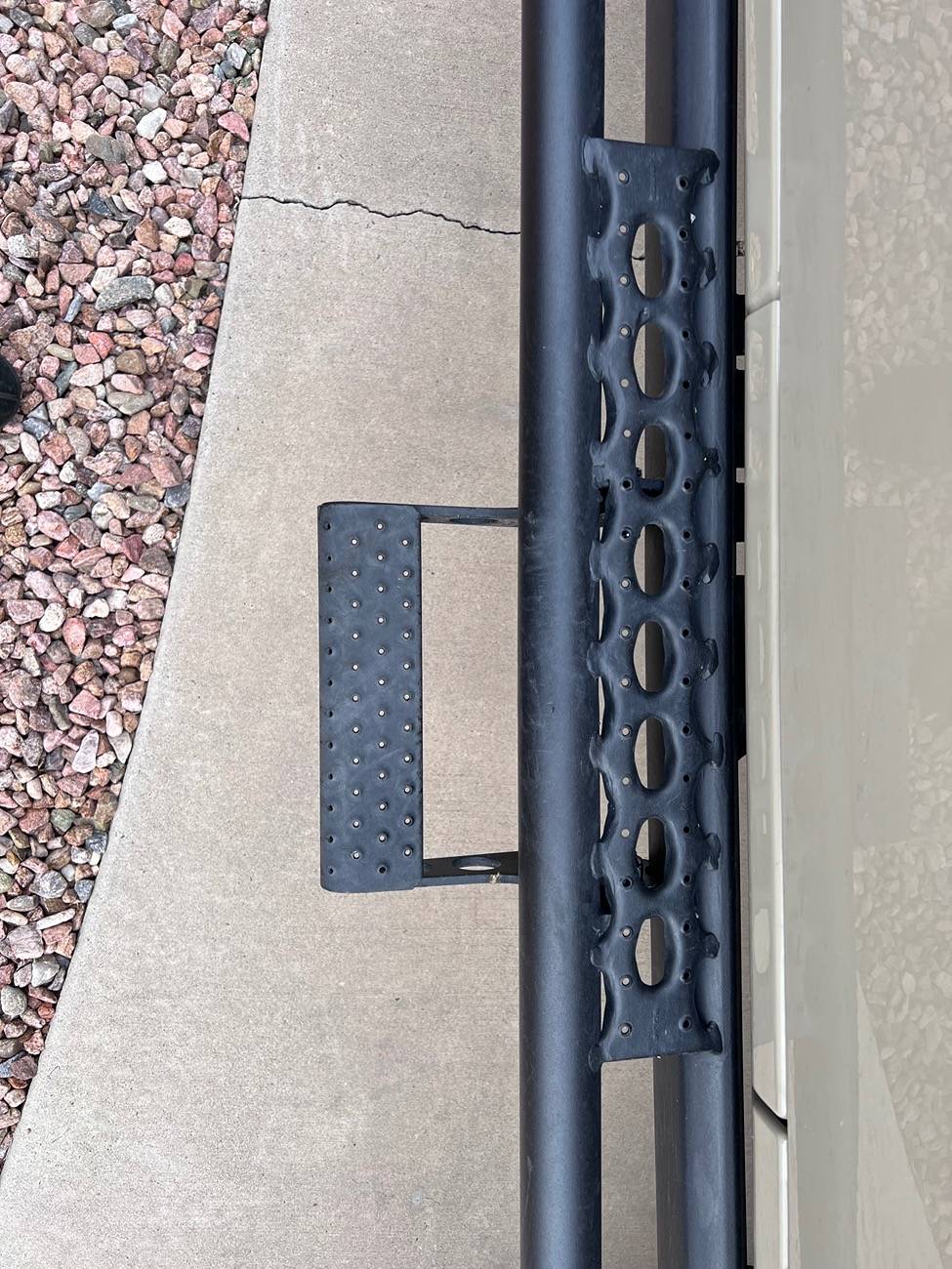

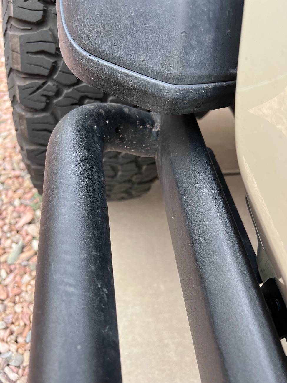

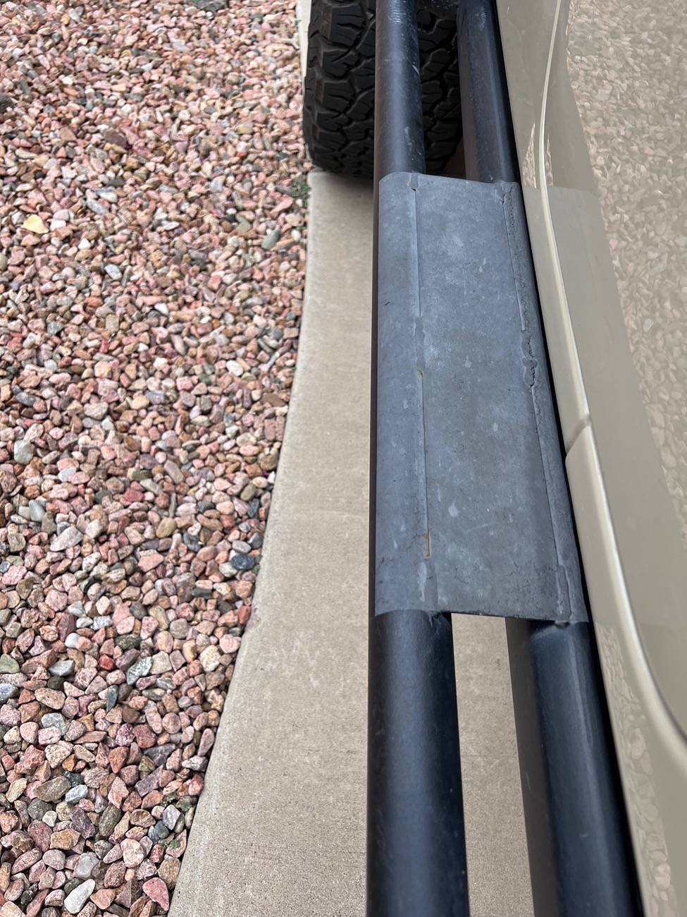

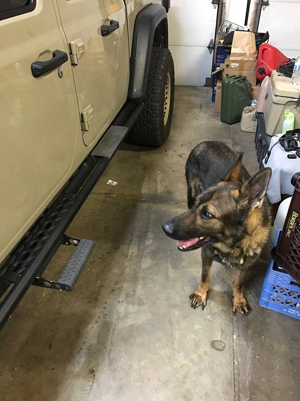

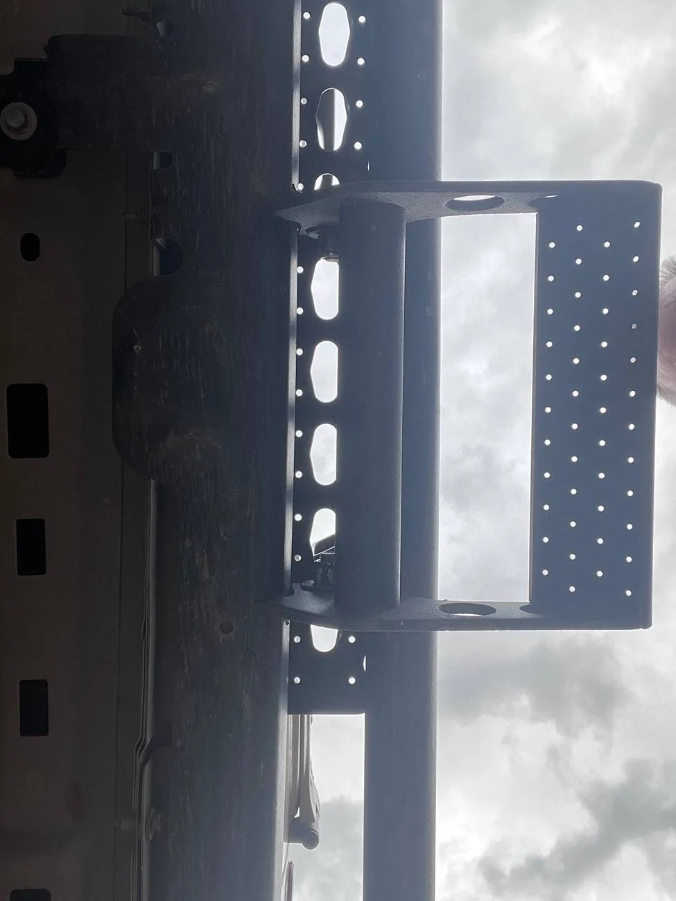

I also used the factory slider. I welded schedule 80 pipe using elbows and 1/4” bracing. I welded perforated plate for the front step and solid plate for the rear for our dog. I didn’t want him catching a nail in the perforated plate. I had the steps from my old Jeep so I welded brackets for them front and rear. The steps can be removed or moved to the back.
Mark
