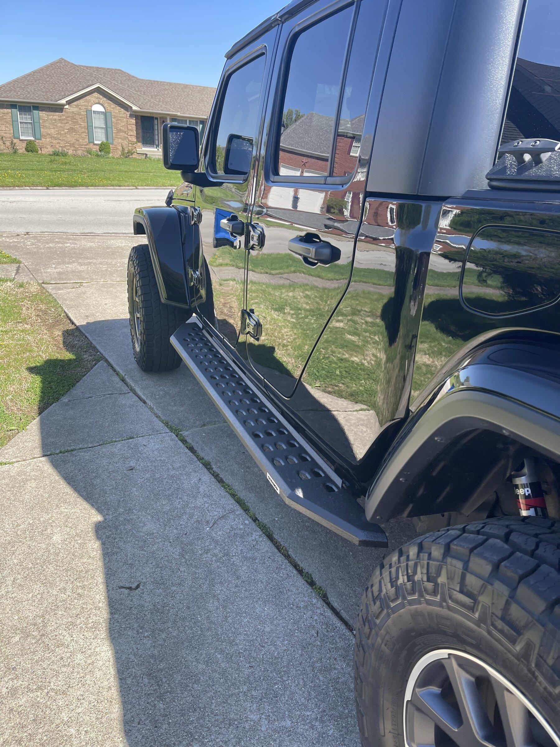

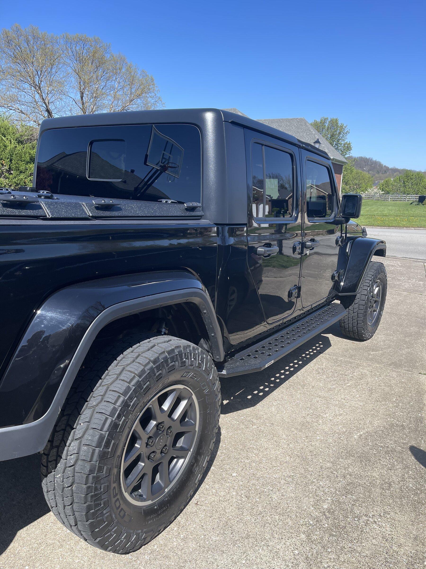

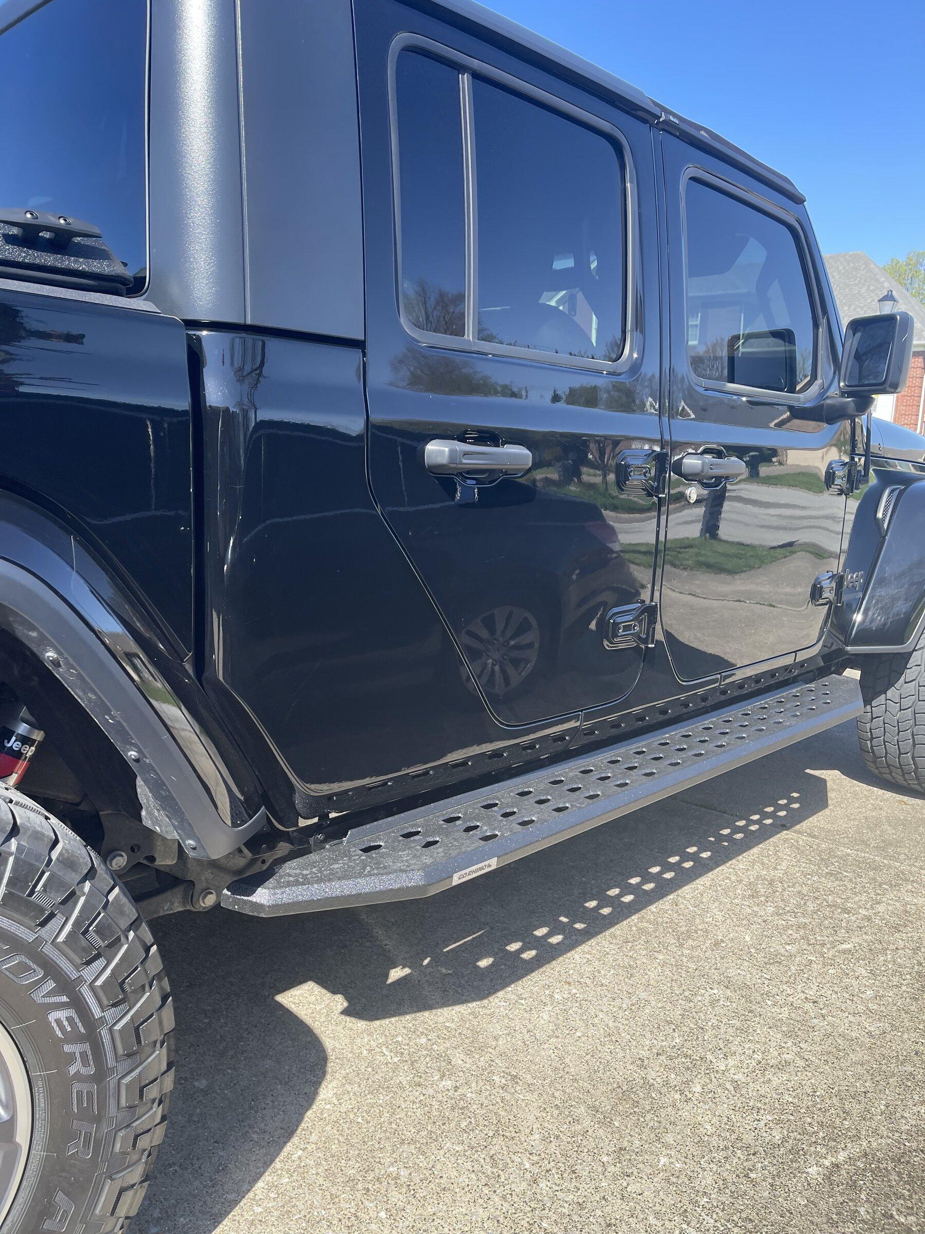

OP first off you will not be disappointed in the RB20s. Great choice. I absolutely love mine. Got the bed liner finish personally. They mount up just fine. Remove the rock rails and they bolt right up. 4 brackets per side. 3 bolts per bracket. 2 go horizontally in the pinch seem. The other under the body. I can dm you pics of the brackets and how they mount if you want.
My main reasoning for the RB20s is that I prefer a full length step as opposed to a rock rail or even a drop step. I want to be able to step up anywhere on the side and not just at the doors.
