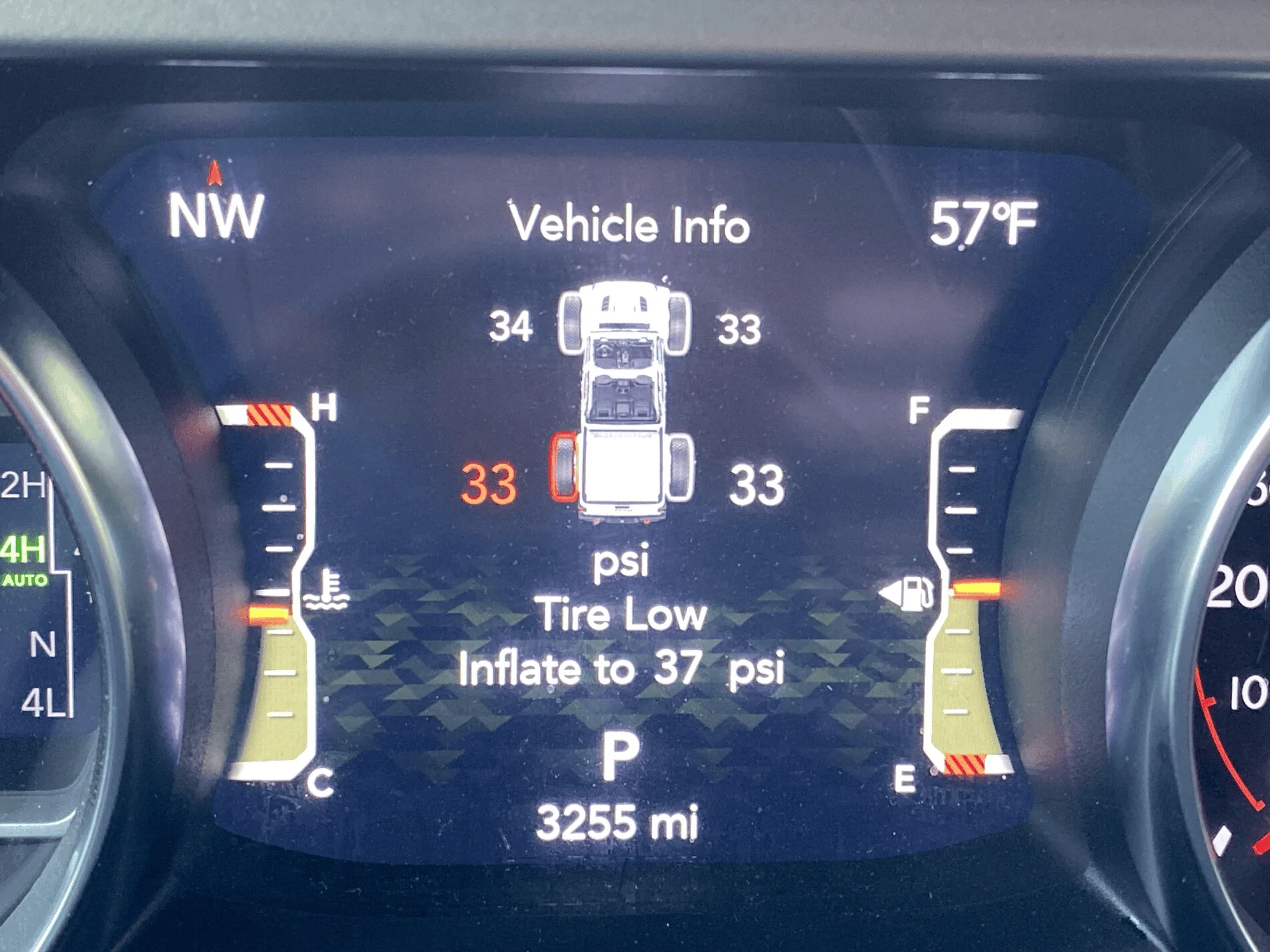

Temps dipped a few days ago and one tire triggered the Low Air Tire Sensor at 29psi (all other tires were low that morning but still above 30psi). Note, I lowered all 4 tires to 33psi the day I picked it up (6 months ago) and want to keep it that way.
Is there a way set the default psi from 37 to 33?
I’ve tried setting a new preset via the Select Tire Fill Alert but this doesn’t remove the warning. Also, I’ve driven it plenty (well over 20 min stretches) but the warning won’t go away. Trip to the dealer in order?

You can set the TPMS levels using Jscan app... check out Jscan.com for all details. I even turned off TPMS with the 35s at 28psi ..

Tazer lets you as well.
