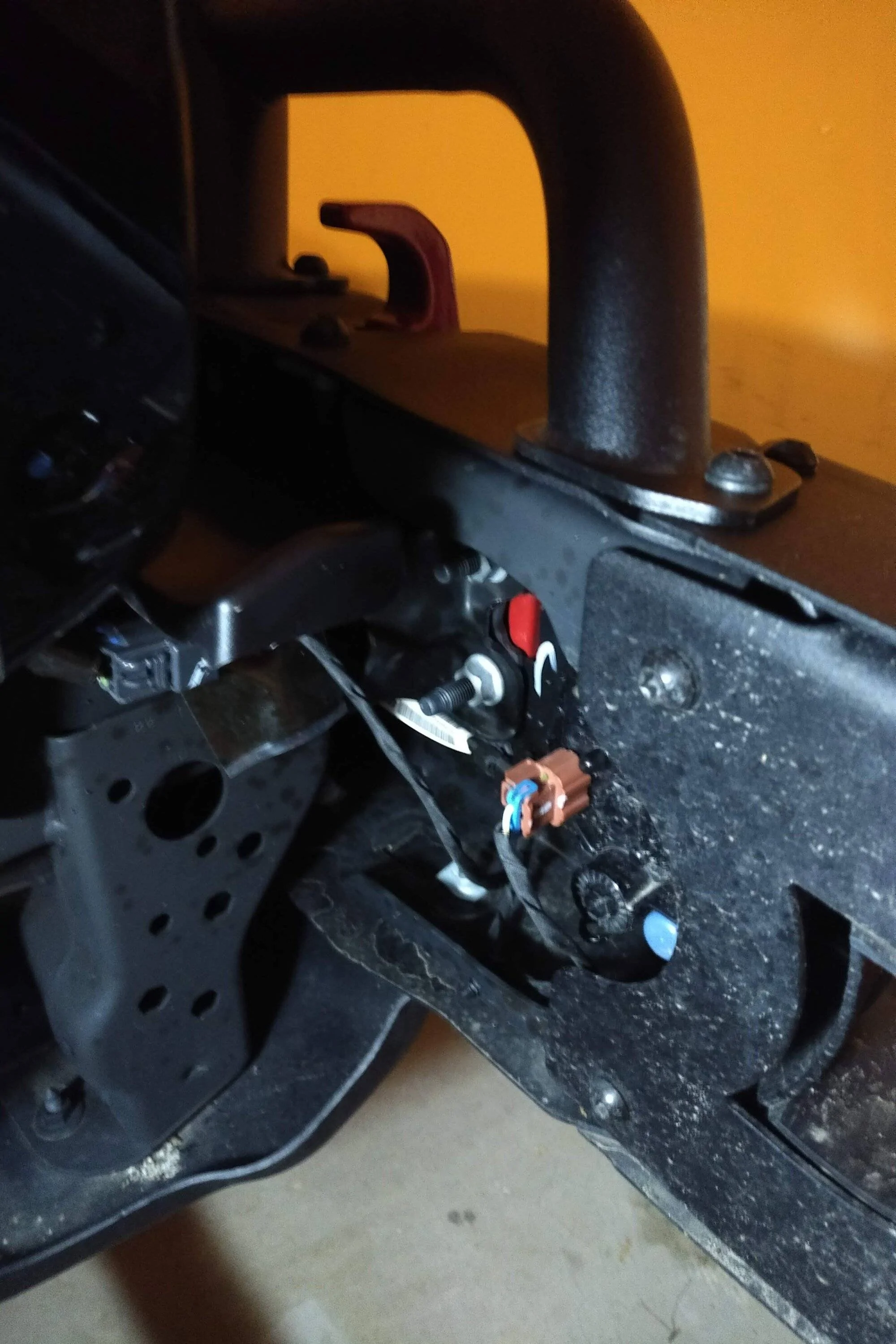

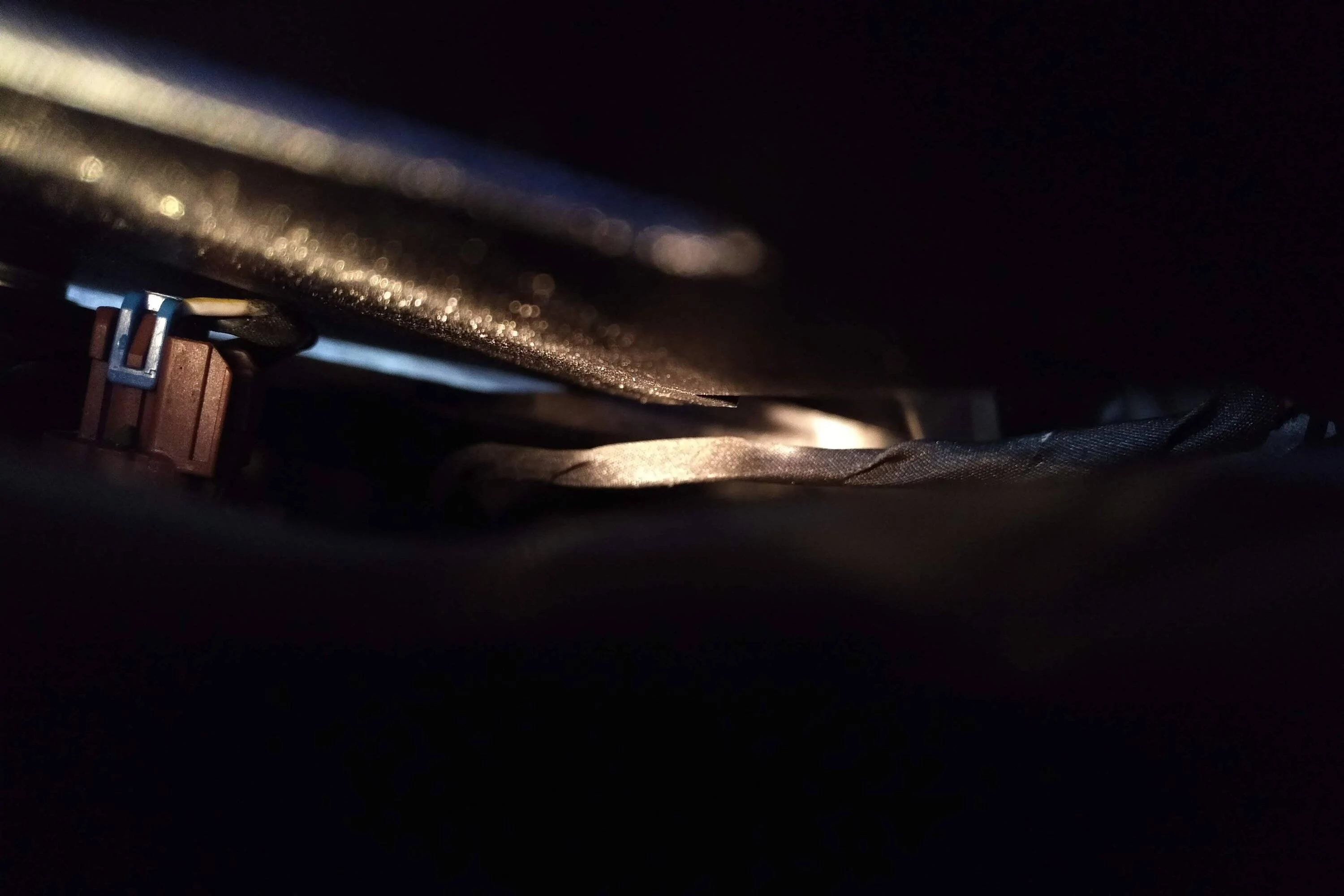

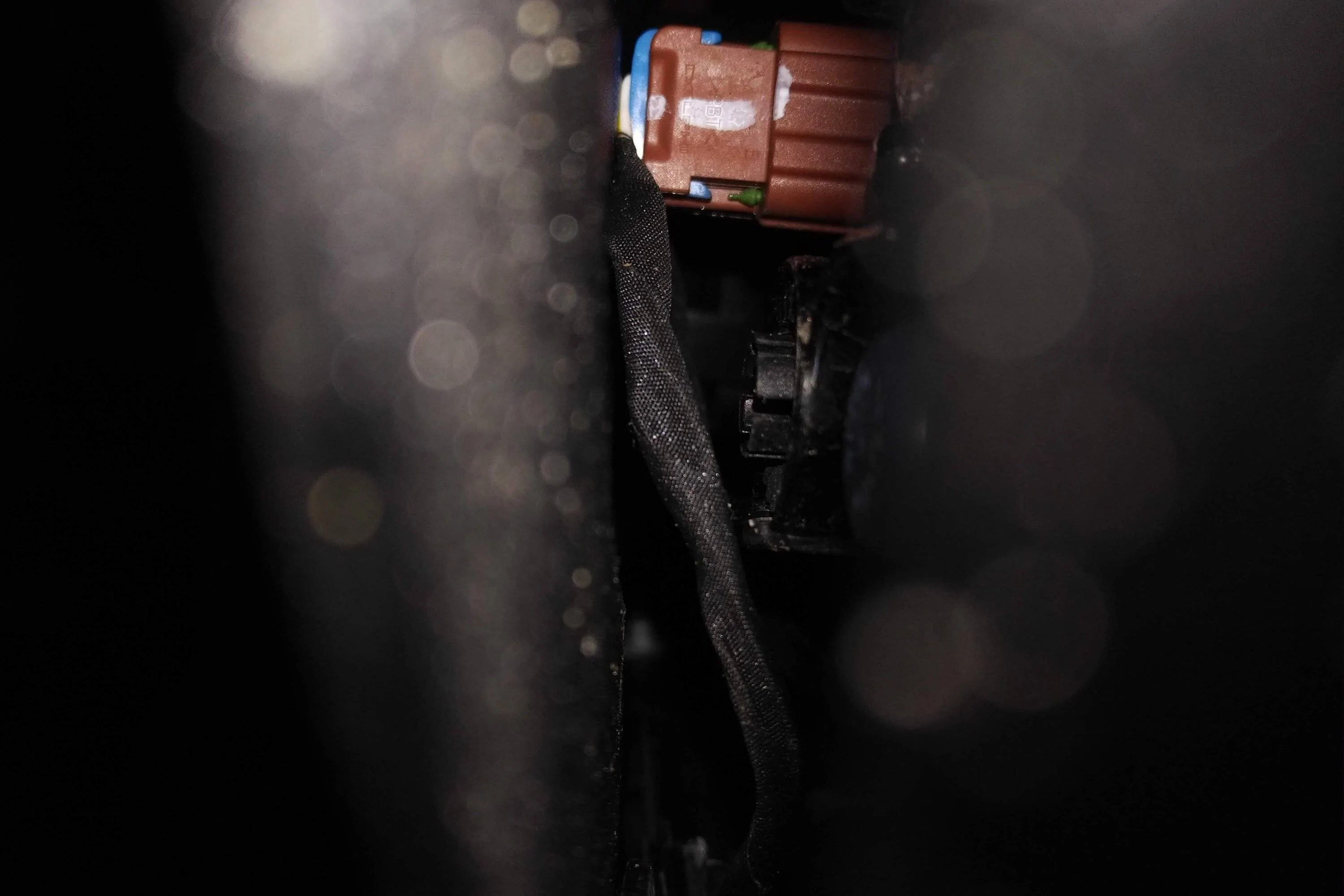

The exposure of the back of the fog lights and wiring on the Mopar steel bumper bothered me from the day I bought the JT. Why Jeep can afford to put a piece of plastic backing on the lower end plastic bumper but not on the supposed “upgraded” steel bumper is baffling. Anyway, this problem is mentioned on a few other threads noted below but I didn’t see anyone post the details of a solve exactly the way I did. Most seem to be solving for a stubby bumper situation which I was not. Thought my lesson learned might help others.

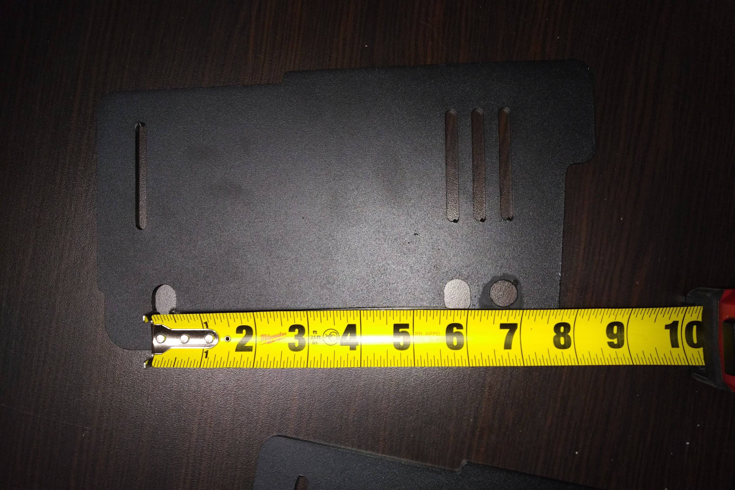

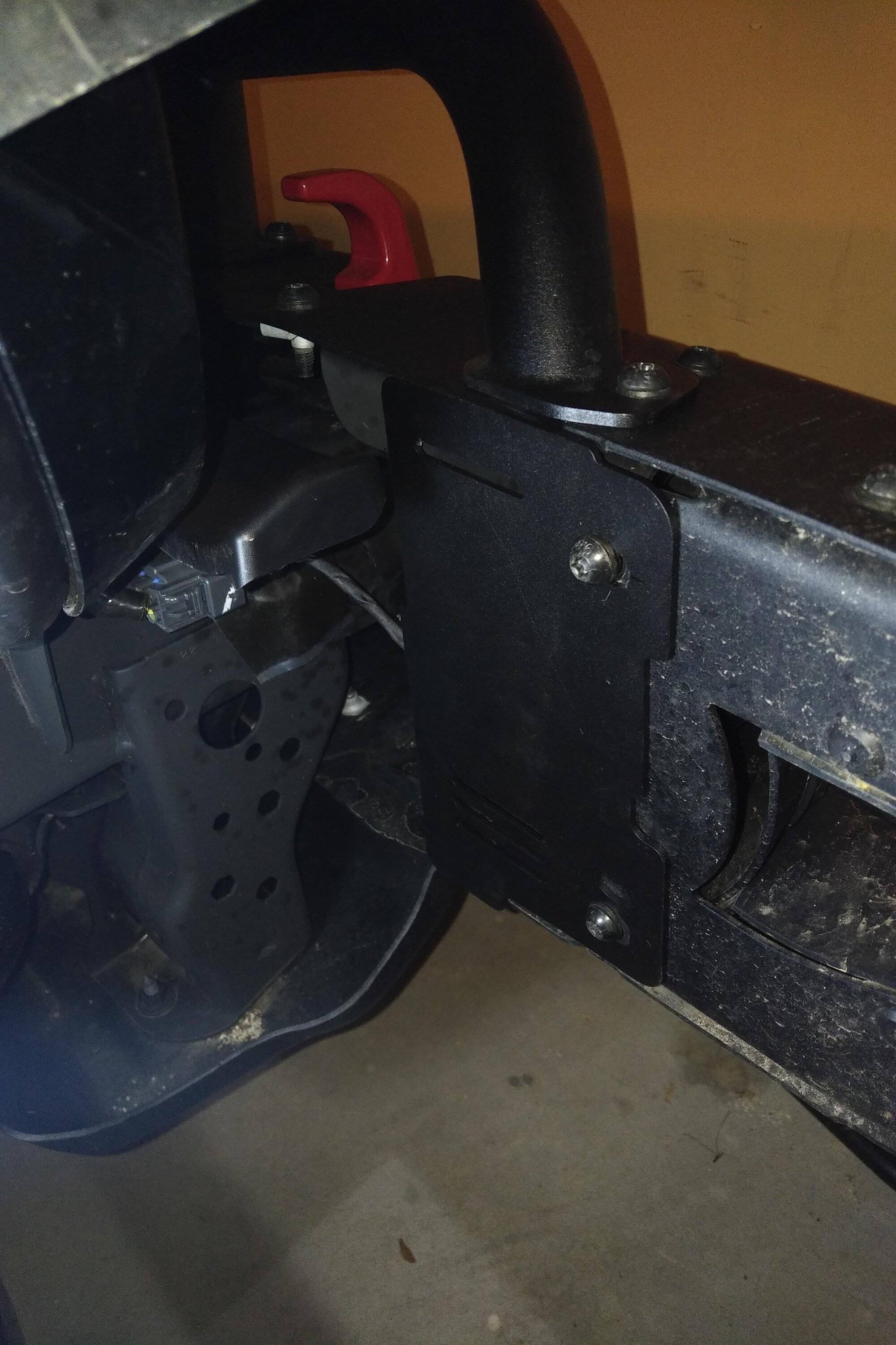

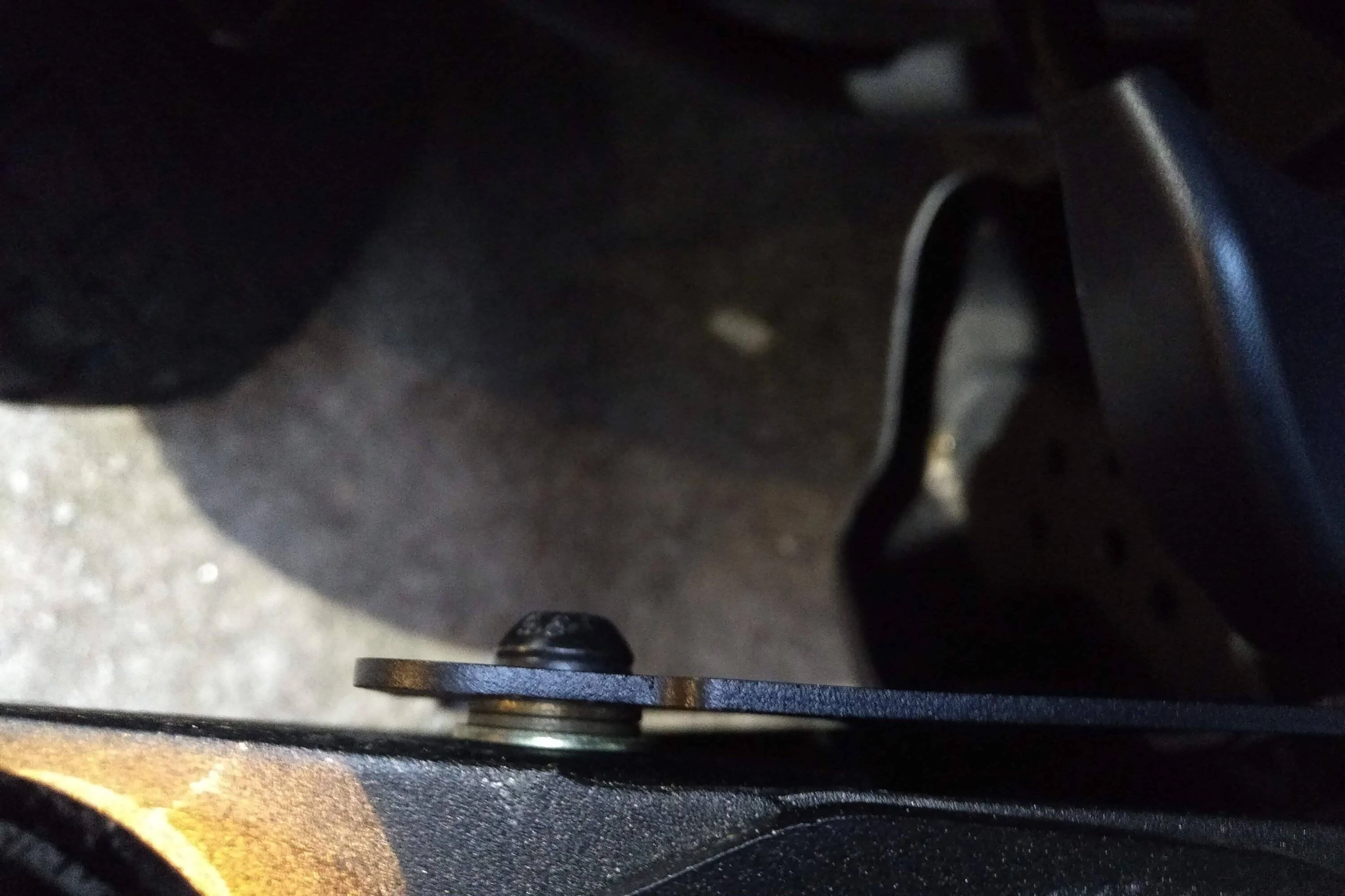

I bought a set and found the bolt holes were off by about 1 inch. I had to drill out additional holes 1 inch below the original bottom bole and it lined up perfectly. I also painted the drilled out holes to make sure the exposed metal didn’t eventually rust. When I started to really tighten down the bolts, I noticed the plate was pressing directly against the back of the fog light and wiring. This made nervous it would eventually wear into the wiring. I added 3 washers between the bumper and the plate which created enough space for the wires to move freely in the space between the plate and back of the fog light. I am relatively pleased with the outcome and it certainly achieves the objective I wanted of protecting the back of the fog light and wiring and only took me a bit more time than planned. Pics below for reference.

Start
Plate modification for additional hole
Initial install pressing on back of fog light
Second install with washers for additional space
