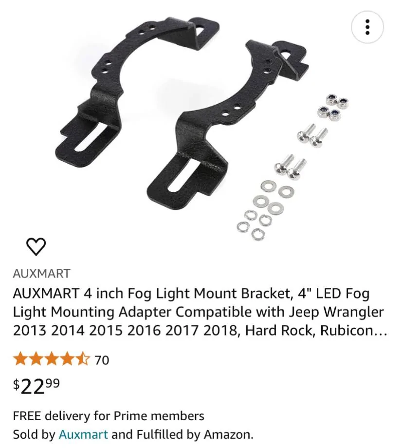

Yes, I had to order brackets from Amazon ($22.00) to adapt the factory LED lights from my plastic bumper to the OEM steel bumper. I’m waiting for the brackets to arrive.

@JUPITER GLADIATOR do you have a link to the adapter brackets? My 2020 rubicon has a plastic bumper with led's and im switching to a 2019 steel rubicon bumper. I also want to make my fogs work with the steel bumper.

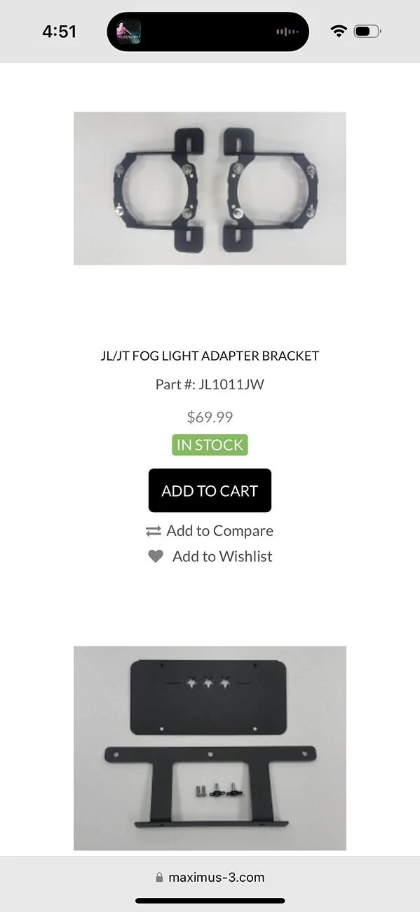

The lights will work however you need to get the adapter kit brackets. Maximus three sells them.
