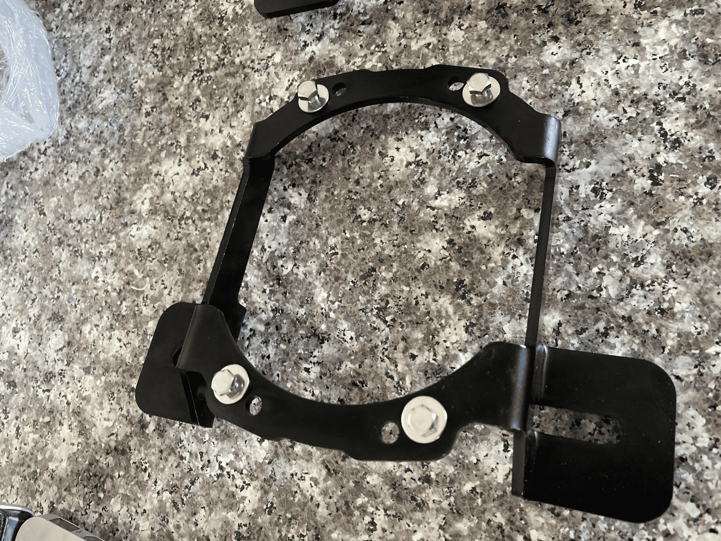

All done. 15 min to attach skid etc . Easy peasy.
Jeep Gladiator ×OEM Steel bumper fog light bracket adapter? tempImageuW1xKI

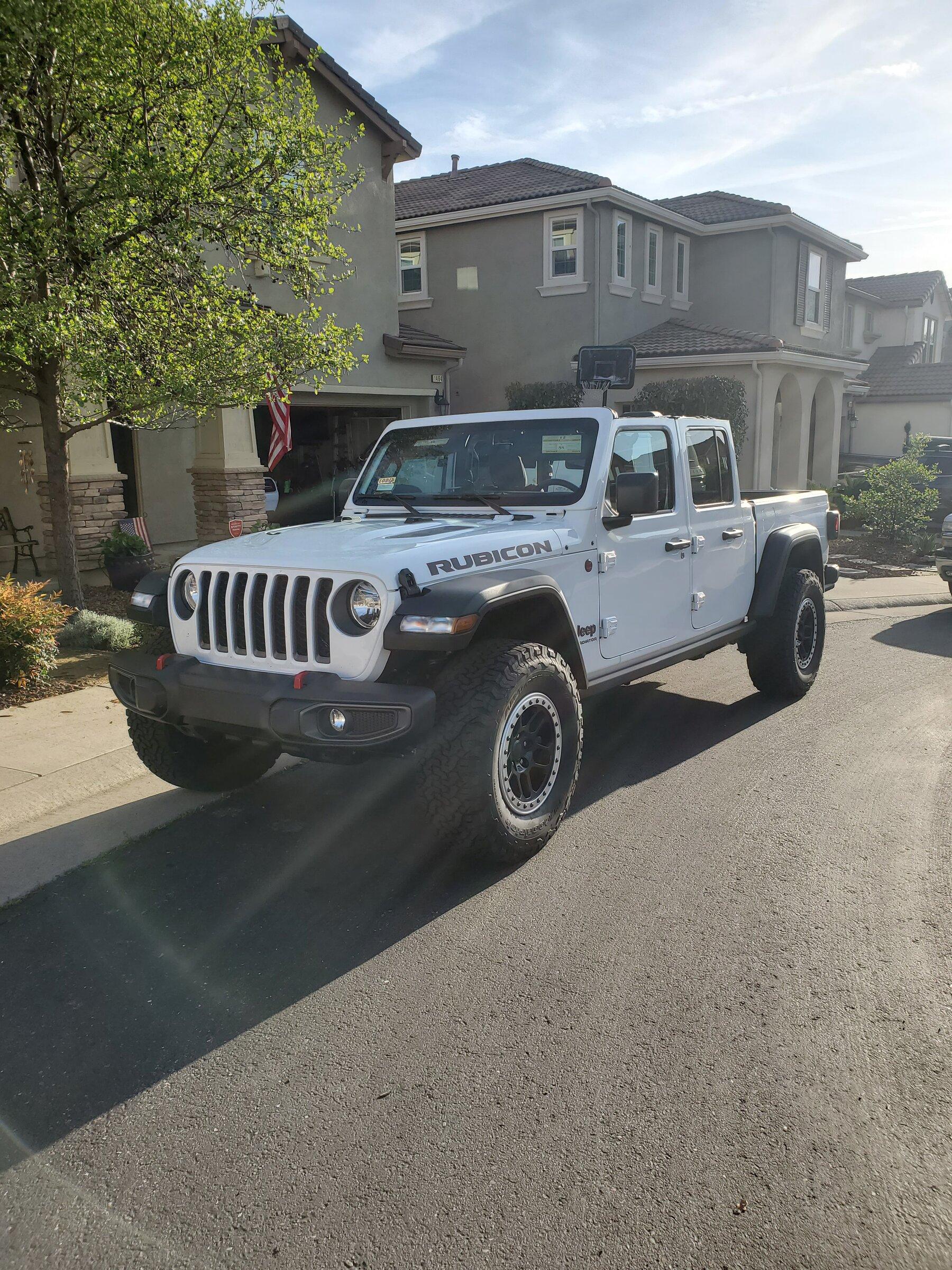

What does your bumper look like? My original one had silver trim on it.
I own a 2022 rubicon gladiator with halogen fogs. Are my fogs the same as yours?
XraytecH
Bernie
Jan 14, 2021
211
1,909
2,812
South San Francisco
2021 Jeep Gladiator Sport
Xraytech

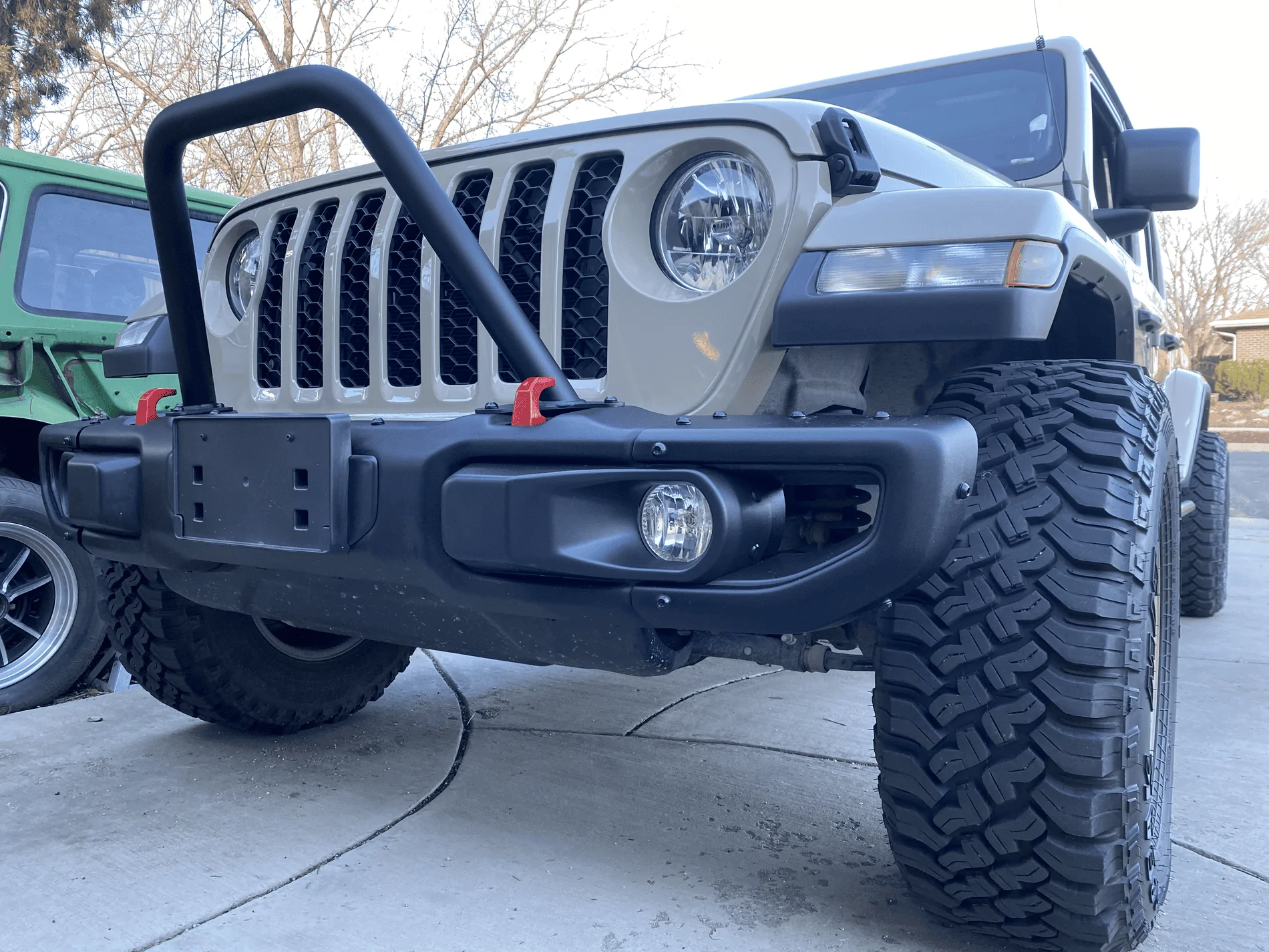

Depends on what OEM plastic bumper you have.
If your bumper looks like this, the halogen fogs will bolt right on.

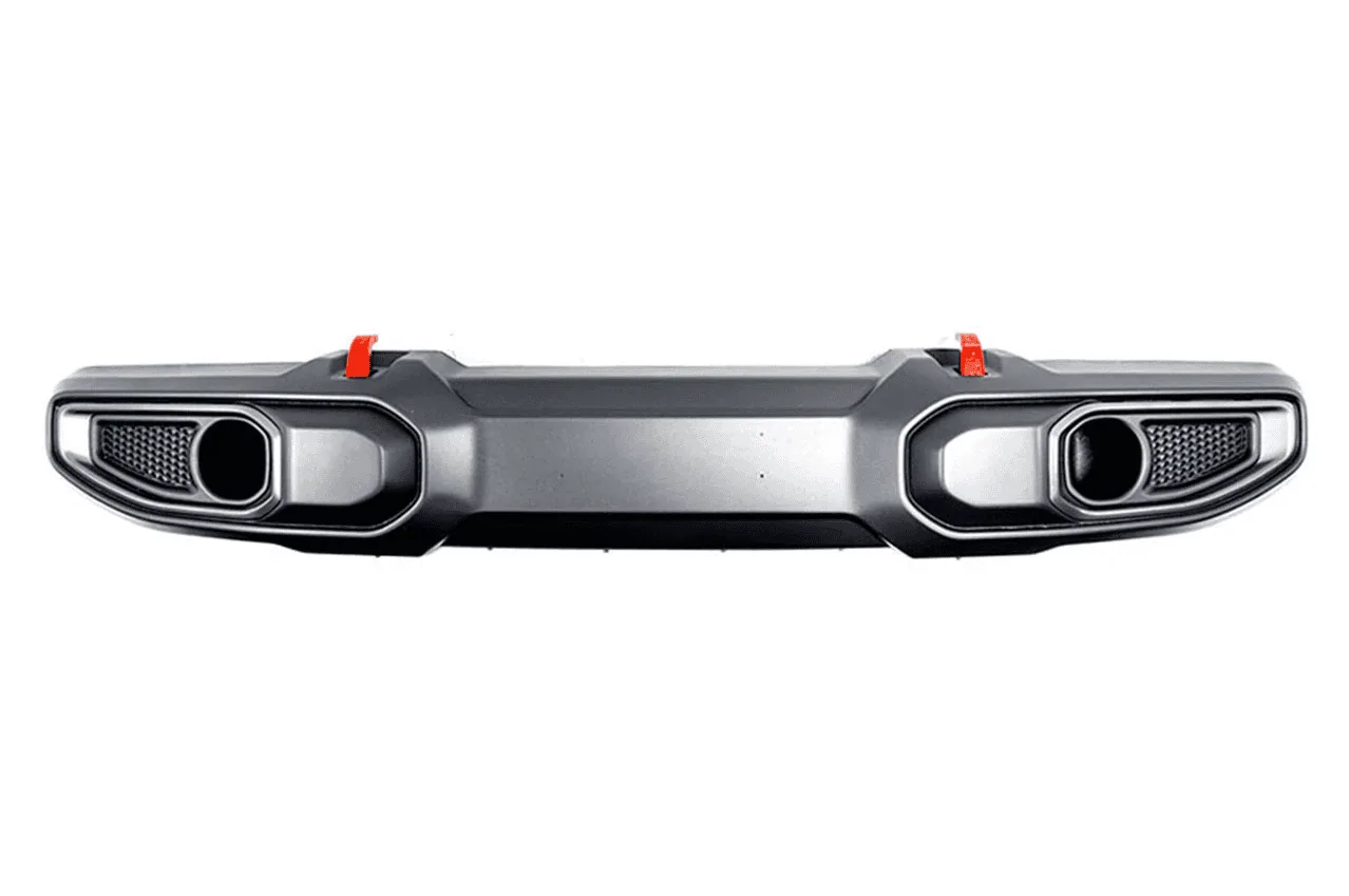

If your bumper looks like this, you will have to get a set of brackets.

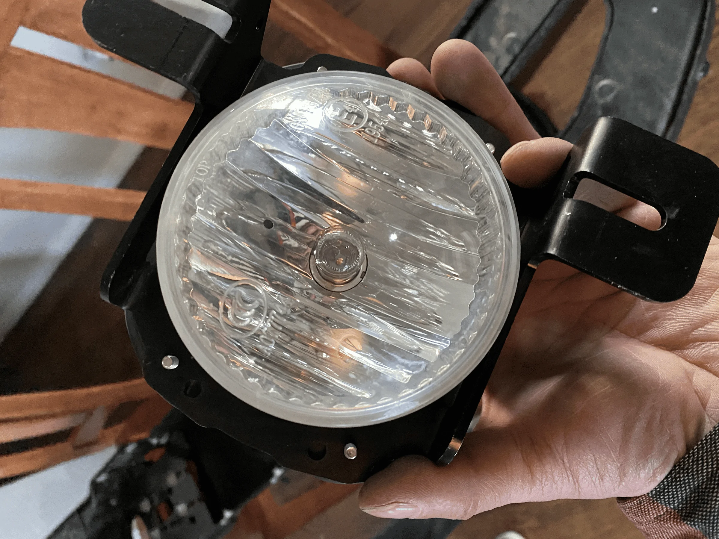

What he said. My OG bumper and the brackets I used.
