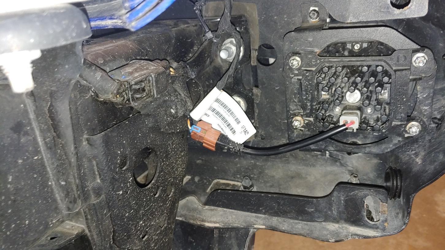

I’ll let ya know either tomorrow or the next day or so. I have brackets on order dropping tomorrow and swapping my plastic overland bumper for a rubi take off steel 3 piece.
40,442
53,860
IF the Mojave plastic bumper is the same one as used on Overland or Rubicon, then these absolutely work -
https://www.amazon.com/dp/B07D598QRF
The stock fog lights for Overland and Rubicon and Sport S, etc. plastic bumpers mount with 4 screws.
The fog lights for the steel bumper use 2.
The above adapter works.
This is a similar adapter that comes with the knock-off steel bumpers - it works the same way but the fog light bolts to this adapter using 4 screws instead of 2

Did the adapter you bought work? Looking at doing the switch on my mojave as well.

Are you fogs LED? I've been reading that the Mojave LED's are different possibly?? Gotta do more research I guess.
Mine are halogen but this mount matched the mount on my son's LED from his Rubicon
