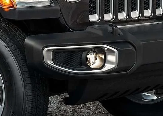

Anybody have luck pulling the fog light bezels. Cant' seem to pry them off.

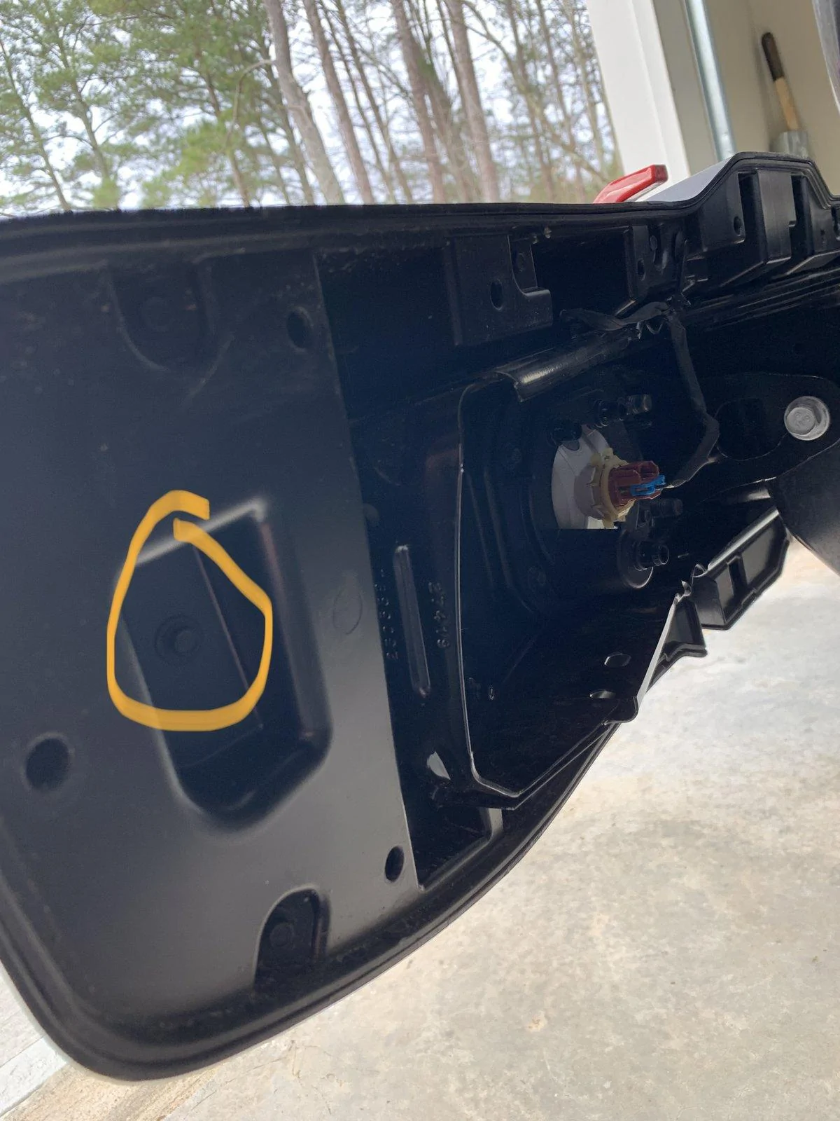

There are screws holding them in and then clips to pop out. See photo for screw location. Once the screw is out take a thin...something...and carefully pop the clips free around the edges of the bezel. I used a butter knife without the wife’s knowledge haha

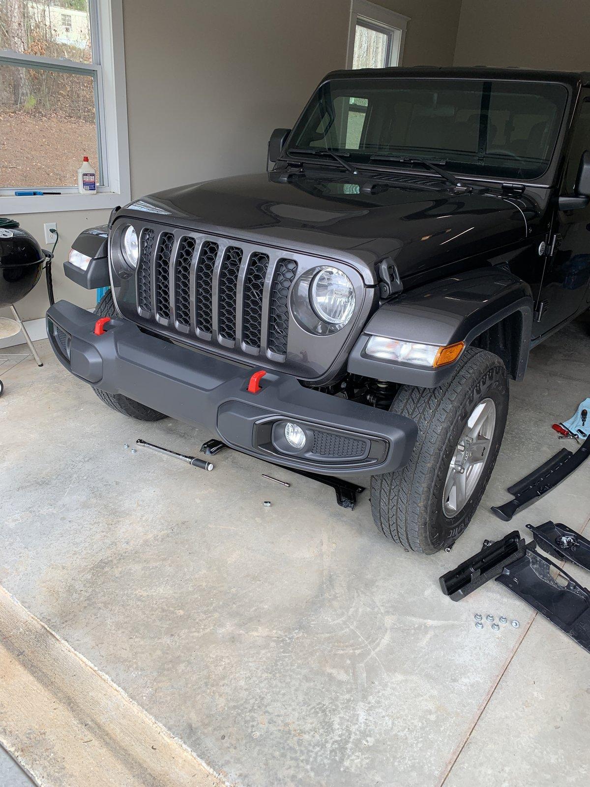

I painted mine with Matte Black Krylon.

That was easy. The screw wasn't even on that tight.
