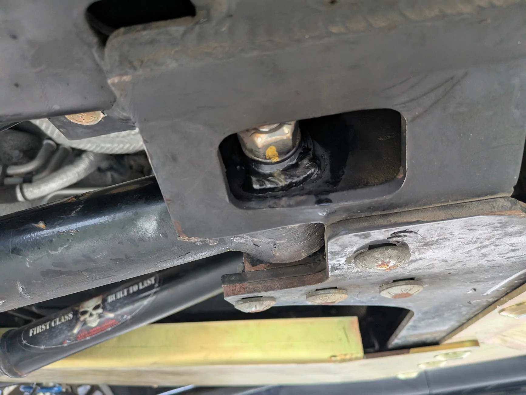

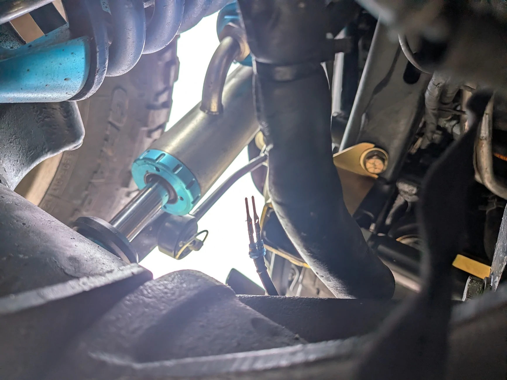

After months of waiting on parts, I finally got Maximus back for a couple of weeks to test drive and shake down. After the Rubicon, the steering and suspension were hammered—I found that everywhere the long arm kit connected to the frame and axles, the mounting holes had started wallowing out, causing the axle to shift. The stock steering box was also shot, with about half a turn of play in either direction. On top of that, one shock was leaking oil, another was leaking air, a coilover was bent, and nearly every rubber bushing was toast.

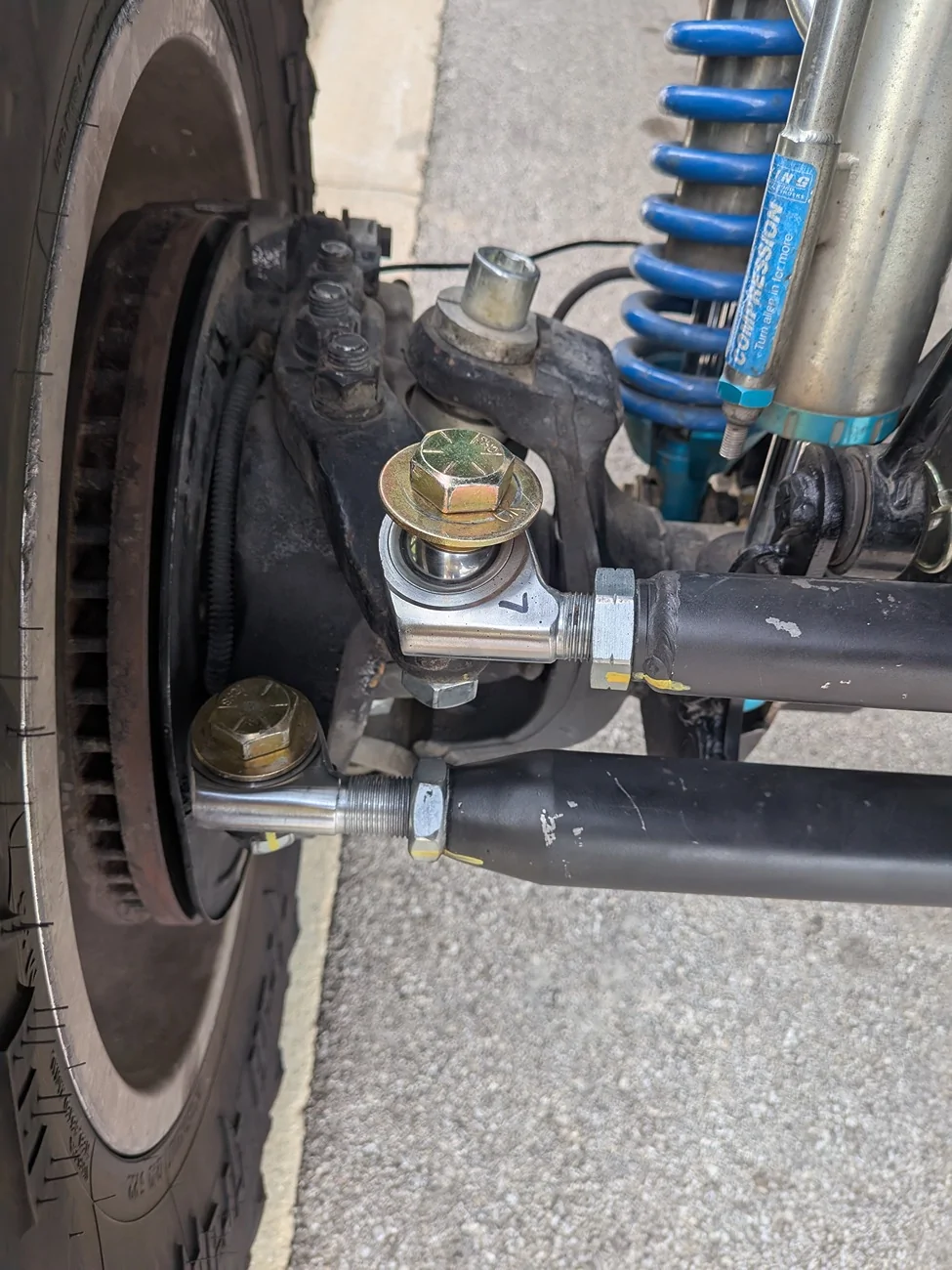

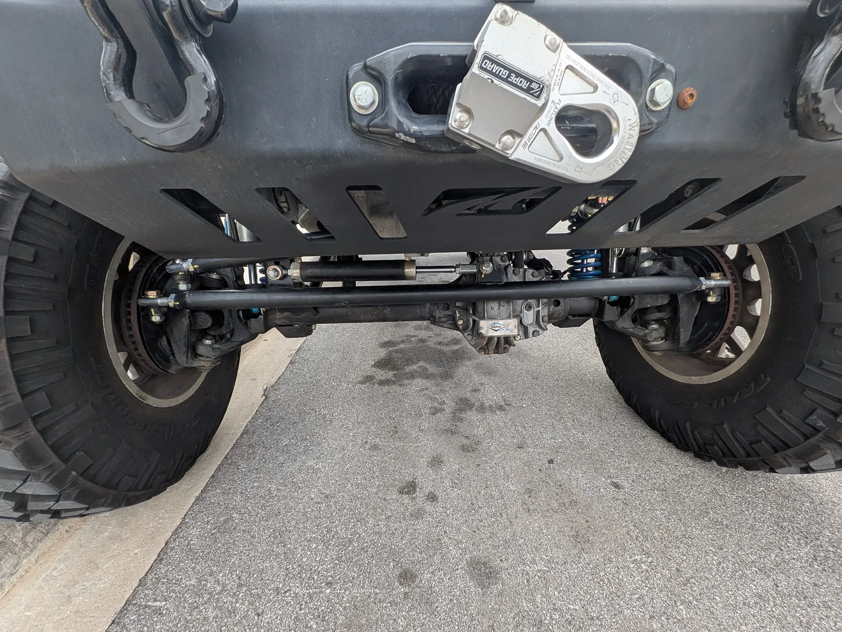

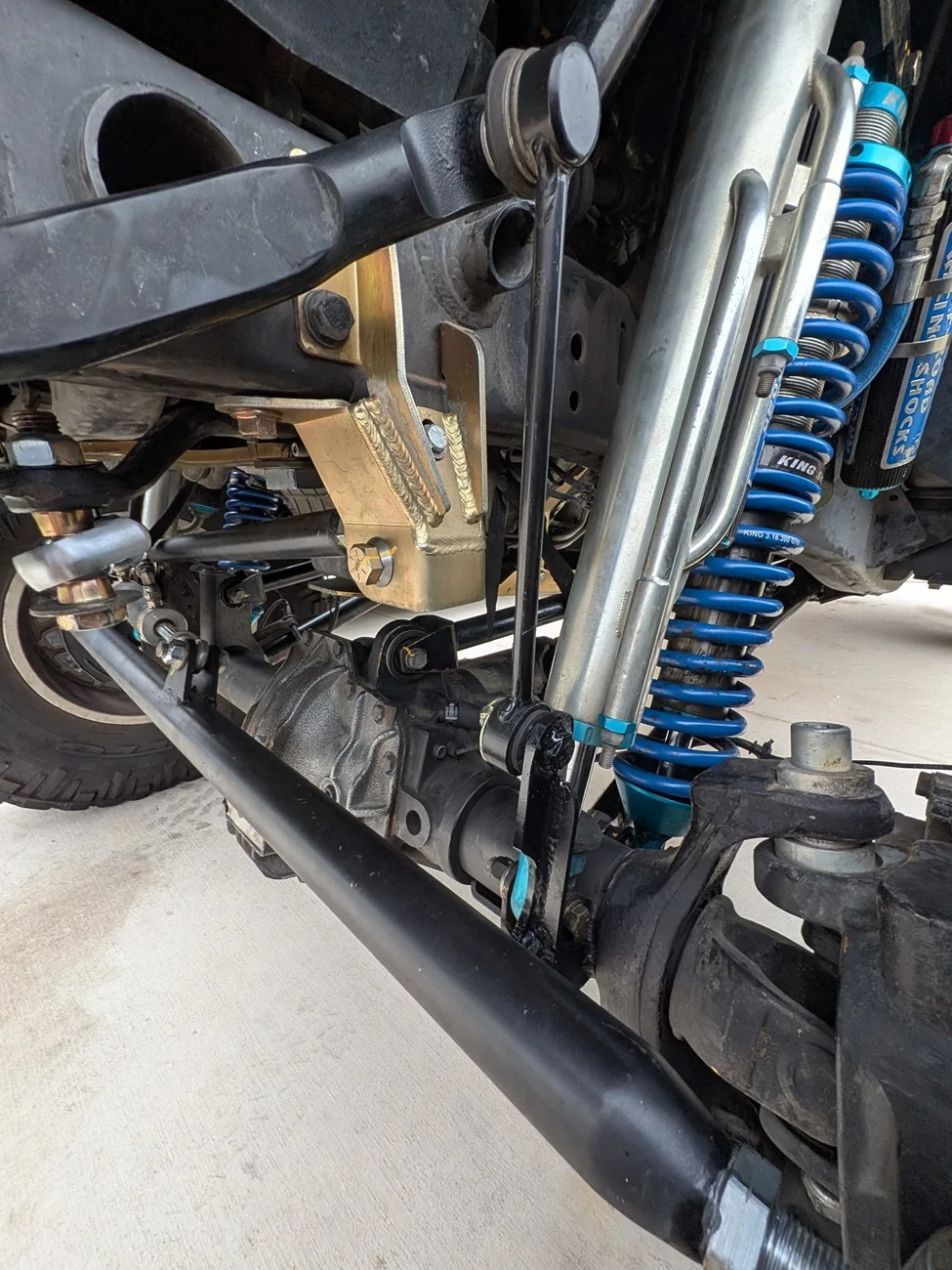

To fix it, we replaced all the bushings with rebuildable ones and installed weld washers at every long arm connection point. The shocks were rebuilt, and we built a custom steering setup using heim joints. For the drag link and tie rod, we used 1.5" OD DOM tubing (with the tie rod sleeved to almost 2 inches). We also fabricated a custom sway bar bracket and added quick disconnects.
The steering box is adjusted for now, but once I'm sure there are no lingering issues, it goes back in for the PSC Big Bore Steering kit and a brake upgrade. This should finally have the steering dialed in.

Dang that thing got beat up! I recognize the crossmember as a RK long arm, were those the adventure series joints? What are you using in their place?
The steering looks stout, looks similar to what genright has come up with. How are the heims, noisy?

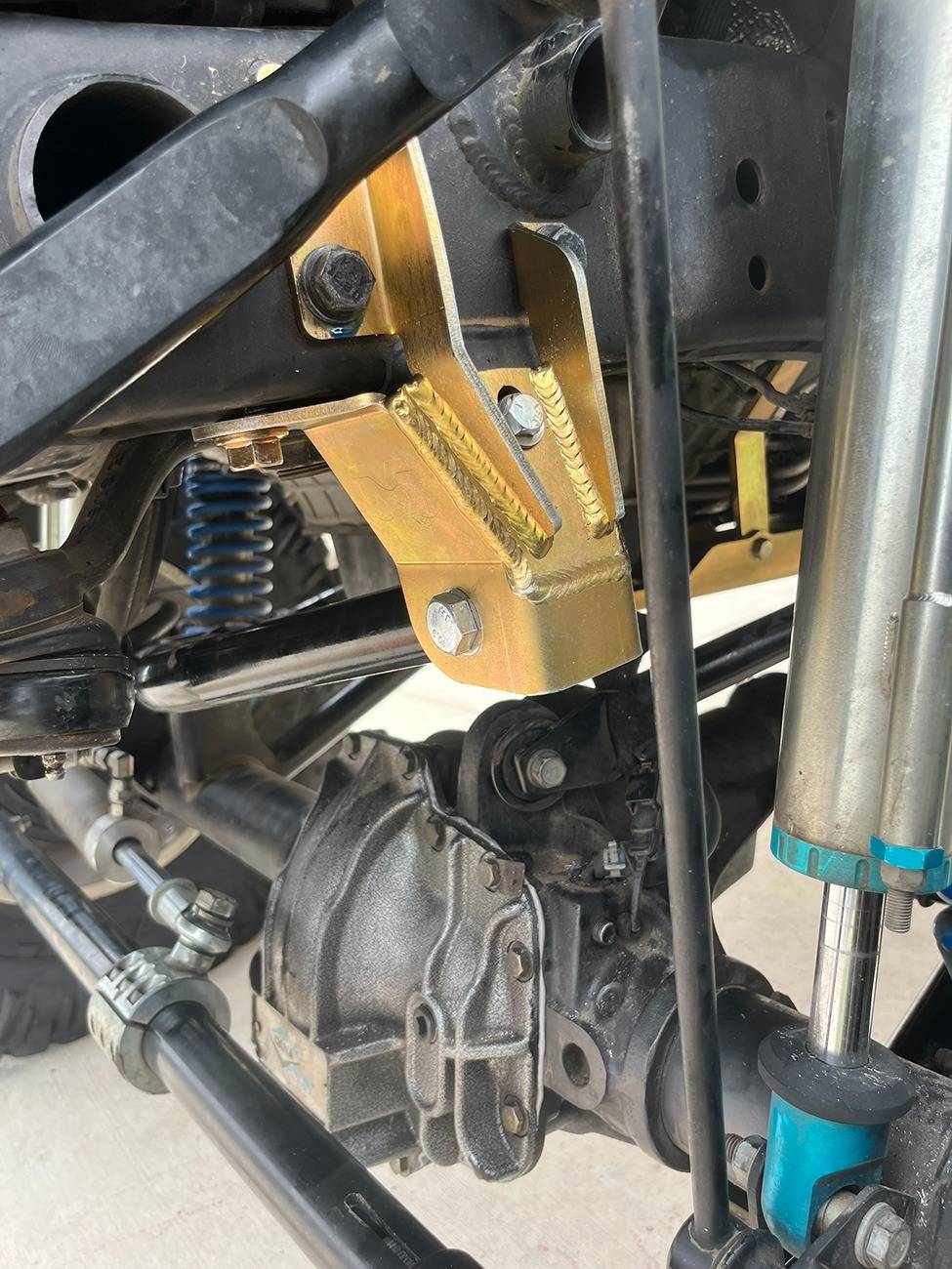

I've been looking into track bar reinforcement brackets, including metalcloak, but wasn't sure if it would clear the coilover upright. Looks like that's what you went with, did you have to cut it up at all to make it fit?

Thanks, the heim joints were a little noisy at first but I oiled them with some Tri-Flow Superior Lubricant and that helped a lot. I don't know much about GenRight Products. The kit does look similar except my bars are all straight and used off center heim joints and they use regular heim joints and curve the bar around the diff. Not sure if either one makes a difference or not. The RK Joints I just got the rebuild kit from RK. Rock Krawler Adventure Series Joint Center Rebuild Kit

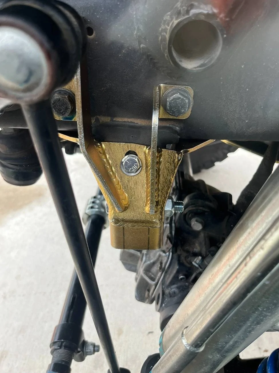

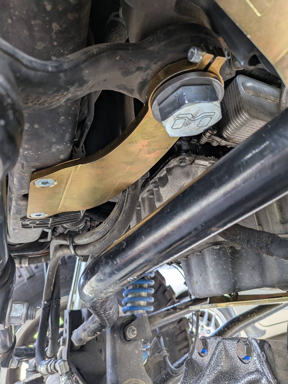

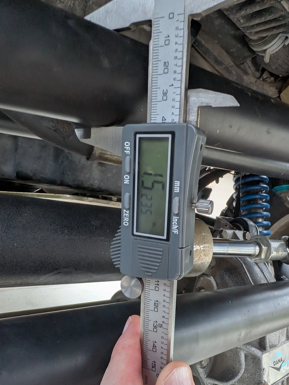

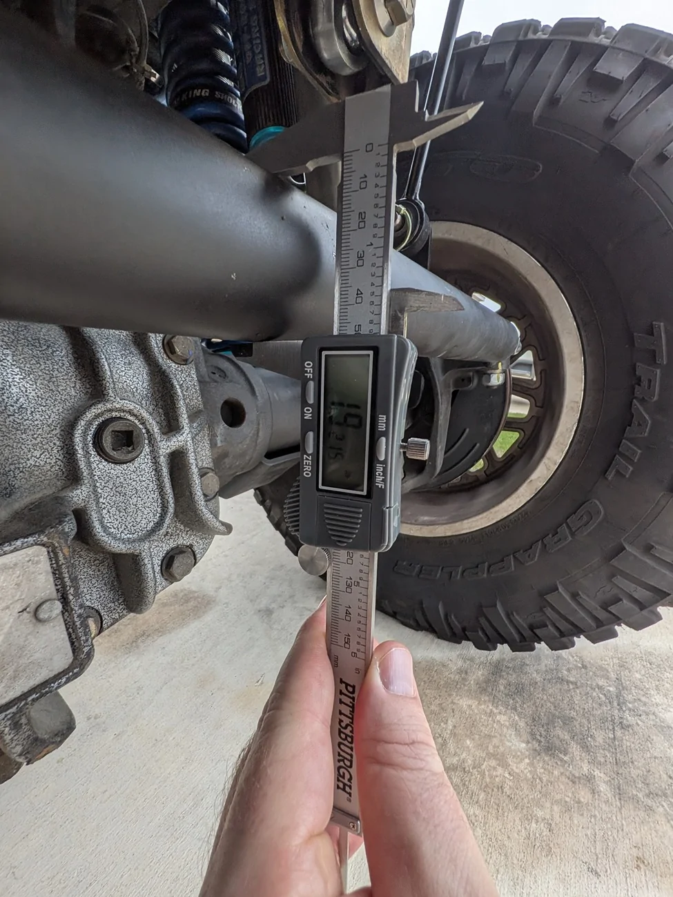

For the trackbar reinforcement bracket I did go with MetalCloak for both the sector shaft brace and the Track bar Reinforcement. Both fit without any modifications other than drilling the holes for the rivnuts.

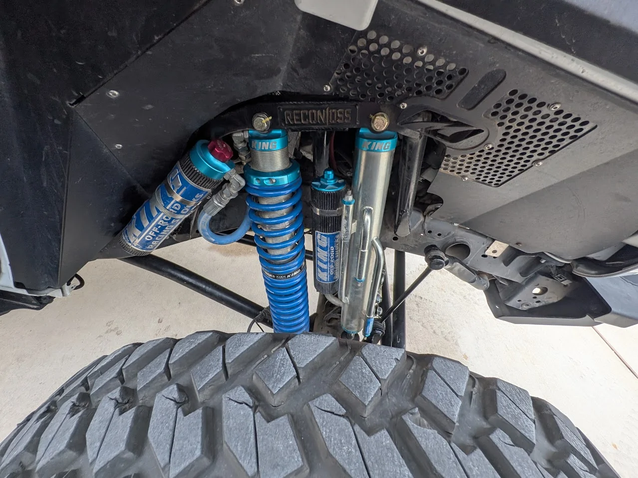

I have the antirock sway bar in the rear and am running the stock rubicon antisway bar in the front but I just added quick release sway bar links. Figured I would run it until it fails and then look at changing it out. For the steering I was running the stock steering gear box and pump with a redneck ram but the stock system just couldn't handle the 42inch tires and the steering box went out on it. I didn't even know GenRight made a kit. Just went with the PSC Big Bore Kit but it doesn't look like the GenRight one will work for a diesel. Hopefully I'll be getting the PSC kit this week. I also relocated the remote reservoirs to a better location.
Good info, thanks! I have the MC sector shaft brace that I never installed on my last JT (went to PSC) and am considering putting that on with their track bar brace. I wasn't positive the brace would work with the coilover bracket, so thanks for the pics. I'm going to try to make the stock steering box work for a bit since my credit card is still rebounding from the past few months. I do have a mechanical pump running off the V8, but I can tell the set up would benefit from assist. The pump gets hot and tired trying to move aired down 40s on rock.

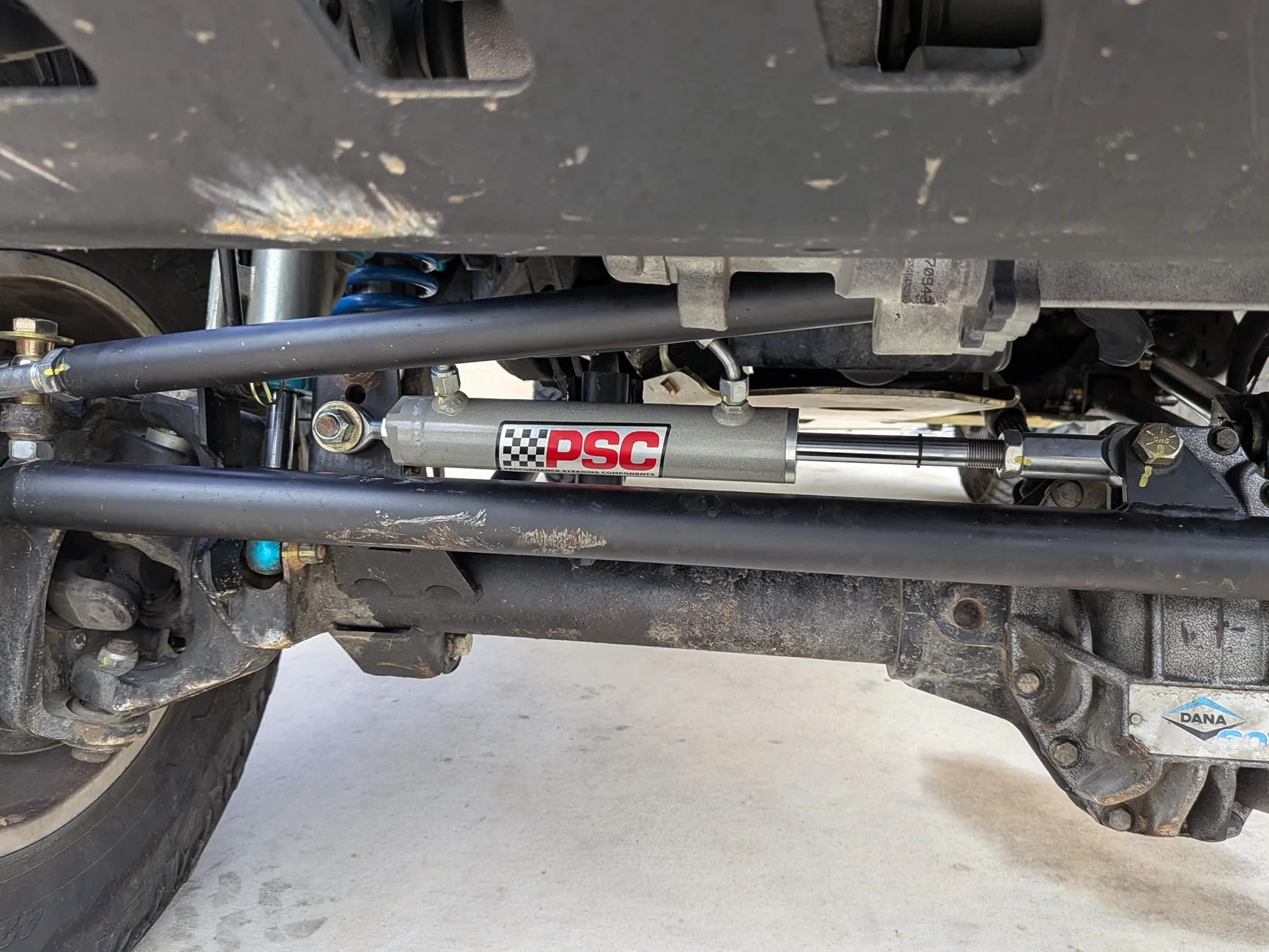

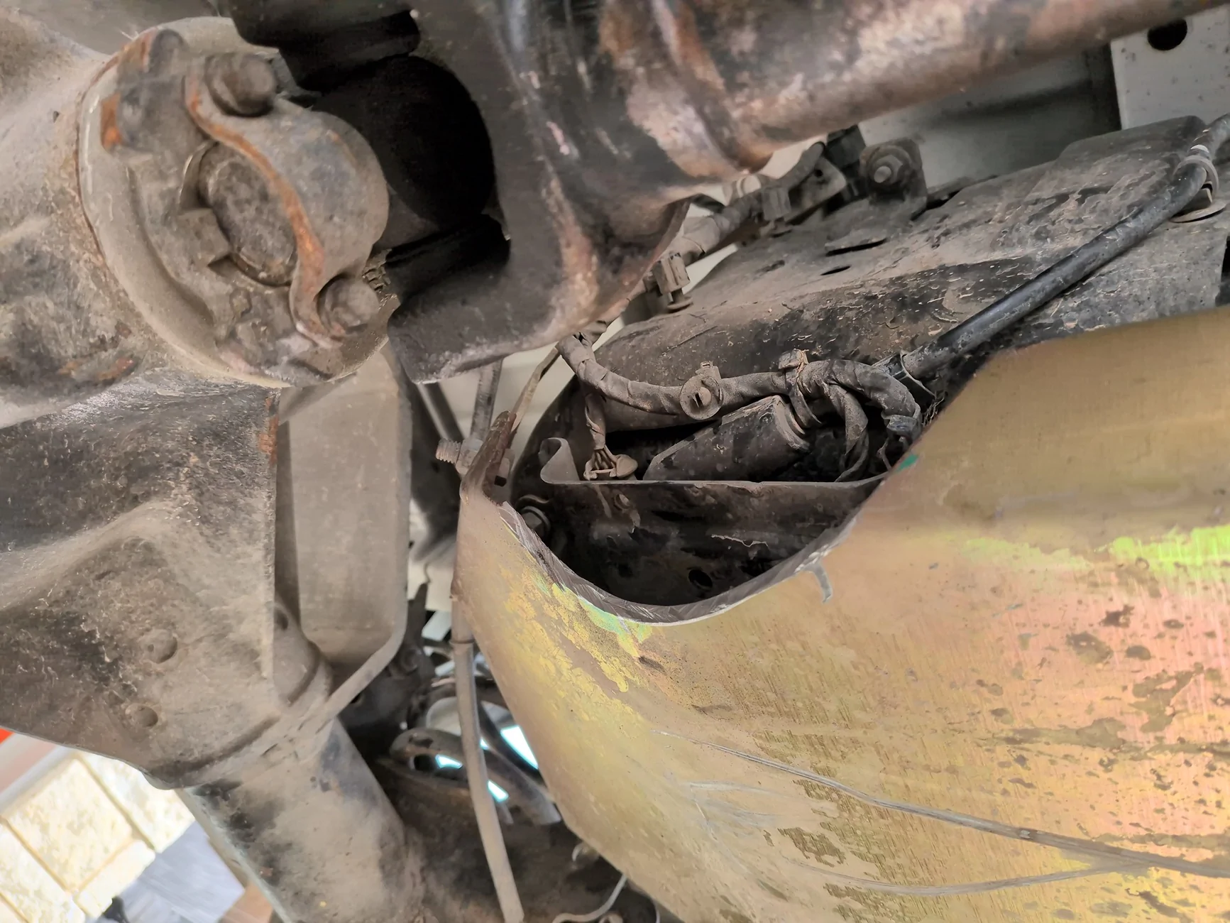

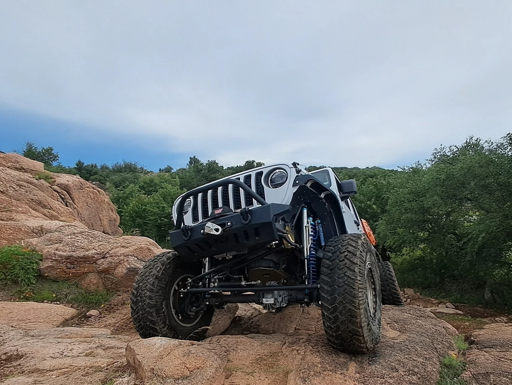

Finally was able to work on Maximus again. I got the PSC Big Bore Kit installed. Took it out to Off-Road N Chill's 10 year event at Wolfcaves and ran into more issues. The bolt for the V-Clamp on the downpipe came off so I had a huge exhaust leak going on. Front lockers stopped working. Turns out the pins got pulled out from the connector. I started getting the OEM Front Trail Camera installed after having the parts for over a year. The stupid back panel likes other have said just doesn't come off and I ended up breaking all the clips off and cracking it in several places to get it off. At least it is behind the seat so no one sees it. I also got the new Armorlite Flooring mostly installed. I left the passenger side off so I could still finish up some wiring. While I had the back seat out I zipped tied the levers open that prevent the back seat from lifting up when the vehicle is slated.

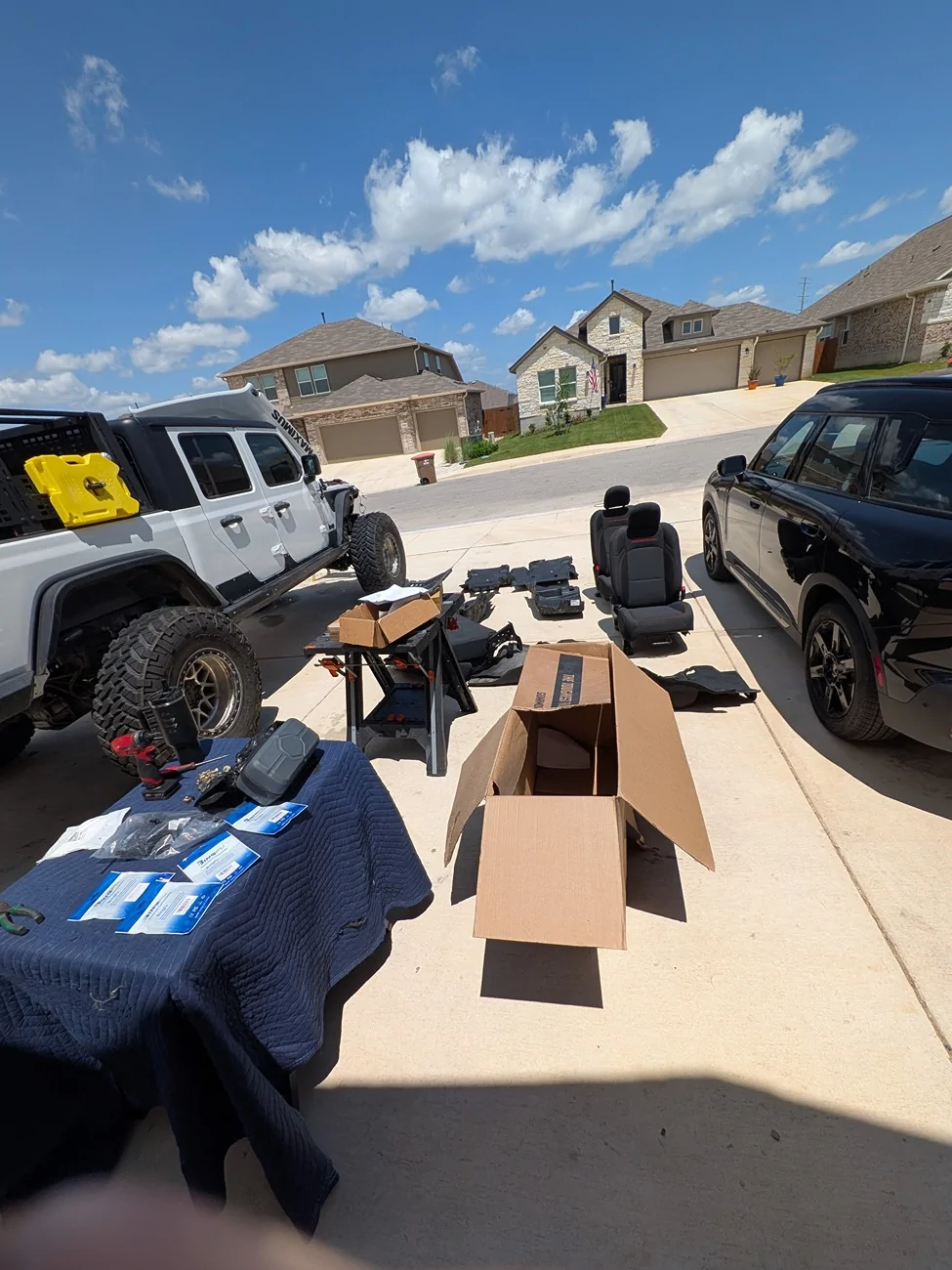

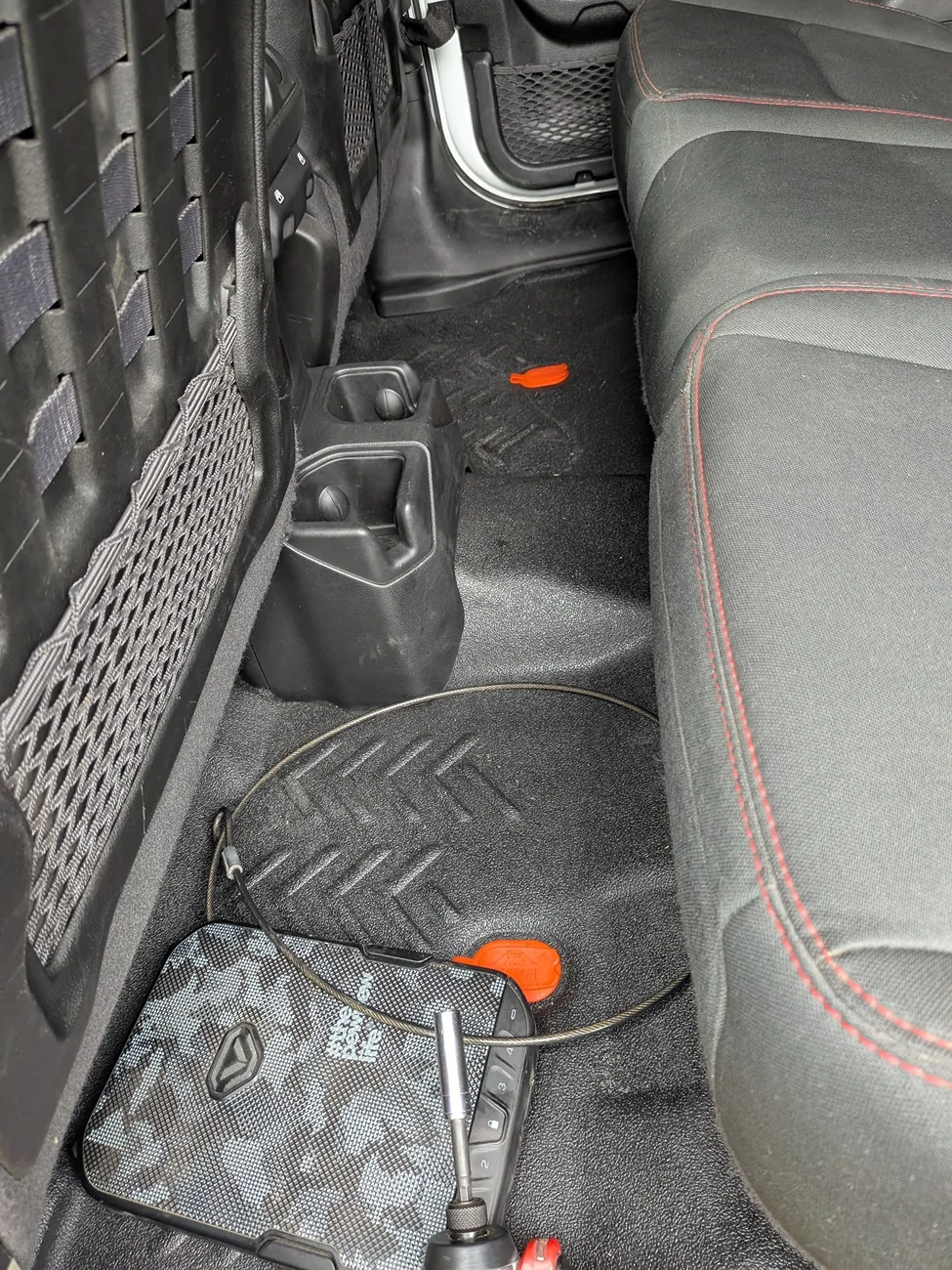

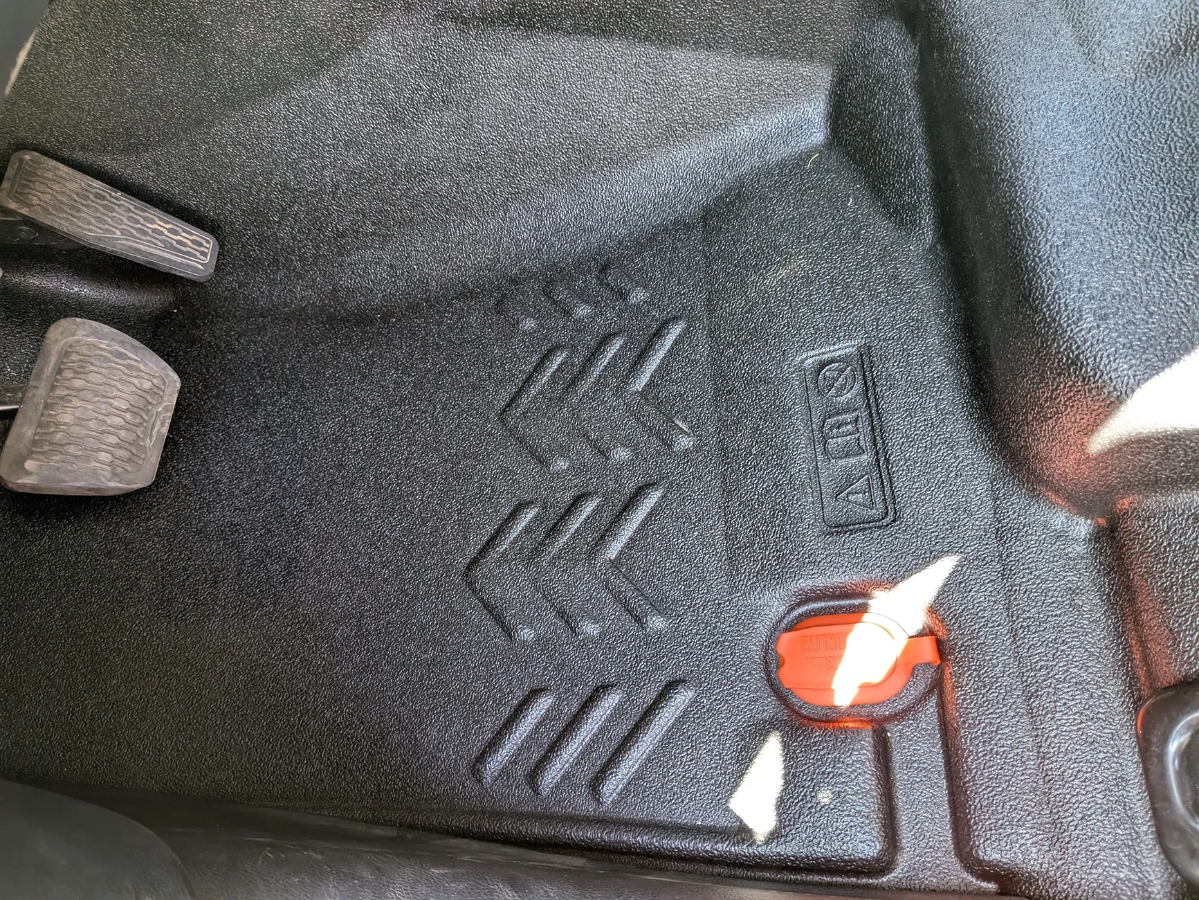

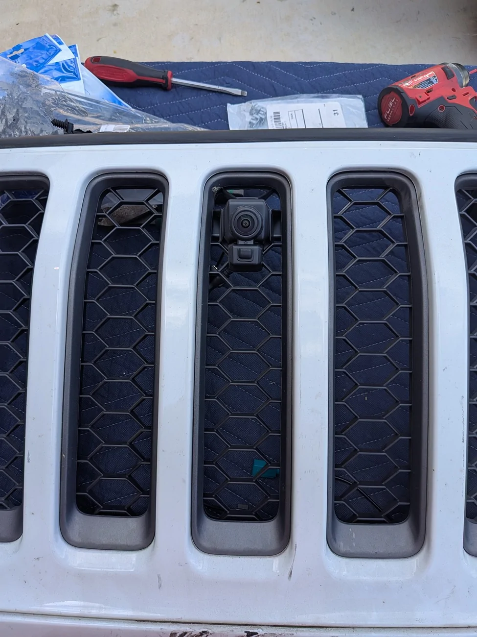

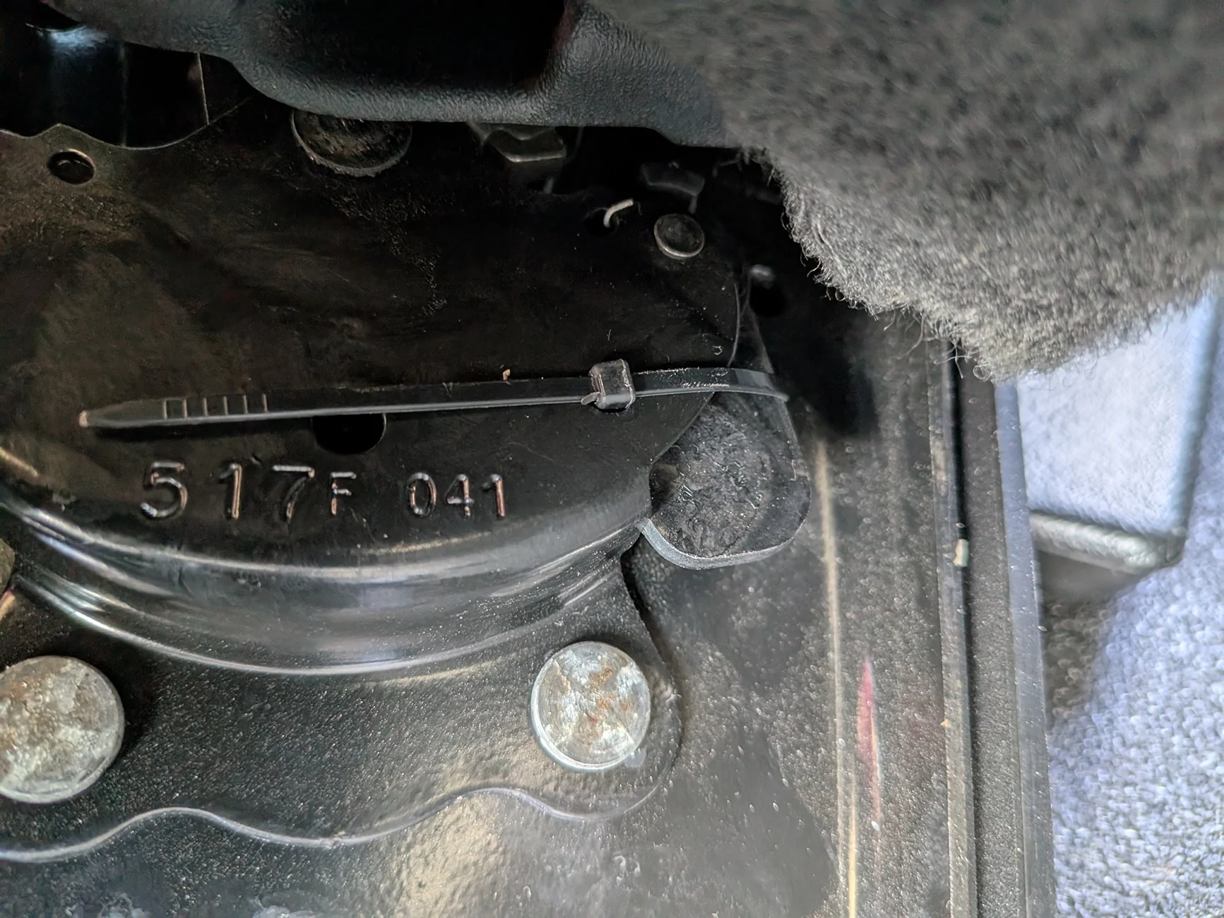

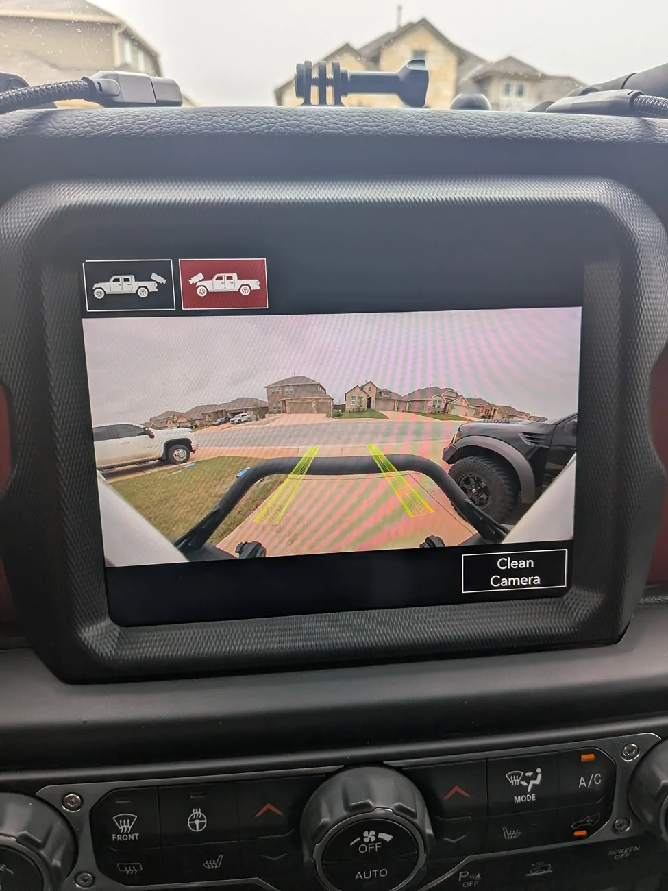

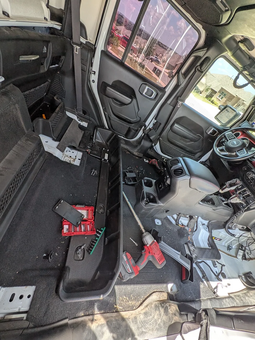

Got the armorlite flooring installed along with the OEM Front Trail Camera. It started pouring here yesterday and today I found out the back window is now leaking. 🤦‍♂️ Fix one thing and another one comes up. If anyone is looking for a nice carpet kit with weathertec floormats let me know.

I really like the wheel tracks on the oem front camera. Maybe I’ll consider the that one of these days and pick one up. How bad was the install?
MaximusTX
MaximusTX
Sep 15, 2023
749
1,062
TX
The install wasn't too bad. I decided to put it in the stock location and that back panel does not want to come off. I ended up cracking it in multiple places and broke most of the tabs off on it trying to get it off. Luckily since it is behind the seat so no one ever sees it I can just leave it like that. I also removed the full interior to install the new flooring which made the install a little easier running the cables. I started gathering all the parts for it almost 2 years ago and then took another 6 months or so before I actually installed it.

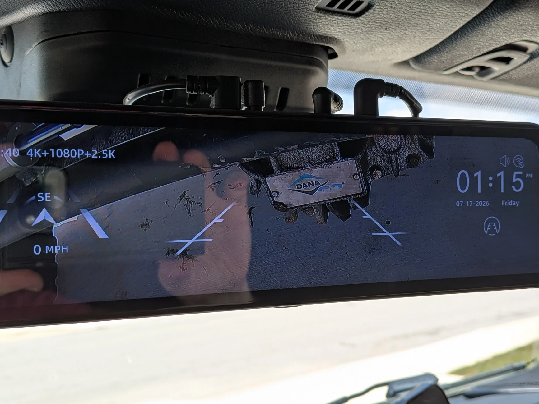

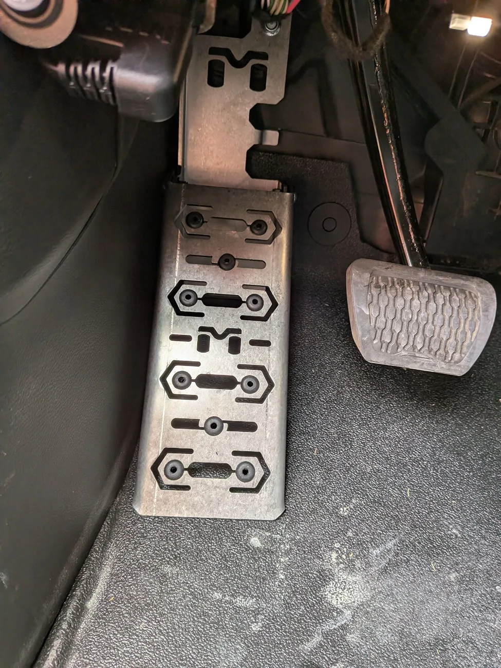

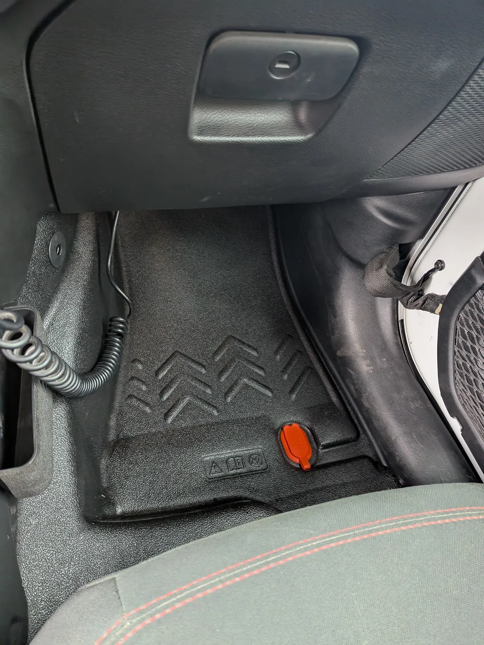

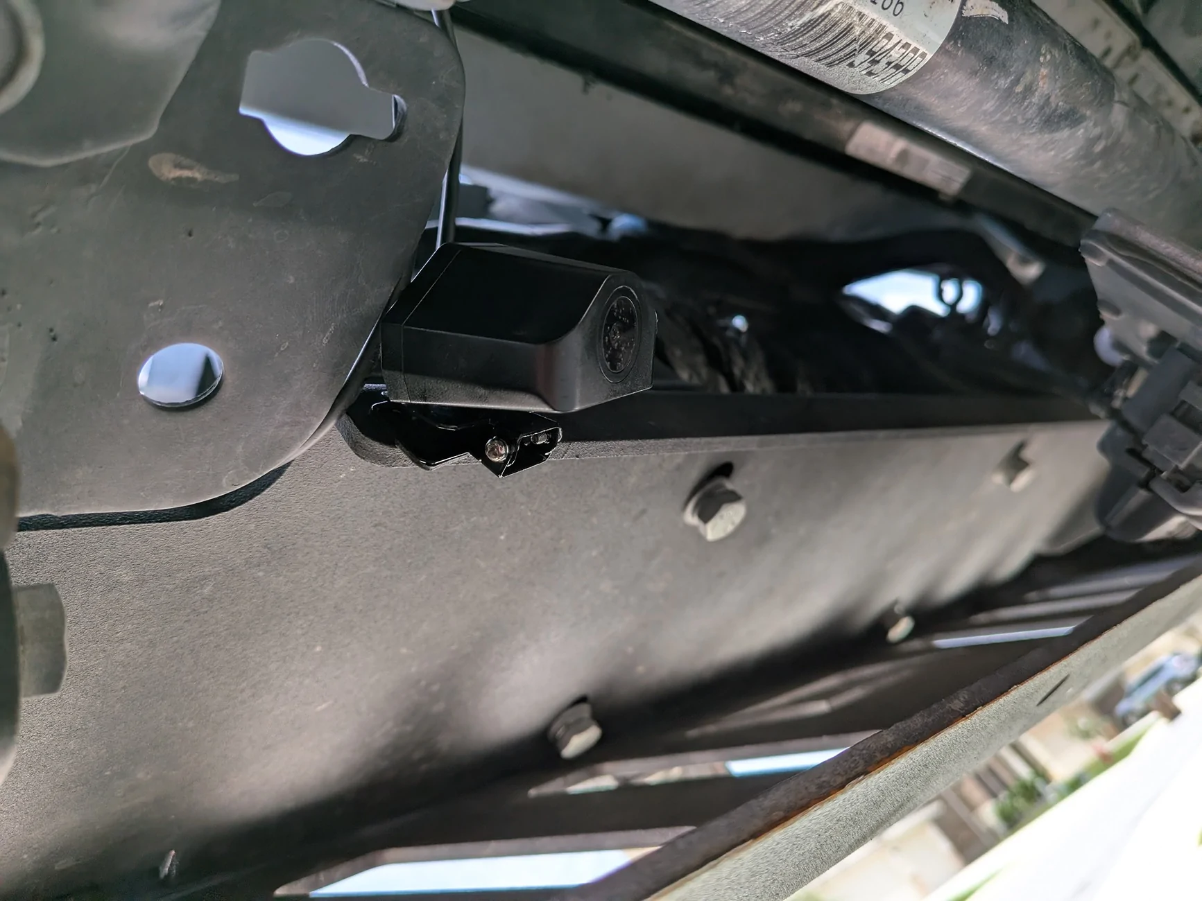

Back to getting some more stuff done. Got the MC Dead Pedal installed, Z Auto NoLimitz, trimmed the skid plate were the driveshaft keeps catching it, moved the Wolfbox Front Camera to the behind the bumper so I can now see the front diff. @Signing Spock I finally got around to re-wiring the starlink and have it wired to AUX3 and so far I have no issues with it but I did just get it wired.
