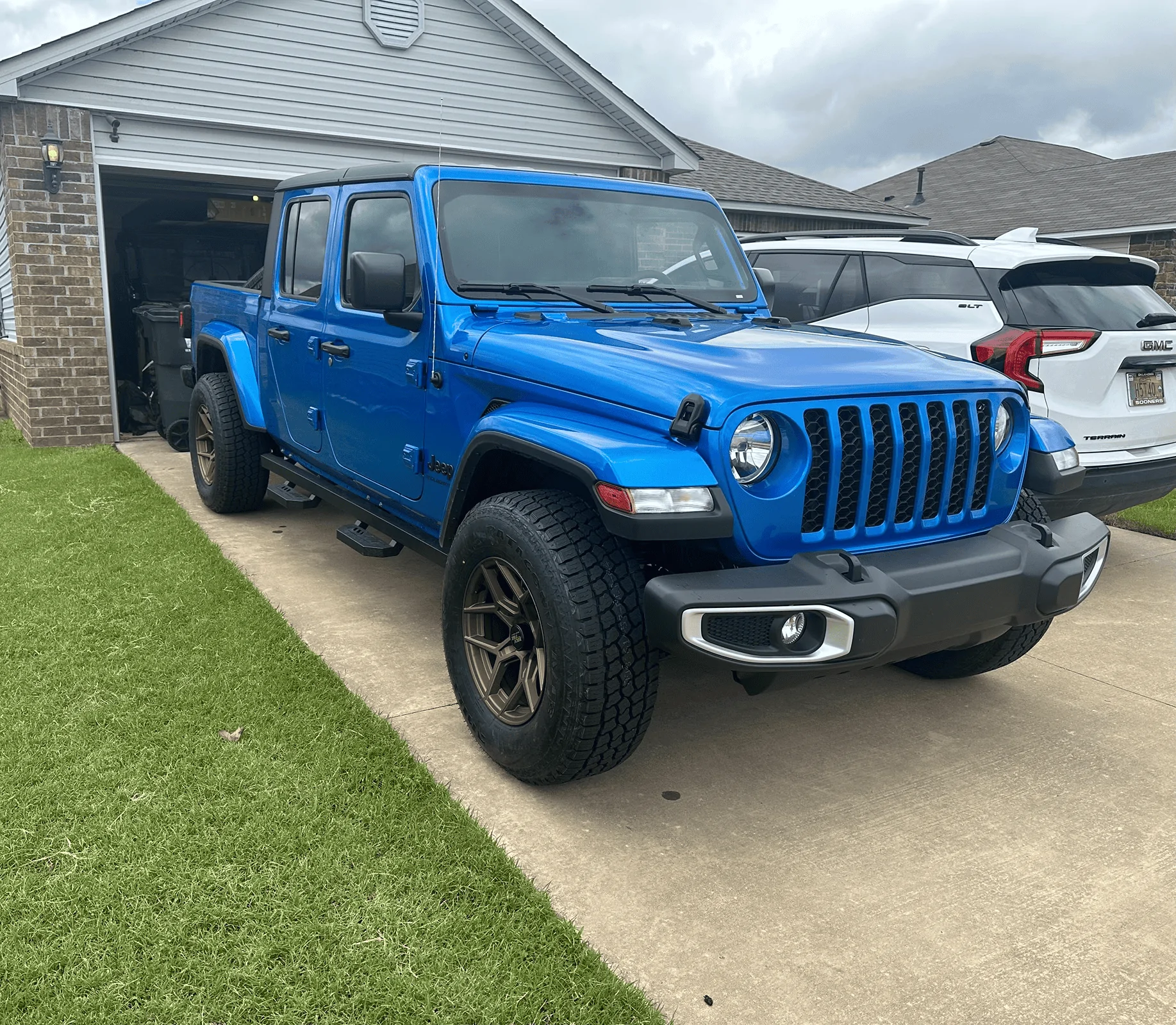

IDK why everyone defaults to 0 offset. This puts a lot of poke on the trim levels with Widetrack axles. Based off a sport your sizing sheet makes sense, but when you have 3/4 in more axle tube length on each side, that's almost 20mm of spacing per side your ignoring. Wide track axles get the same fitment with +20 that a standard sport does with 0 offset. AEV wheels are proof of this. I run stock Sport OE wheels, +44 offset, add a 1 in spacer that's 18.6mm offset and 37s fit with no rubbing just fine. If i ran 0 per your list, I'd be getting tickets, unnecessarily reducing scrub radius, and chipping more paint. I would add a section to your list to cover trims with Highline/Rubicon fenders and Widetrack axle vehicles. I could' still go further in as i have room to spare, my stock Mojave wheels are 30 something offset and they will fit 35s and some 37s with no rubbing as well. I'm not saying this list is wrong, I'm just saying your safety margin of making 0 offset the baseline is a bit excessive considering stock is +44. telling someone they need to add almost 2in of offset per side to fit bigger than 33s is a lot. your list is more accurate for sport trims and 9in plus wide wheels. This list would work for most owners out there but there will be quite a few Sport Max tow, Deisel, Rubi/Mojave owners who will be annoyed a bit irked that they spent 5k for wheels and tires and they ended up with a Hot Stance Boy SOFLO look instead of what they wanted. just my 2 cents.
Jeep Gladiator Member Input Needed! Jeep Gladiator Wheels | Buyers Guide 1715080848324-4u
this -12 on a sport, courtesy of @Jccook777
Jeep Gladiator Member Input Needed! Jeep Gladiator Wheels | Buyers Guide IMG_1922
This is +18 on a widetrack vehicle
36 whole mm's of difference, same fitment. imagine if i had -18, ewwww.

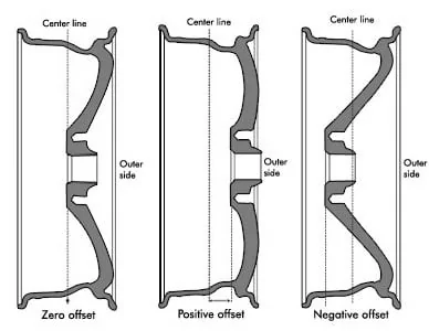

I would add the stock wheel offsets to the introductory summary for each trim, and perhaps a simple graphic or an embedded video that explains offset - positive, negative, and zero.

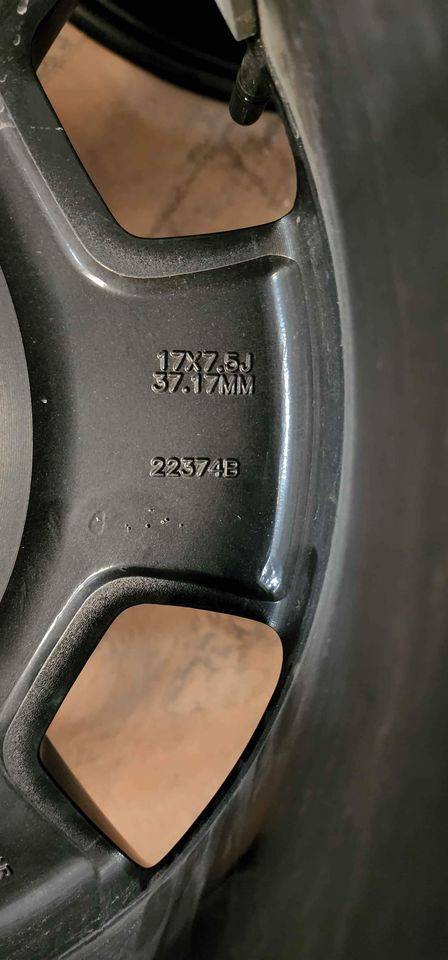

You may also mention that Jeep, and probably others, cast the manufactured offset in the inside backside of their rims. So if anyone isn't sure what their starting point is, they can simply go and take a look.

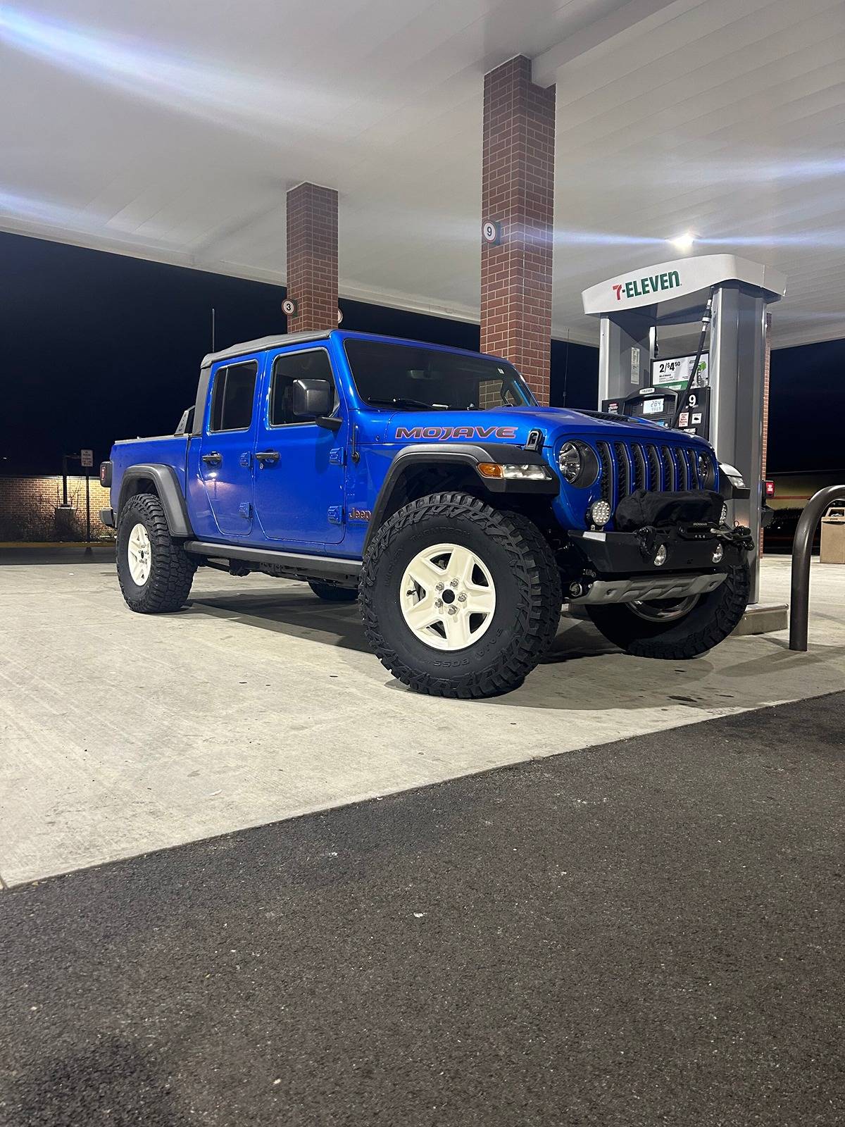

Rubicon is +44
Mojave is +37.17
