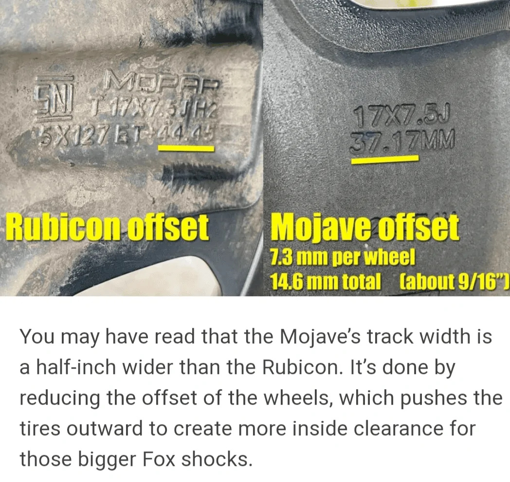

do the mojave stock rims have the same offset as the other JT?
really are they all the same?
Im looking to buy some new black rims for the JTMT and dont want the silly wheels out of the well look.

I believe Mojave is a +37 ... Rubi +44 .. Not sure about the other trims ... will have my mojave wheels for sale in about 2 weeks ..

Mojave have little bit more offset, but with factory Falkens and larger tires no real stick out, can’t remember if you are a Max Tow, but if not your axle is narrower anyway should not be a problem….jack

I you add 1.75" Spidertrax spacer to the stock mojave 37.17 mm wheels does that equate to an approximate -7.25 wheel? Thanks!
