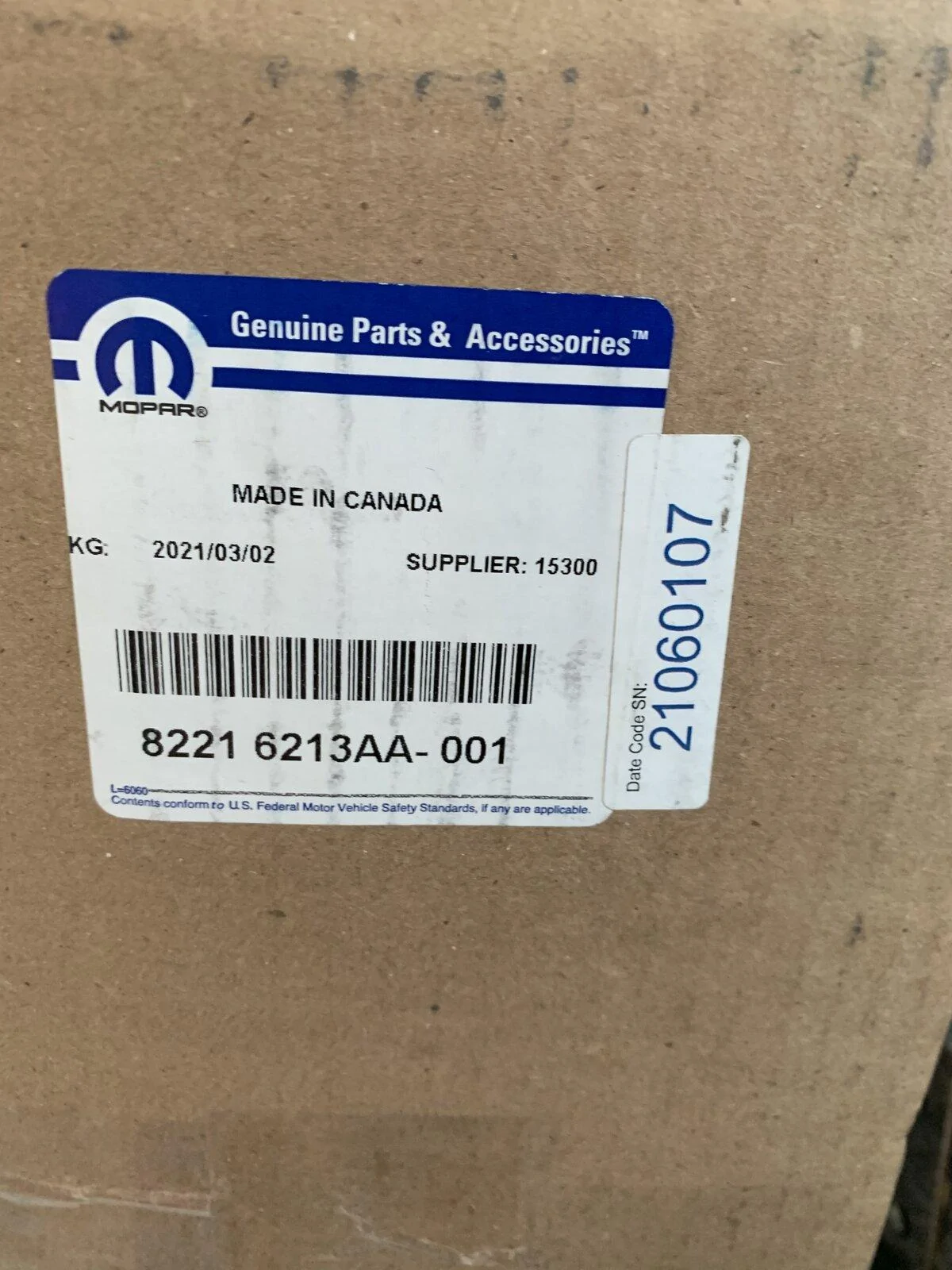

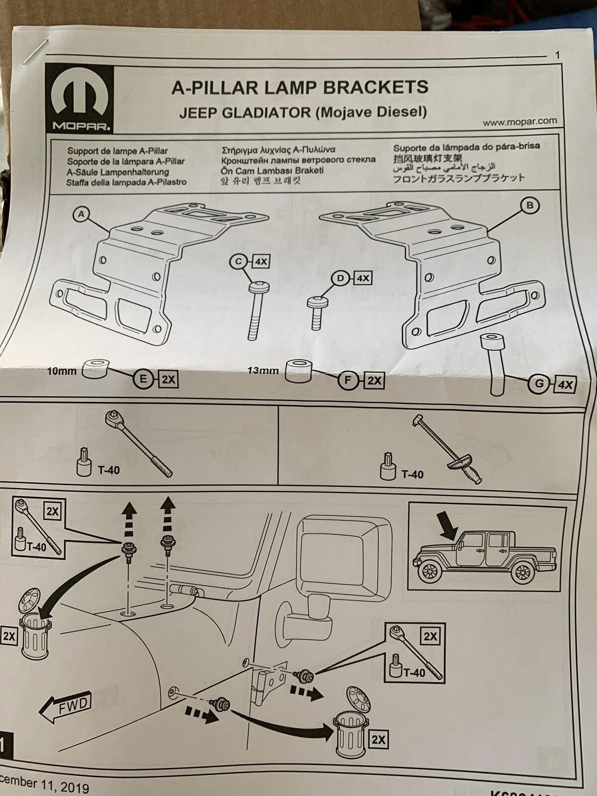

I found the diesel specific Mopar brackets, expensive, but I’ll take oem.
Jefe1018
Jefe1018
Mar 4, 2020
48
3,123
5,252
NV
Update: the right part showed up!
The correct part no. for Mojave and Diesel is 8221 6213AA-001.
