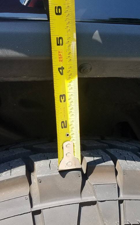

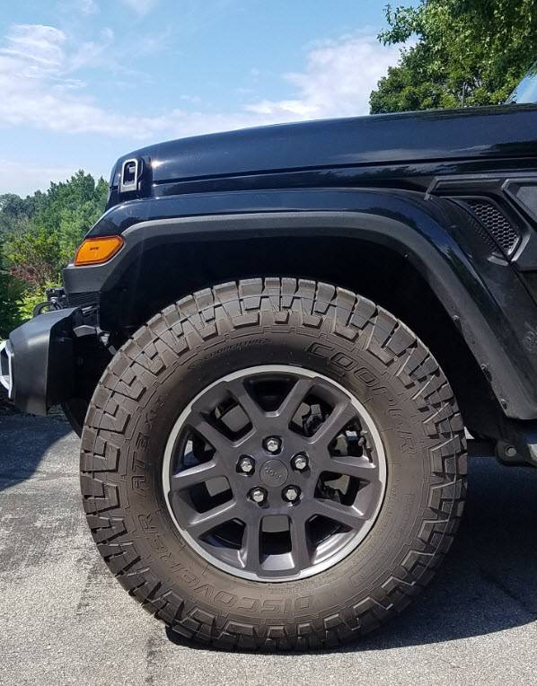

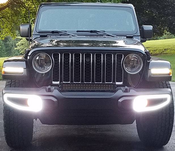

Not sure if this helps or not. I have a 2022 Overland. Have a Mopar Lift still in the box. But I already put 35s on my stock rims. Cooper Discoverer AT3 XLT 285-75-18. Specs below. Liked these for sidewall strength for towing, lighter weight for better starting, stopping and mileage. And I like the narrow stance. Prefer the Pizza Cutter style as opposed to the wide balloon monster tires. Anyway, no rubbing any where. Stock fenders and front bumper. Installing the Mopar Lift will only increase my clearances. NOTE: This is a daily driver. No Rock Climbing or forcing the suspension into outrageous contortions.
Jeep Gladiator Mopar lift + 35 x 10.5 on stock rims, Sport Max Tow Cooper285-75-18
Jeep Gladiator Mopar lift + 35 x 10.5 on stock rims, Sport Max Tow Cooper-in-Fender
Jeep Gladiator Mopar lift + 35 x 10.5 on stock rims, Sport Max Tow Cooper-in-Fender-Inches
Jeep Gladiator Mopar lift + 35 x 10.5 on stock rims, Sport Max Tow Ring-LED-White
