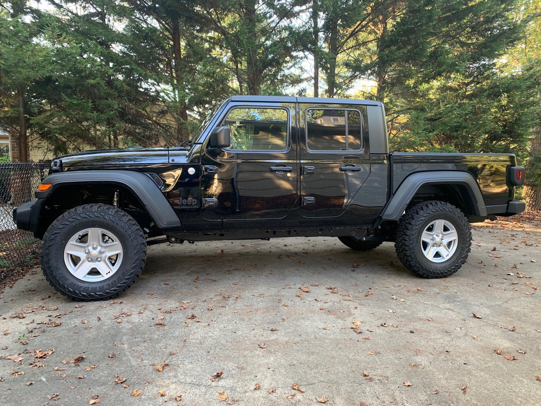

I've had a 2.5 inch Readylift SSt spacer kit on mine since it had 300 miles on it, now got just over 42,000 miles on it. No issues that i can tell, rides as good as stock other than slightly rougher 37's I'm running now

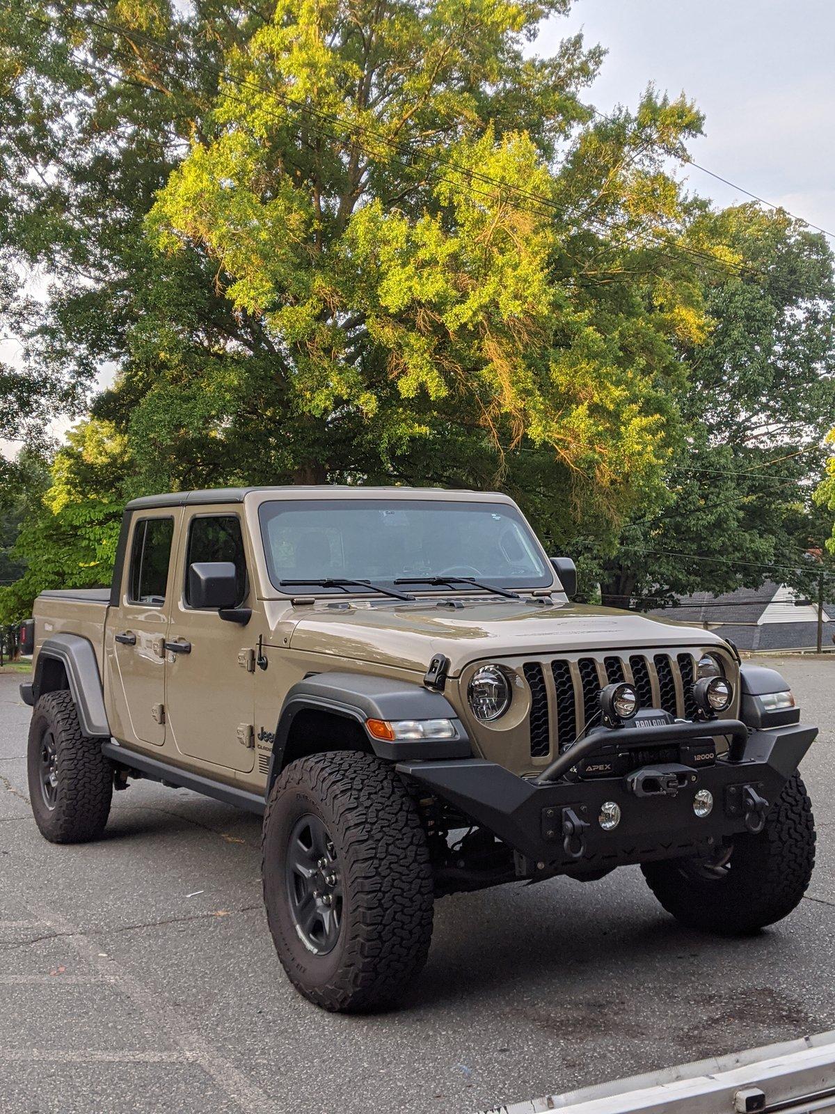

Ummm, sure looks copmpletely wonky and like your riding the stops on the rear? :whatsgoingon:
3.5" skyjacker coil spring lift. It doesn't sag too much under a load and rides pretty good. Probably more than what you're looking for but just shows that you can do a spring lift and don't completely lose your "truck" abilities.
