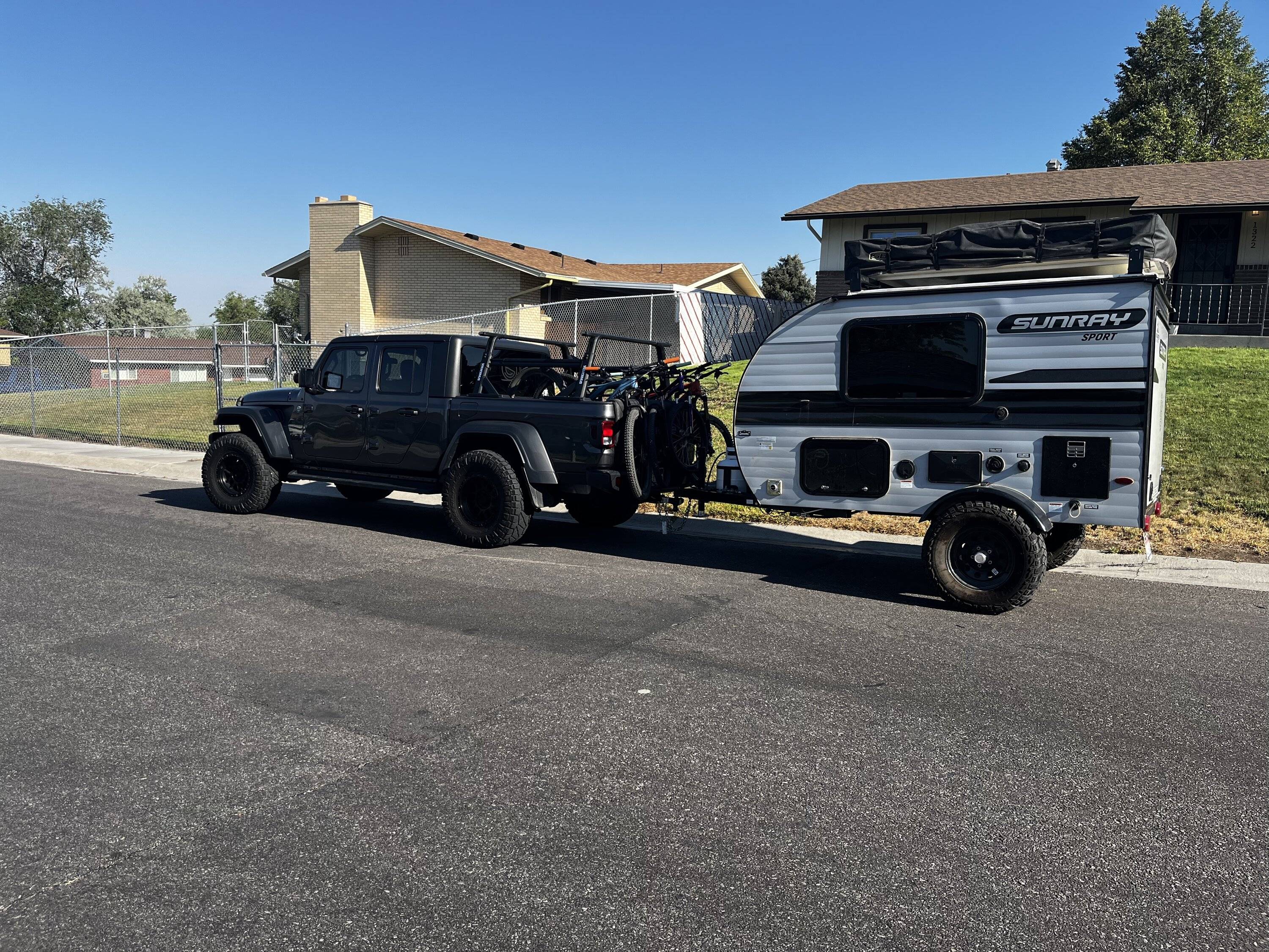

This is my typical weekend camping trip load, sometimes I exchange the MTBs for 2 pit bikes. I keep it around 70-72mph on the interstate and have a lot of elevation change in the areas we go. Truck pulls it fine. I have a 2.5 teraflex lift that uses a small spacer in the rear and keeps the original max tow rear springs. I also have a Falcon adjustable steering stabilizer that I will stiffen up for long interstate trips. I also installed the OEM trailer brake controller and that seems to work fine. I don’t use a WDS hitch or anything like that.
It’s definitely not the best towing vehicle but it suites my needs fine, the fuel stops are just a bit more frequent.
