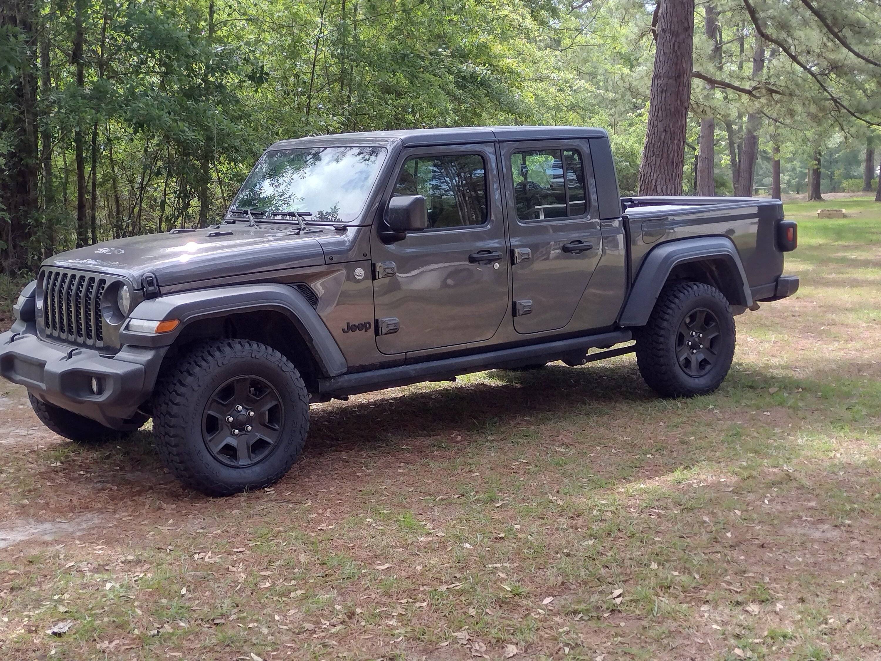

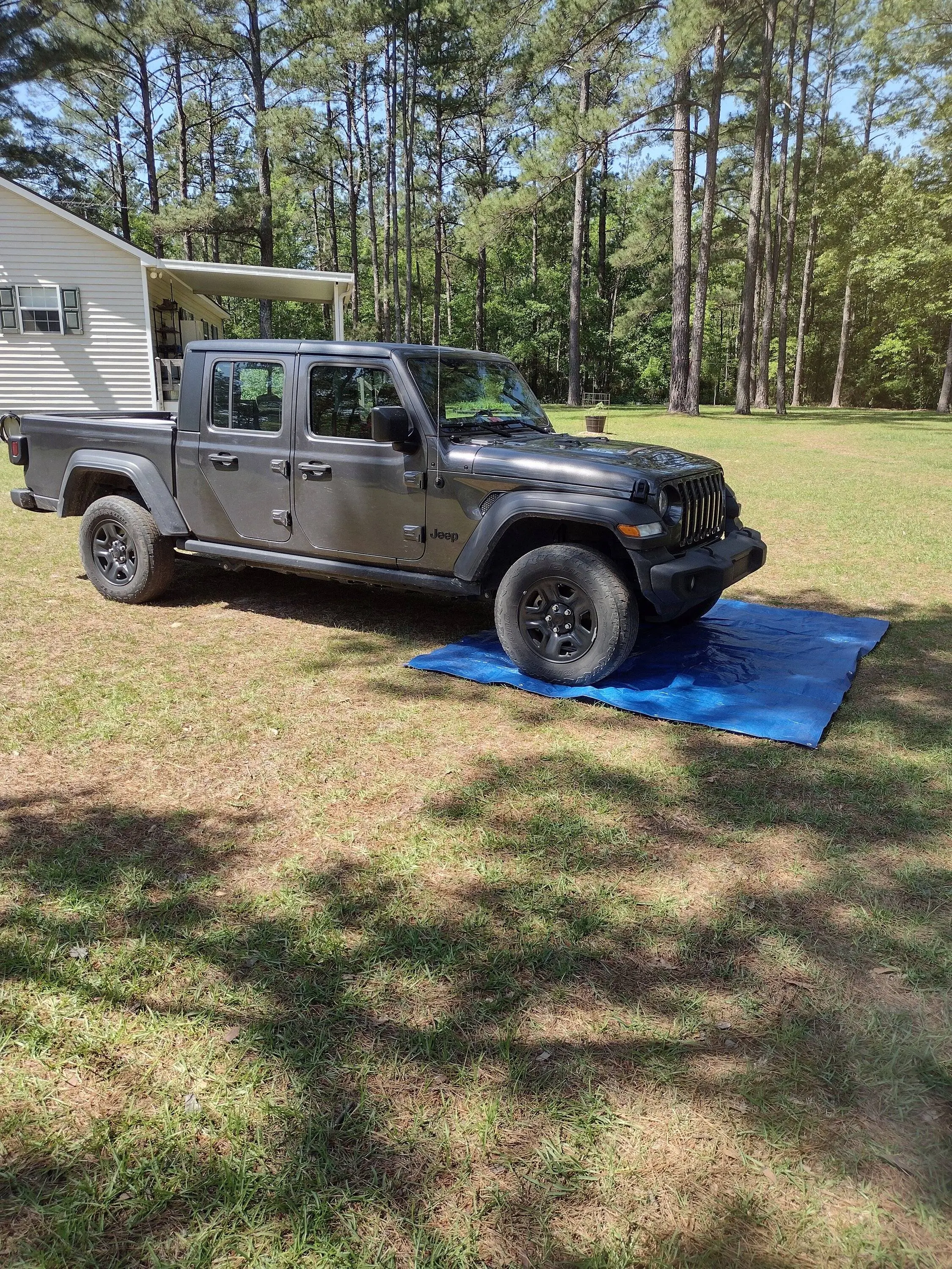

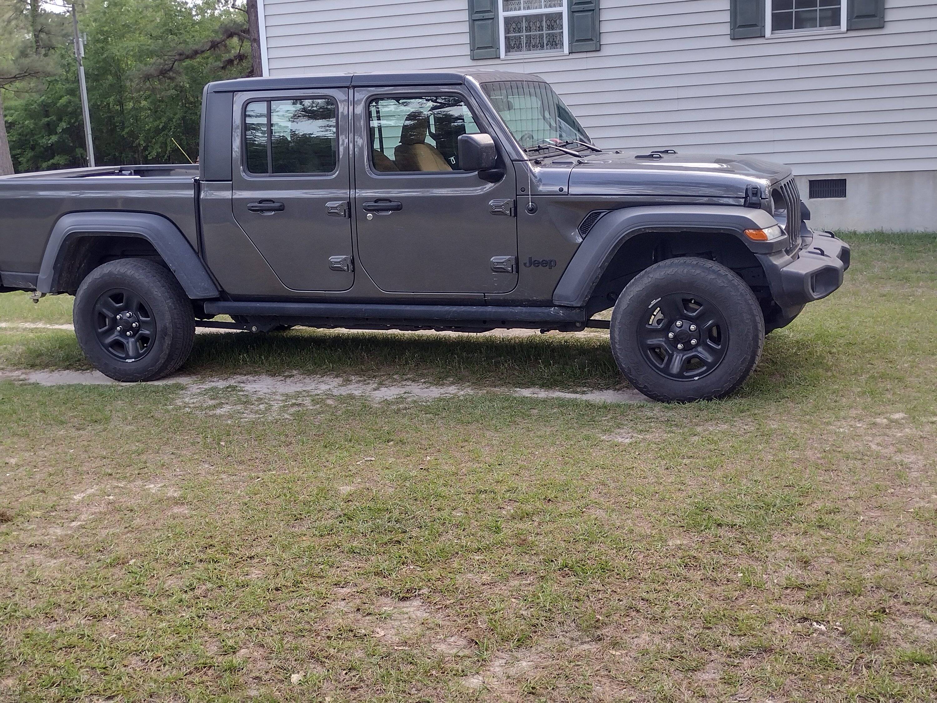

Thanks to all who gave advice.This week I installed new front springs from a 2022 JT max tow sport s on my 2021 JT sport max tow, added one inch teraflex spacer, and installed Mopar LCA for two inch lift to correct caster. Reduced my rake from 2.25 inches. To 1/2 inch. Ride is amazing. Wouldn't have thought sport s coils would have been one inch taller than sport coils , both being max tow. Pleased with results. Thanks to all who provided advice and insight. One more question? Front raised nearly two inches. Should I add the teraflex shock extenders I purchased to center shock stroke? Thanks for all advice and opinions ?

And yea I would put on the shocks extensions

Thanks! New tires and rims going on tuesday.swapped from sport max tow springs to sport s max tow springs because his truck payload was less than mine due to his options on his truck. Nearly 275 lbs difference. Felt like that would help preload for bumper and winch upgrade.
Jeep Gladiator Thank you! Swapped to Sport S max tow springs IMG_20230421_172133599_HDR
Jeep Gladiator Thank you! Swapped to Sport S max tow springs IMG_20230421_172029565_HDR
Jeep Gladiator Thank you! Swapped to Sport S max tow springs IMG_20230420_114008968_HDR
Jeep Gladiator Thank you! Swapped to Sport S max tow springs IMG_20230420_113657825_HDR

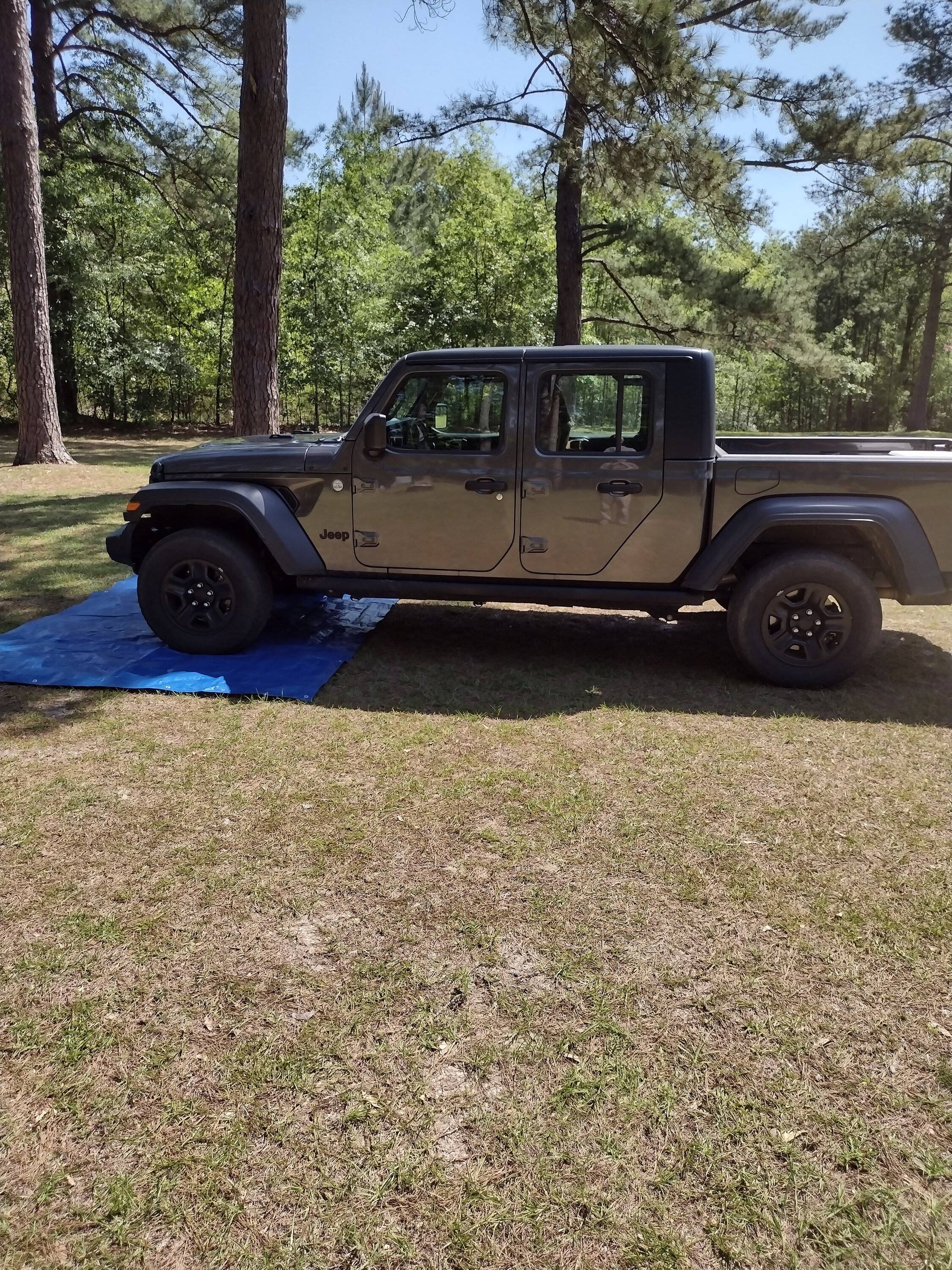

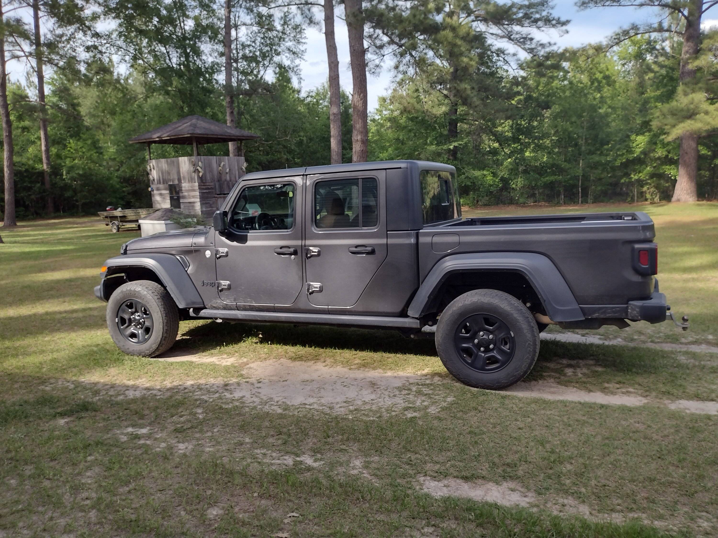

Installed new Mickey Thompson Baja boss at, one inch teraflex spacer front,new Mopar LCA from 2 inch lift. Liking the results!
