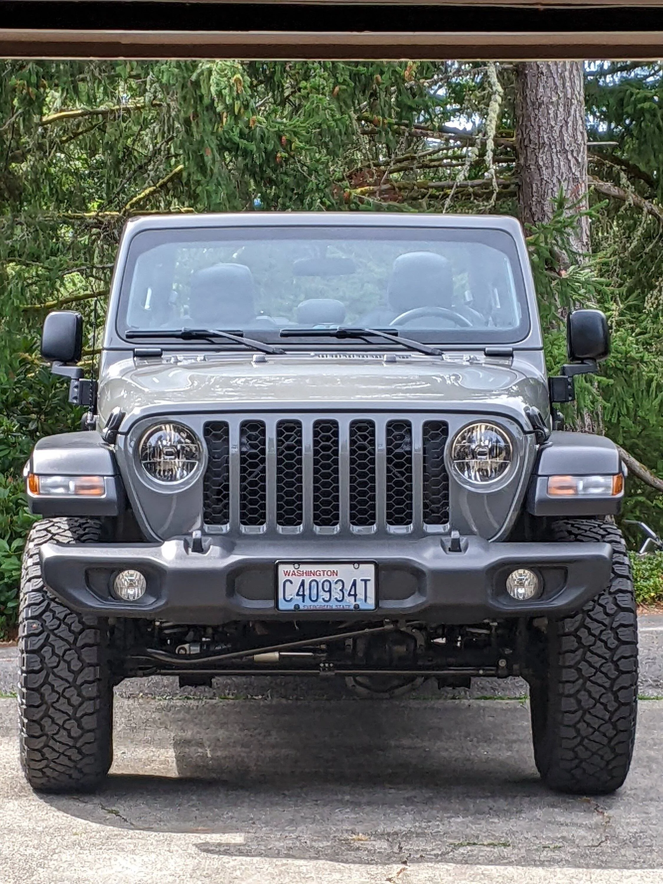

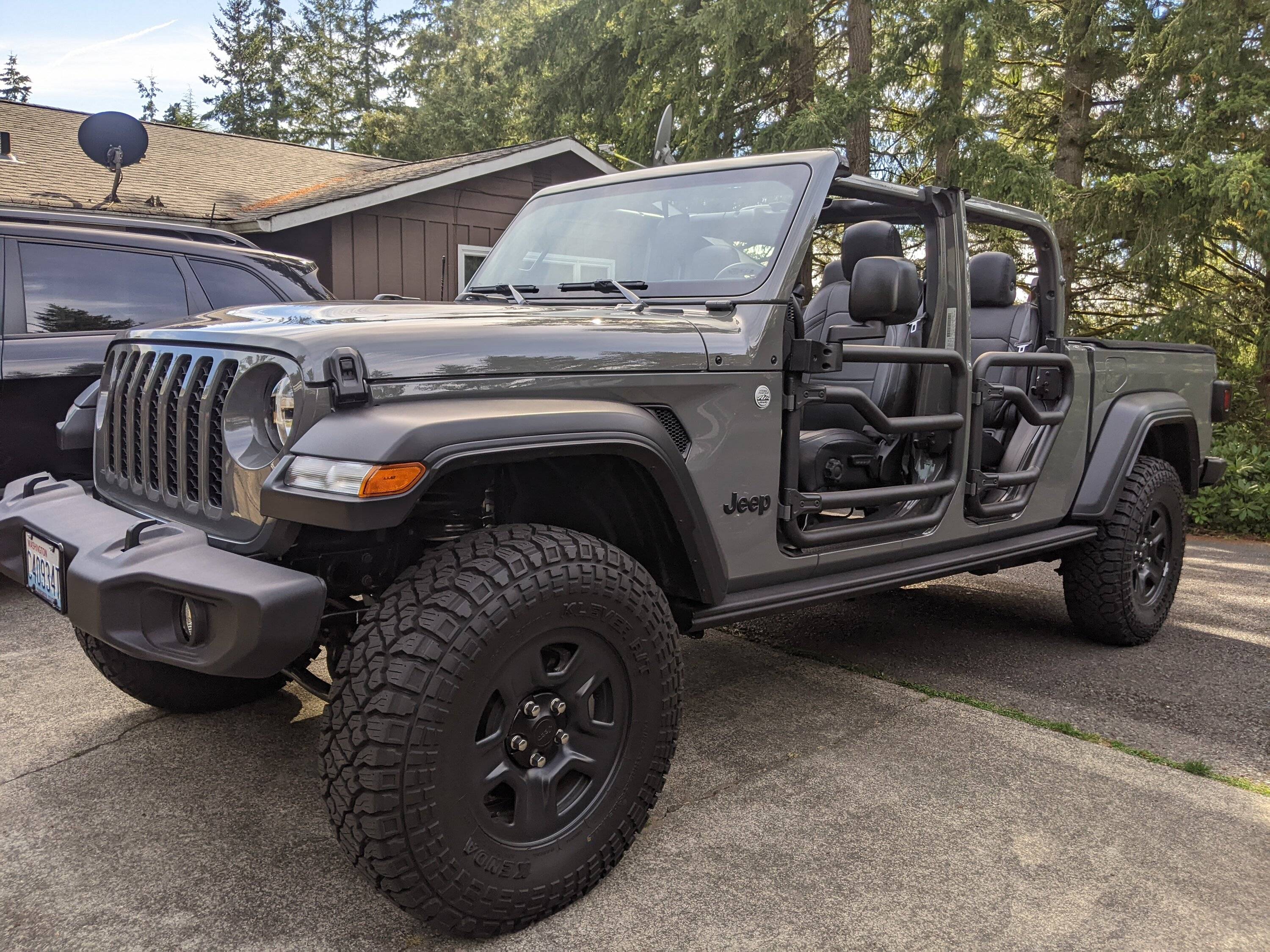

2" Eibach front springs and 1 3/8" Icon rear spacer. Sits perfectly level. 35" tires.

ATL_Rubi
