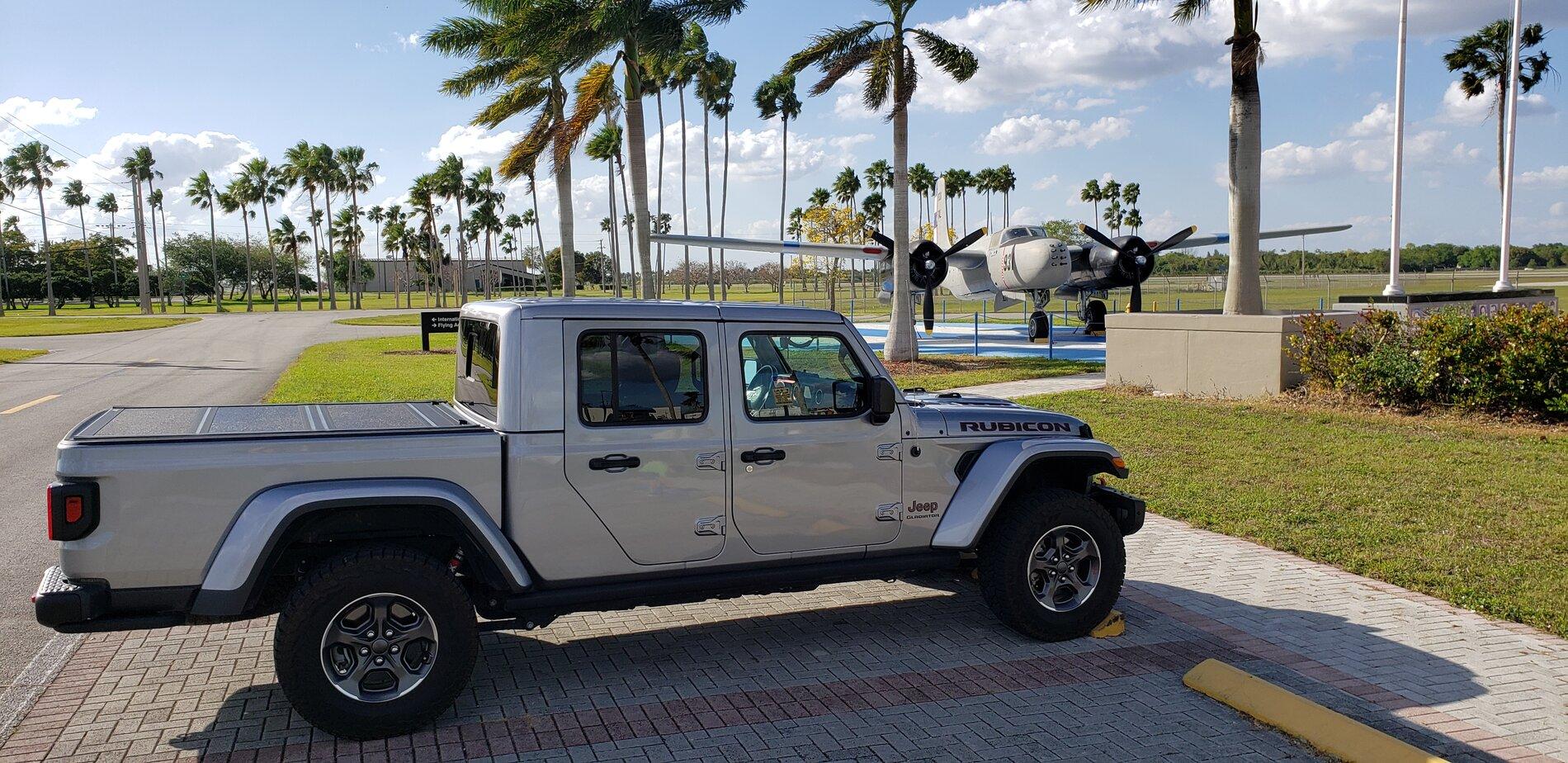

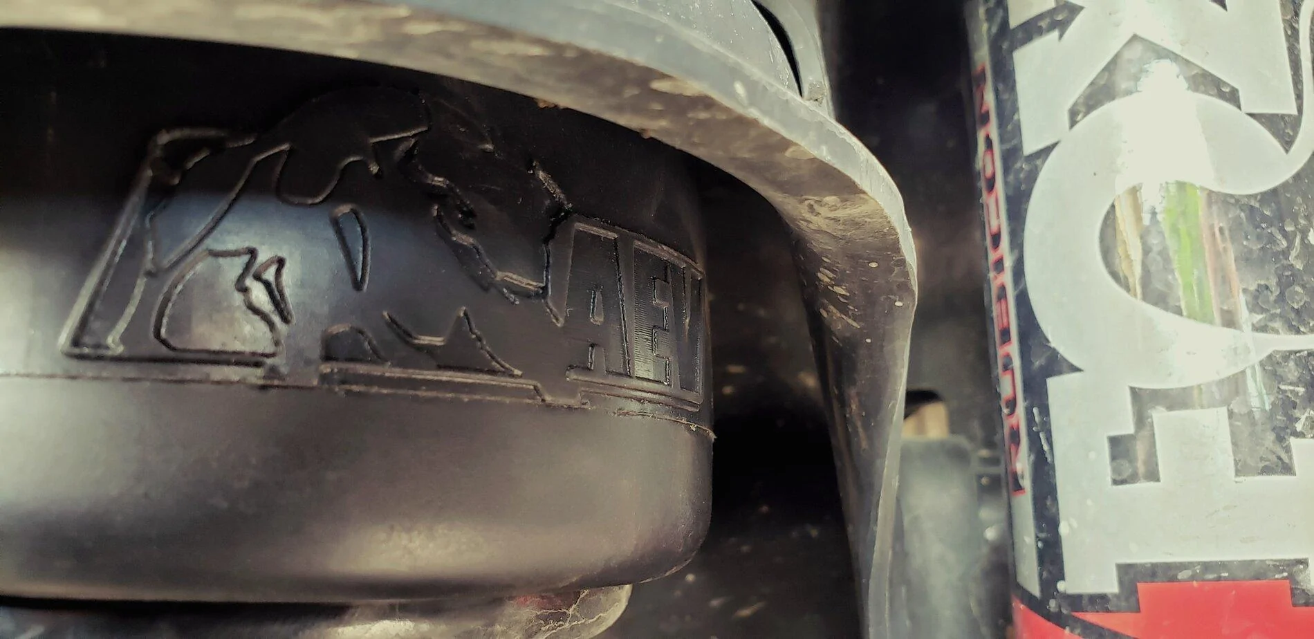

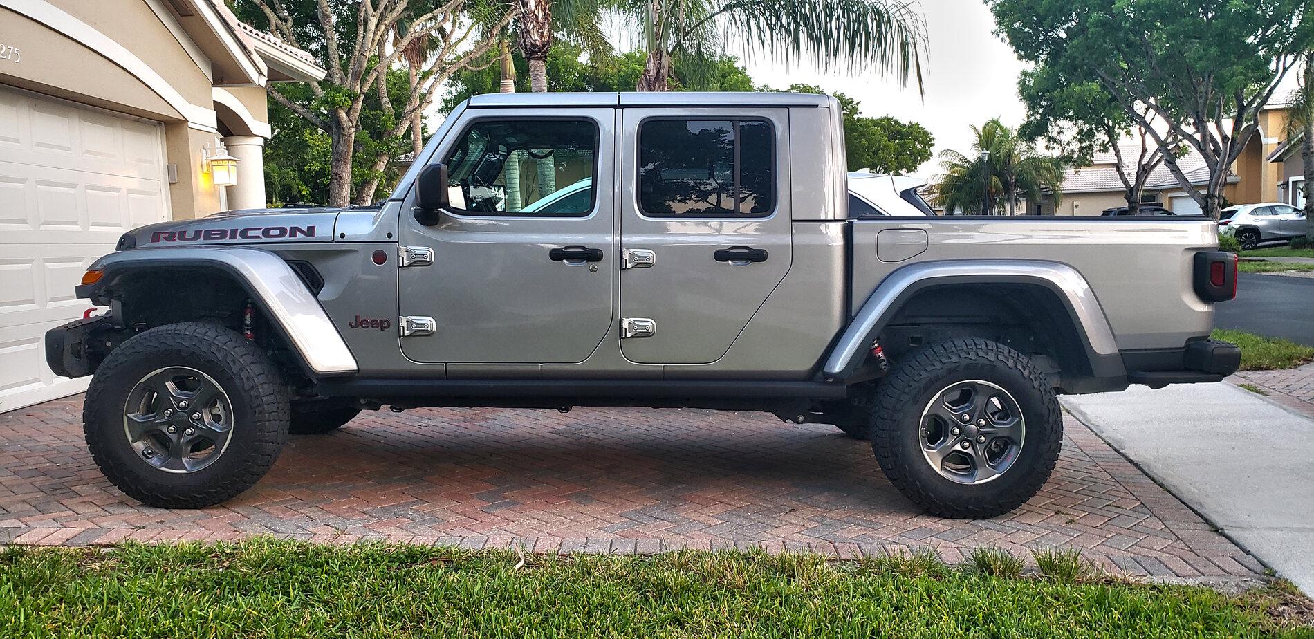

AEV Spacer lift Installed,
Took a while but......2020. (nuf said)
Alongside Synergy's adjustable track bar and Fox steering stabilizer.
Steering is more precise now on curves. I appreciate the Fox being on the stiffer side.
Now I need to fill those wells.
Borahs and 37's Nittos would do the trick.
...and gears.
