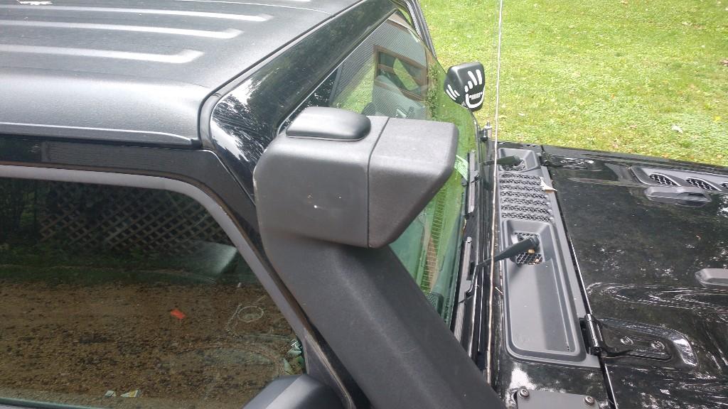

Here's the stock xm antenna mounted to the snorkel. Remove the front screen, drill a hole and file it square. Easy.

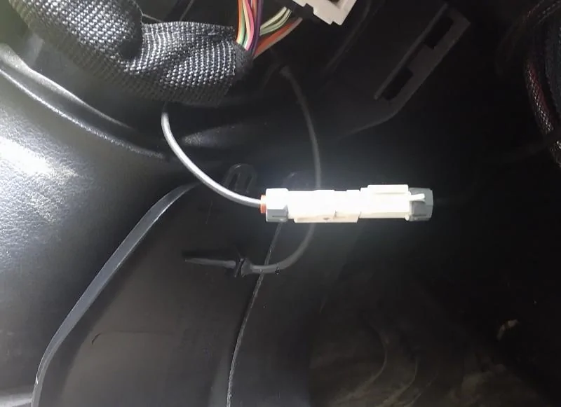

Here's where the antenna wire terminates behind the kick panel. That's the driver's door electrical disconnect at the top of the photo

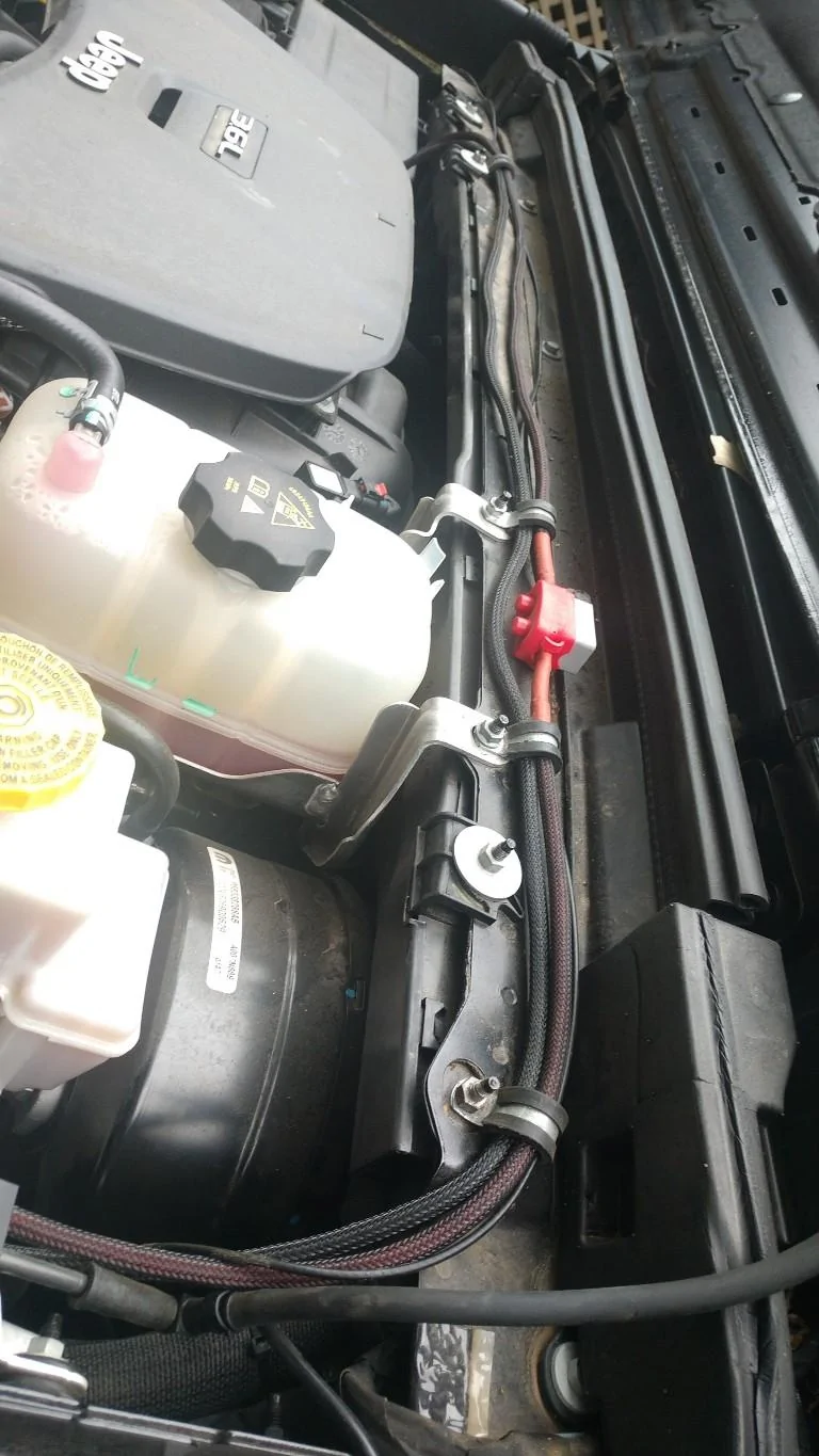

I ran the stock antenna cable through the firewall plug by the master cylinder and over the engine bay in front of the cowl. Here, it's secured by clamps holding my aux switch panel wiring

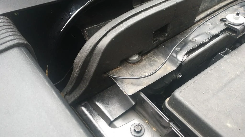

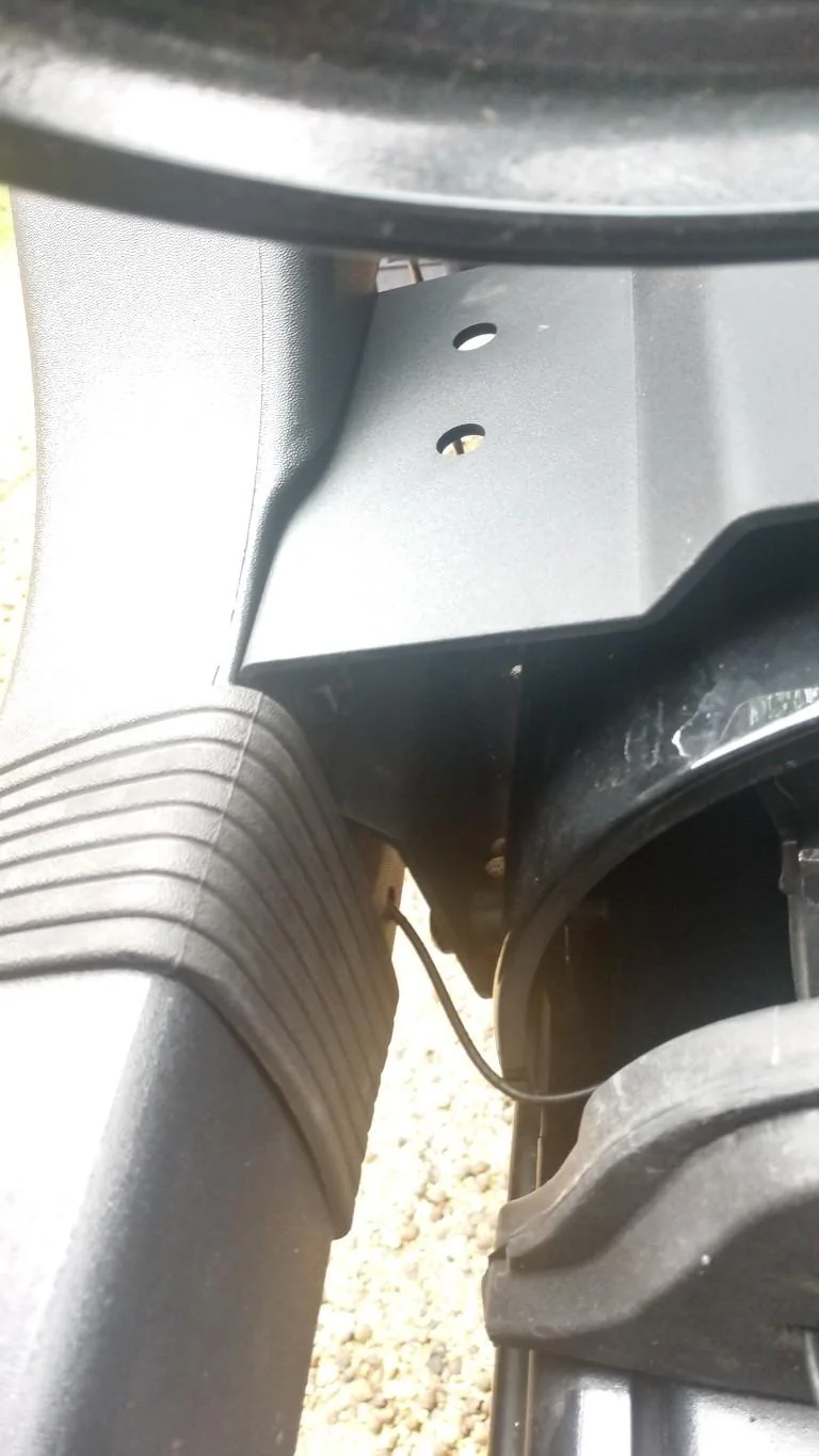

I ran the wire out between the hood and cowl by the snorkel as shown

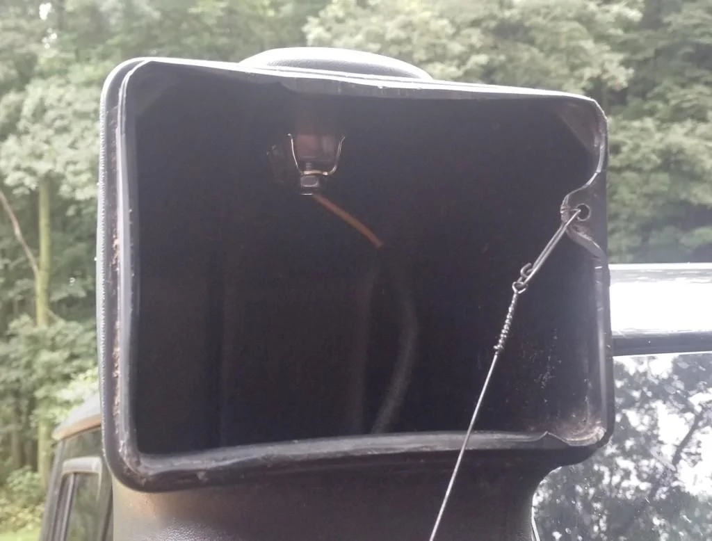

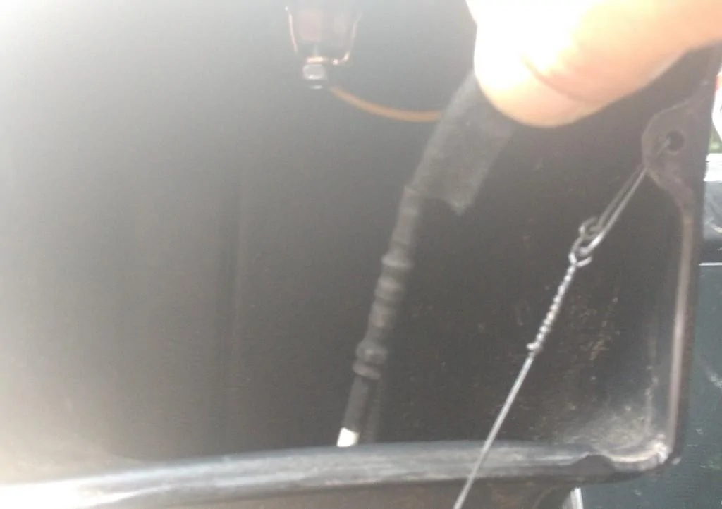

Here the antenna wire enters the snorkel through an 8mm hole I drilled for the purpose
The antenna wire has a disconnect about 6 inches from the antenna. A bit of putzing with a small flat top screwdriver will allow easy removal of both ends of the plastic fakra connector. (Allows passing the antenna wire through a smaller hole into the snorkel. If you want to leave the connecter on, you'll need to drill a much bigger hole in the snorkel). I pulled the wire up to the antenna, plugged it together and secured it with heat-shrink tubing. Easy...
Here's the inside view of the snorkel without the bird catcher attached
It's not hard to do and requires NO ADDITIONAL parts other than a stubby piece of heat shrink.

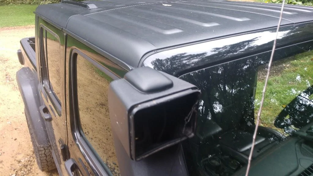

Testing, Testing....One, Two...
The results are immediate and enlightening. I no longer get xm dropouts every time I pass through the shade of a tree, phone pole, building etc. I can now get xm in my shady driveway. Couldn't before. Signal is no longer bothered by my Yakima roof rack.
