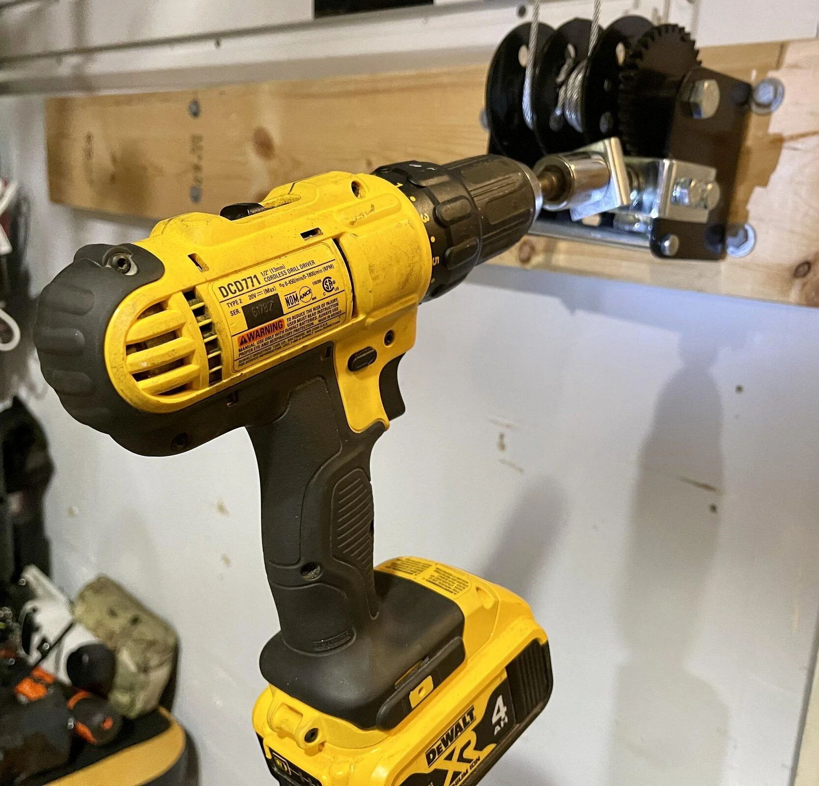

it definitely does take alot to go up and down... i was debating if my drill would work to ease the process a bit

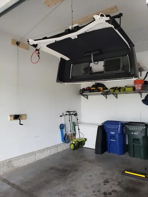

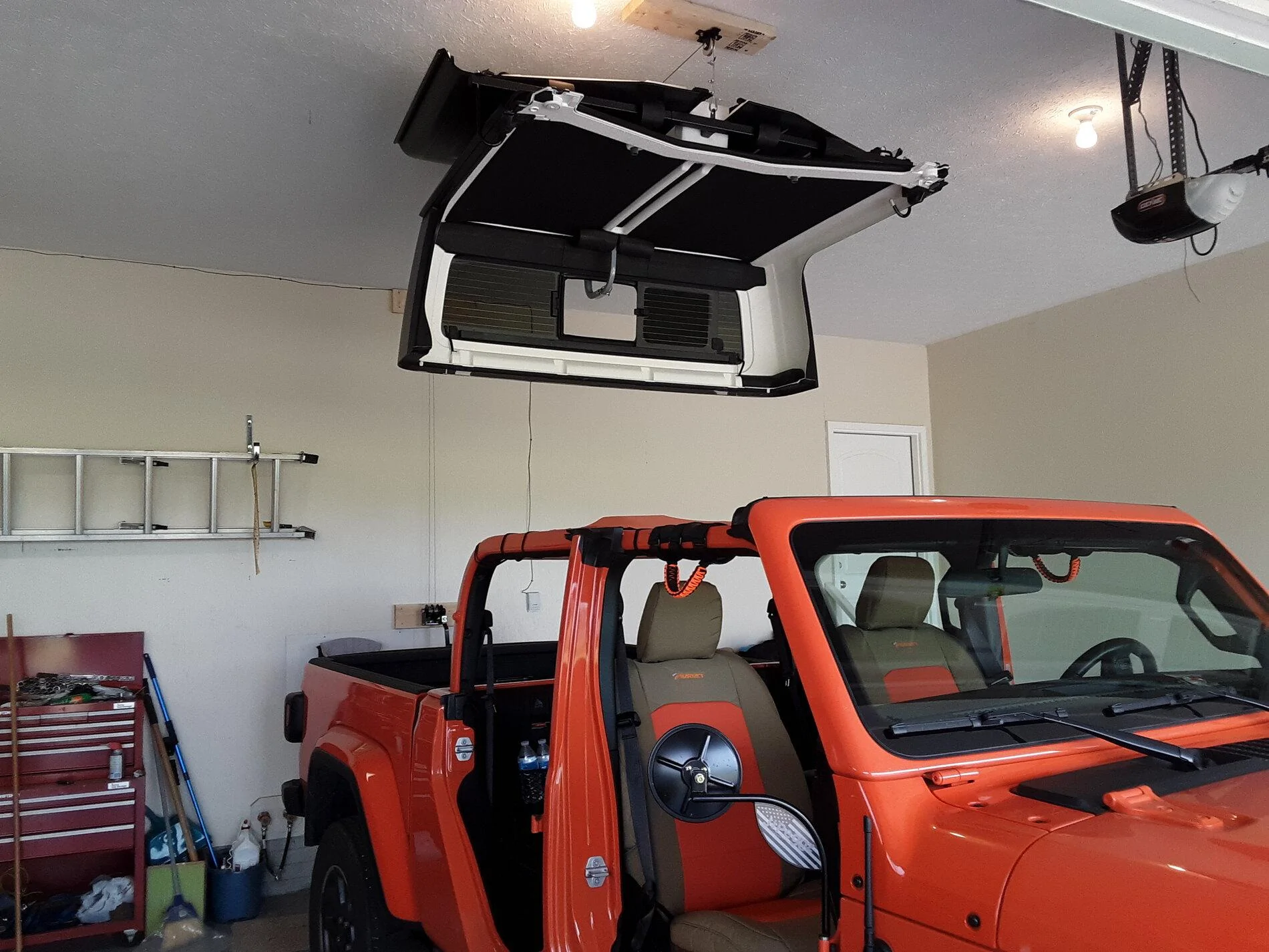

So...just a question for you guys/gals with the hoist. Why do you lift it so high? You only need to go far enough to get it off the body...all that extra cranking seems unnecessary, not to mention dangerous if it gives at that height.

i
i go up that much as i normally park beak first in the garage and i need it up there to clear when i turn around
my picture is a little deceiving as the lower part of the top is only about 4 inches over the roll cage/front windshield
I get a lot of wind where I live and I wanted the top above the garage door, with no slack in the cables. I have another truck, so my top will be off all summer. If I had to put it on and off frequently I would have gotten the power unit.

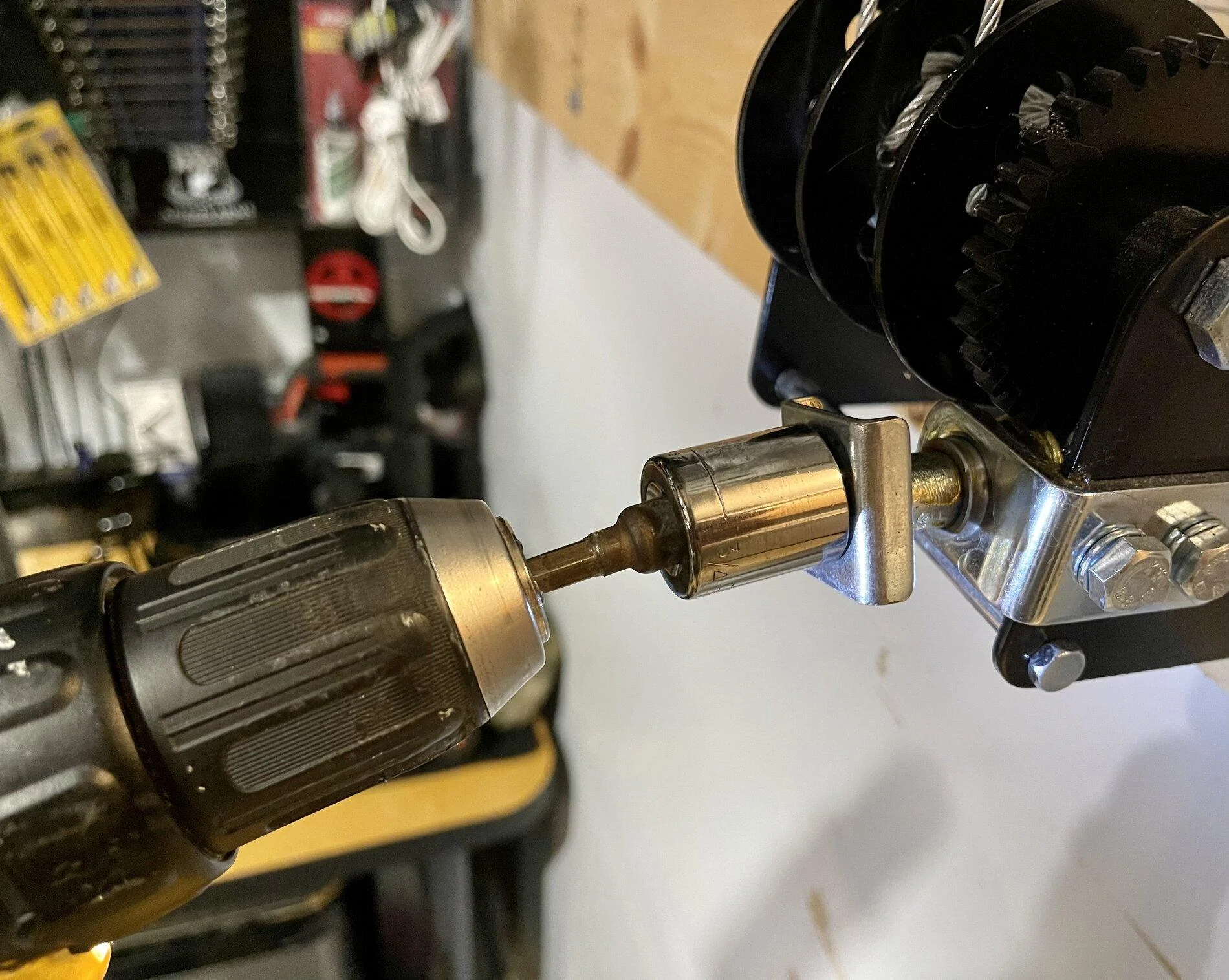

I guess I'm not the only one who bought the crank unit, I'm pretty happy with it, just takes more cranking than I expected.
Take the handle off. Use a socket with a drill.
100% this, think i need a deep well socket for mine though my short ones dont reach
It’s the best way without using the ceiling winch option. I just leave the socket on there—spare one from an old set.

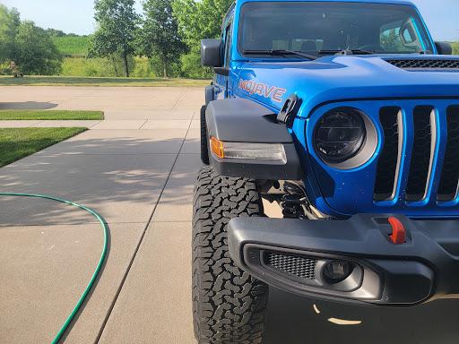

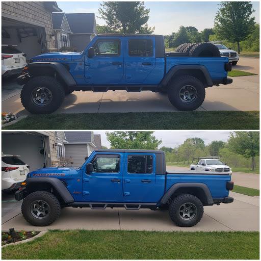

got her back today with new shoes (37x12.5r17 BFG K02s) and a small lift (readylift 2.5/2) but looks like they gave me the teraflex shock extensions instead(they looked and felt more solid anyway, had talked to the guy about it so im glad he ended up finding me a set)
also added the synergy track bar brace. contrary to what i had read my mojave did _not_ have an additional gusset/flange where the brace attaches so there was no modification needed.. something for anyone to double check yourself if youre looking to add
top is after, bottom is before, though kinda sad that the picture isnt as dramatic as life
Jeep Gladiator Mud Bunny - no idea what im doing 2021-06-17
also a front view, 17x9 -12mm fuel shoks, they def poke but its not obnoxious (ofc the stock poked some too)
Jeep Gladiator Mud Bunny - no idea what im doing 2021-06-17 (2)

ok at least took some measurements and got a few numbers... but still tweaking things
overall i gained about (measured from my rock sliders)
- 4.5 in the front
- 3.5 in the back
when i measured from that point previously i had just over an inch of rake, and now i have zero
the 37 k0s measure about 35.5 mount and at the moment i have them set at 35psi warm (they were 37 cold when i picked it up so i let out about 4ish psi)... this will probably drop a bit more as it is still a little rougher, its only 85 here today, and i havent done more than a couple miles up and down the bypass trying to dial in the tire size
speaking of which, i started at 35.5 on the tazer but was over 2mph off at 65, its up to 36.41 and im JUST a hair over truck speed vs gps speed so probably bring it down to the 36.23 (or whatever it is) and be spot on
no rub, no sign of anything even within 3'' on flat ground with steering cranked
