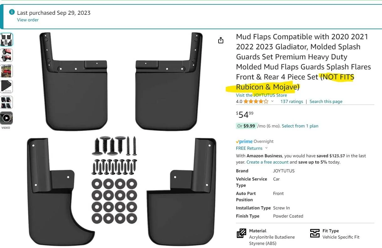

Good day, I'm trying to find a set of front mud guards for a JT High Altitude. I've researched numerous threads dealing with mud flaps but still don't have an answer. I ordered a set from Amazon, and they didn't work.

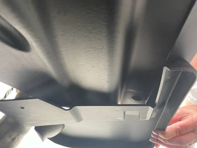

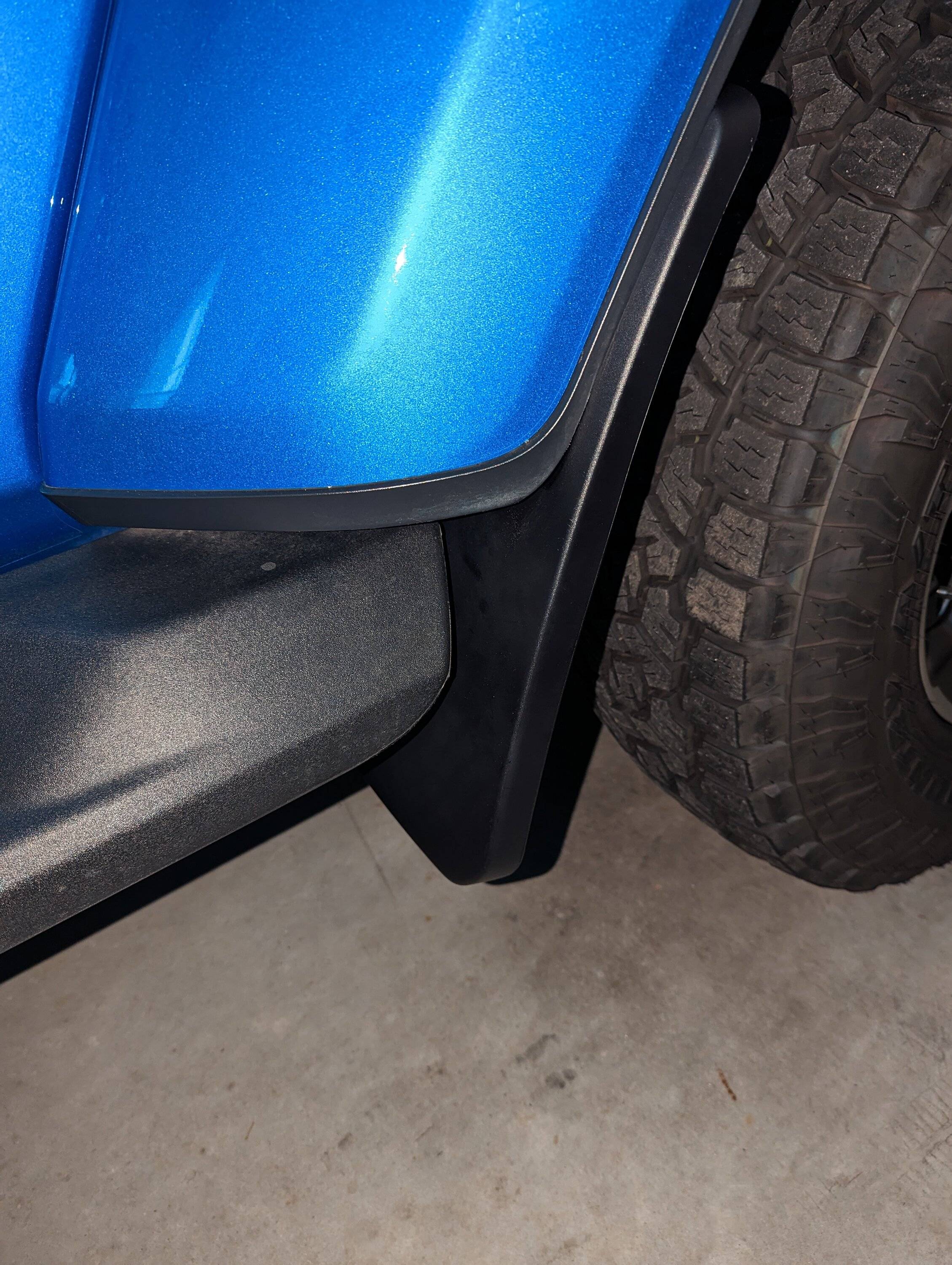

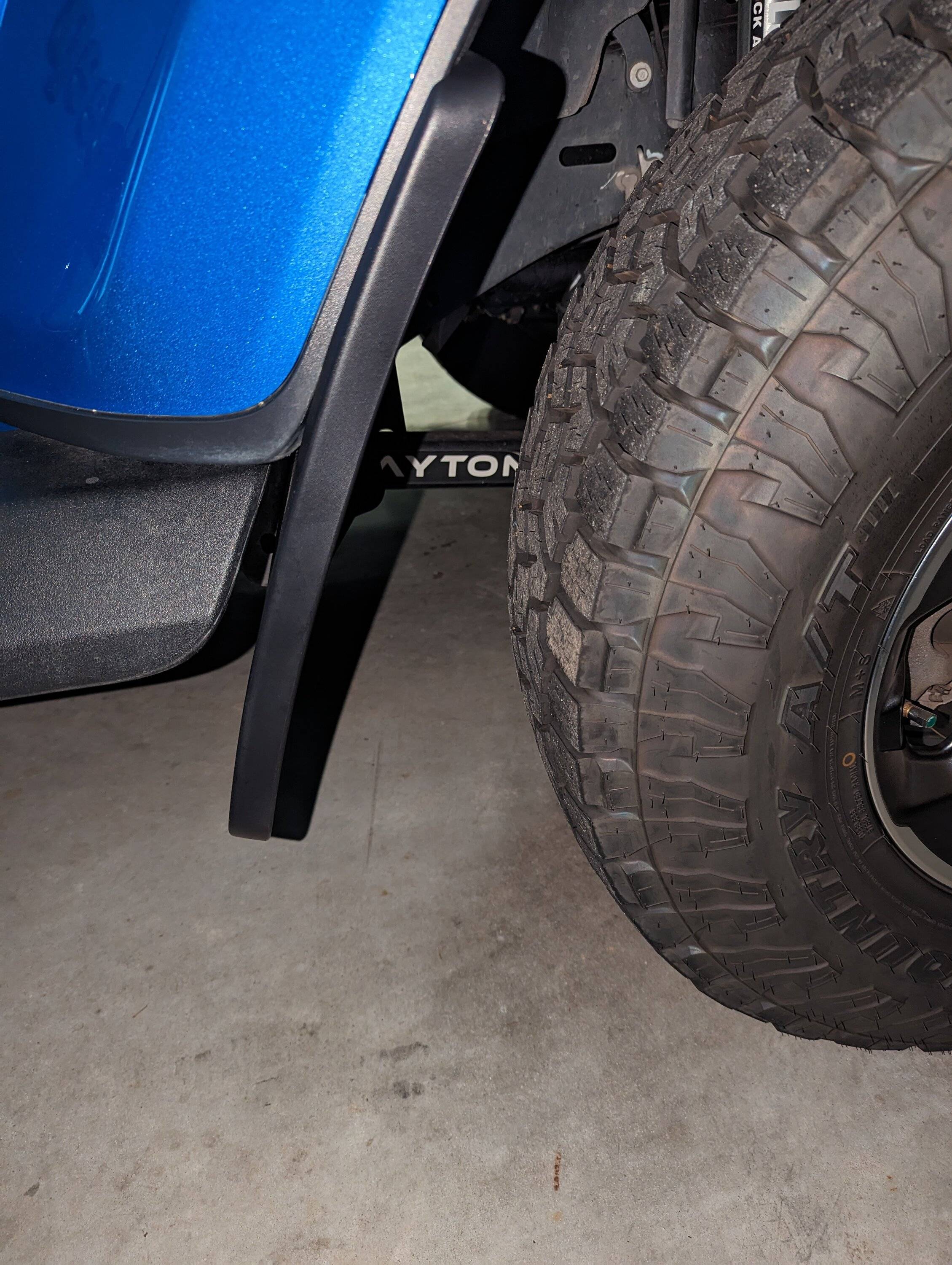

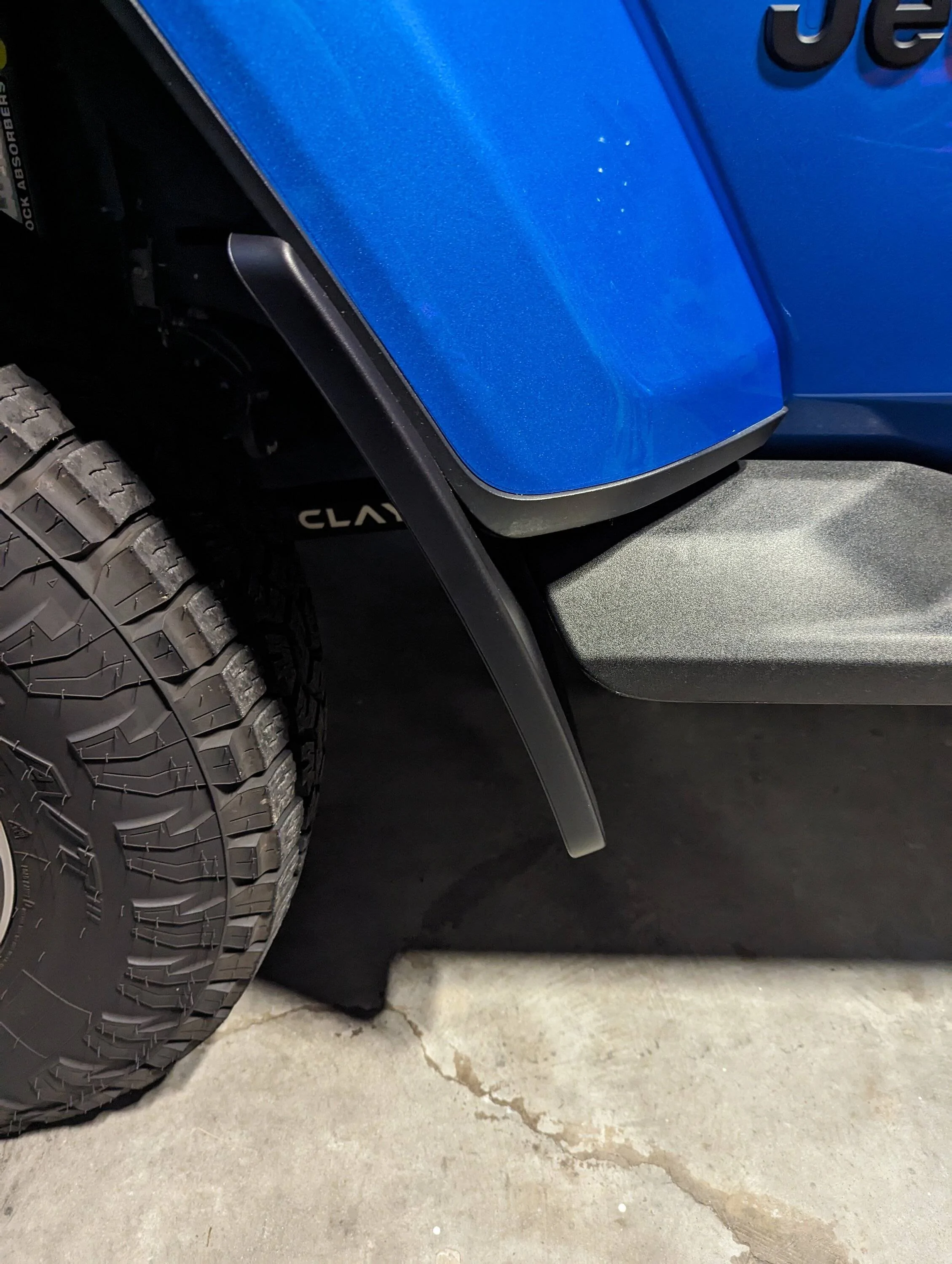

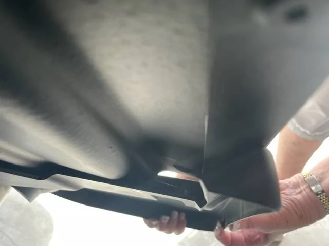

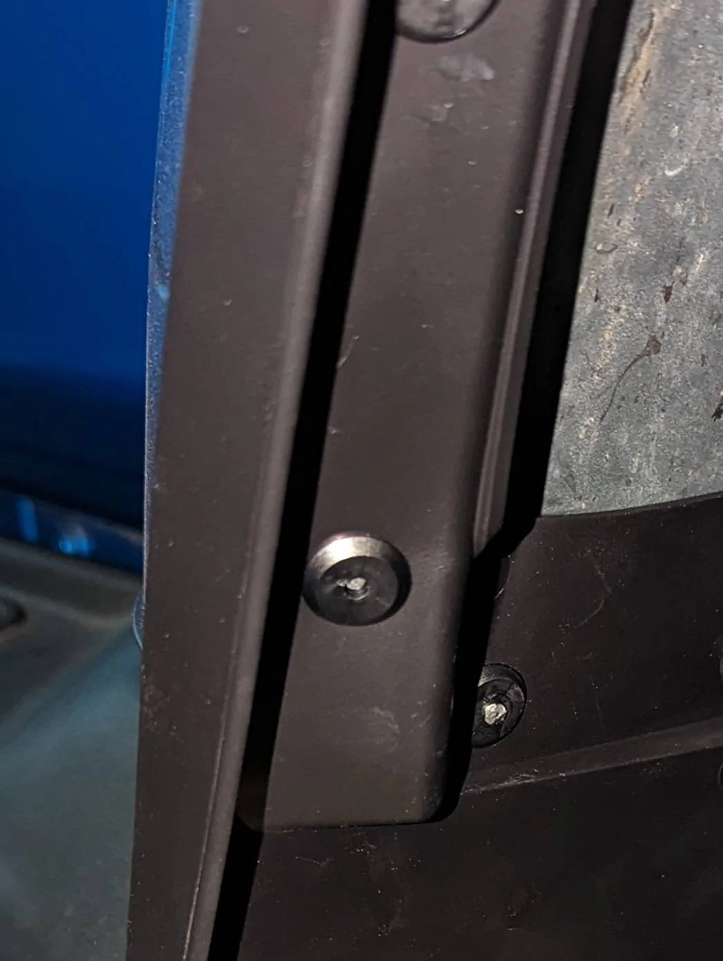

These are the ones i used. You do need to heat them a little bit to soften them up to better mold them. Work great. The last pic is the area that needs to be heated and molded.

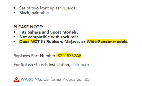

Thanks Todd and Cory. If using the MOPAR flaps for the front, do the holes line up for mounting? I looked on the web and this fitment comment had me a bit concerned. I was told that our trucks have the wider fenders to accommodate the longer axles.

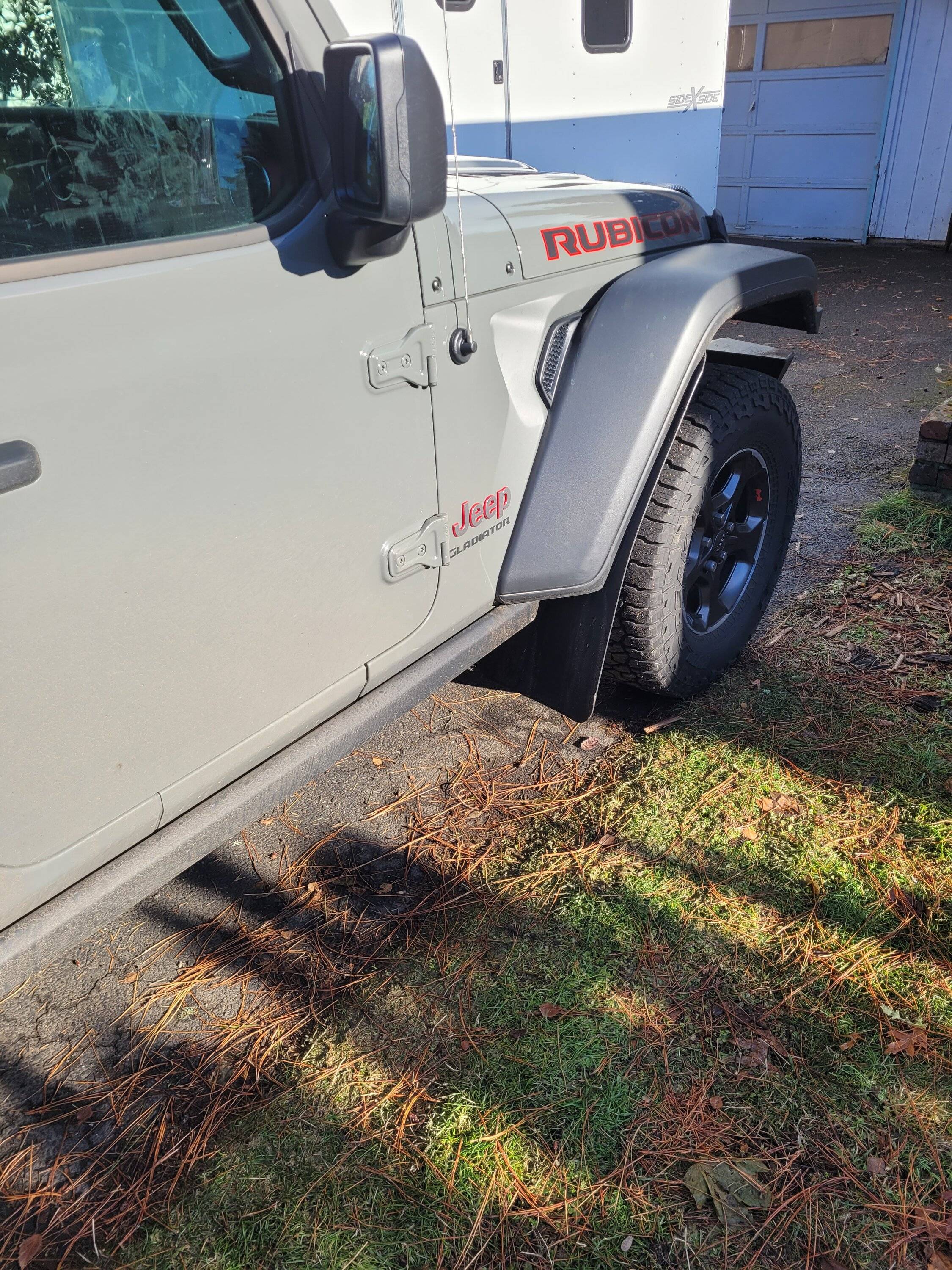

Husky Longjohn mudflaps, universal fit. Not to bad to install, used a little heat to help mold them, they've held up well.
On sale right now for less than $26 a pair.

No the holes do not line up. I needed to remove 2 of the plastic rivets so the flaps would lay flatter. You do have to drill holes in the plastic.

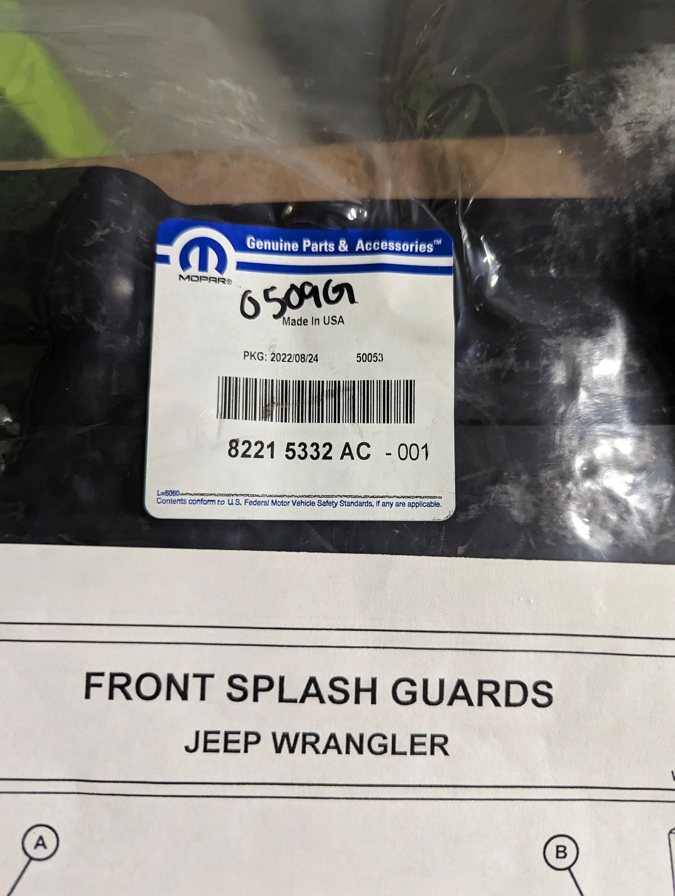

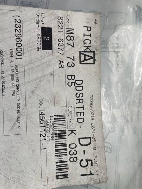

One more update. I ordered the spash guards Benny at All MOPAR Parts suggested , and they do not fit, not even close. They may work for the Max Tow JTs but they don't fit the High Altitude models.
