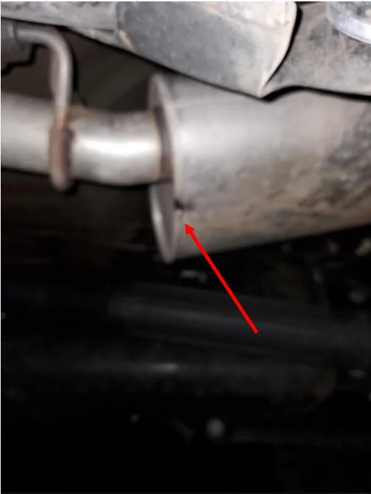

Reaching out to everyone to see if any of you have/had this issue. This morning did the normal auto start and went out to get in the Glad and seen some water on the ground under the truck- drivers side. I look under the truck and see excessive moisture dripping down from the muffler and what seems to be either a hole or the seam on the muffler itself is bad... Anyone else have/had this issue. The truck only has 6000 miles. Sorry for the bad pic it was 4:30 this morning ,, Please advise. Thanks MNY_PIT

Yep I've seen it too, usually only happens when I do the auto start and let it sit while wrangling the kids and what not. I don't really see it other than this long idles

@MNY_PIT
There is a weep hole on the end of the muffler itself. Water/Condensation is suppose to leak out there. Good once in awhile to check to see if weep hole is clear. If not clear, clear it with a probe.
Sometimes you will see quite a bit spitting out of there.... NORMAL...
Picture is of normal weep hole...
PePe: Appreciate the info. I was thinking what the heck, now I have to upgrade the exhaust..lol. No seriously thanks for letting me know its supposed to be there that eases my mind.
