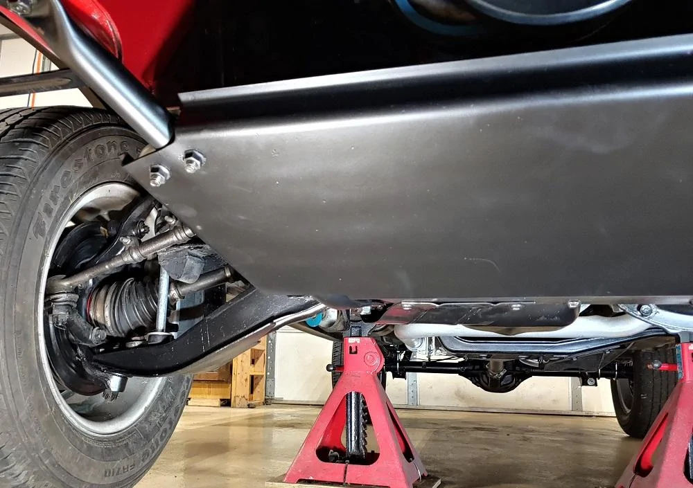

Our hubs don't lock and unlock as you probably know.
Also, CVJs are stronger than U Joints. Nothing wimpy about them. Their weakness is that they need to run in a grease bath and depend on their boots. I've torn boots and caught it. I drove home and changed the boot and the CVJ never failed. (This includes taking everything apart, cleaning it thoroughly, regreasing and reassembling) So its reasonable that if you do an inspection after any serious off-roading you would be ok.
If you aren't going to be doing any kind of driving that might tear a boot they are functionally superior. Quieter, smoother, MUCH stronger at steering lock.
U joints fail also. They just fail differently. Often catastrophically. Whereas CVJs almost never fail catastrophically, leaving you on the side of the road or trail. I've broken U Joints on the back of my 66 chevy. It happens. Fortunately they are really easy to change on a driveshaft.
Ya basically beat me to it. I've not seen one fail to the point of leaving someone stranded UNLESS they ignore the torn boot and keep driving in the dust and dirt (and I mean even normal streets and roads have enough dust to destroy things)
They have precision fitting balls and channels and need to be kept clean.
I much prefer CV joints and that's what sort of joints are used in shafts that need to operate in extreme angles. The CV is constant velocity where a cross type joint speeds up and slows down when running at an angle.
But let's face it, 99% of the time you're only going to use 4A or 4H either one if it's snowing or really nasty weather otherwise outside. So I think they could have gotten away with the stronger and more durable U-joint design. Oh well, not a major crisis as ALL of the IFS systems use CV joints and they hold up pretty well considering..
Not necessarily - parking lots, in town, etc. U-joints pop and jerk in town and tighter turns and it's hard on them. They aren't made for angles like that.
CV joints are in all front wheel drive vehicles - don't see those people complaining and some put on a whole lot of miles. I've had several vehicles with CV joints in the front, only ever had one boot issue. I simply replaced the whole shaft and will rebuild the other shaft when I get a chance and have an entire spare.
I can turn this thing sharper than ANY Jeep with Cardan type joints up front and the joints run smooth as silk and it does zero damage to them.
The forces are also more evenly distributed over multiple hard steel balls with more surface area than those tiny needle bearings in a Cardan joint.
