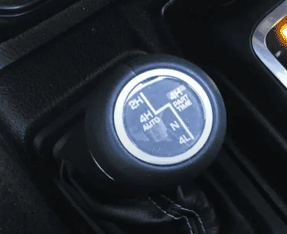

Front axle disconnect. With it in 2H, the front right axle shaft is split in half. This means that the front pinion and ring gear and thus the front drive shaft are not rotating.So you are saying that the hub disconnects?
That's news to me. I'm happy to delete my post if I'm wrong. Can you explain more?
My understanding was that in 2H, the only thing that disconnected was the transfer case. Which would leave the entire front drivetrain being pushed by the road.
Thanks - Don
AMC did a lot of testing back in the 80s - there IS a difference in MPG because you are spinning the ring gear, pinion and drive shaft with the right axle not split.
In 2H that axle is split and you are only turning the side gears and spiders (The carrier gears) while the carrier remains stationary.
