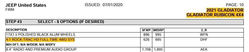

In the Rubicon trim in 2021 it was not an available option and wasn't offered . Mine was built 6/20 ,Delivered and Putchased 12/20. I don't think it was ever an option for Rubicon at that time
Rubicons got a version that was called "ROCK-TRAC". Basically the same as SELC-TRAC except it had a 4.0 ratio vs 2.71 ratio in SELC-TRAC.
Jeep Gladiator Selec Trac full time 4WD once standard on Sport Models Roc-Trac
Yes that is exactly what mine has is Rock Trac and on that low side it will just crawl. I can put it in first gear jump out run around the truck & get back in ...lol
