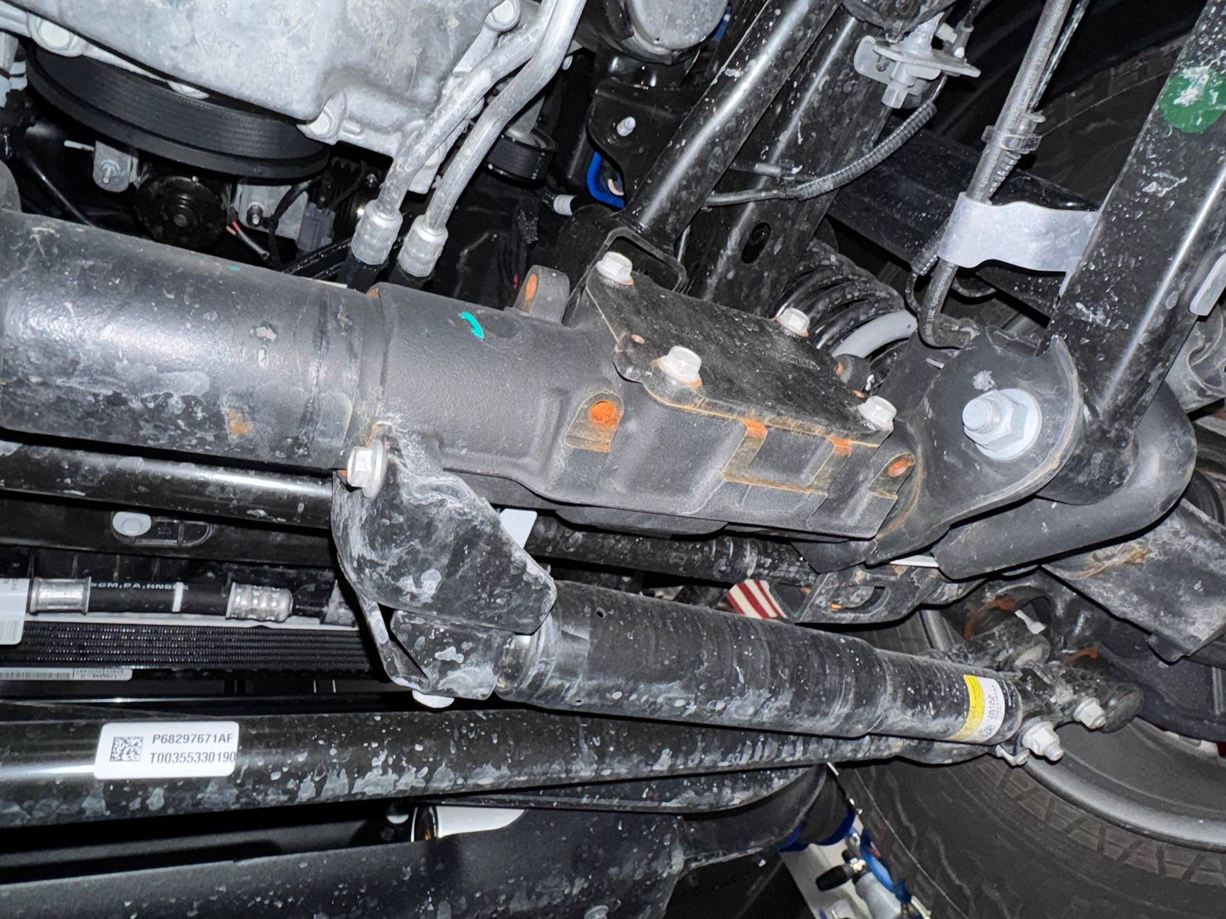

Do those have a Front Axle Disconnect like the rest? If it does I would guess that it stays engaged so there’s less delay in activation
I’m still trying to learn how it all works….. in terms of the front axle shafts and front driveshaft. I’m used to IFS rigs…which always had them (Front disconnects).
I’m not used to seeing solid front axles with CV joints…or any of that…😂
I‘m pretty sure my 2024 Mojave X has a FAD……
I honestly didn’t crawl under there long enough to see any wiring to it (behind all the other stuff under there).
So yes… As soon as you put it into 4Auto - Everything (front axle shafts & front drivesahft) should be spinning. Same as it would in 4Hi and 4Lo. The T-case gearing (and clutch paks) would send power to the front driveshaft accordingly.

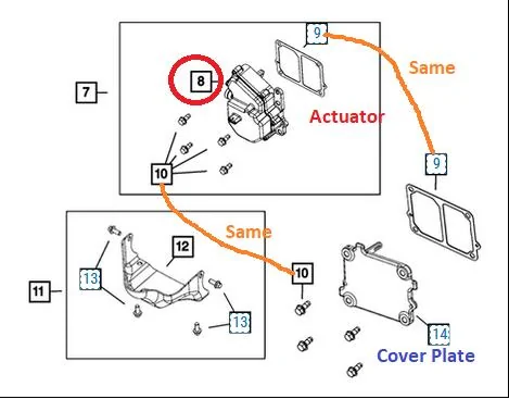

The Mojave X does not have FAD. If you did, the Cover Plate held on my the 4 silver screws shown in your picture would not be there and an Actuator would be in its place. like so:
