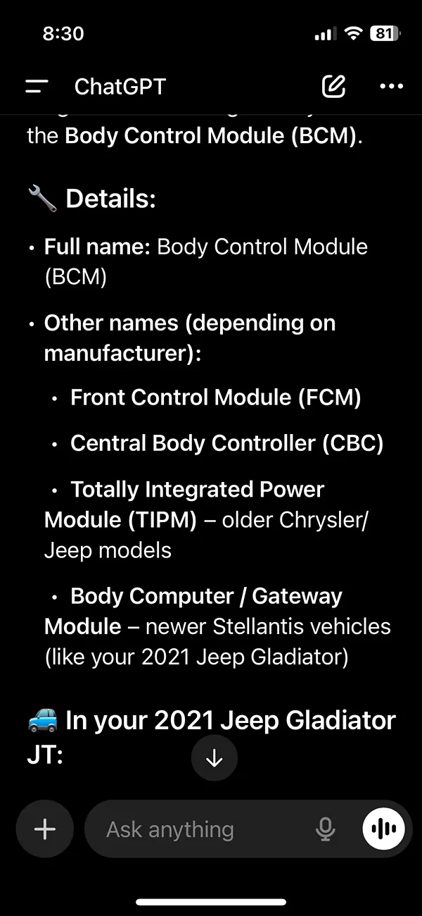

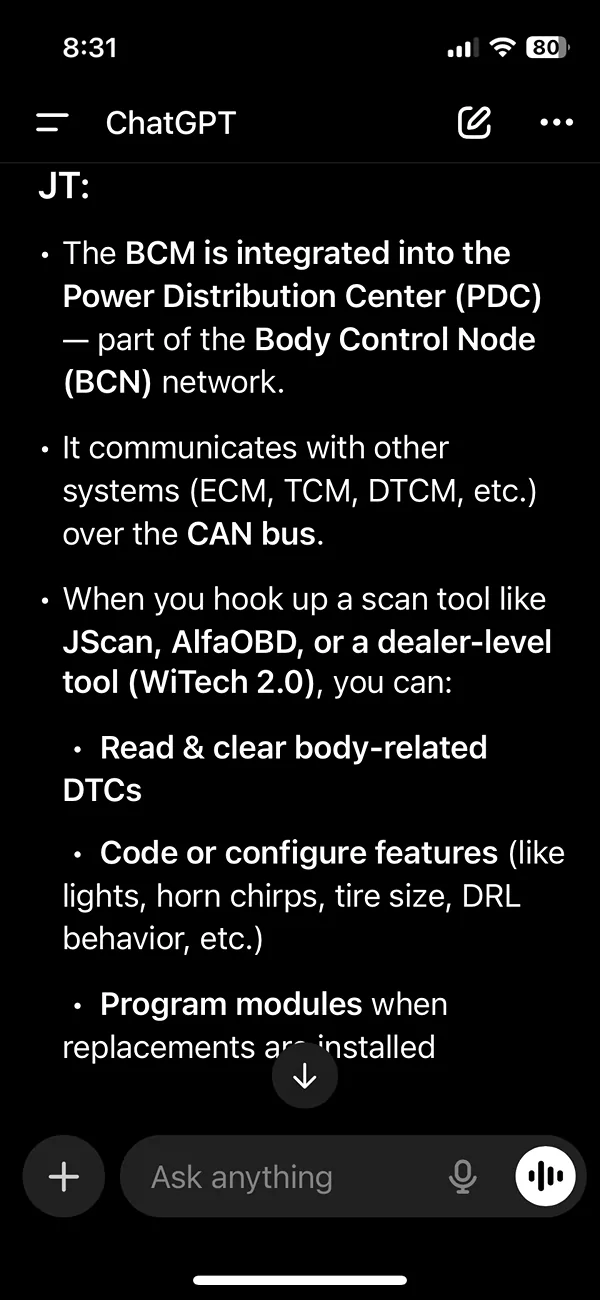

I was having to think back when I too had the bypass cable for a ThinkDriver diagnostic dongle/phone app, and cable had to be installed and removed a few times (hook tool was best, kept my hands out) but then after awhile of this constant install and removal, I upgraded the diagnostic reader to their Mucar CDE900 Pro which just plugs into the OBD2 port.
Then…. we had a bunch of road resurfacing in Calgary this summer and you know when those surface machines are tearing up the top layer of the road and when they stop, there’s that 2” edge all our vehicles hit when driving over…. All summer long, hitting that edge of the road on my normal commute to work …
Then my diagnostic reader called a BCM code (body control module). The jarring from hitting that edge over and over caused the two cables to come loose. I used the hook tool to pull them down, sprayed them and clipped them back in. BCM code cleared. Here’s what Ai says about that module:
