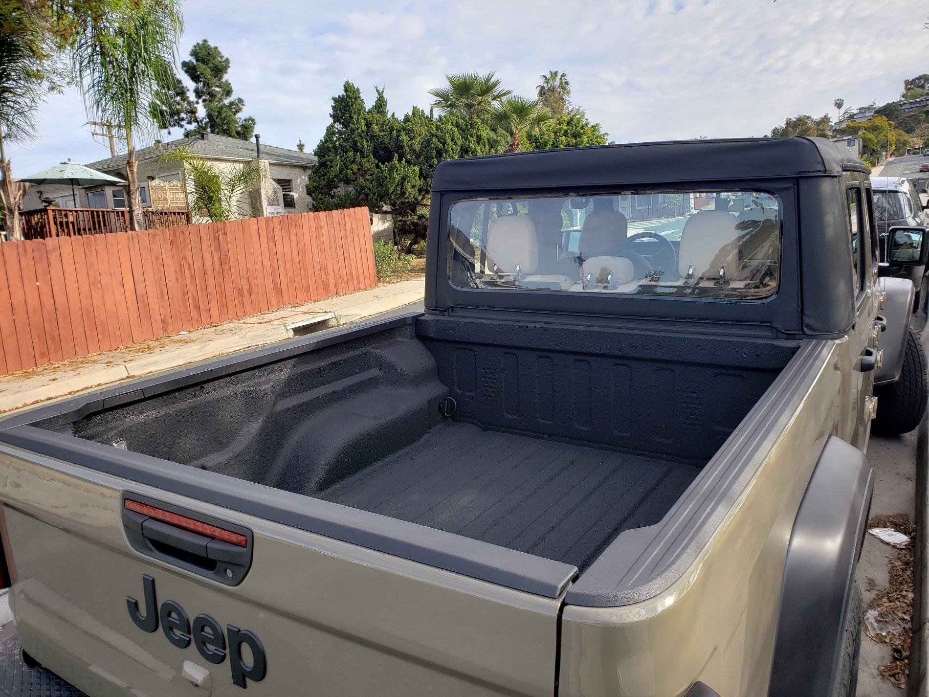

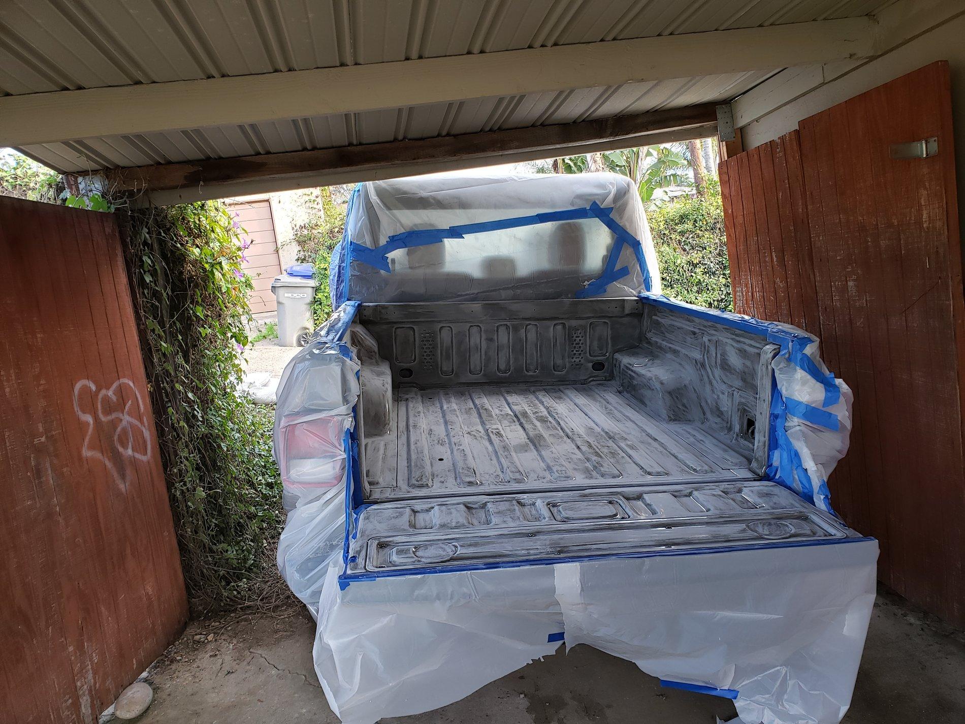

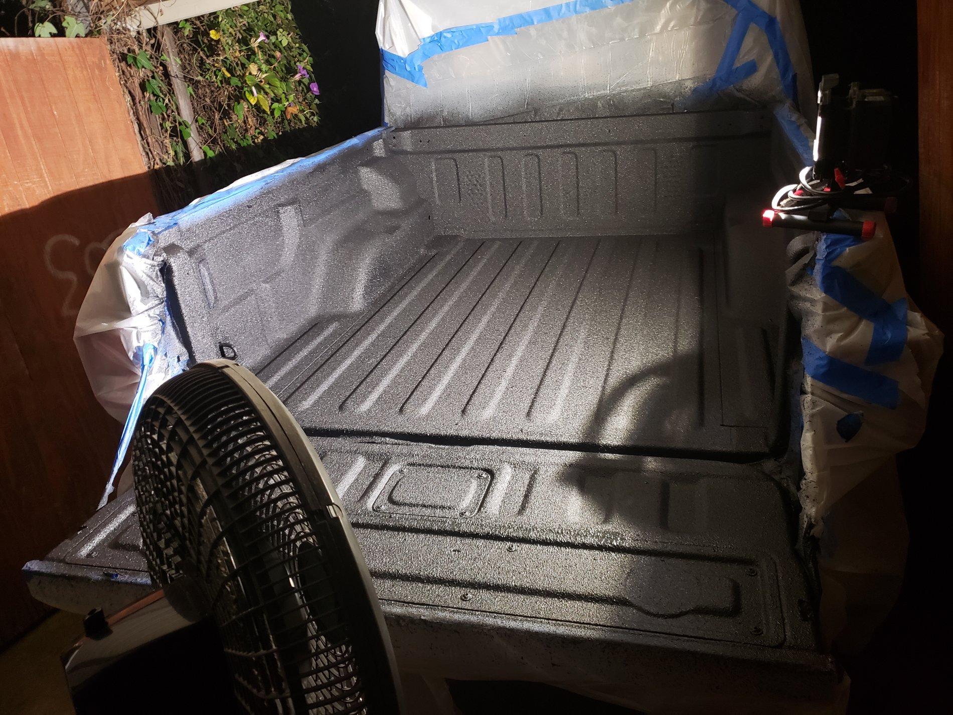

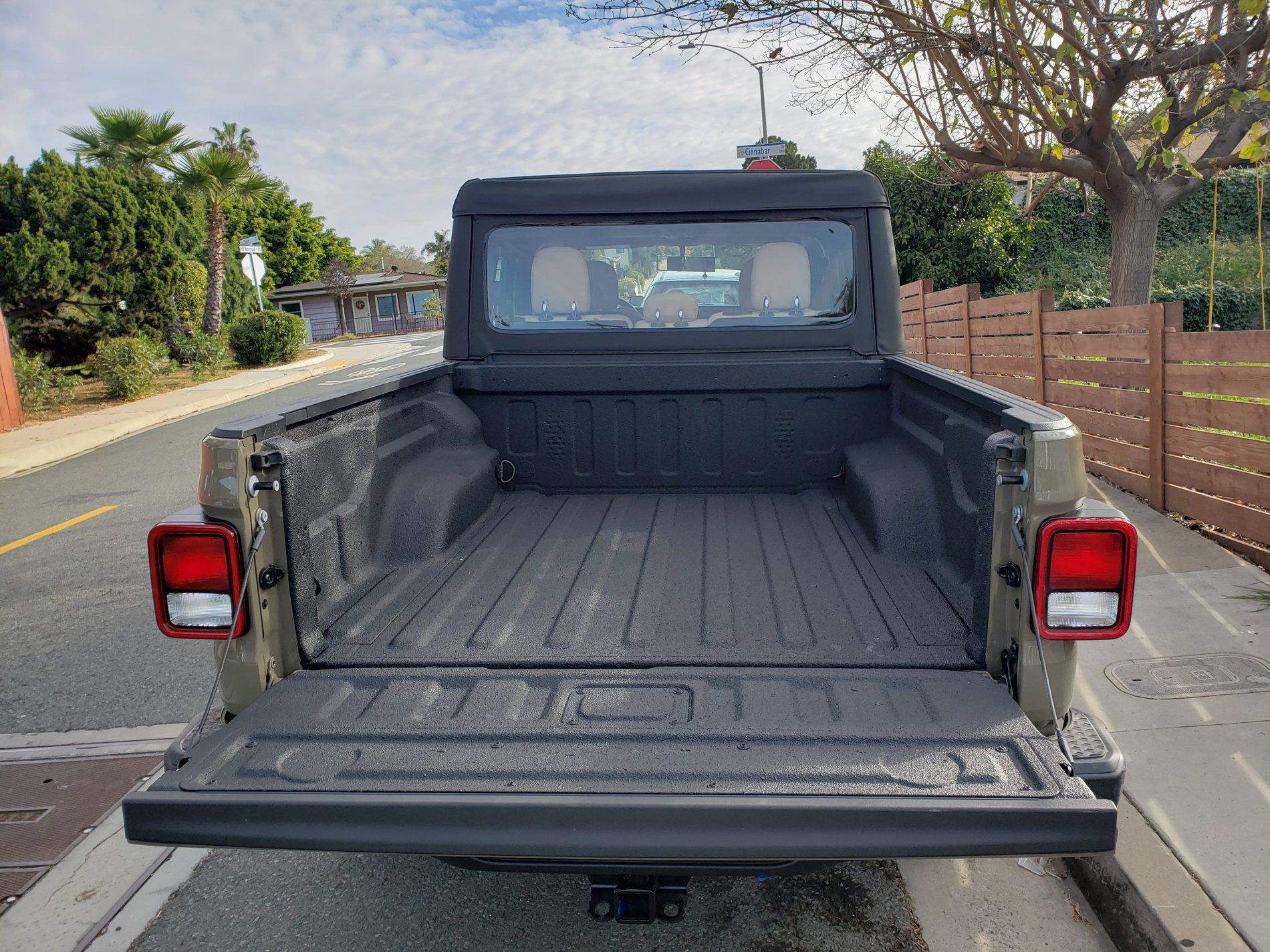

Hi Everyone,
Thought I'd share my experience with my first spray in bed liner job.
Time: 10 hours ( i can probably do it again in 3-5 hours now that i am not Youtubing while bumbling through).
Cost Total: $200+/- (depending on how much materials you already have).
Parts:
$118: Raptor Spray on kit (with spray gun)
https://www.amazon.com/gp/product/B01CKE7B1E/ref=ppx_yo_dt_b_asin_title_o05_s01?ie=UTF8&psc=1
$13: Adhesion promoter: https://www.amazon.com/gp/product/B00397POFC/ref=ppx_yo_dt_b_asin_title_o05_s00?ie=UTF8&psc=1
#15: Etch Primer Gray: https://www.amazon.com/gp/product/B006HFM5YG/ref=ppx_yo_dt_b_asin_title_o05_s00?ie=UTF8&psc=1
I used my compressor 30 gallon compressor and misc painting supplies from harbor freight (masking tape etc....).
I sprayed at 50 psi.
Overall my experience was positive and had fun as i got a couple of buddies + beer to help, i know some guys will mix in tint to give the finish some color which if i ever do this again.. i might dabble but i did this with no experience and I'll be back for my 1 year update to see how things held up.
