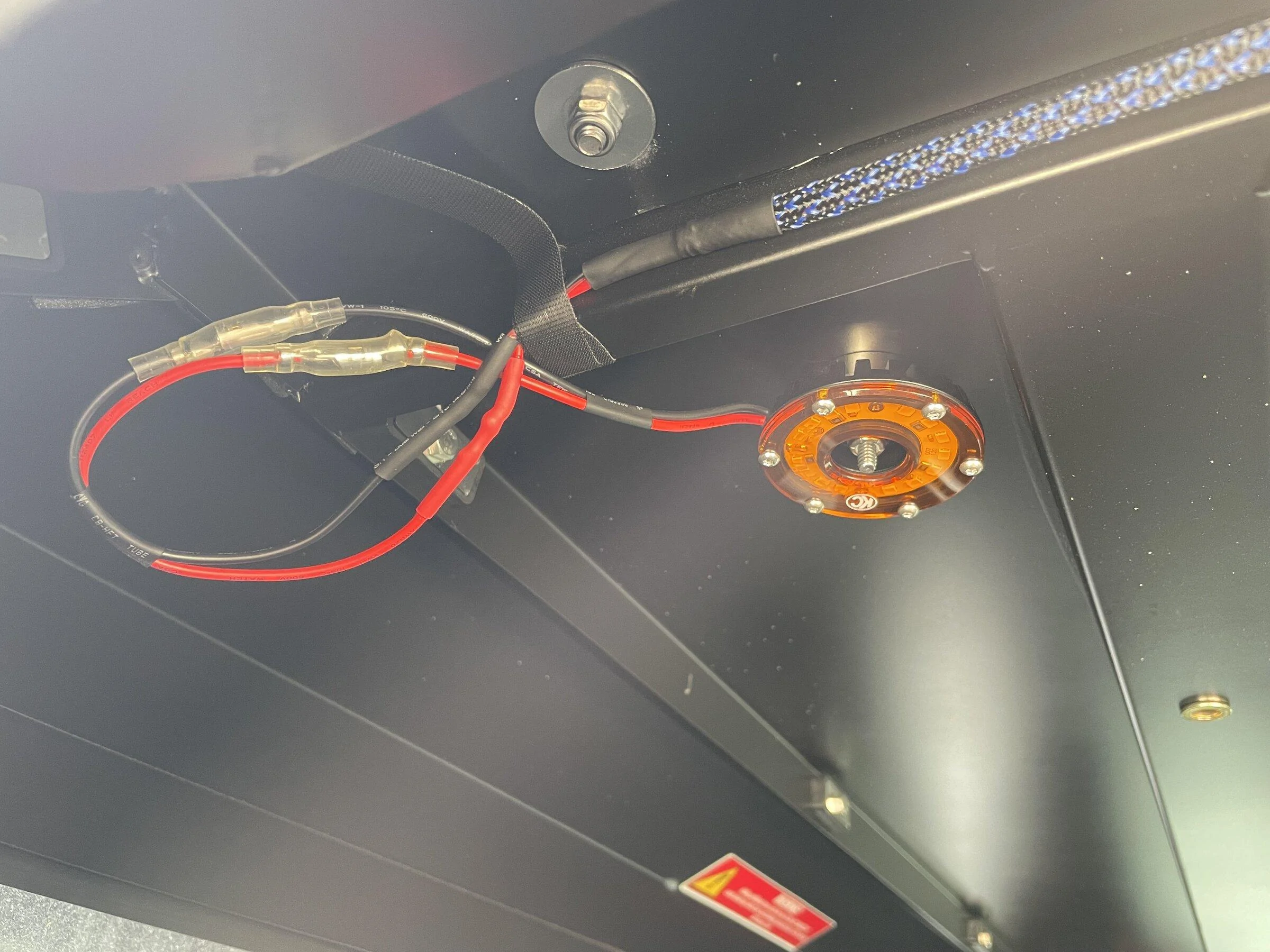

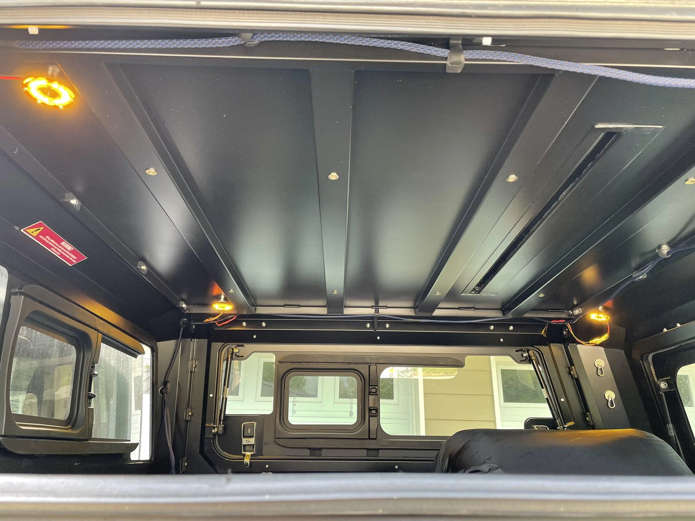

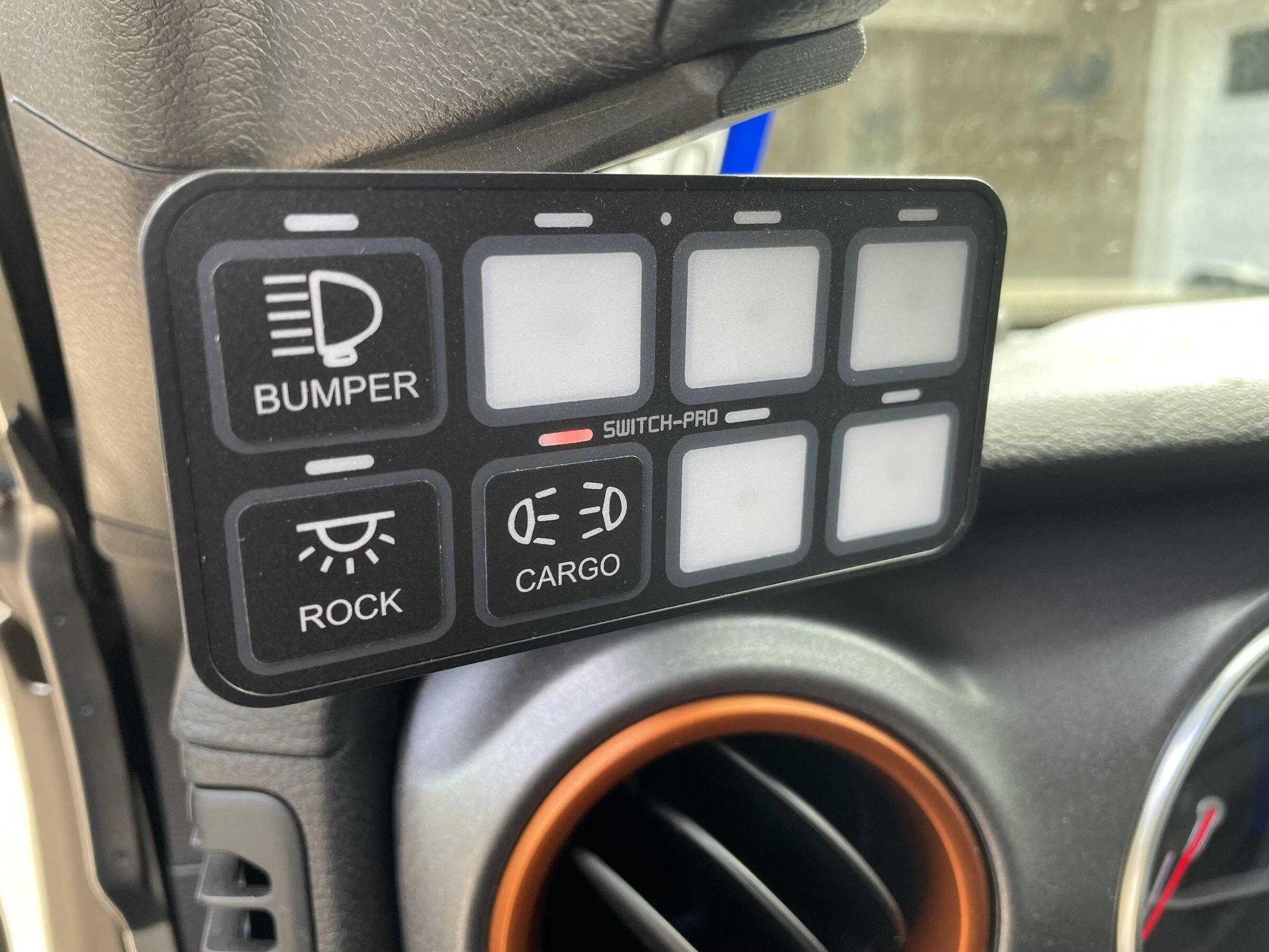

Awesome setup! I’m also interested in your cap lighting. Are you tied into the bed lights? I have been thinking of doing something with LED strip lights in the ceiling with a switch that has a time-out built in in case the lights are left on. Any info on your setup is appreciated!
EWP
EWP
Jun 12, 2020
53
170
Jeeps
The lights are KC HiLites Cyclone LEDs mounted with a ceramic magnet. The power comes from a Switch Pros SP-9100 using a tap off the original bed lights for a trigger. With this setup, the lights come on when the bed light is on but I can also turn them on manually from the switch panel in the cab or via the app on my phone.
