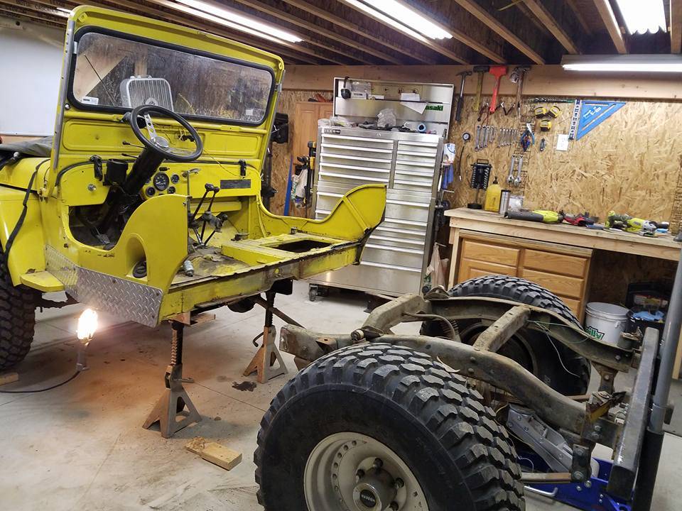

When my wife came out to my shop and saw the 47 in this condition after some work with a sawzall , she knew I would be spending more money and time on another project, but is always in total support of these kinds of projects. A year later, we took the 47 for its first drive as a truck.

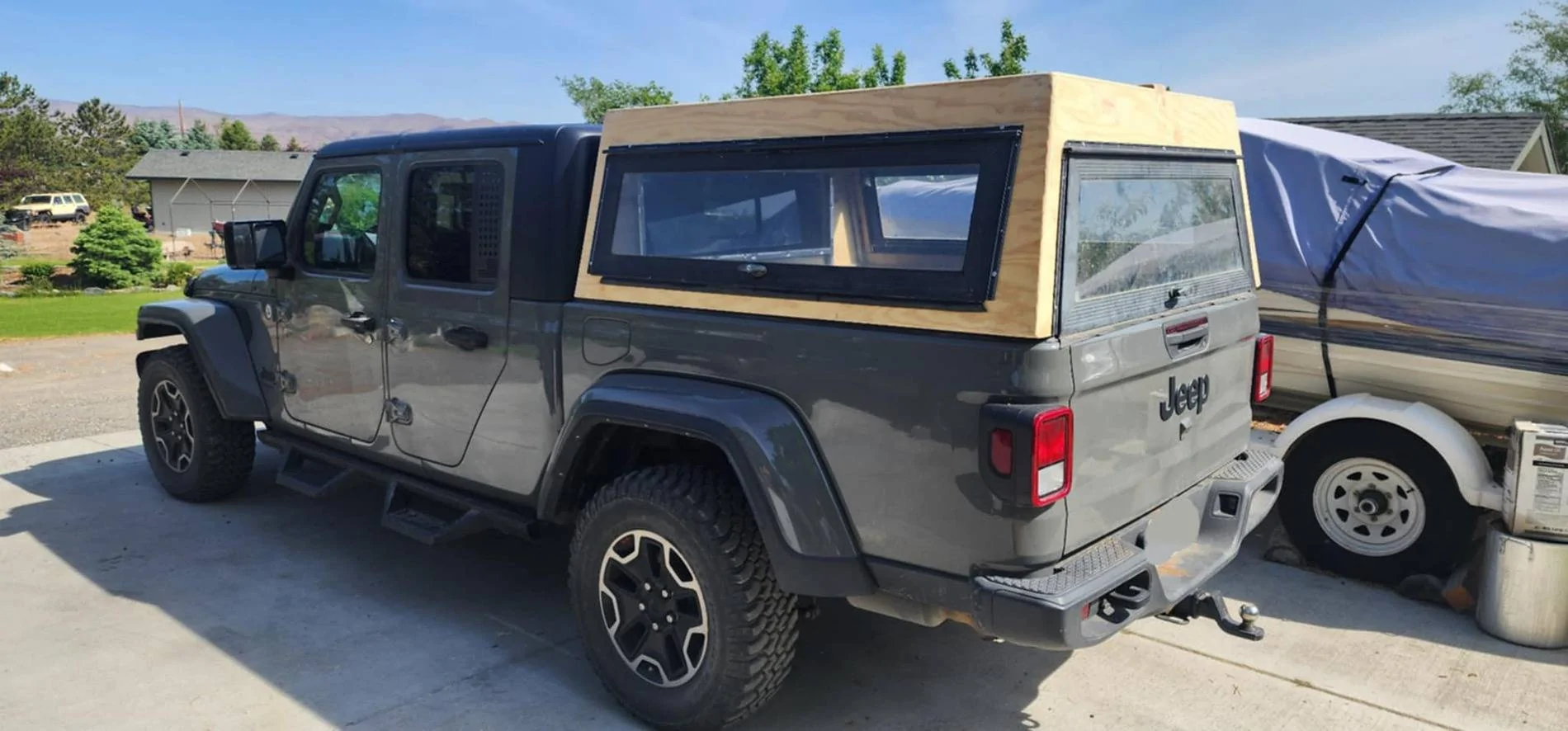

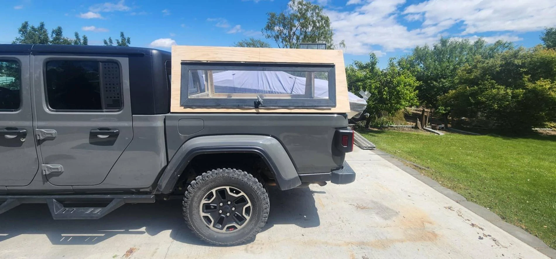

Had a little bit of time today to have the corners rounded out and everything ready for paint and bedliner. I'm Probably going to drill the holes for the cross bar mounts a little big and get the walls coated with the chassis saver and maybe some bedliner.
Think I'm also going to order some stingray aerosol cans to color match the shell doors. They are in need of some tlc.

question: since your making this thing yourself....why didn't you radius the rear corners to match the curvature of the top bedrails?

I would have liked to match it up better, but the rear hatch I am working with doesn't line up with tailgate well. I had to extended it out to get a good seal, so I just kept it straight and easy. Rounding it off wouldn't have left much room for the hatch frame.

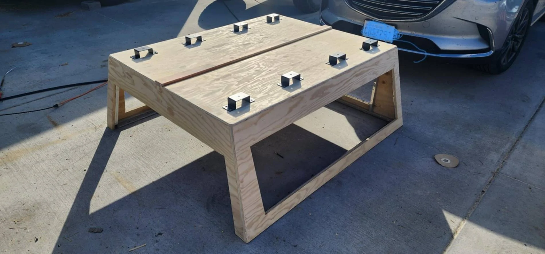

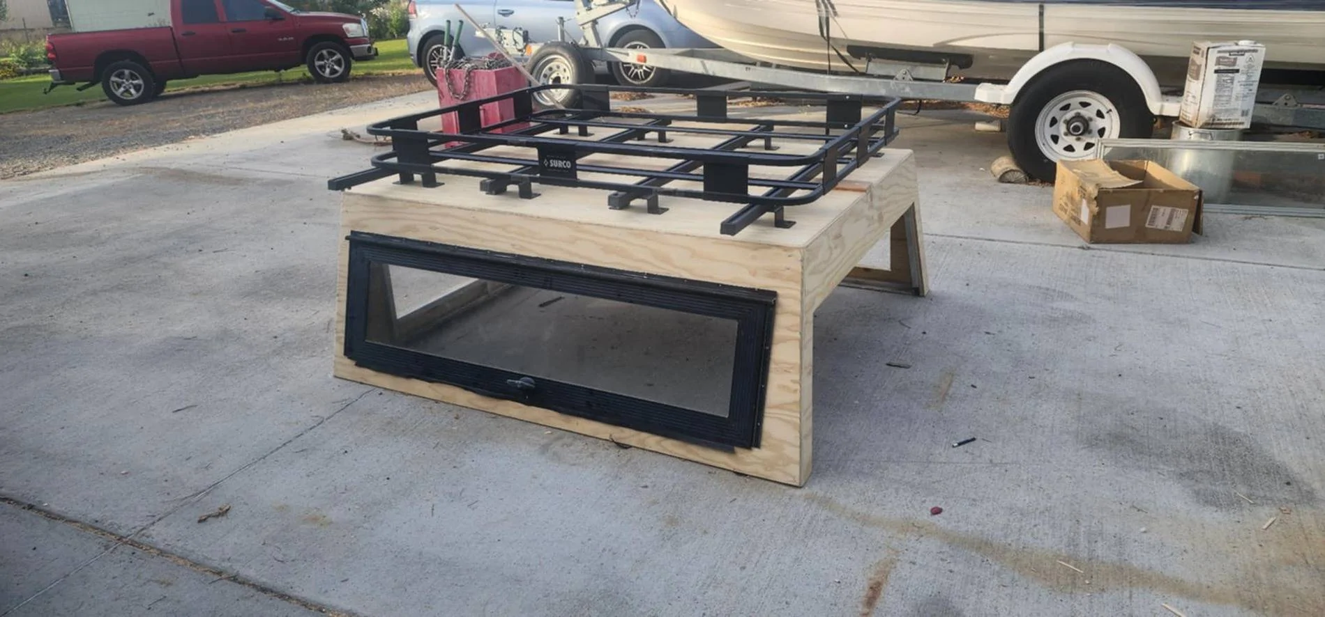

Got everything mocked up how I want it. Will get everything drilled tomorrow.

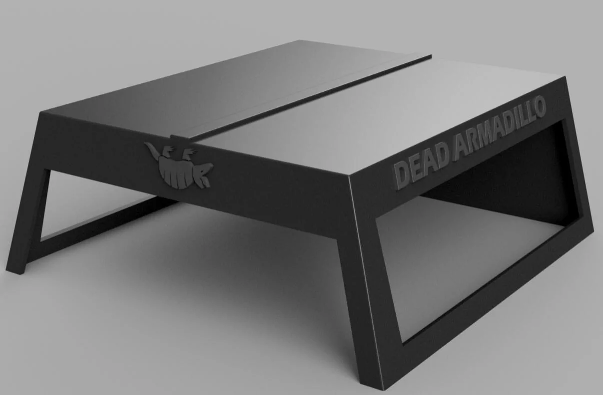

My brother is a wizard with fusion 360 and made a quick render of the shell. He will be 3d printing the lettering and the armadillo so we can attach them while the wood is still bare. Then we will make some gray decals to go over them once the bedliner is cured. Will need to make some dead armadillo decals for my hood as well. Looks like the monstaliner won't get here for a couple weeks, so I will just be getting things mocked up for the interior of the shell in the meantime.

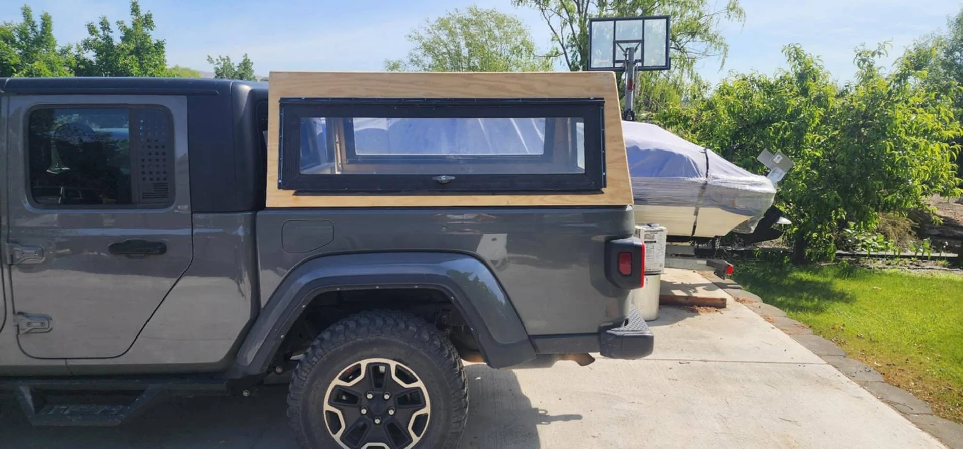

I was still not happy with fitment and the seal around the tailgate. So, this morning I removed the factory trim, which allowed me to move the shell forward just a bit more. I am much happier with it, now I need to design and 3d print a new trim piece.
Jeep Gladiator DIY hardtop camper shell 2336f798-26d3-429e-9cf7-3d59d9a995d7
Jeep Gladiator DIY hardtop camper shell 235b654e-cf56-4e03-9990-fb00123e8d1c
Jeep Gladiator DIY hardtop camper shell 60fb7eb8-1330-470f-ada4-c41be94e4dc6
Agenda for the rest of the day is framing out the interior side door frames. I will be installing some T Slot track along them for mounting points. Plan on using them for removable mesh screens to keep the bugs out while camping.
