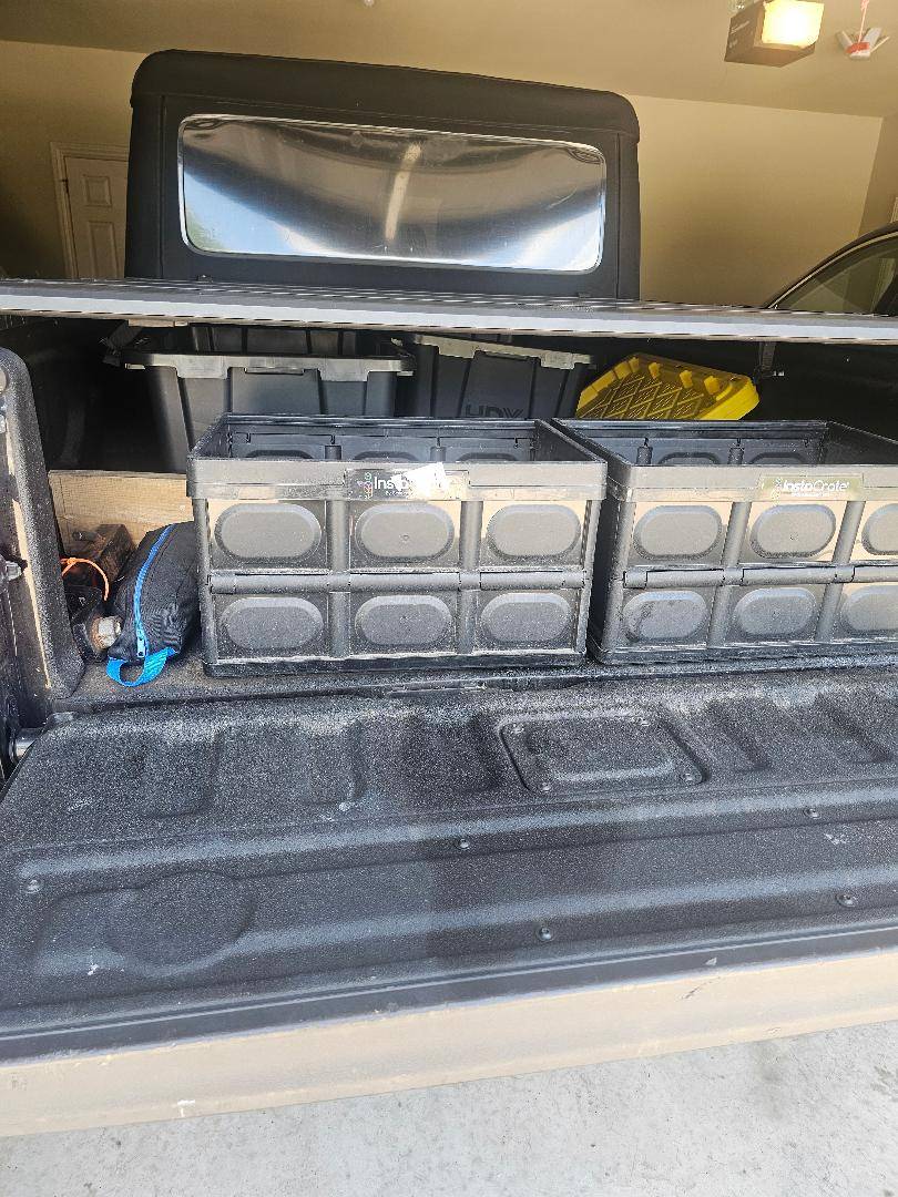

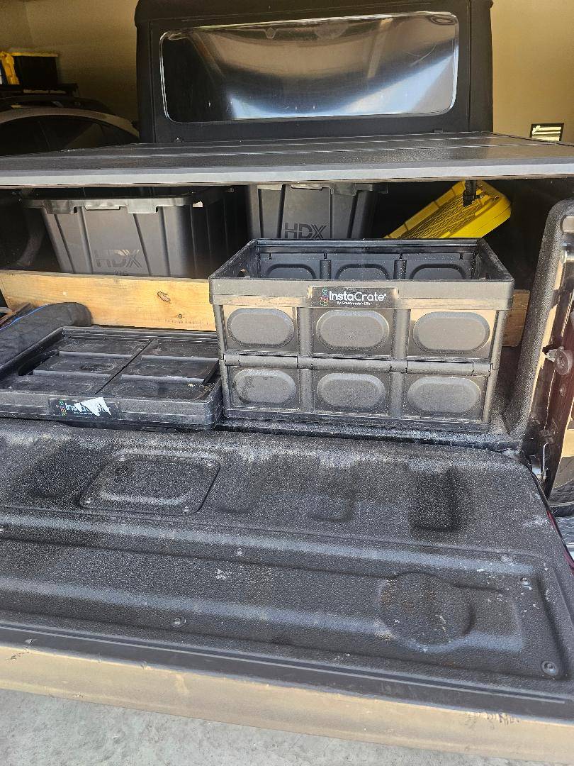

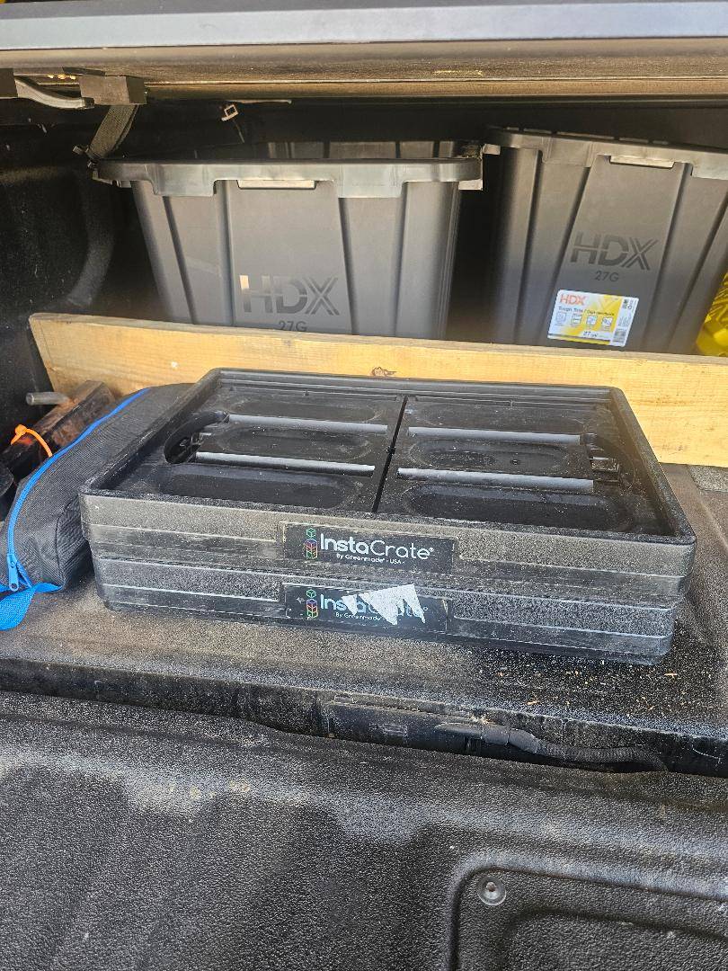

I keep a pair of foldable crates between the wood bed divider and the tailgate. Perfect for a run to the grocery store. OP you did a good job on yours. I made a single cut and said goof enough.
