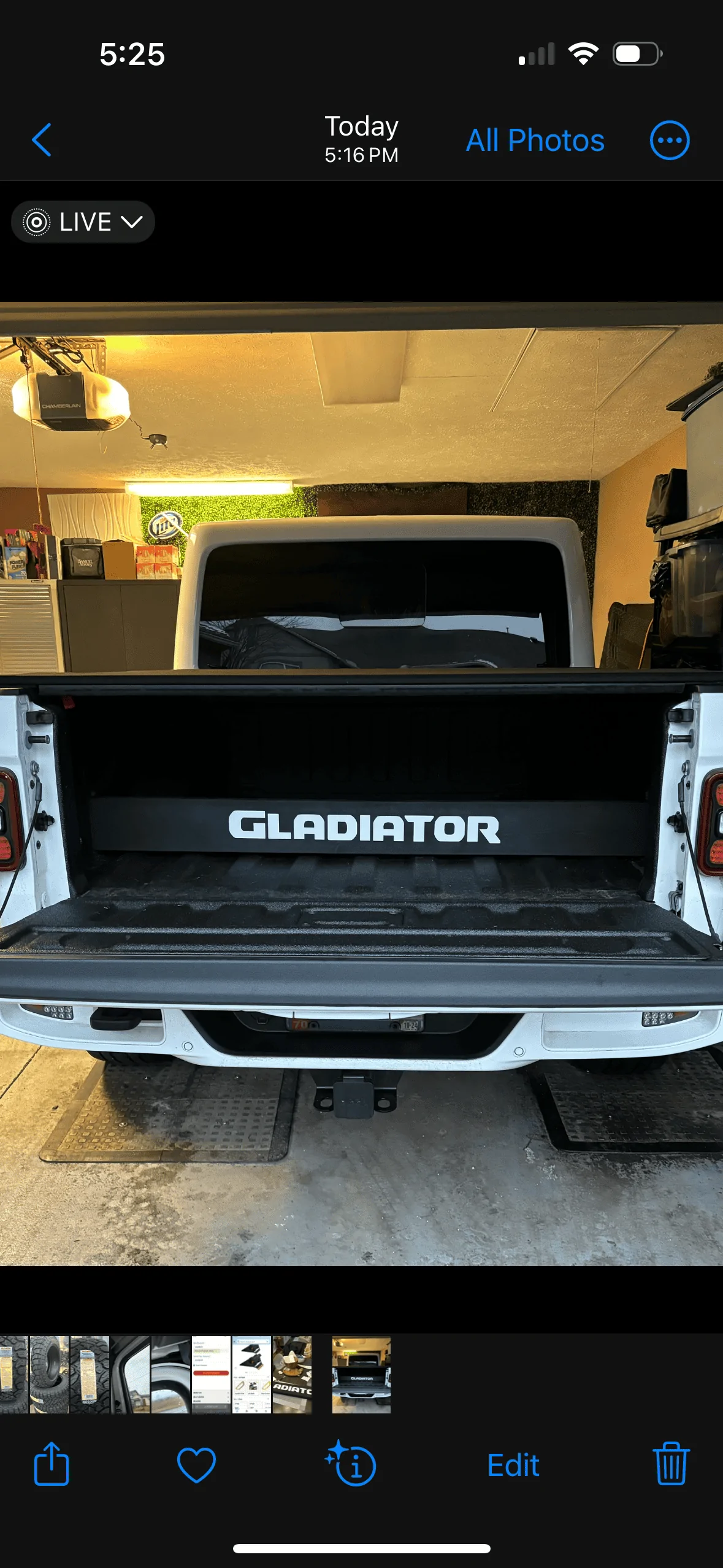

2x8 cut to size, rounded edges on the bottom, wood filled damaged areas, sanded, primed, painted and a gloss finish.
‘Decal’ is actually raised lettering individually installed by yours truly.

What length are y’all cutting the boards too? Looks like the homemade dividers are perfect.

Looks great, quite unique too. I don't think I've ever seen a Gladiator sporting that.

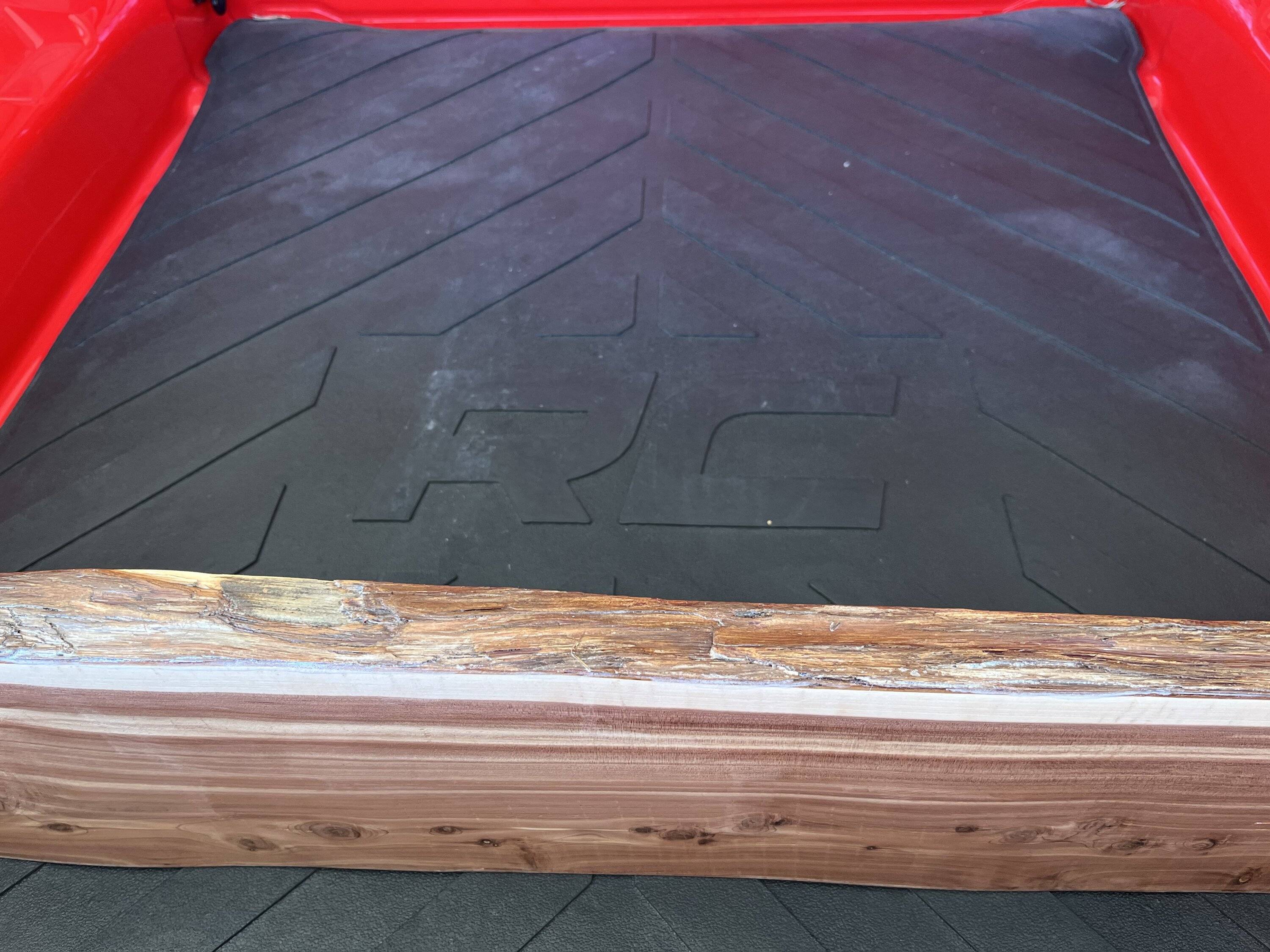

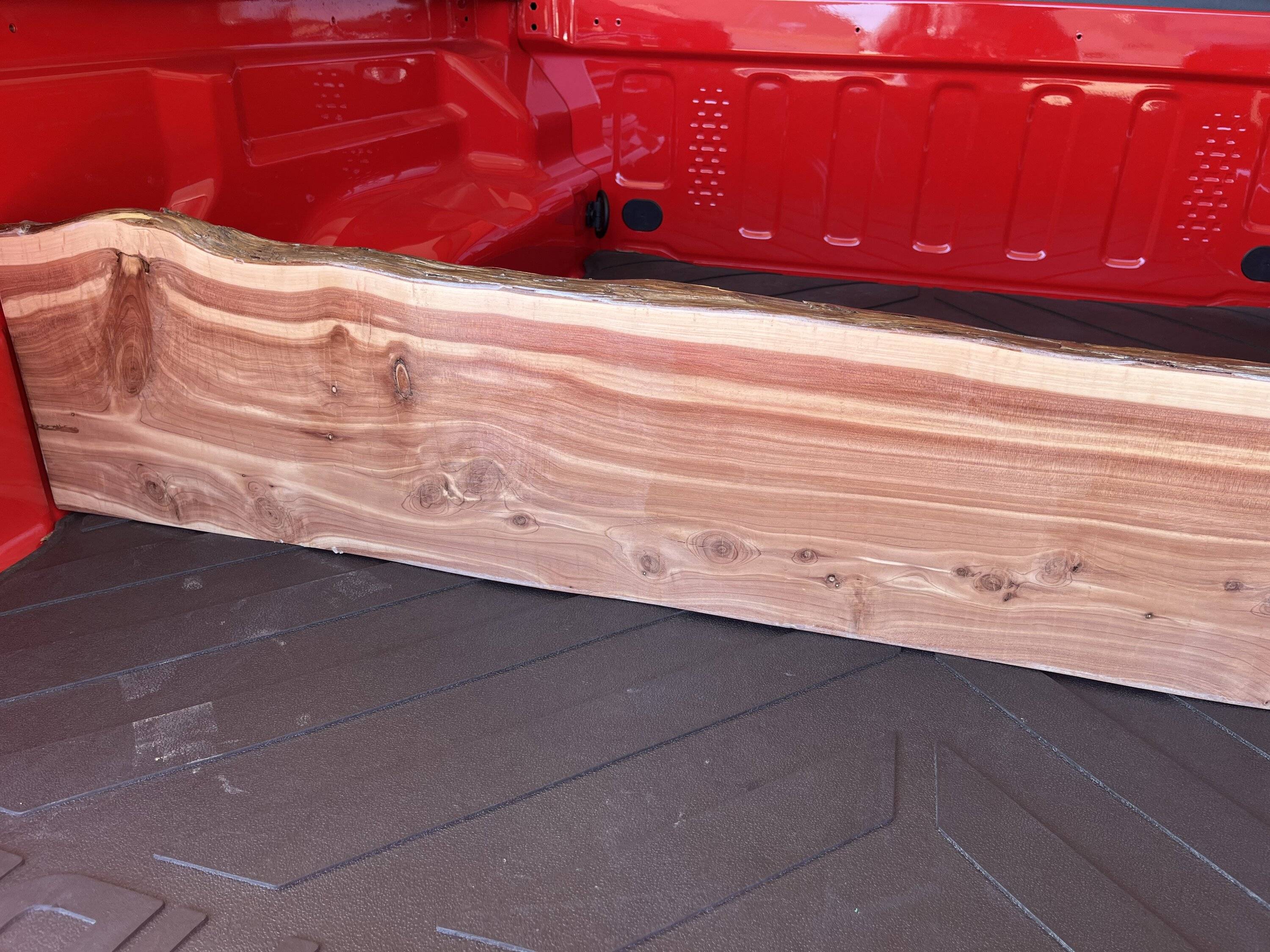

I was looking for something different and found that cedar slab for $20. So I thought even if I messed it up it wasn’t going to break the bank so to speak.

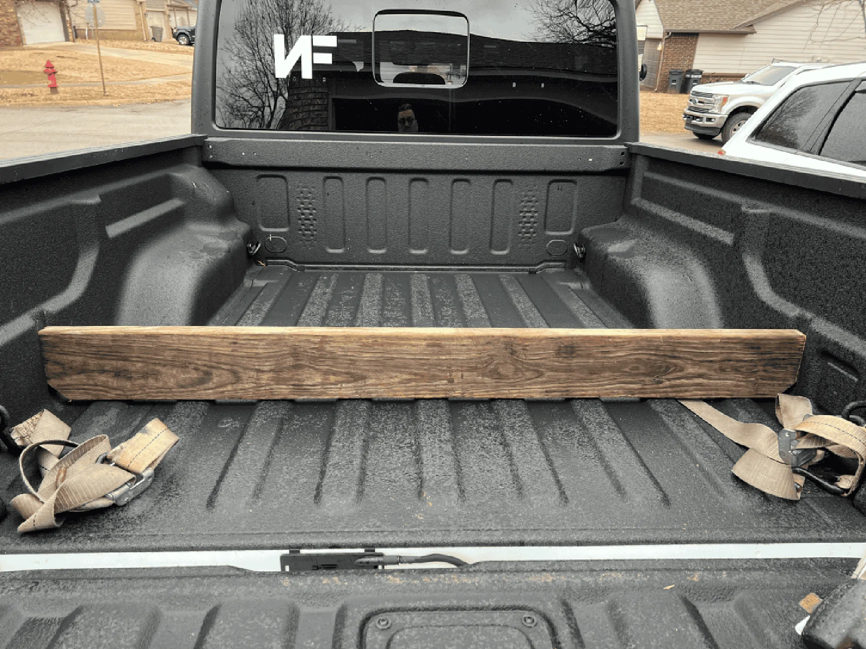

I did 57 5/8 and put 1/4 in self adhesive foam pad on each end. Of course by the time I was done sanding it was probably 1/4 shorter.

Yep, I went by what is in the owners manual, page 94 in "Getting to know your vehicle" in my 2023 Gladiator Owners Manual. Yeah, I RTFM. Mine is two pine 2X4's, cut to 57 5/8 inches and bottom corners cut on the one that sits on the bed, and also a 50" 2X4 with all corners rounded for the slots atop the bed rear wheelhouses in case I want to flatload something with the tailgate partially open. All 3 in place with a piece of plywood on top creates a level surface. I don't normally drive with the 50 inch, it stays in the garage unless I am going to be needing it. Since it all sits underneath a tonneau cover, I haven't even bothered to rattle can them for protection yet. Someday...
