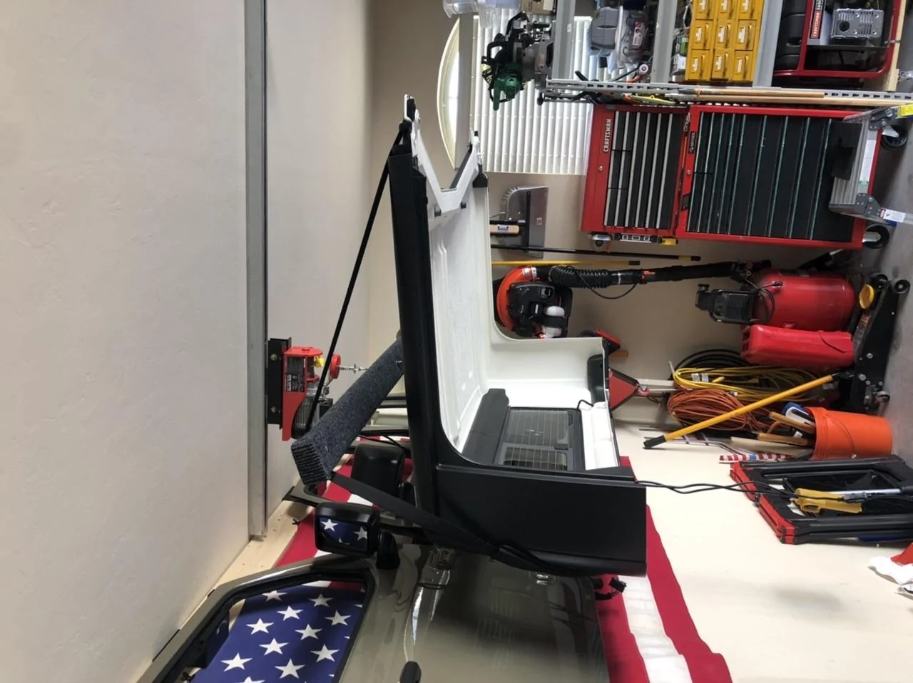

Mine takes 2 pulleys. One above the top and one on the wall or ceiling above the winch To make the turn.

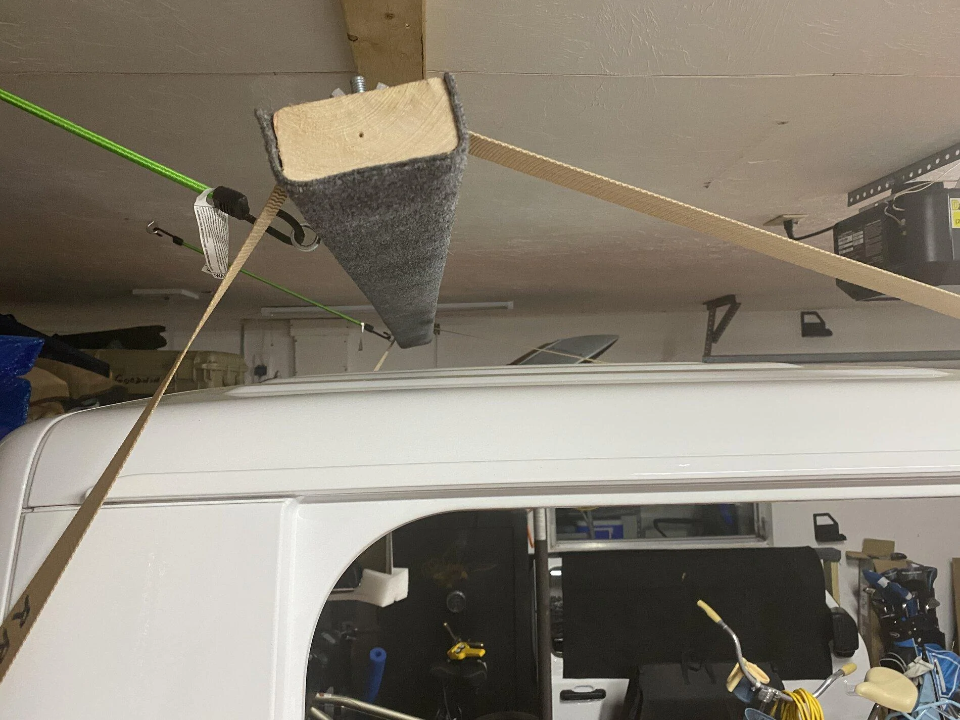

Finally got mine installed today. It works but not real happy with it fir a couple reasons
1. Strap length are a bitch to figure out. Too long and I have clearance issues, too short and I canā€™t get the webbing attached. Plus youā€™ve got to find the right length on both front and back in order to make it balance and lift off and hang evenly. Iā€™m burning thru webbing and grommets like crazy trying to find the sweet spot.
2. The HF hoist is all on or all off. Thereā€™s no slow so itā€™s either jerking the top up of letting it slam down. Not happy with it at all.
this is going to be an ongoing project. Some sort of adjustable webbing that can also take a grommet would be a huge help.

@DaleG- how much distance is there from the bottom of the 2x4 to the top when you are lifting off ? I am trying to minimize mine because of clearance issues in the garage. I donā€™t think itā€™s possible to have it touching but I have almost 12ā€ now
Iā€™m about 6ā€ but it could be a little tighter
Love reading all these ideas!
You could put a grommet on one end to attach to the top, leave the other end long and tie it off at the board until you get the right length. Or instead of a lag bolt and wingnut, use an eye bolt and carabiner on that end. Easy to adjust length then. Especially if you start with a strap that has a cam lock adjustment.

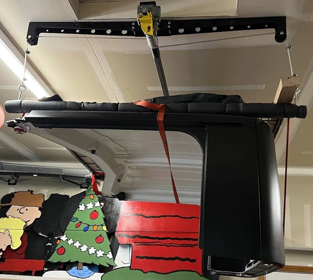

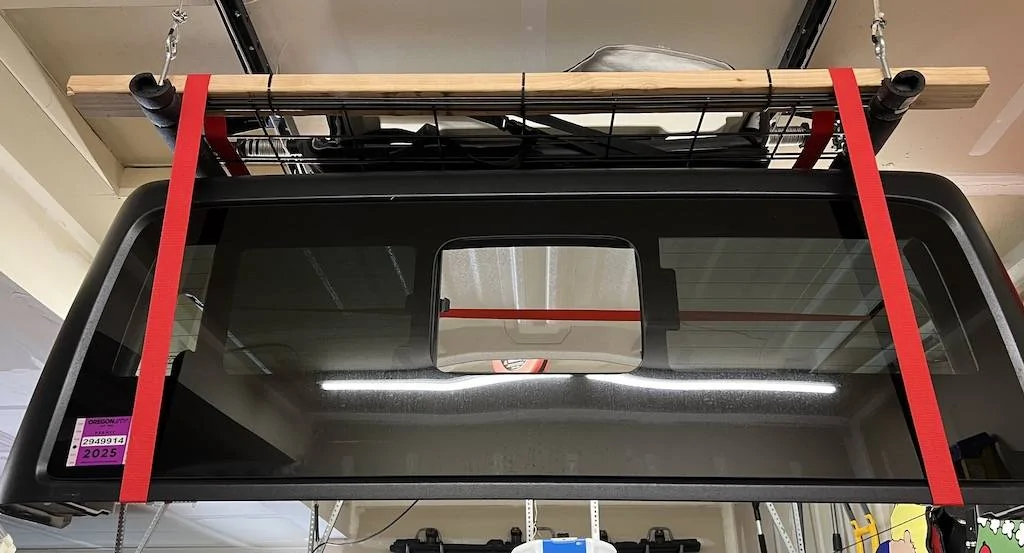

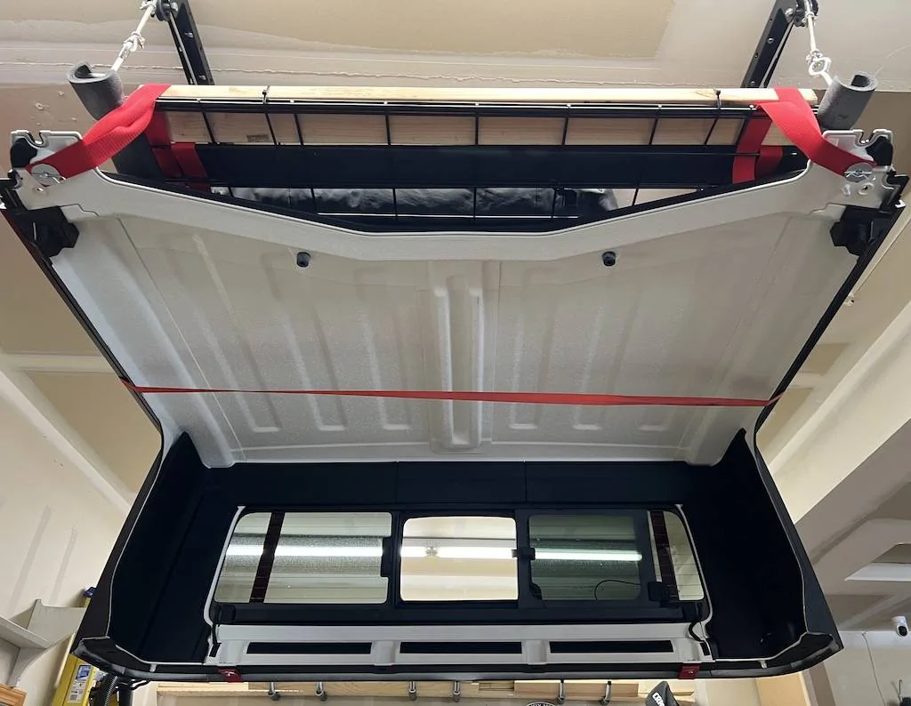

@DaleG - wanted to say thanks for sharing your hoist setup (not sure you visit much now) But I used your part list to help make some changes to my setup, using my Racor Hoist, but adopting your strap setup. I added a ratchet strap until I feel confident it's not needed. Compared to my JKU hard top this is so much lighter and easier.
Jeep Gladiator My door and top storage DIY solutions.... cart and hoist. IMG_3258
Jeep Gladiator My door and top storage DIY solutions.... cart and hoist. IMG_3260
Jeep Gladiator My door and top storage DIY solutions.... cart and hoist. IMG_3261
