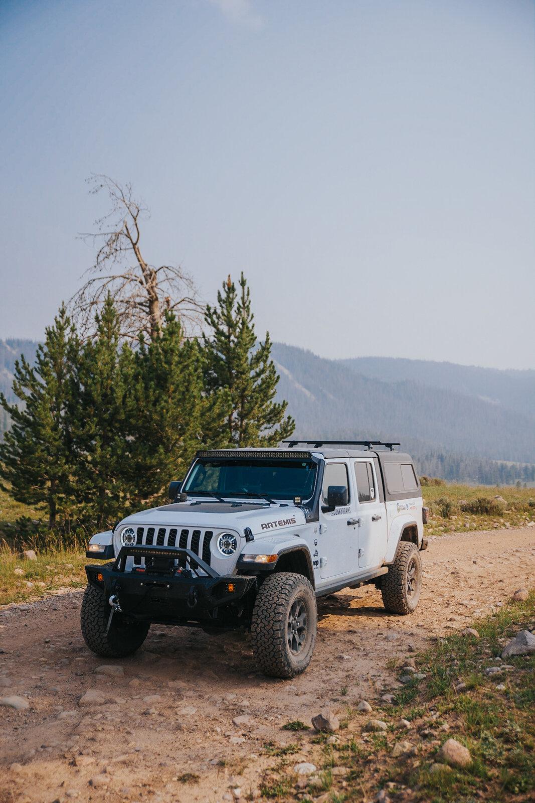

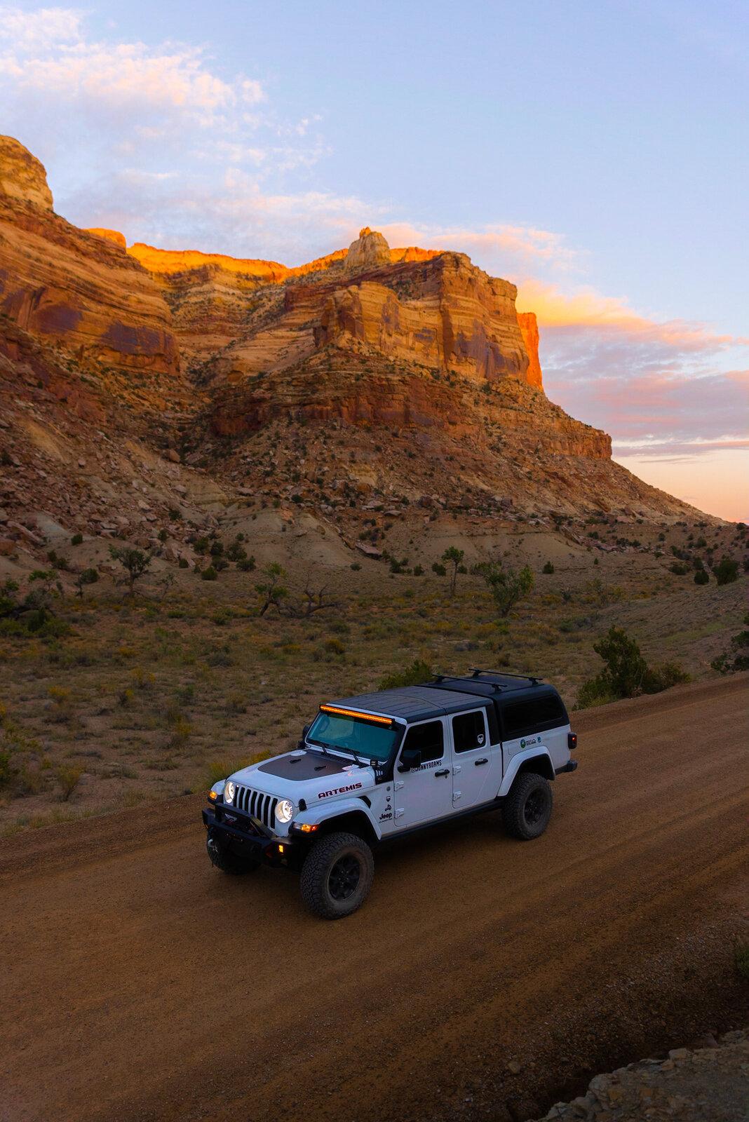

So I have a 3.5 inch lift (with a 1 inch front spacer for the Diesel engine and a 2.5” rear for the weight I have in the bed), I started with the Teraflex lift but had issues with their track bar causing an annoying knock. I’ve since switched to the 3.5” lift by rough country with their new 8 stage vertex res shocks, to see what I prefer. I have kept the Teraflex alpine IR control arms as they are incredibly good. I’ve included some photos. For reference my tires are 315/70/17 also I had to add 2.5” wheel spacers by Teraflex as I rubbed on my control arms at full lock, and my passenger rear rubbed on my muffler when flexing.
