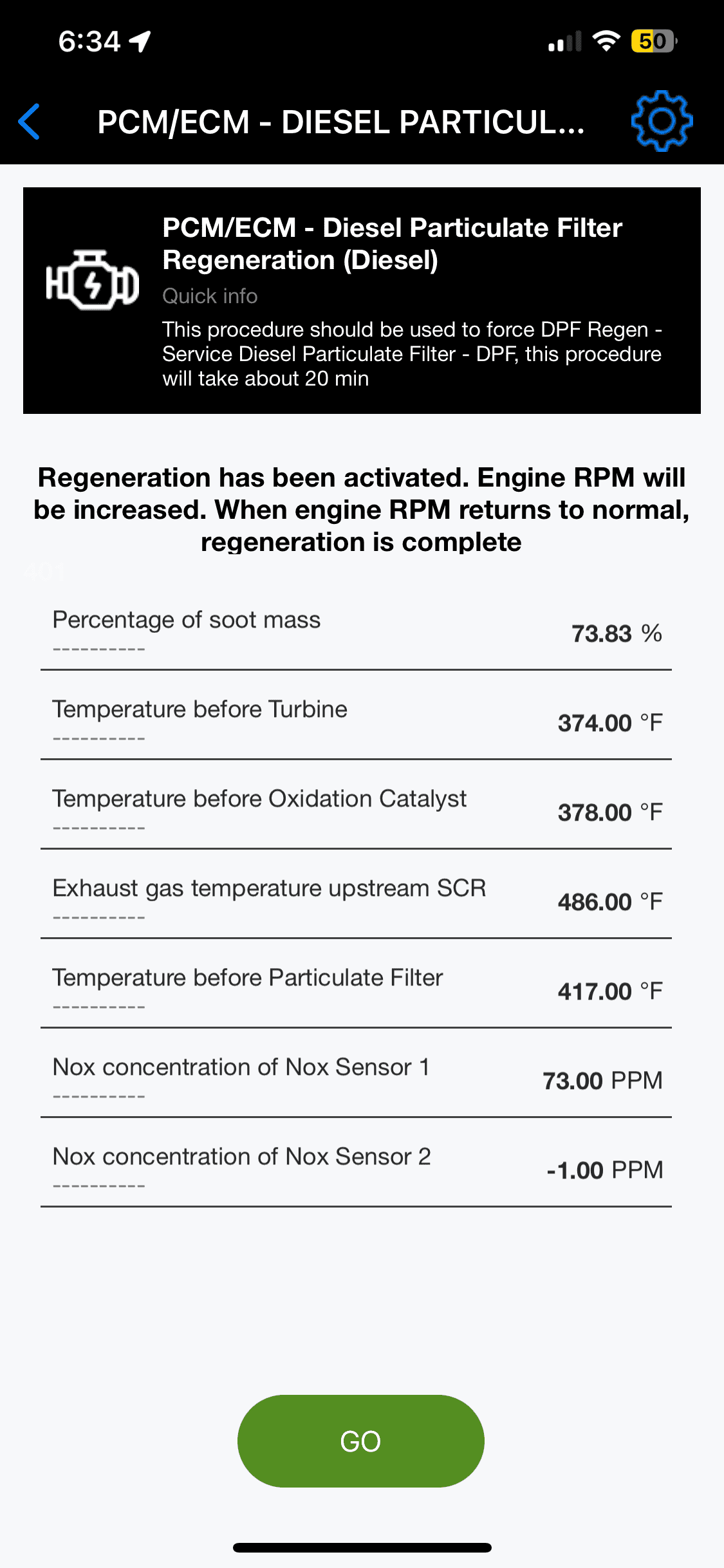

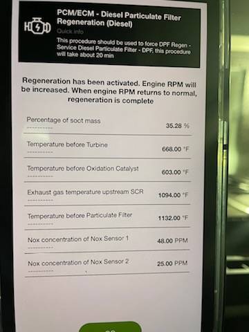

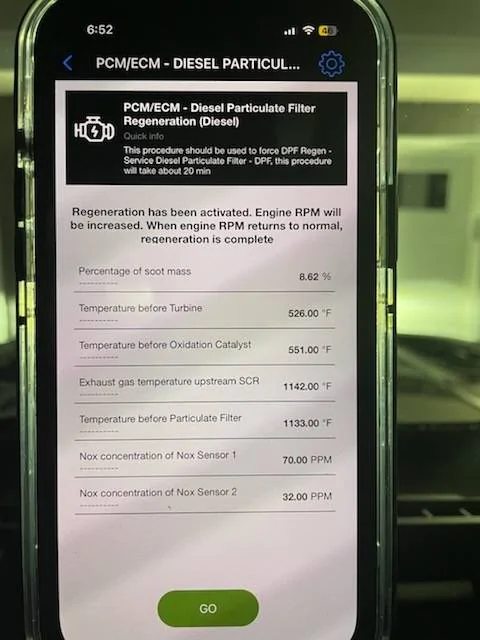

Most of what I monitor can be done with the off road pages. Soot level is important and really the only thing I want to “monitor” until it’s tuned.
This thread has had me reading into jacan, and I really do like the ability to force regen if needed. - probably going to pick up this capability once I figure out what obd2 reader thing is worth the $$. (Something to consider if your keeping the emissions equipment).
edit/update. Picked up the obd Mx+ and jscan and gave the force regen a try. holy hot…. @SargeDiesel
Jeep Gladiator First experience with DPF regen after installing Scanguage 2. IMG_2992
Jeep Gladiator First experience with DPF regen after installing Scanguage 2. IMG_0405
Jeep Gladiator First experience with DPF regen after installing Scanguage 2. IMG_0412

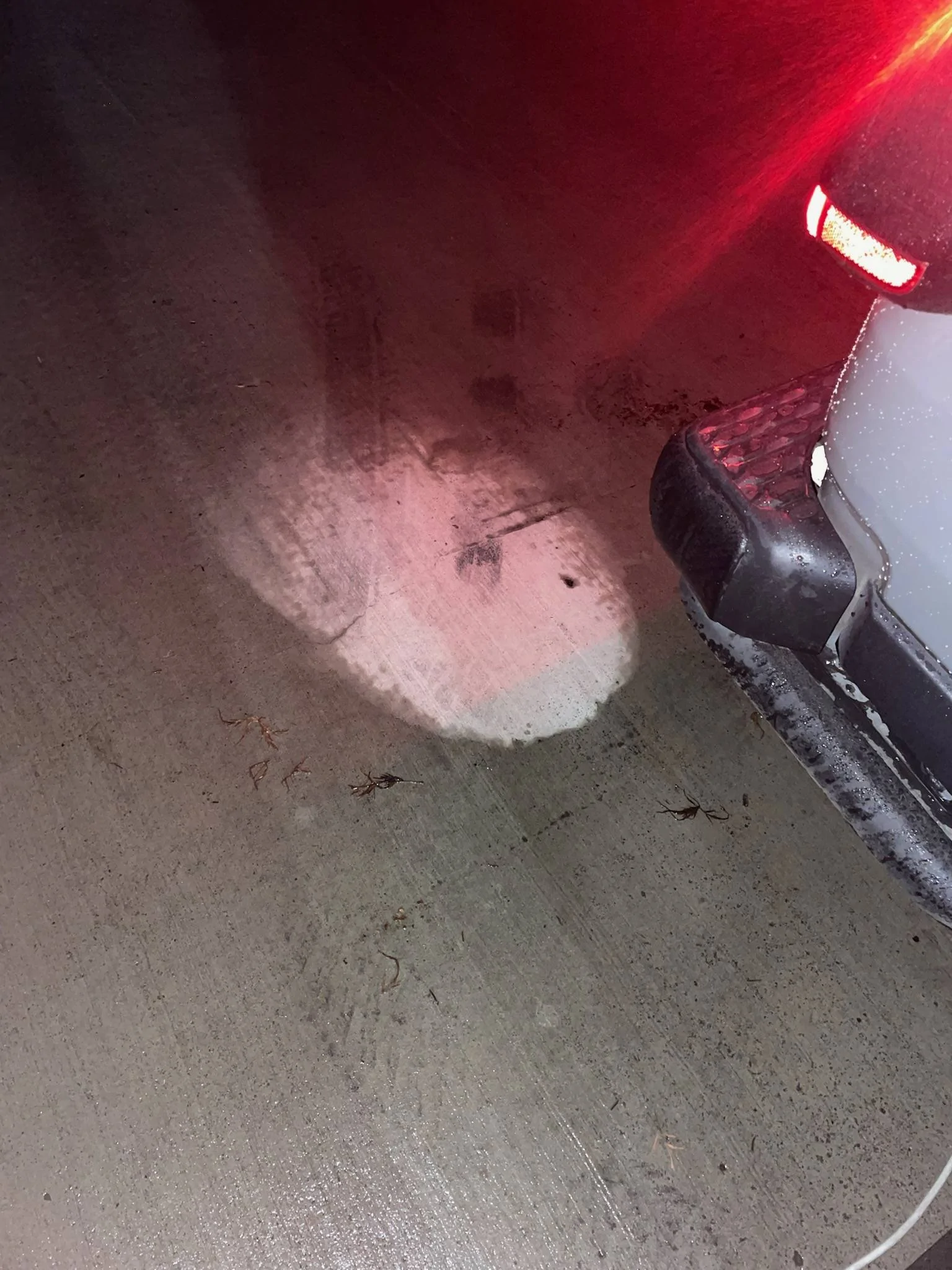

Exhaust tip temps
Jeep Gladiator First experience with DPF regen after installing Scanguage 2. IMG_0408
Enough to dry the cement post rain
Jeep Gladiator First experience with DPF regen after installing Scanguage 2. IMG_0410

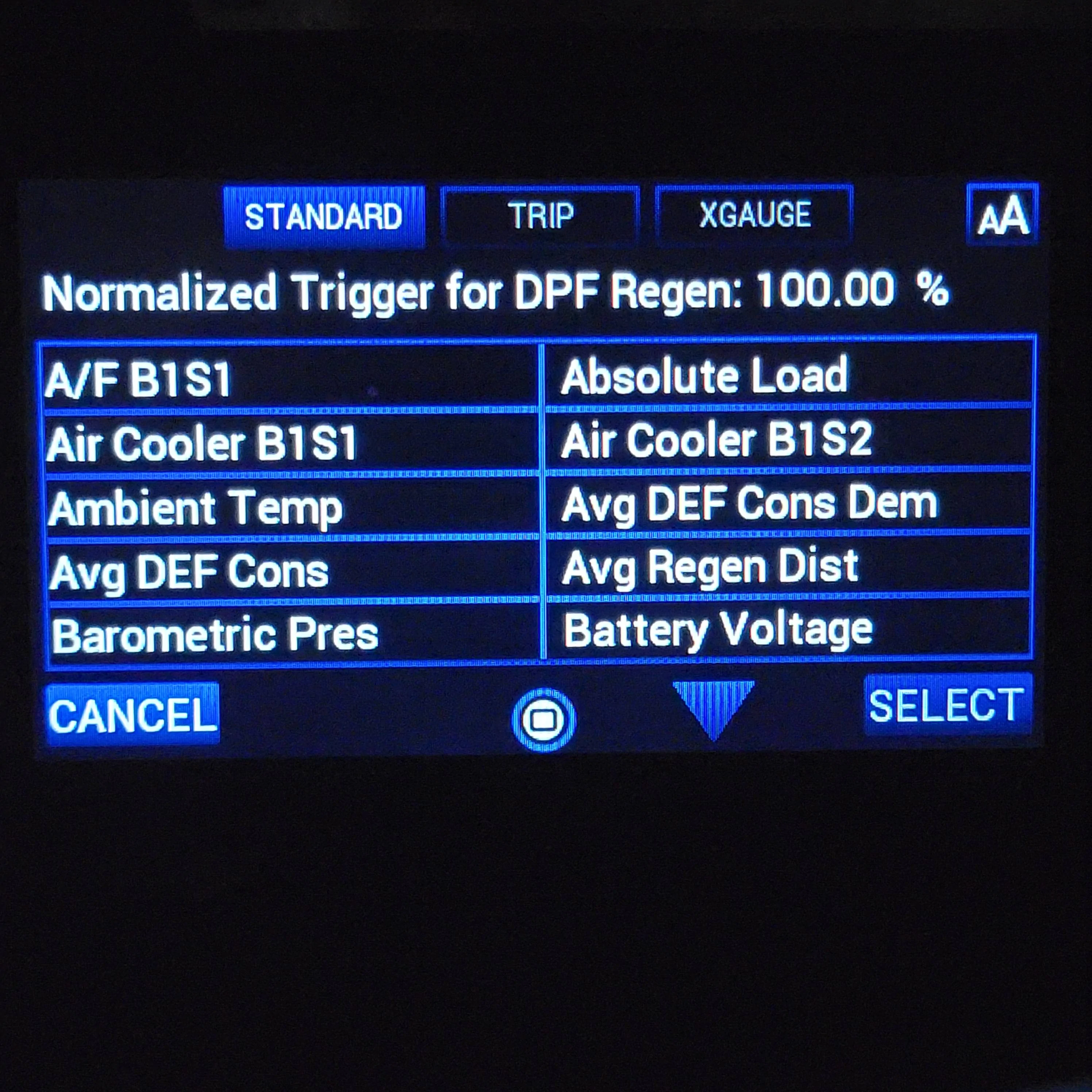

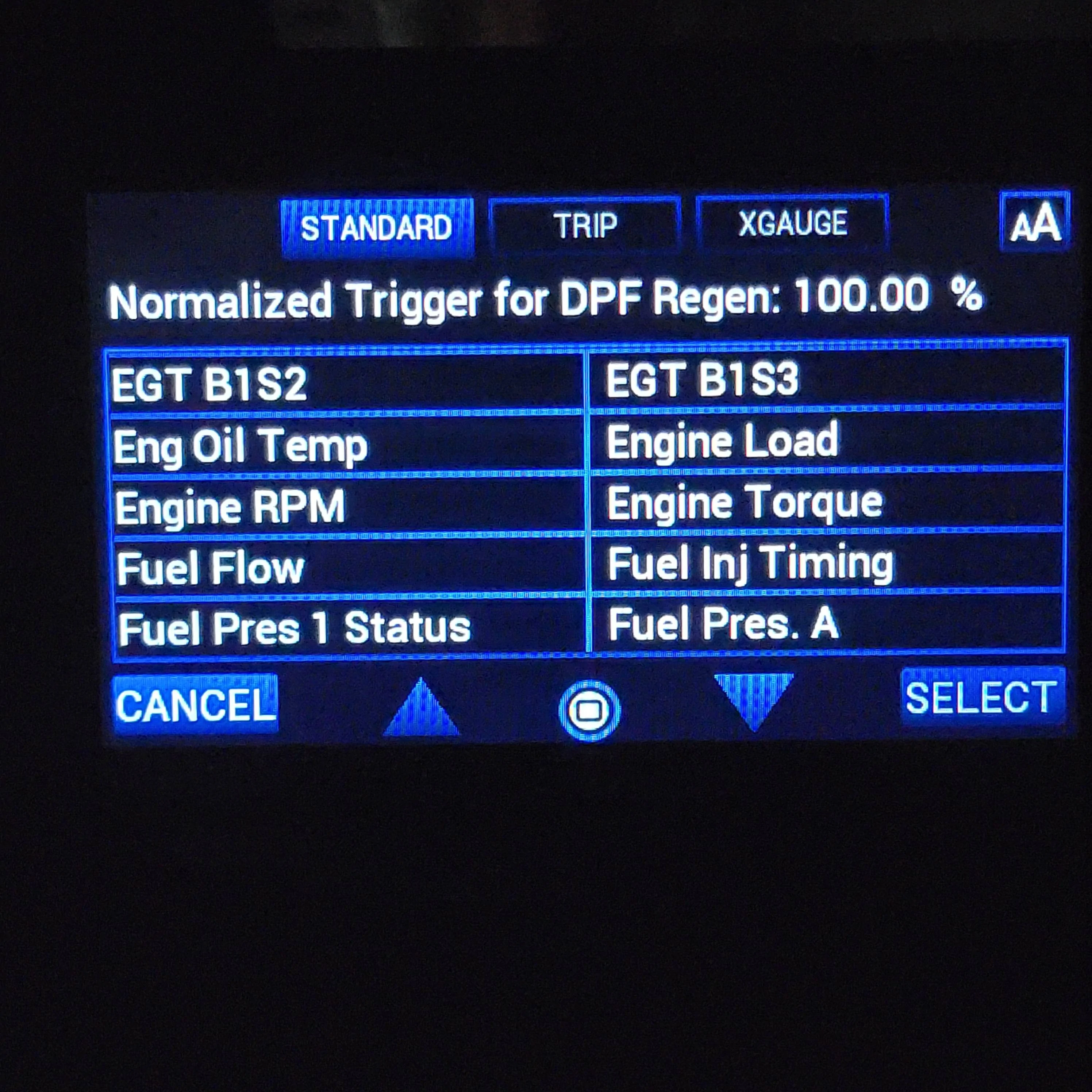

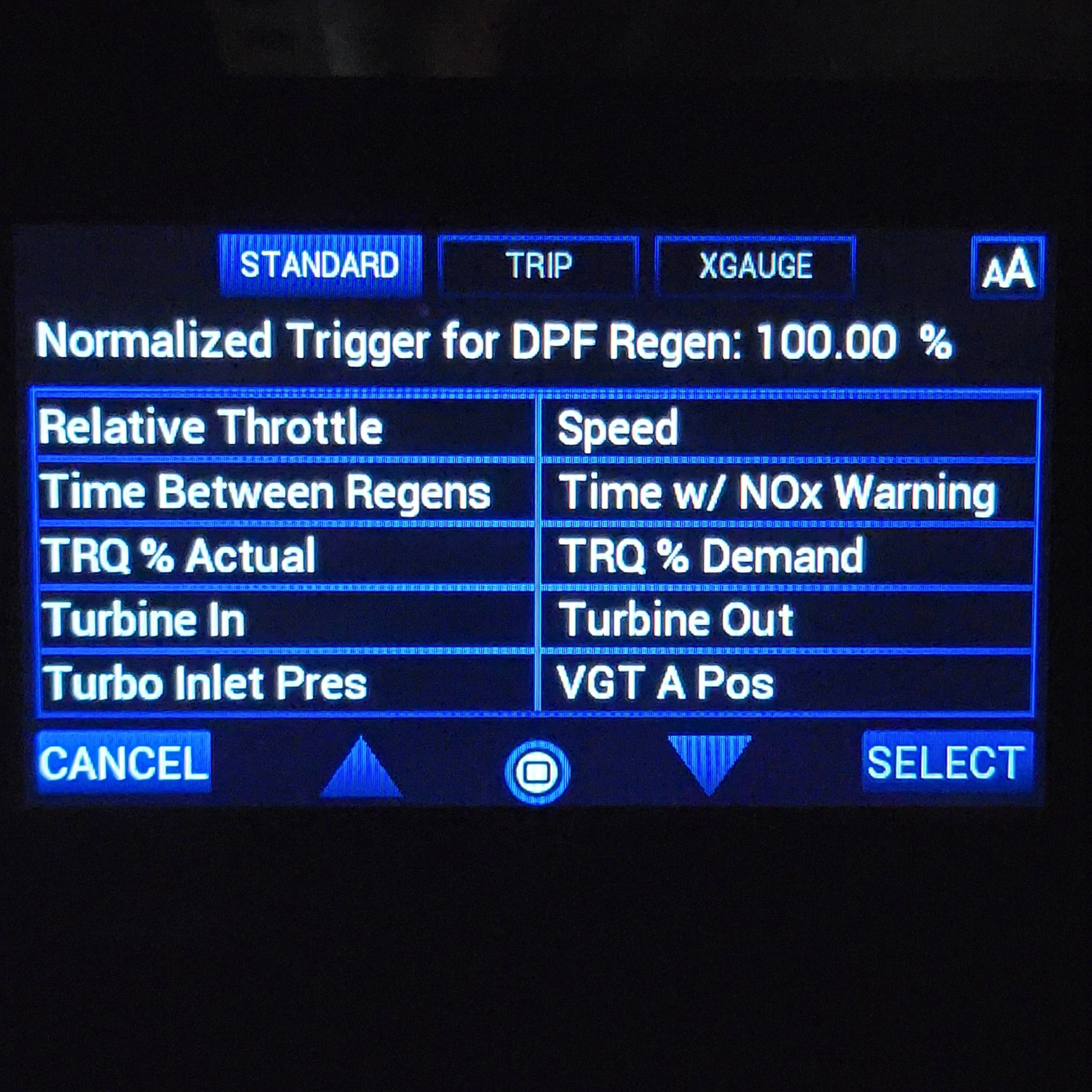

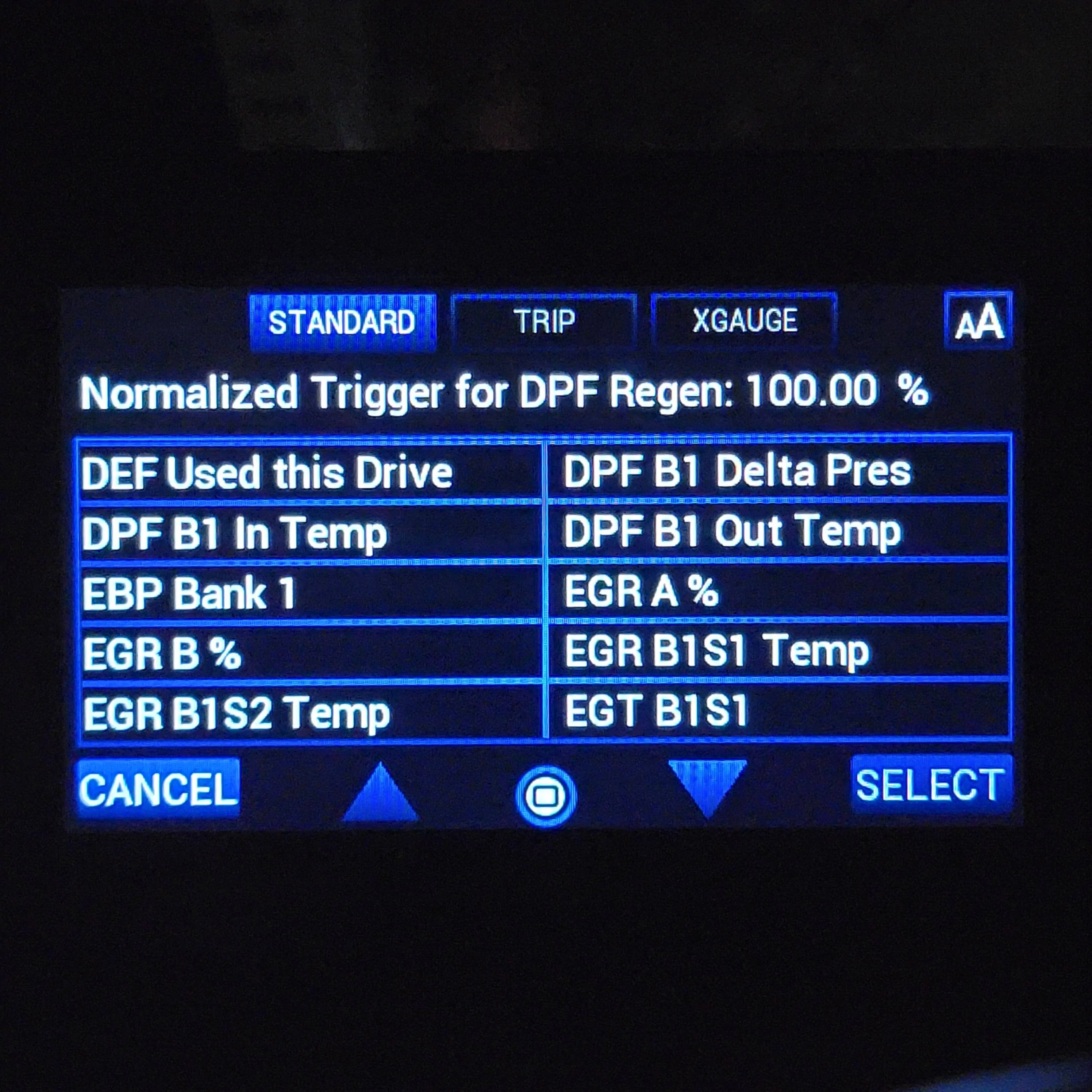

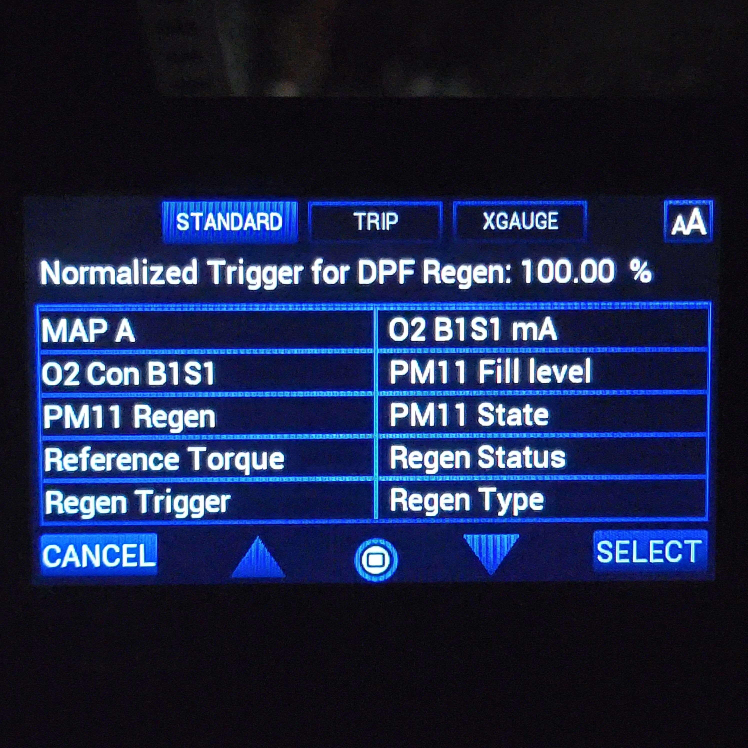

I'm still in the process of trying to figure out all of the SG3 codes... I was going to post all the pics I took of them and make a "fill in the blank" list after the abbreviation... but it would be a very long post... the information has to already be available somewhere... just no where I've been looking... ha ha
Here are a few examples of some of the codes:
Jeep Gladiator First experience with DPF regen after installing Scanguage 2. 20231108_203059
Jeep Gladiator First experience with DPF regen after installing Scanguage 2. 20231108_203032
Jeep Gladiator First experience with DPF regen after installing Scanguage 2. 20231108_203045
Jeep Gladiator First experience with DPF regen after installing Scanguage 2. 20231108_203022
Jeep Gladiator First experience with DPF regen after installing Scanguage 2. 20231108_203010
Jeep Gladiator First experience with DPF regen after installing Scanguage 2. 20231108_202958
Jeep Gladiator First experience with DPF regen after installing Scanguage 2. 20231108_202929
Jeep Gladiator First experience with DPF regen after installing Scanguage 2. 20231108_202945

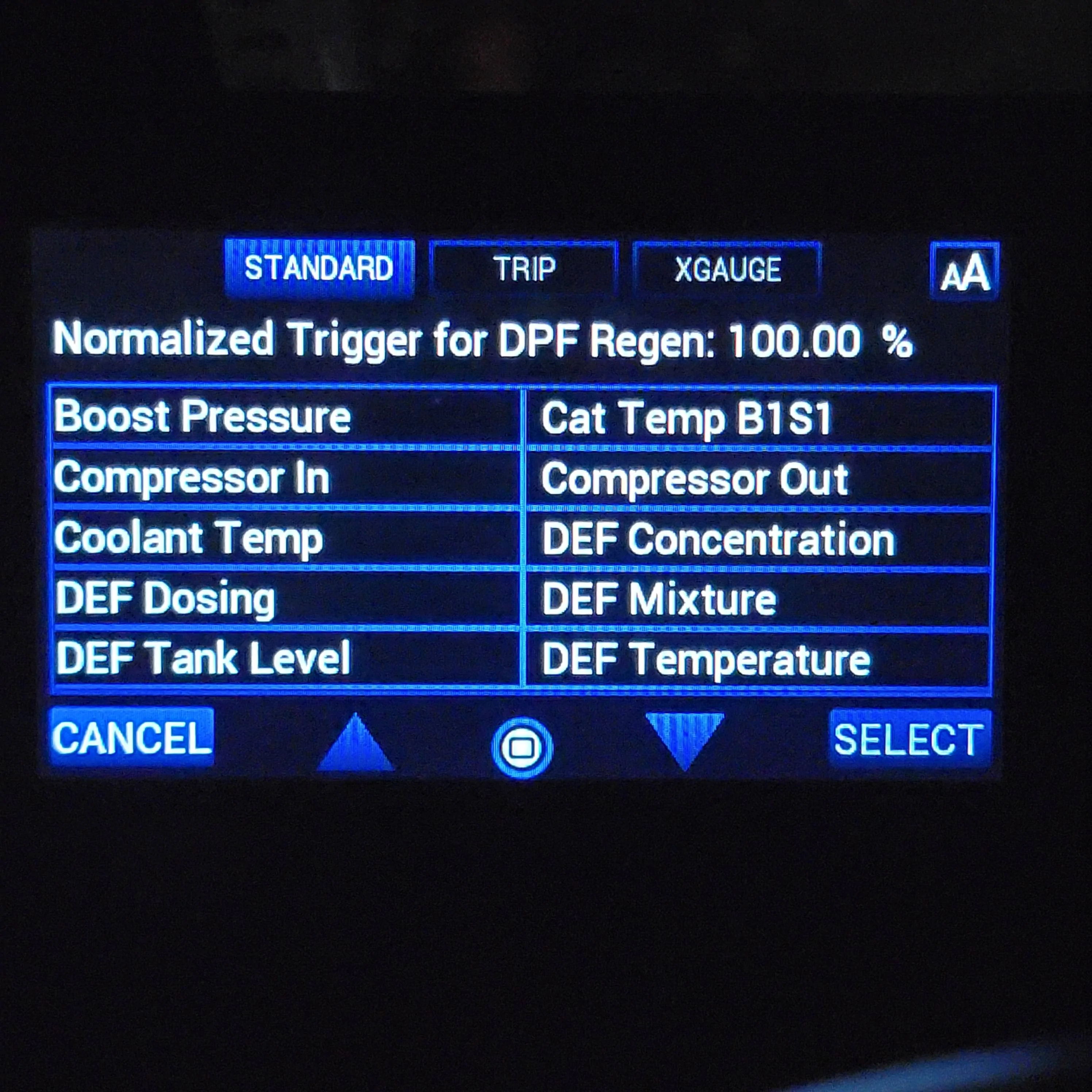

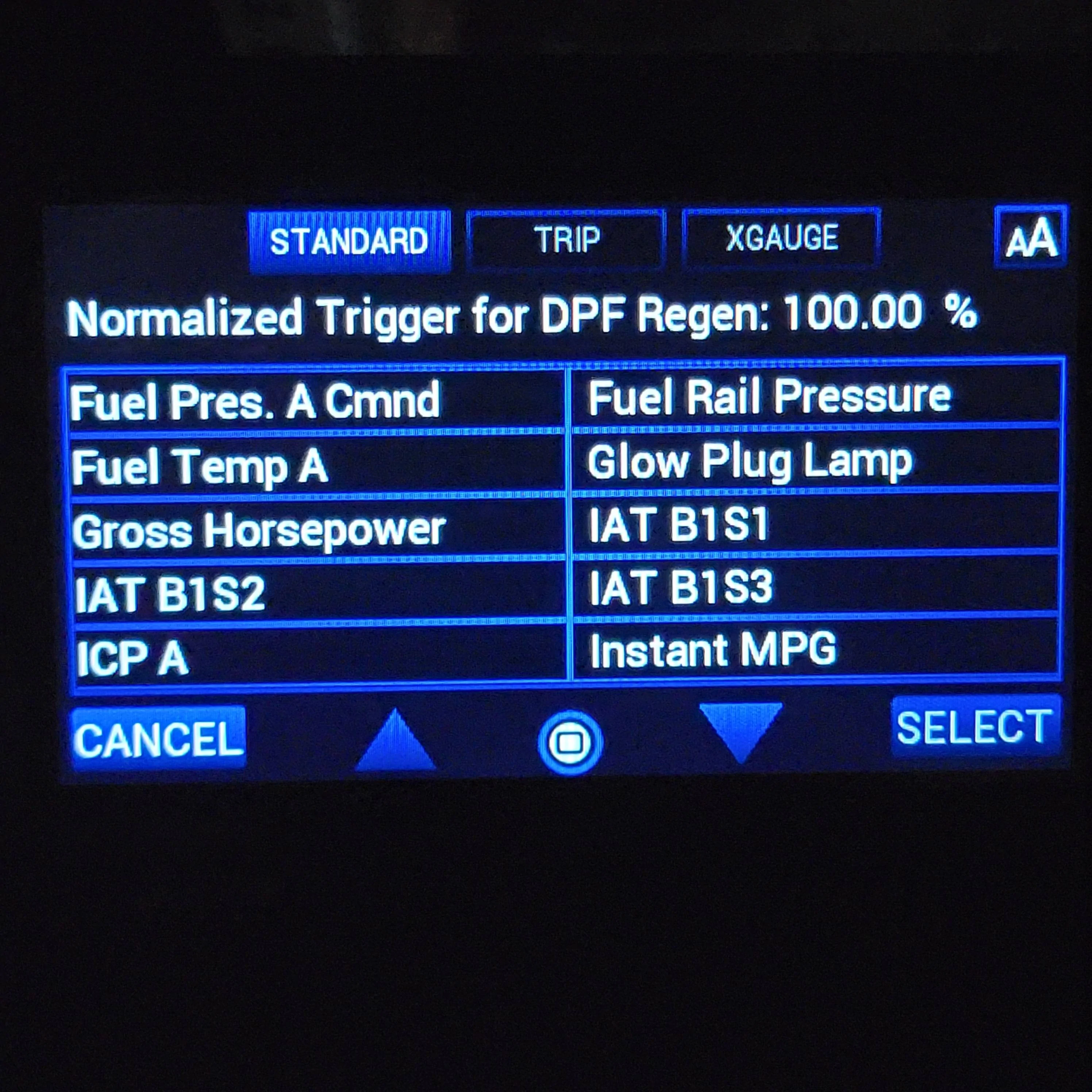

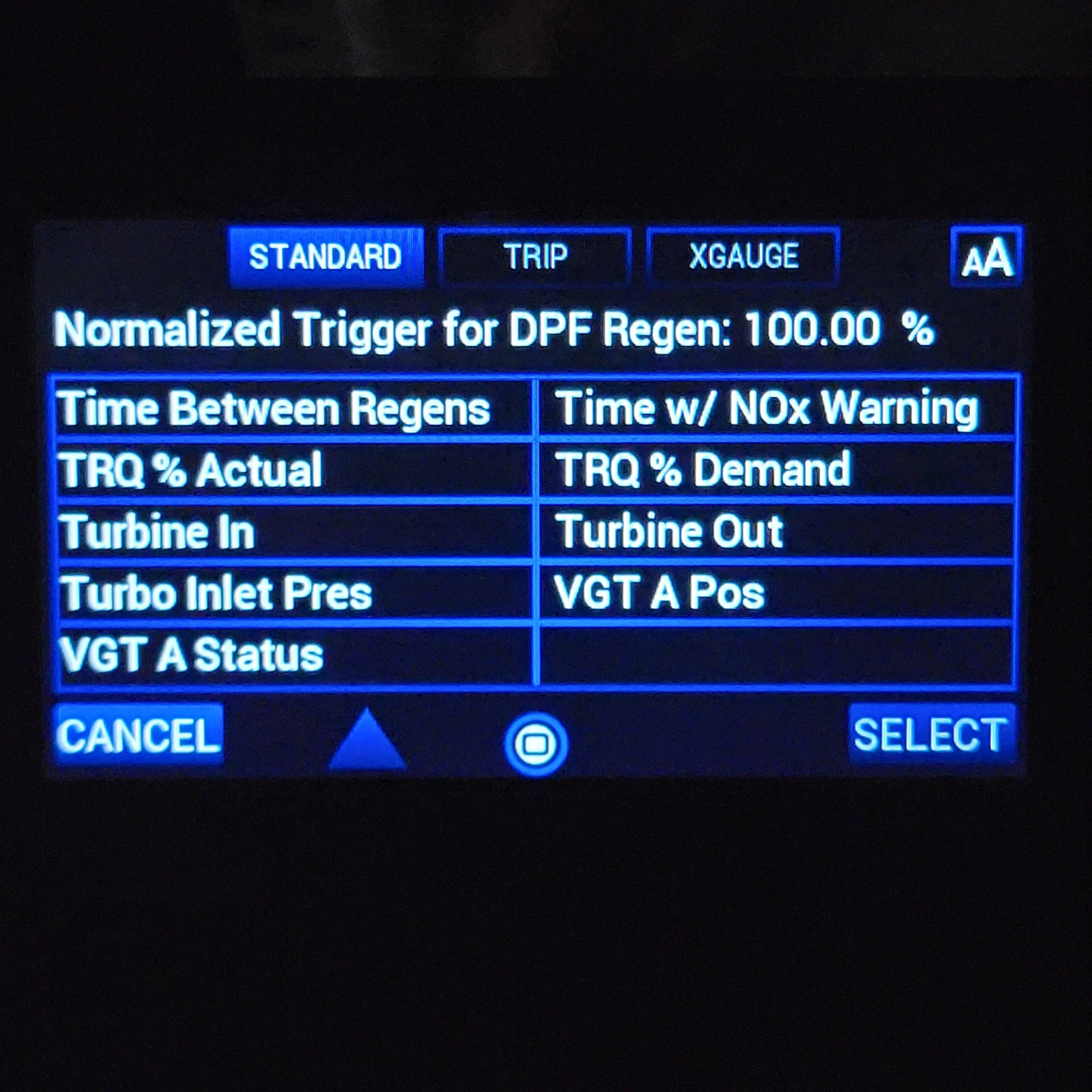

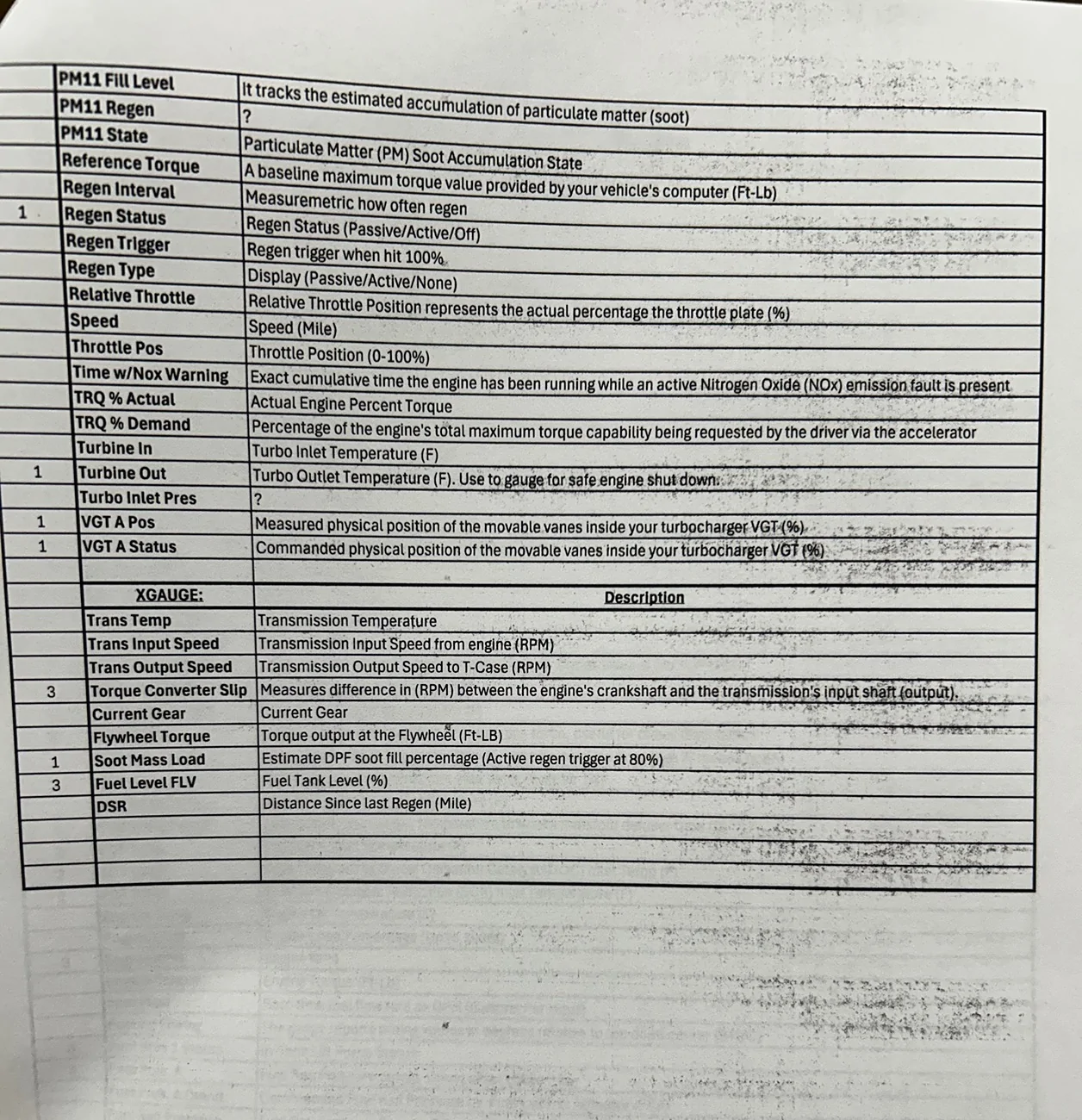

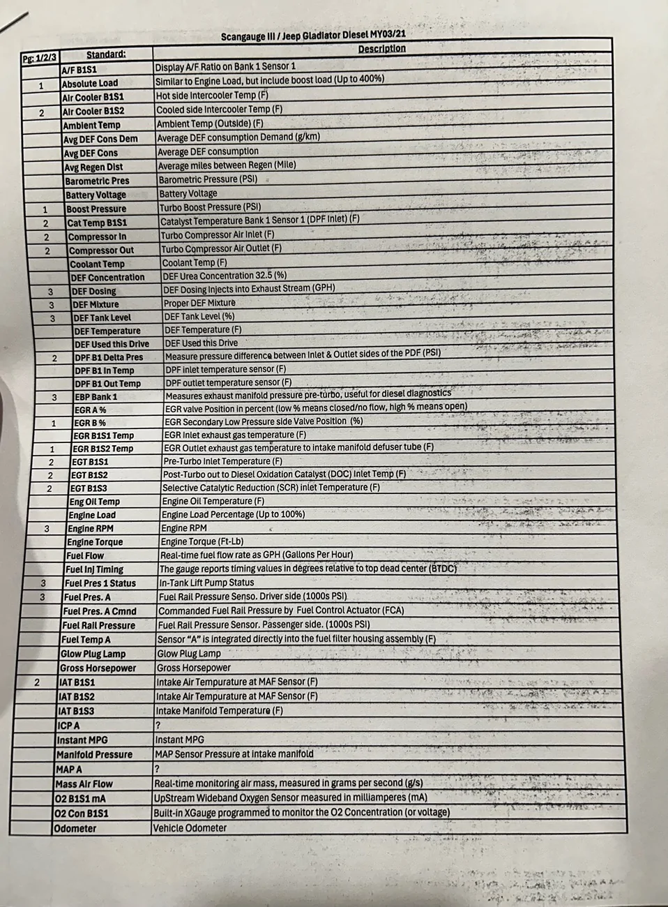

I would like to post it here to help with any future searches by other members. I recently upgraded from SG2 to SG3 and i was overwhelmed with the massive list of available sensors to monitor. Just like you, i couldn't find a complete list of the sensors abbreviation anywhere, even on SG website. I ended up spent half a day searching and created an Excel sheets below. There's a few with question marks that i still couldn't figure out. I can provide this in Excel format too if interested.
Jeep Gladiator First experience with DPF regen after installing Scanguage 2. IMG_0713
Jeep Gladiator First experience with DPF regen after installing Scanguage 2. IMG_0714
Do you Know of a sensor that I could use to help
Monitor the Diesel CAT I have installed? I have a straight thru exhaust with an added CAT.
The one label Cat Temp B1S1 is the factory DPF temp sensor located at the middle of the DPF. If you're asking about aftermarket sensor than i have no clue lol.
I replaced the DPF with the aftermarket CAT. I need to do more research. Saw your list and thought maybe you would know.
I see sensors in the exhaust above/before DPF location. Need to verify what they do and their identity.
Thanks
